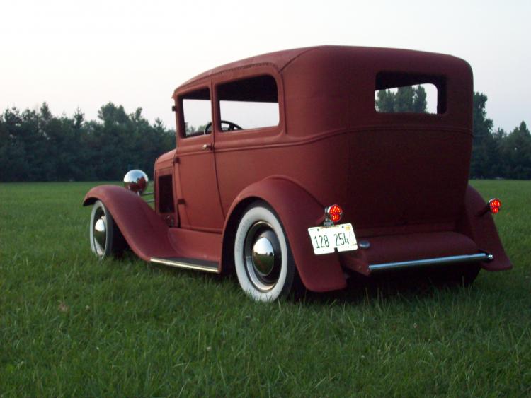

History looking for model a Cdan w/ 32 gas tank pics???

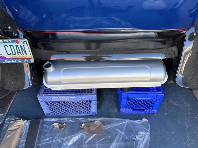

    well, that was short lived... took the back seat out and the cross member is right under the seat and to the top of the raised floor...so, back to the drawing board... so what I need to do is remove the valance on the rear and re try the 32 tank, also It will slide all the way in to the filler neck..

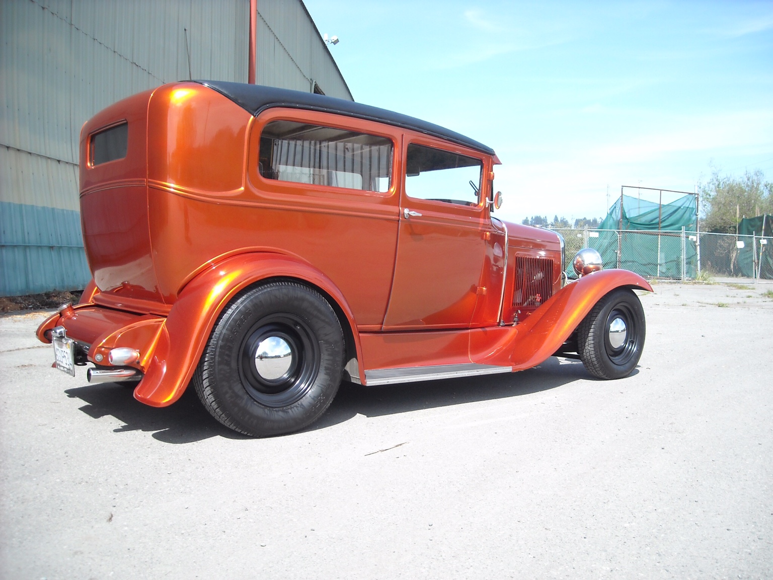

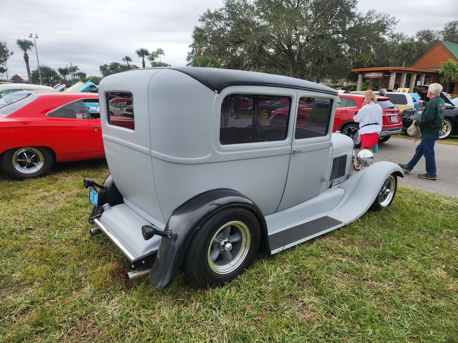

    My friend Davis A C-dan with deuce tank. 20230128_135717.jpg 20230128_135705.jpg

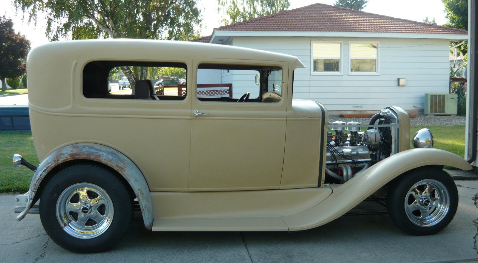

    Anybody got pics of any without fenders ? Been kinda heading this way on my 31 Tudor but I'm thinking of running bobbed rear fenders or none at all....

    thanks for the post and pic... looks like the dagels kit install.... I can slide my tank to where the filler neck touches the body... not to keen on the look of the tank haning back there and sticking out so far as my look is to be a drag /street race banger

    David used the Duece frame rail ends to attach tank in stock '32 configuration.

    Well, so far I took all the rear interior (seat and floor) out...didn't come up with a way to put a tank inside the rear, so back to the 32 tank idea......looks like no problem to slide the tank in to where the filler neck is about 1/2'' from the body with the valance removed, puts the tank up about 4'' more.... so looks like that what we will do...not the best looking idea.... but it's the best we came up with...
    I'll be doing that shortly, and will post some pics along the way..using the 32 tank and frame horns and fabing up the rest...also moving the rear shocks to the front side as they where on the rear side...wouldn't be able to remove the shocks with the tank in, and they were also too long after the car was lowered...

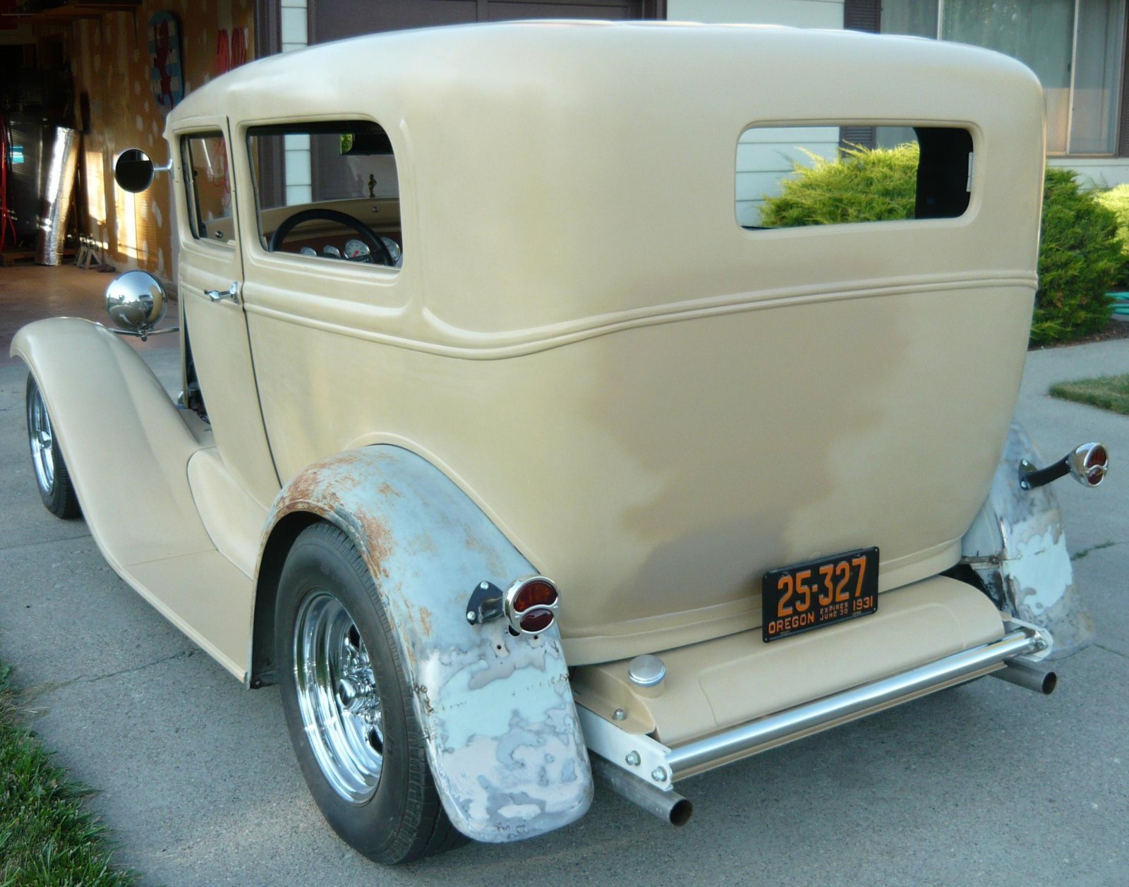

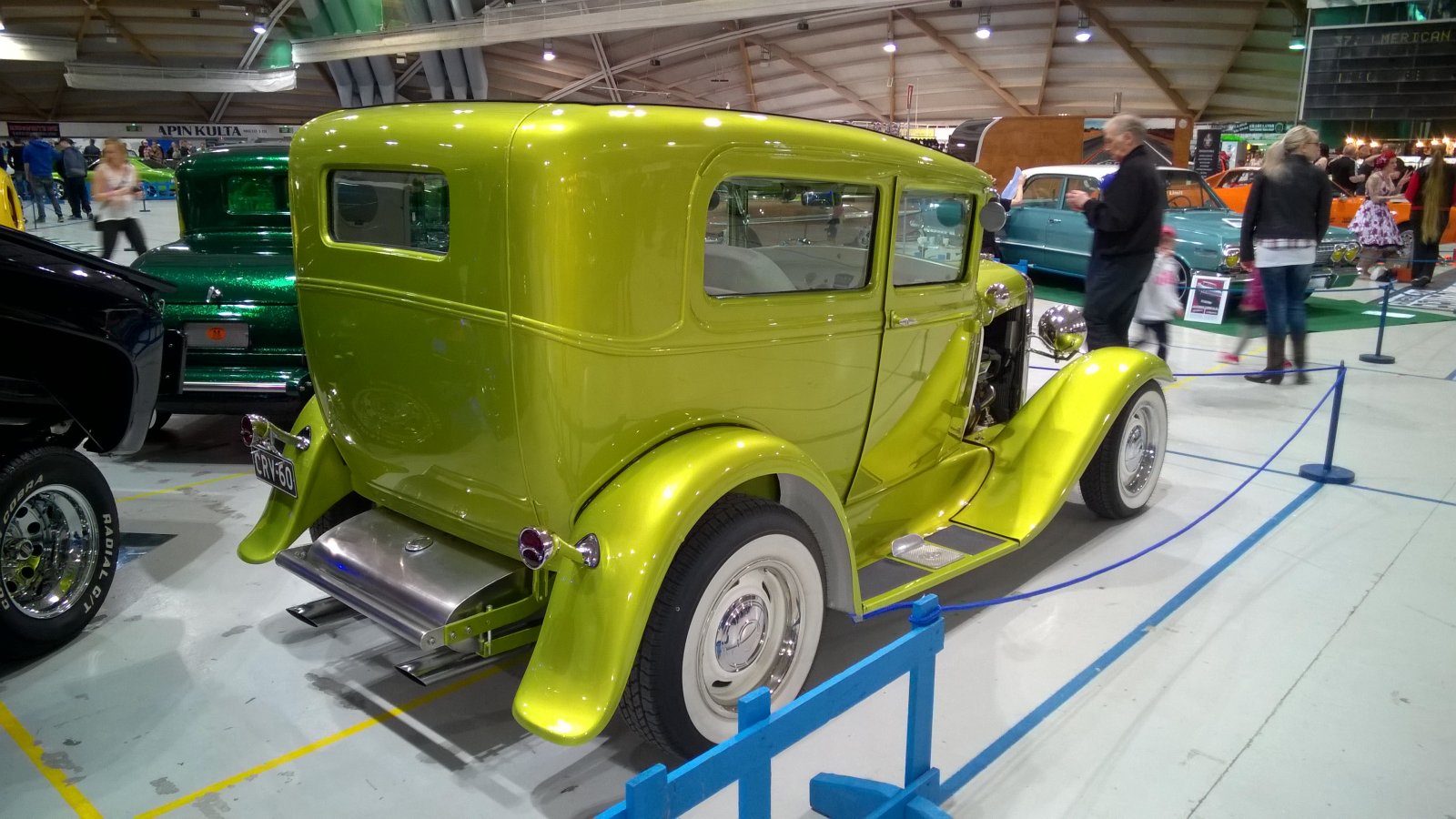

    Just in case you'd like to see more 30/31 pix:
    This one looks like what you're trying to do
    Who knows what this tank and frame rails are? I'm guessing custom made for this car.

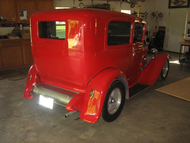

    Here's a 28/29 with 32 tank:
    ...and here's one with some kind of tank back there:

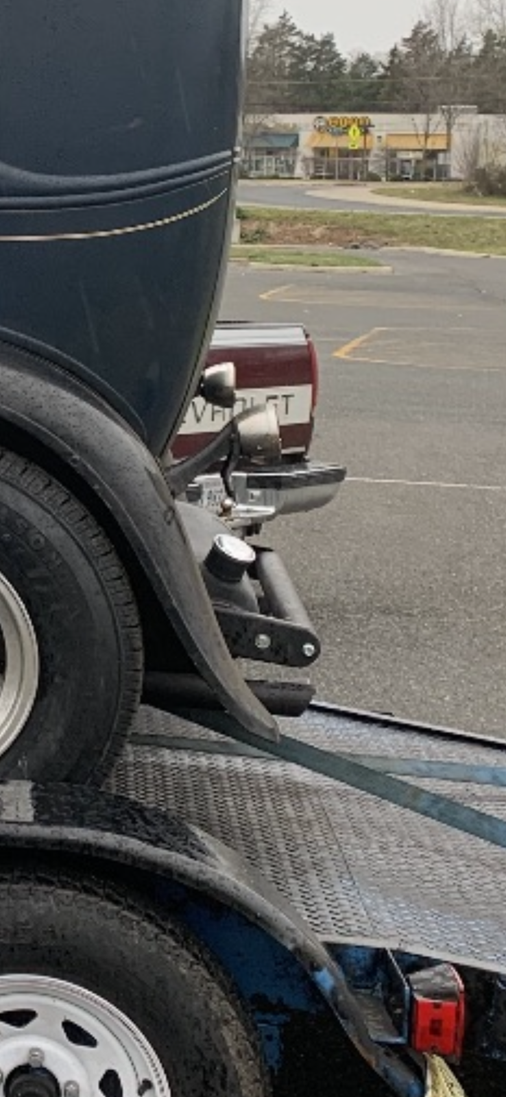

    that is a fabricated tank, not a ‘32 tank.
    I had fitment issues on one car and considered mounting the tank under the top off the frame rails even packing it down, to make it work.
    On a stock ‘32 sedan the body is indeed shorter so it appears that the tank sticks out more than on a coupe or roadster.
    so looking at post 19 you are correct with your observation !

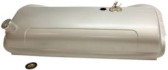

    sooo. it's a reproduction 32 ford gas tank...correct???
    made to bolt on a 32 frame..???
  25. clem
    Joined: Dec 20, 2006
    Posts: 4,614
    clem
    Not likely to be reproduction,
    looks homemade, different bracket to bolt to top of chassis, curve’s don’t look the same as original, angle of filler cap looks different.
    (Sad really that I notice these things, but last year I spent a lot of time refitting / refurbishing 2 original ones…………..)
    I suspect that it is a one off made by owner to look like a ‘32 (or perhaps a reproduction one without the correct brackets)- looks close enough for most.

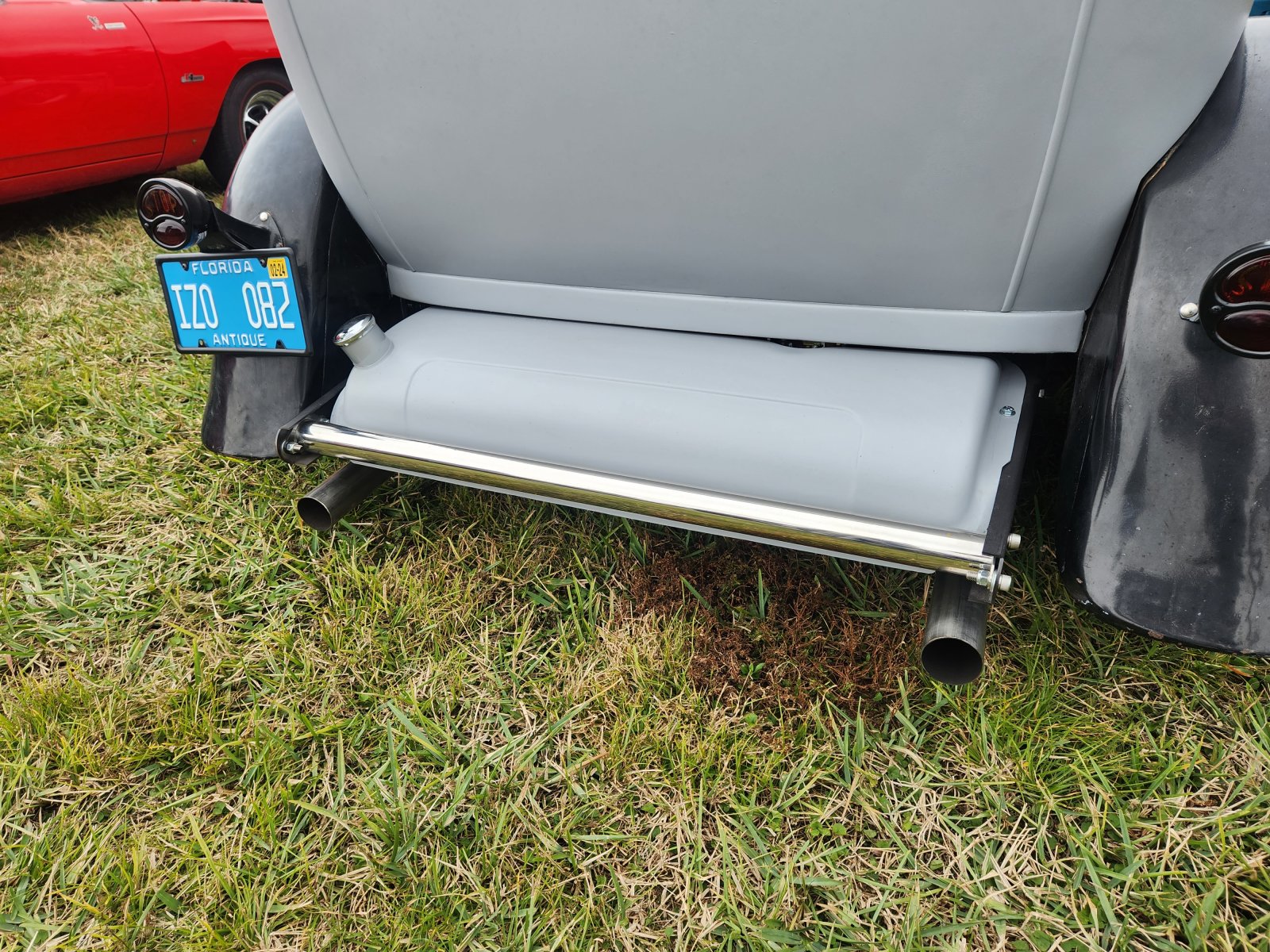

    Here are a couple of reproduction ones.
    vintique
    note no brackets at all on this one as some come like that

    Top tank Vintique with side gussets. Bottom tank from Tank's no gussets. I think the Tanks tank is a better quality stamping so I always add the gussets.
