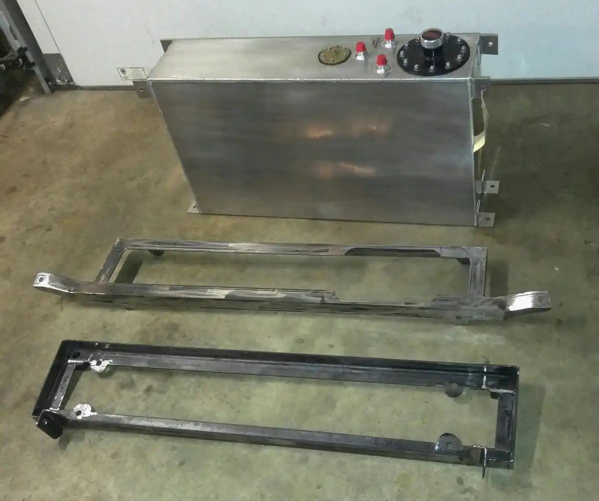

  3. By carefully measuring, here's how I put a thin vertical tank behind the back seat(s) of my '28 A.
    It's 15 gallons, RCI #2161.
    The top & bottom frames are 1.5" angle, MIG welded with a Lincoln 140c.
    The "firewall" is 18 gauge steel I cut & bent with simple hand tools.
    The fill-tube goes through a hole in the driver's side sail panel.
    all four seats are stock tilting Model A Tudor front seats.
    BTW, the top is chopped 3.5" in front & 2.5" in back. I'm 6'2" and fit comfortably.
    Hope this helps.:)

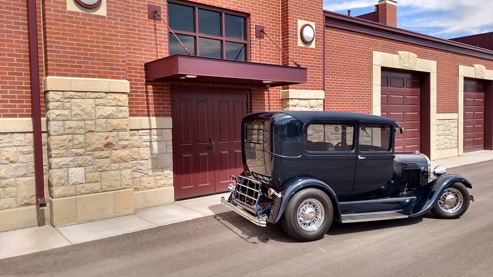

    We built this sedan (with a 32 tank) for a great guy 25 years ago.
    2FORCEFULL likes this.
