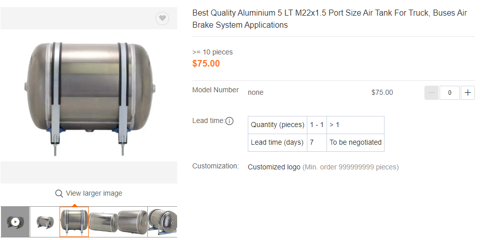

    Joined: Sep 16, 2014
    Posts: 15,618
    Bandit Billy
    $75 bucks. Looks close, weld a moon Tri-bar cap on it, add a data plate, I prefer springs to hold it down, easily remedied. Purpose built, Aluminum, why recreate the wheel?
  22. nrgwizard
    Joined: Aug 18, 2006
    Posts: 3,027
    nrgwizard
    from Minn. uSA
    Nice find, BB.
