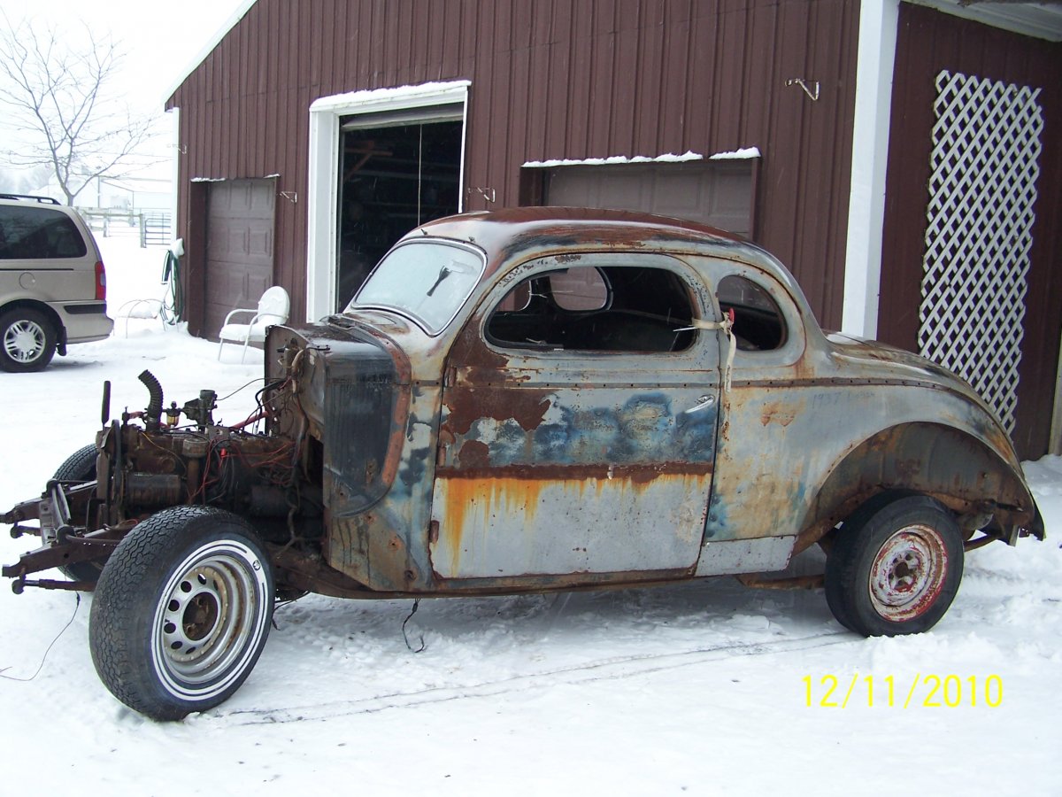

    Hey y’all, here is my very neglected 39 Plymouth or what’s left of her. I know they are a pain to find stuff for, but I’m wondering if anyone on here has done some reconstruction or custom fab stuff to one. She’s sat in the same place since 1956, so I’m in the process of tearing into the motor to see if it’s salvageable, but so far I’m not convinced. Although the oil is still clean..

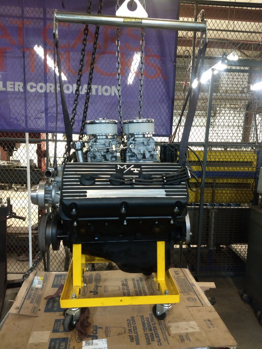

    It tuff to beat Mopar flat head 6 but a HEMI wins IMG_20210206_123813248.jpg

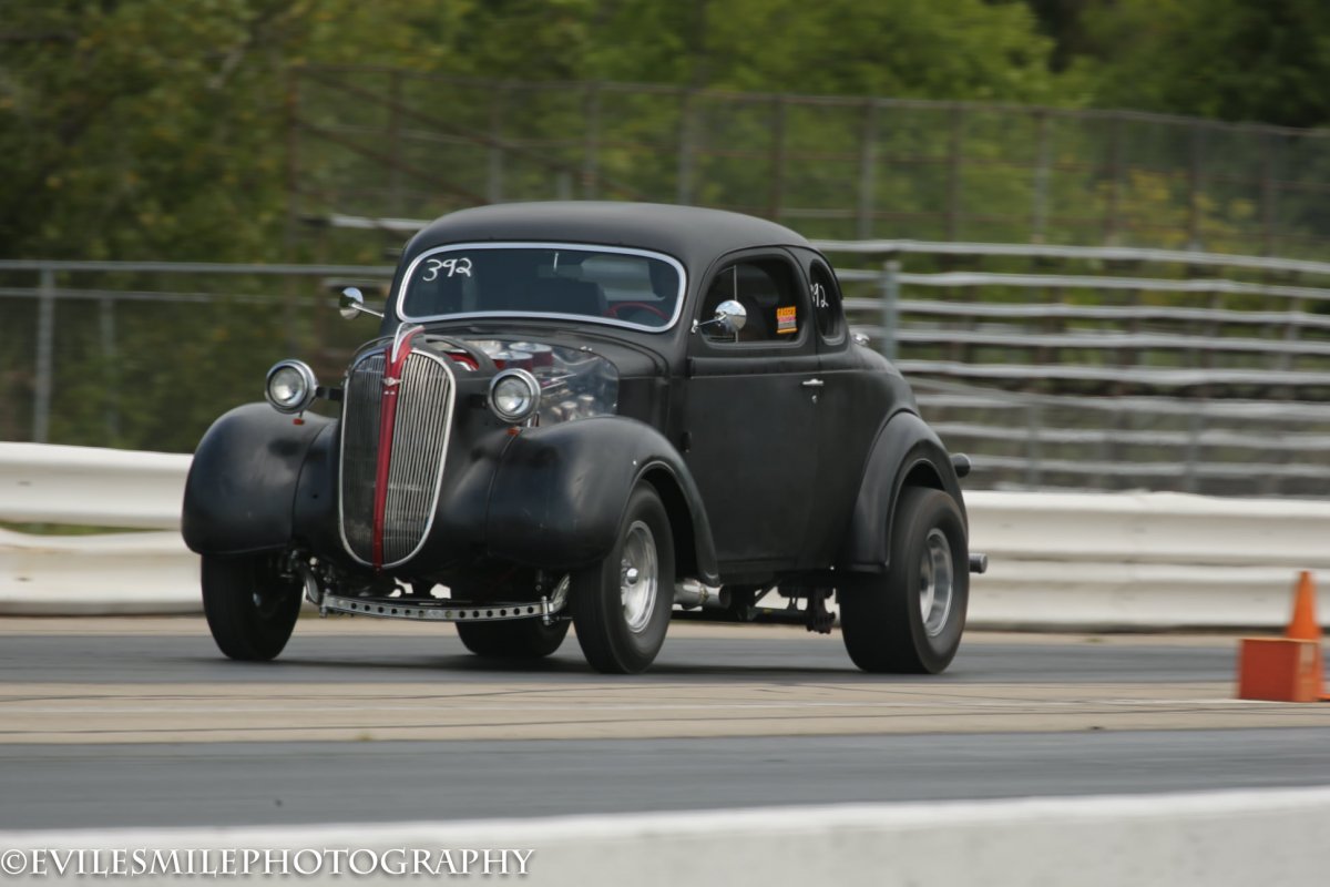

    this is my 1939 plymouth coupe it has a 383 mopar and 727 tf trans , 3:55 8-3/4 shuregrip rear end. 39ply.jpg

    That’s a great looking car too! I’ve thought about the Dakota v6 a couple times especially with a 5 speed behind it would be a great trip car. I’m still picking through it and looking at the amount of rust that’ll have to be cut out but for sitting so long it’s not bad. Especially for having most of the gl*** busted or shot out.

    Good point. Most of the rust this car has would’ve been prevented if it hadn’t been used for country target practice and most of the gl*** busted out. My outer door skins are still strong, it just rotted out from behind.

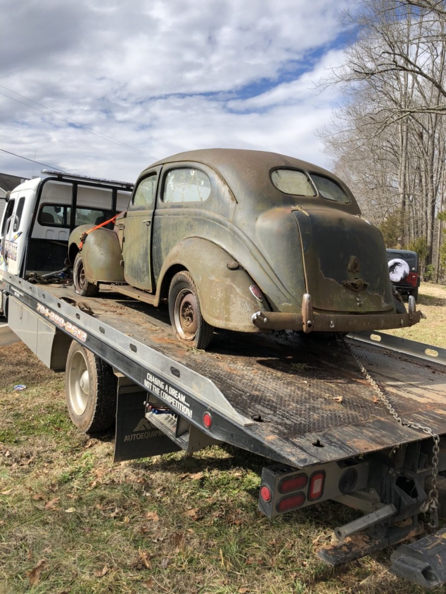

    Man those are both beautiful cars! That flathead looks way cooler than mine currently for sure. I’m still going to attempt to free up this motor and see if she’ll run but I’d be lying if I didn’t think a v8 wouldn’t look good in there. IMG_4924.JPG

    If my rusty memory does not deceive me a V8 swap is not that easy on those due clearance issues with the steering so unless you want to go for all out performance I agree with hkestes above with one twist: try and find a late 265, it's slightly longer but that you can work around by moving the rad and you can get 180 hp and loads of torque out of them relatively easily. That plus a 5sp or o/d box and you'll have a car capable of staying with modern traffic all day long.
