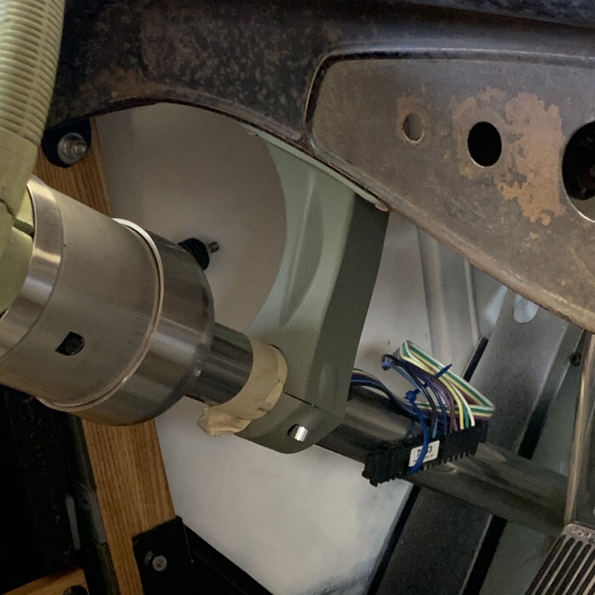

    Here’s one I made for my Deuce pickup. I formed it up and welded a muffler clamp into it.

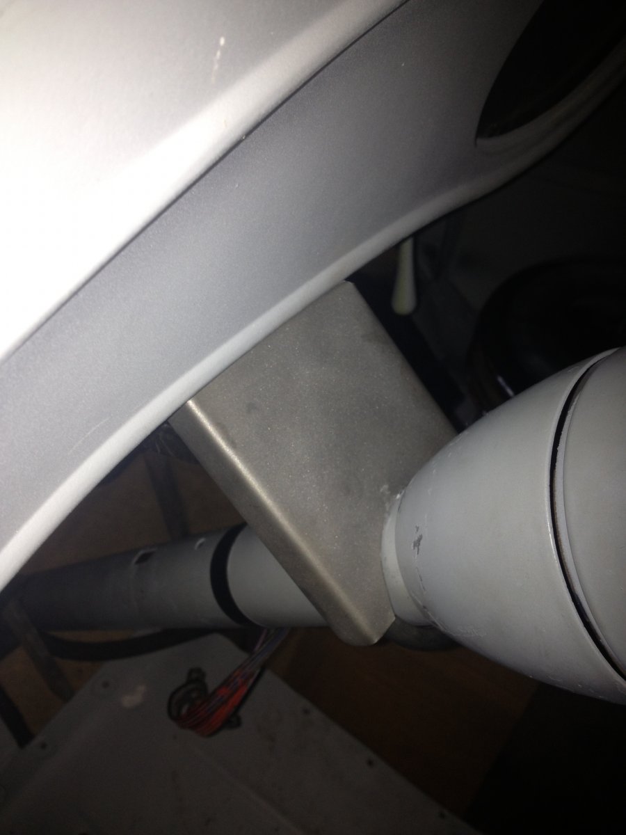

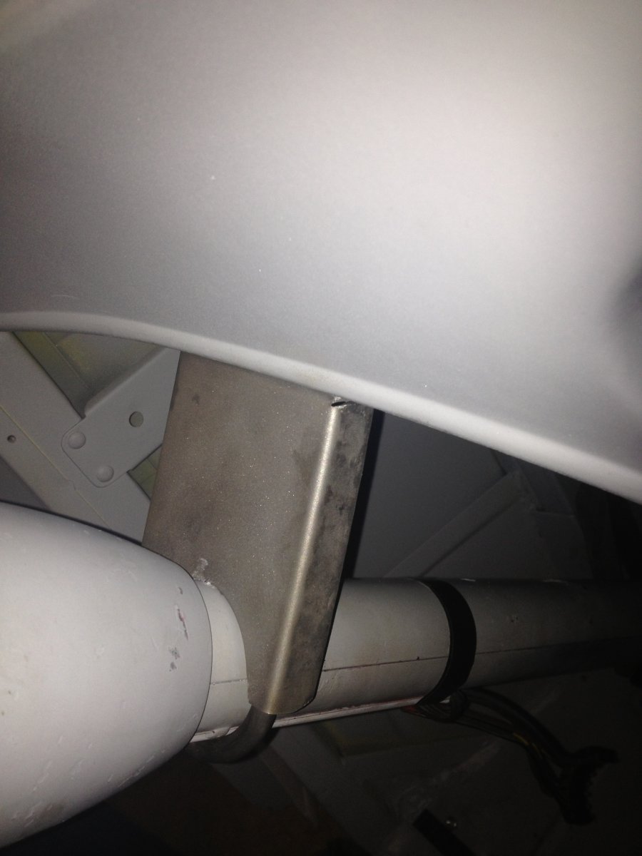

    FE30ECF6-123A-4FE5-906E-3F5F27E0E3D7.jpeg Fabricated this for my ‘31 Pontiac.

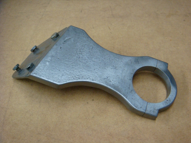

    Carved out of a one inch thick piece of steel for my Model A:
    Rough cut
    Ready for paint
    Doing it again I would make the bottom half below the column unbolt instead of a clamping action.

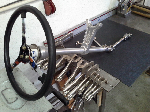

    Made this out of 1/2" steel for a longer version of a Model A for my Tudor.
