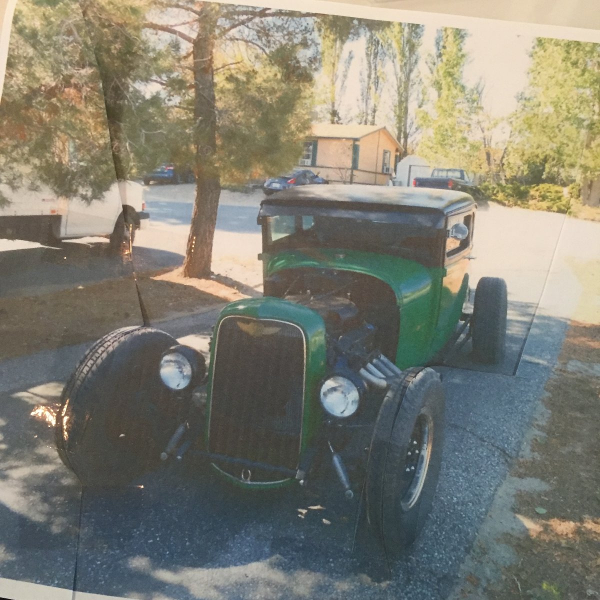

    The tire size now is 235/75/15
  2. Just throw some volkswagon tires on the front and drive it. that'll clean it right up until you decide that you need something different.
    165/80R15 I think BF Goodrich 80 dollars a copy from Summit racing.
  3. Tim
    Joined: Mar 2, 2001
    Posts: 20,261
    Tim
    from KCMO
    Dang man that's pretty close! Maybe an inch shorter tire up front to bring the nose down about a half inch and your there.
    I didn't make them shorter but look how much better it looks with a skinnier front tire
    Yeah I'm a bit of a photoshop wizard you might say ;) lol
    abe lugo and flyn schlosser like this.
  4. mcsfabrication
    Joined: Nov 26, 2006
    Posts: 1,067
    mcsfabrication
    Mr. Porkn****** hit the nail squarely on the head. Discount Tire will do you some 165 x 80 x 15" radials for around $55.00 each delivered to your door. Delivery is free. Think they're Nexan brand. I have them on the front of an Anglia. Balance perfect with no weights, and ride nice. Would change the entire at***ude of your car for $110.00.
    flyn schlosser likes this.
  5. You could easily drop back to a 70 series and give yourself some rubber rake, but the skinny tire is going to be shorter anyway.
  6. flyn schlosser
    Joined: Oct 13, 2014
    Posts: 331
    flyn schlosser
    from Elko,NV
    Thank you for the info .

  8. Rocky
    Posts: 17,625
    Rocky
    Classified Editor
    Haven't read all the posts but if you want tall skinny 4.5" bolt pattern wheels, go with 40s-50s International pickup wheels...they're 16 by 4.5" and have the 4.5" bolt pattern.... also have the proper bumps in the wheel centers to take a 40-48 ford p***enger car hubcap.
    Tim likes this.
  9. flyn schlosser
    Posts: 331
    flyn schlosser
    from Elko,NV
    Those would work perfect not sure how easy they will be to find.Im on the look out now .Thank you

    I'm suprised nobody has said add a hood. You want a Bonneville style car....a hood goes a long way. Look at your avitar. You can always take off to change up the look.
    And yes tires need to be at the top of the list
    Clark
    AHotRod and flyn schlosser like this.

    Yep, tires wheels, and seats look a little out of place!

    I agree on the hood. I have a stock model a hood fits nicely at the cowl but my car is about 8inches longer . Thought about trying to find someone to make one .
    Clark likes this.
  20. Clark
    Joined: Jan 14, 2001
    Posts: 5,132
    Clark
    A hood for your car is fairly easy to make. You could use a large piece of pipe, a oxygen bottle or even maybe a telephone pole
    AHotRod, Tim and flyn schlosser like this.

    There was a great tech recently about a guy making a Model A hood top out of a Ford F-1 pickup hood, looked really simple and could be made any length, no metal forming was involved. I like your car without a hood but if you really wanted one (a top at least) that article made it look like an easy afternoon job.
    volvobrynk and flyn schlosser like this.

    Going to clean up real nice. I got a kick out of the door panels, but I would have to get rid of the hexagonal (?) exhaust cover thing. You have a great car and a great at***ude to go with it.
  25. 38Chevy454
    Joined: Oct 19, 2001
    Posts: 6,787
    38Chevy454
    Just like the rest said, lot of good potential with some easy changes. First of course some different wheels and tires. Then some cosmetics and other simple clean-up fixes. The VW front tires would be easy money and might even use your existing wheels for now. However, the all new wheel and tire package may be better to just pay now and be done.
