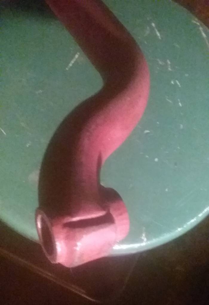

  10. 20201025_214037.jpg I'm thinking that trying to drop that tiny bit of an axle would not be a safe idea but I'm no expert. Most Anglia G***ers upgraded to a tube axle. Might be a better idea to have a tube axle made to fit your spindles.

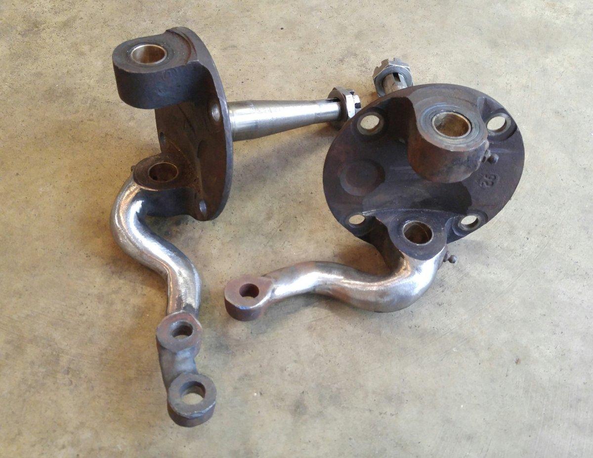

    Have you asked @jackandeuces ?
    He's bent a lot of Ford axles & spindles- including mine- and his process was featured in the last Rodder's Journal. He's in Hampton, VA. IMAG0189-1.jpg spindles 01.jpg
