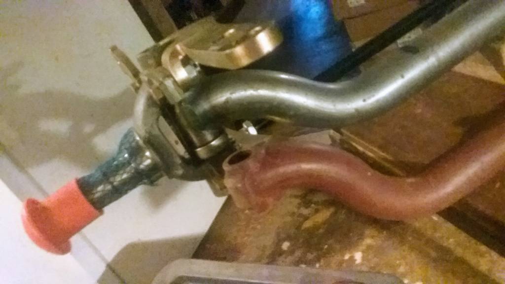

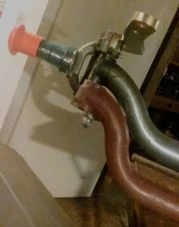

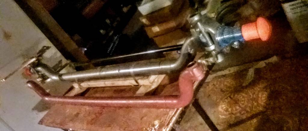

    Looks like your getting some good info...
    I took a closer look at my axle and I was off on the pin bore .
    The boss is 1 3/4"Long , 1 1/4" OD. , pin bore is actually a
    "**** hair" under 7/8", haven't gone digital yet.
    Up against my speedway axle thats going under my Studebaker champion, its small. 20201026_163628~3.jpeg 20201026_163532~2.jpeg 20201026_163313~2.jpeg 20201026_163728~2.jpeg 20201026_163359~2.jpeg

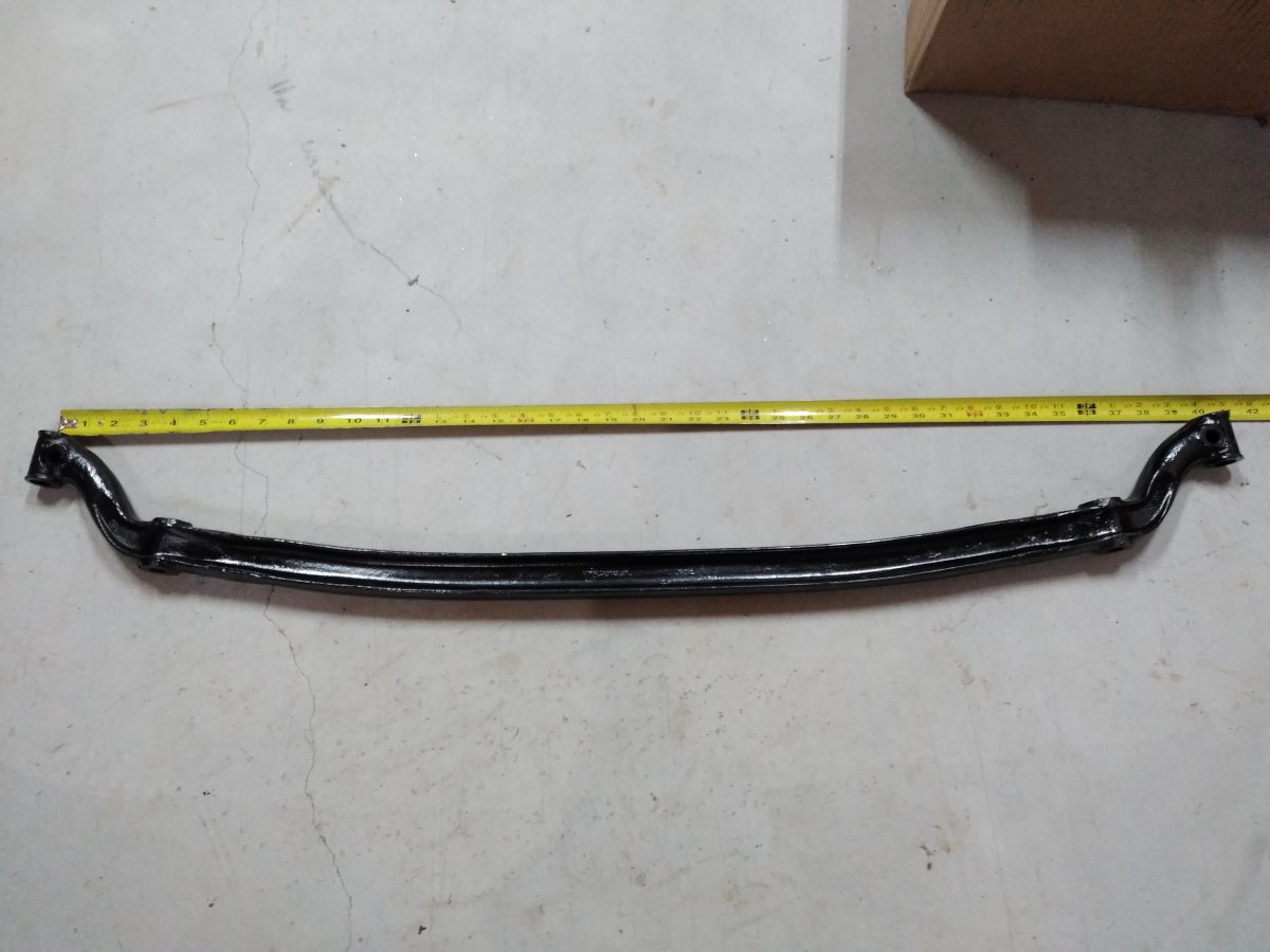

    OK, the axle came back today. Joe's and Nostalgia Sid's both said they would do it. Joe answered first, so I called him first. He said he would make a jig and it would be about a month. I called Sid and he was a little more into doing it. I sent the axle to Sid. He got it 11/19. Dec 7th I got a little antsy and emailed. Tresea got right back to me and said they were working on it today. Sid finished it up 12/30 (Darn, I don't know how he can make any money at that rate :) ) It took a month either way. I hope Joe wasn't counting on it. I watched an interview with Sid on the YouTube, he and Joe used to work together. Apparently, Oklahoma is a hotbed of axle dropping activity.
    Sid dropped it about 2". It did narrow the axle 1 1/2". (It was 41 1/2" CTR to CTR. Now it is more like 40") That's OK, I'm not sure I would want to stretch-drop this dainty of an axle, even for my lightweight car. We'll see if I can turn around in a parking lot :). It's clean and painted black. He said he straightened it and set the caster. To what degree, I don't know. I'll have to call him. It rings like a bell. I'm not stripping and magging it. It looks nice.
    Both Joe's and Nostalgia Sid's were a pleasure to work with. You have to hand it to Joe, he's still kickin' it out at 80. I would recommend either. This whole thread came about because if you Google "dropped axles", Sid's pops right up. I filled out the online form and sent it on. He didn't get right back, I got antsy and started this thread.
    I want to thank everybody on the H.A.M.B. that had leads. That's what this is about. I know there is nothing on the web about dropping Anglias, I searched for 412 hours (easy, COVID and all). We had our nay-sayers here, I knew better. Like I said, some people have mad skills. There is no nationwide phone book of axle droppers. When the Google comes up empty this place, and ones like it, are where it's at. From now on, this post will be out there. I understand how this whole message board thing works. I was doing EGroups in the '90's. My living relied on posting about my (former) OT engine/stroker kit/blower kit business on a bunch of boards for about a decade. ( https://web.archive.org/web/20011129234223/http://www.accuratepower.com/ , me in 2001 ). This stuff helps the H.A.M.B. as a whole and increases their web presence on the Google. The same goes for every shop we mentioned.
    Thanks again, Mike

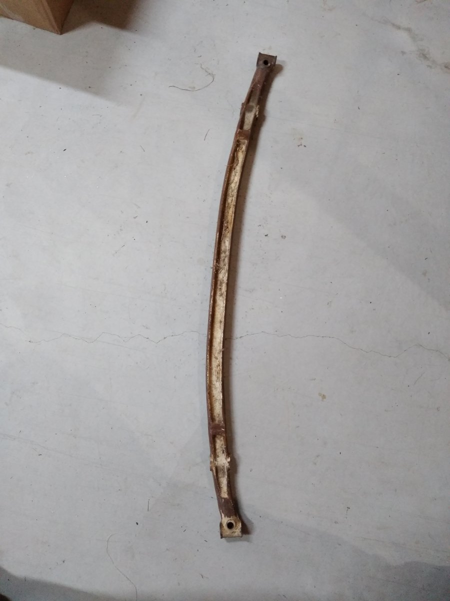

    Specials
    This is Ballamy-esque as well.
    Oh, do tell !
    I'm half tempted to split mine and do away with lateral location (panhard, watts etc.)
    Mike
