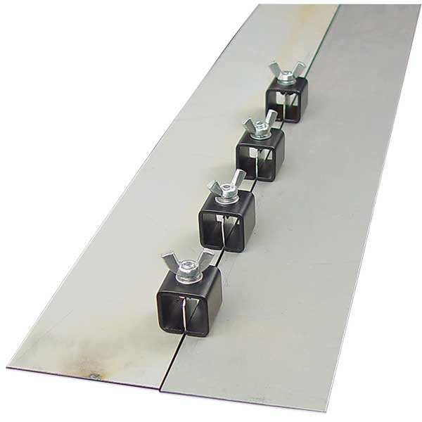

    I can’t recall what the name of those things are. Instead of a round piece setup, they used thin flat stock. In between the pieces to weld.

  4. tomcat11
    Joined: Mar 31, 2010
    Posts: 1,141
    tomcat11

    Thanks all, just what I was looking for!

    I highly DO NOT recommend them for anything. YMMV

    Why not? I have a pin hole in a roof. Plan is to use a hole saw, the use a larger hole saw on sheet metal, turn it down to fit the first hole. I just need 3 probably to get an even surface for some tack welds.

    I use those occasionally but prefer rare earth magnets. The problem witth these is that if you make your patch fit tight enough, when you tack the patch the weld shrinks and they are hard to get out. Plus, they are made for straight cuts, so a circular cut would require a larger gap. Use magnets.

    I planned to open them wide, and grind them narrower, last time I tried magnets welding a patch, I had to be far away from them, really messed with the wire welder.

    Just use the magnetic to hold it in place until you get 1 or 2 tacks. You do have to be an inch or so away from the magnets. How big is your patch?

    I'll second this. ^ Bought the Eastwood version long ago, used them once, and never again.
    In a perfect world with no expansion and shrinkage, they would be great, but things move, sometimes access to both sides is neither simple nor easy, they are a bit finicky to set up...as suggested, a strong magnet (those 90* angle holder magnets are fine) would be easier in just about every way.

    Too big a gap, only work decent on completely flat metal even worse on a curve cut etc.
    use the weakest magnets you can find for small patches. I like refrigerator magnets.
    Start the weld on solid metal and pull to the patch.

    Yes, if the patch is that small, small ceramic craft magnets, about 1/2" diameter work well.

  17. I also found them very hard to get out and will not use them again.

    If your patch is not heavy, I use masking tape !!!

    Totally agree with this. Never more than a 45 deg angle.
    Another trick I use for small plugs like this I'll often start with a strip of metal slightly wider than the hole and scribe the shape on it.
    Cut it out leaving a small tab which can be bent up to make a handle to hold onto while I do the first tack or 2 then trim it off.

    Round corners are key for keeping even heat on sheet patches. If possible drill your corners first using a step drill bit or sheet metal hole auger (I'll remember the bit name in a sec). Or use a hand nibbler and file to round the corners. After that the patch is just a trace and cut.
    As said above magnets work much better than the clamps. Weird of caution though if you are running Mig. The arc will start to get screwy as you get closer to the magnets. So don't forget to pull them off after you tack.

    I've seen some clamps in online videos that look like a threaded bolt that is split in half long ways and has thin L-shaped end pieces that slip under the two sheet metal panels. Then they tighten a nut on the threads and it grips the two panels and pulls them up together and levels them out. Not sure what they're called or where to get them, but the thin ends look much thinner than the popular butt weld clamps with the wing nut, so it should have a much thinner gap between the two panels.
    I ground down my HF butt weld clamps to have a thinner gap between the panels. It helps a lot, but they don't last long.
