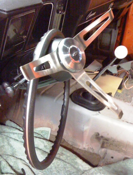

  2. Build one. I did this for my GMC using a new 15" Speedway circle track wheel and the stock Jimmy center. A pic of it in progress.
    dana barlow and hfh like this.

    Did you weld or rivet the center in?
  5. Yes, the center is welded in. Under the plastic the GMC spoke were round steel, welding was easiest

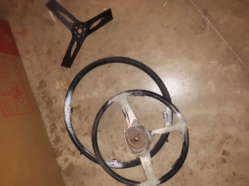

    So getting back to making a steering wheel. I picked up a damaged 39 ford banjo wheel to cut down. I have a 14 inch hoop getting made and I will cut the spokes down and weld it all together. This brings me to “how do I cover it”.
    3d print the grip? Wrap in with vulcanizing tape? Vulcanizing tape and a s***ched on leather cover? Make a resin mold?

    weld a good usable wheel to your center. JB Weld imperfections in the wheel
