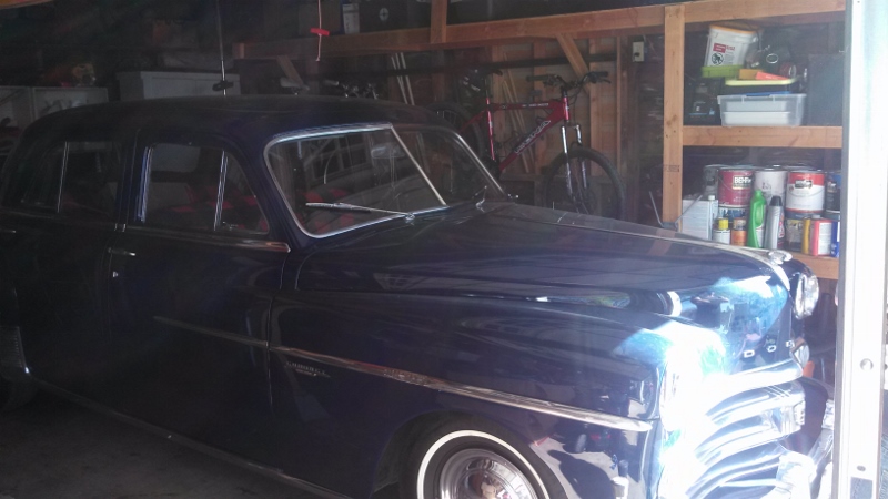

    After tinkering and checking and filling, I took the Dodge out to test it. Although it was a kick to be able to drive it through town, it still isn't shifting.
    -I checked all the electrical connections and made sure they were clean and tight
    -I drained and filled the transmission and filled the coupler.
    -I can hear the solenoid clicking when I let off the gas pedal to up-shift, and I can hear it click when it automatically id supposed to downshift.
    -Still no shift. I guess it's back to the manual, and do some more testing.
    I am glad I got the shop manual.
    Still it was nice to finally be able to get it out on the street. I wasn't sure if I would get it back in the garage, but I had to take the chance. Living on a hill....

    Well, here I am at decision making time. I don't want to spend a lot of time on the gyro-matic.
    I have decided that I am going to adapt a T5 and newer rear end in to the car. Since I do no have a place or the tools to do this myself, I am employing a local shop to do the work.
    I want to save as much $$ as I can, so I will be gathering the parts myself..to the extent that I can.
    So...I wanted to make sure I am covering as much as possible in that regard.
    Please take a look at the list below and if you see something wrong or missing, let me know. I would REALLY appreciate it!
    - T5 transmission from a Chevy S10 (1985-88); This would include the bell housing, clutch and ????
    - an adapter plate
    - A complete rear end from a Jeep Cherokee(1984-2001- preferably 8.25 Chrysler w/3.55)
    - Spring perch re-location kit(do I need to do the same thing for the shocks?)
    I know there is some fabrication involved(clutch mechanism; rear support for trans; new drive line; etc). Is there anything else I can or need to get for the shop to be able to do this so they have it on hand? Or is the rest pretty much fabricate on the spot as it comes up?
    Thank you again guys for all the help and information! I have really learned a lot from all your posts.
