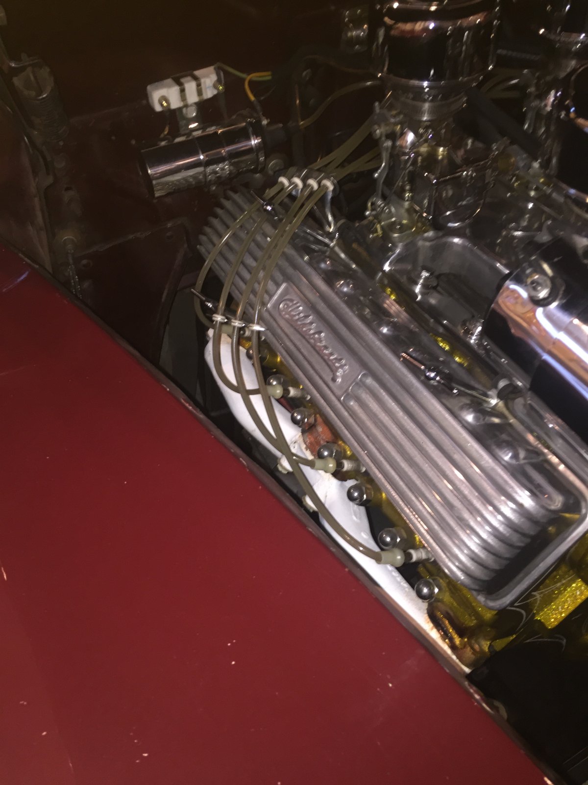

    The reason why white is hard to achieve. Even if the coating survives the heat ANY contamination from a finger print to a drop of oil will burn into the surface. 58924cda56326b0daf6474195c610ef7.jpg

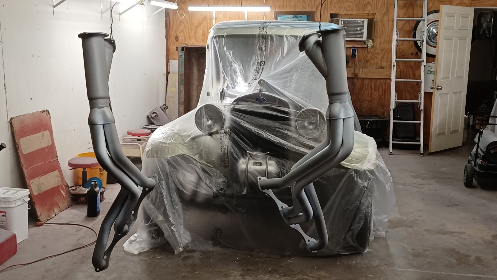

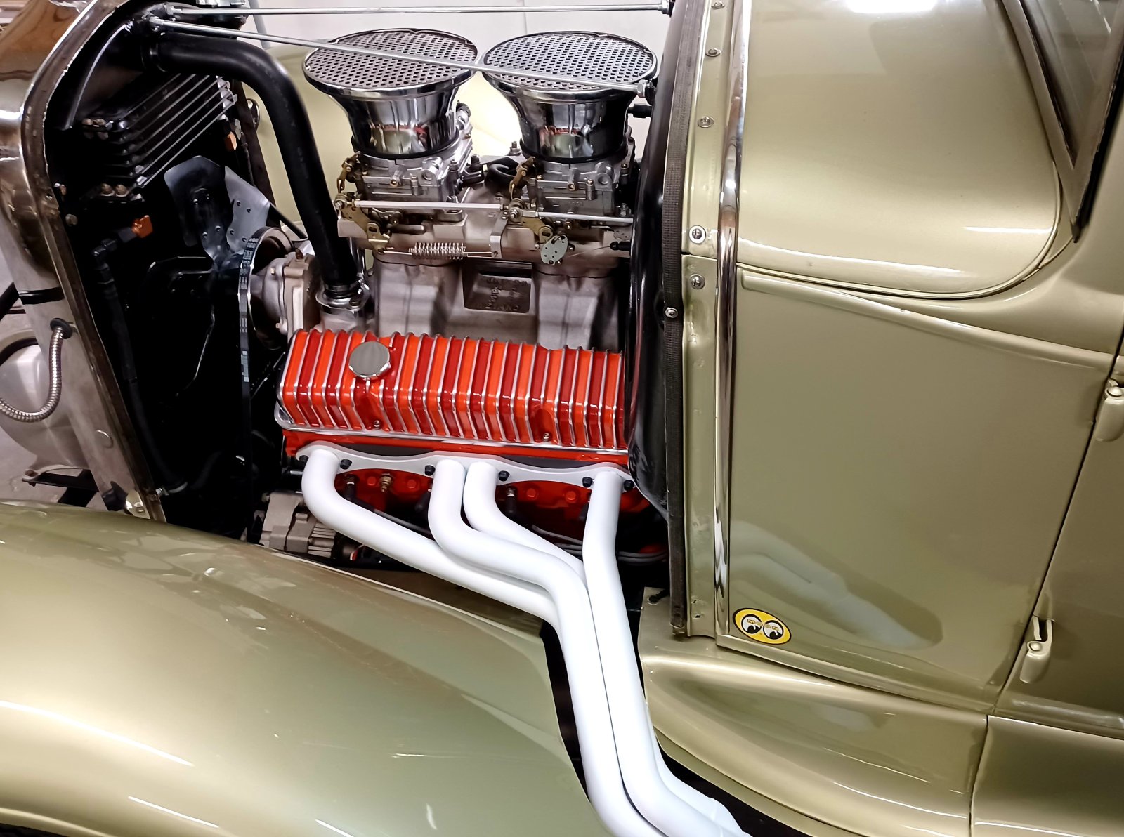

    You're halfway there. :) True, the cerakote will brown over time - but it will also insulate any paint you put over it. Just spray them with high-heat white Rustoleum right over the cerakote.
    I did exactly that on my A. And in a year and a half, I only had to do one minor touch up.
    Here are a couple of pictures of the raw (gray) cerakote and after, with the white paint.
    Yep, that's why being able to touch it up with spray paint is an advantage. :)
