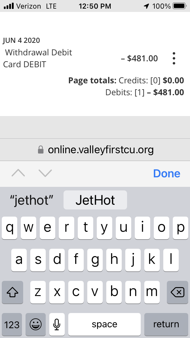

  18. Budget36
    Joined: Nov 29, 2014
    Posts: 15,210
    Budget36
    Wow the price at JH has gone way up. I’m pretty sure I had these done during the pandemic. I’ll check my statements for when I had these done.
  19. Budget36
    Posts: 15,210
    Budget36
    71FF550E-6890-4D2C-8B6C-BAC92D576DDA.png 71FF550E-6890-4D2C-8B6C-BAC92D576DDA.png
    This was in June of 2020. $481.xx
