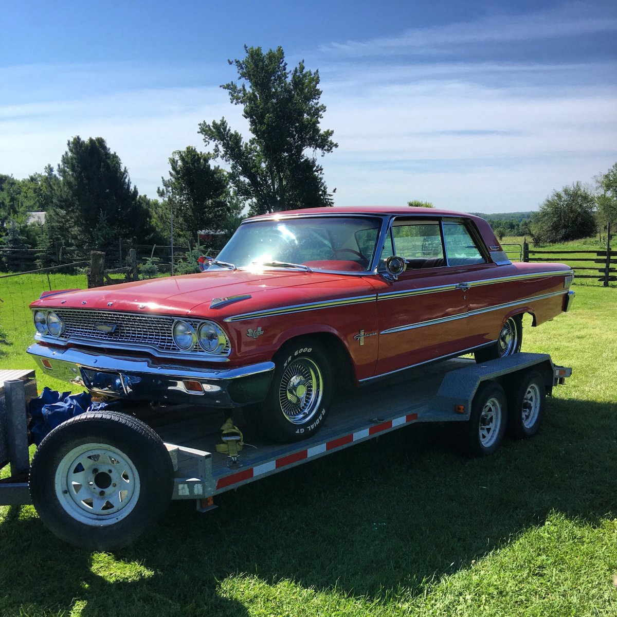

    IMG_5419 2.jpg Just picked up a clean 1963 Galaxie G-code car. Unfortunately the 406 is long gone, my hopes is to once again have this full size ford back to its full glory. I am currently on the look for any 406 parts, namely proper heads and 6v try power set up. I will consider any other parts also, so if you have or know someone who has any 406 junk please let me know. I'd love to have a 406 back where it belongs.
