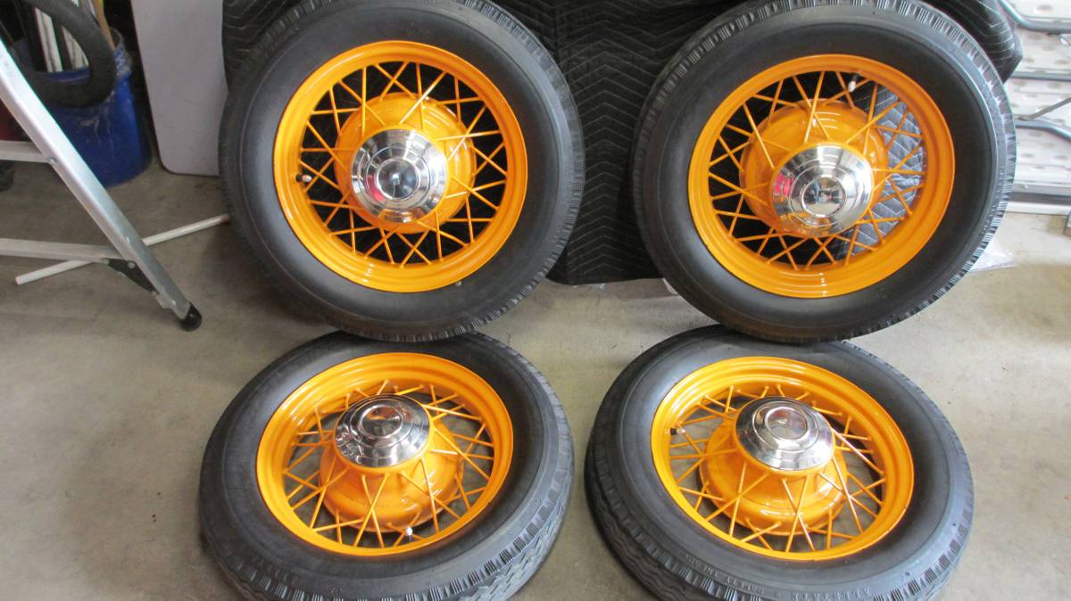

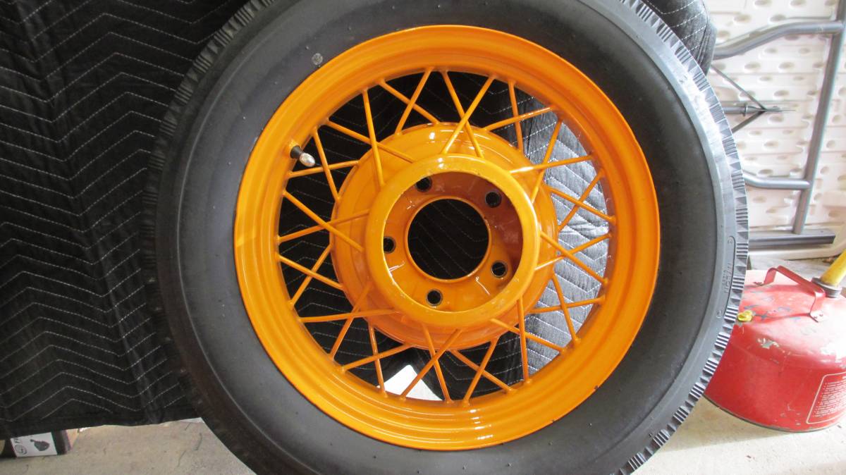

    These are on CL in Buffalo
    They are 17 inch with amazing rubber.
    These are what a kid in the early '40s would switch to.
    The will start your car looking like a Hot Rod.
    They are reasonable @ $500 OBO as the ad says.
    And you can easily sell the ones you have to a stock A guy!
    So they are cheap after a ride to Buffalo.
    I HAVE ZERO connection to the seller, but they will probably
    end up in my garage if you don't buy them!
    Here is the link: post id: 7251576228
    Your car will be KILLER with them!
    All the best for a great New Year!
    Seems like you started out a winner!!!
    PS: If you want to play as you go, later
    you can put a set of 7-00-17 tires on the rear.
    They are usually at least 31 inches high.
    An easy way to change your rear end ratio,
    to get more top speed without changing anything else!
