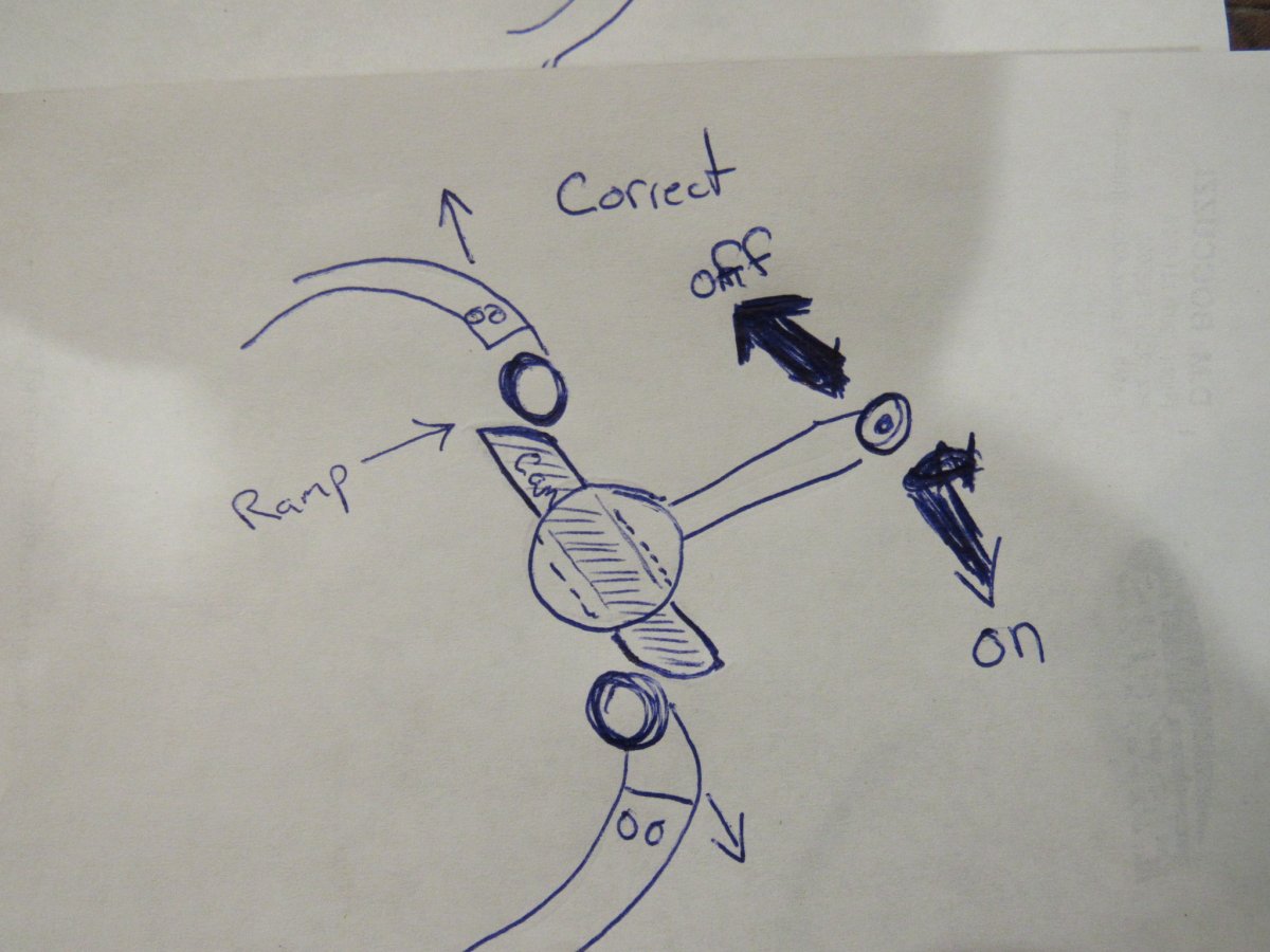

    there is a procedure for properly adjusting the brakes. there is a major and minor adjustment procedures. after you fix the cam you should do a major adjustment.
    I always retard the spark before shutting a model A down. when it is timed right it should "putt, putt putt...." when it is retarded. IMG_1520.JPG IMG_1521.JPG sorry for the crude drawings

    tb33anda3rd - Swapped the rear brake cams around. They were opposite your drawings on both p***enger and driver. You’ll see from the pics that the cams were worn and I had to smooth them out before reinstalling. Did another more thorough brake adjust. Rears don’t lock up now. Thanks again for your help.
