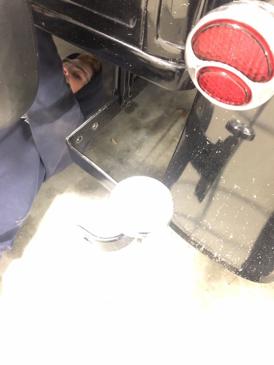

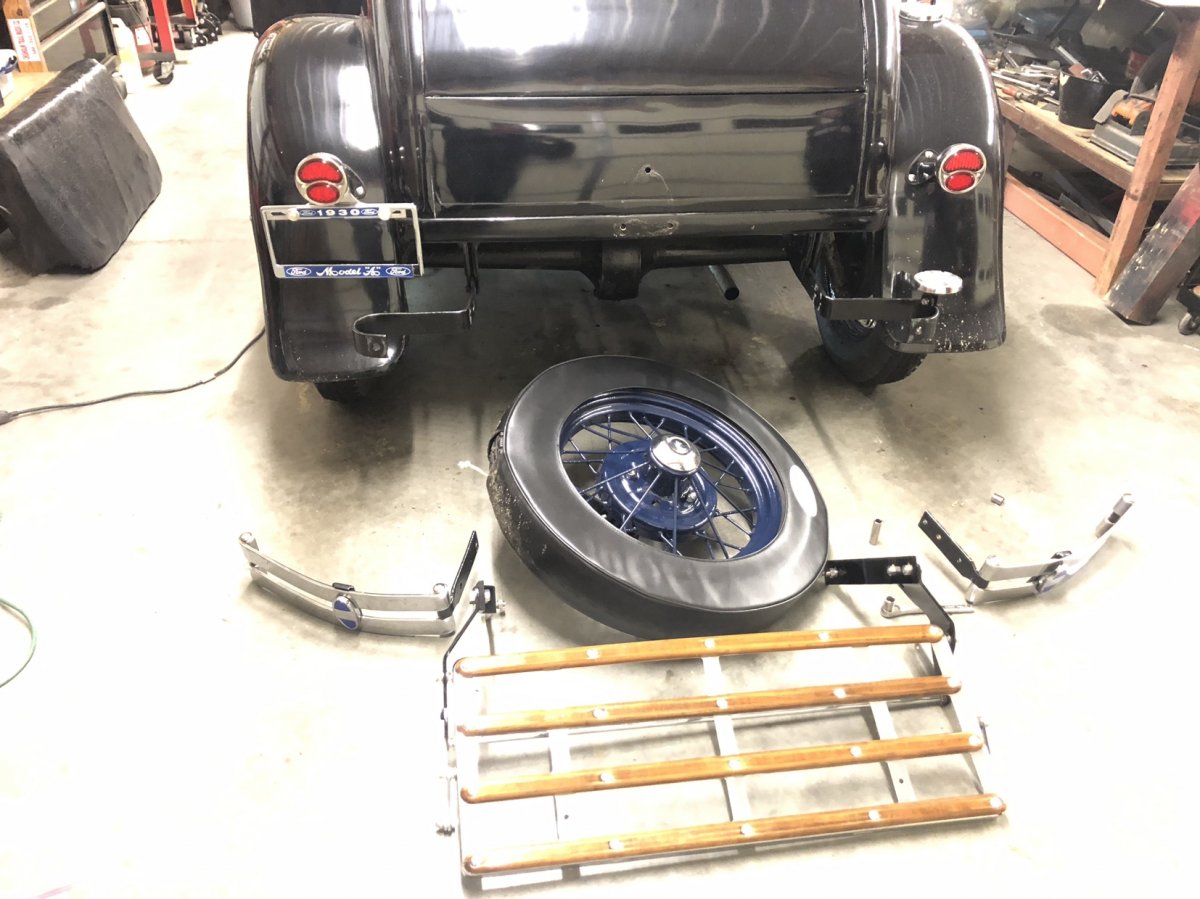

    Starting to take parts off.
    What do I do with this part of the rear bumper? Cut it off?

    That's for access to the rumble seat!

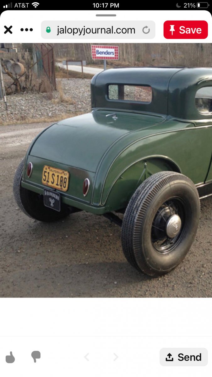

    Yeah. I get that but it is going. Not sure of the best procedure. Going for the look in this pic.

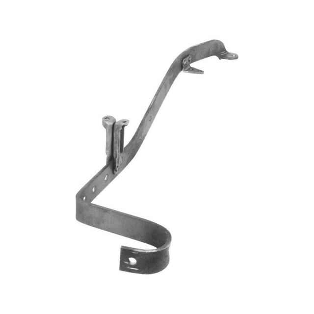

    The rest of the bumper bracket just bolts on, Look!
    And yes, sell them with the whole package!
    While you are at it, the rumble lid reverses and becomes a trunk.
    Then you can sell the rumble seat, maybe to the same guy as the bumpers!
    See where this is heading? Keep taking parts off and you will be able to buy
    a lot of the stuff you need. It's how lots of old time Hot Rods
    got built!

    Doesn’t seem like much support left under the rear of the car. Hmmm.
  26. Tony Martino
    Joined: Apr 2, 2010
    Posts: 3,930
    Tony Martino
    The frame ends at the rear cross member where the spring mounts.
    The rest of the body just hangs off!
    Most times they were just cut off, right where the 2 uprights
    connect leaving them to bolt up for more structural integrity.

    My thought was if I cut it off it at least it would provide some support. I mean there is a rumble seat back there. Not sure what to think about that.

    BTW, The picture of the green A with no brackets showing
    looks like it's on a '32 frame.
    That's a whole different ball game.
    The '32 frame has rails that stuck out
    behind the rear of the body to mount the gas tank.
    To get that look they were gut off at the end of the A body.
    Also, I can't really tell from that pic, but it looks like that car has
    maybe a '36 rear end with the spring behind, not on top of the axle.
    This requires moving the rear cross member back.
    Non of this is relevant to your build with a stock A frame,
    but it will limit you reaching some of the look you may want.
