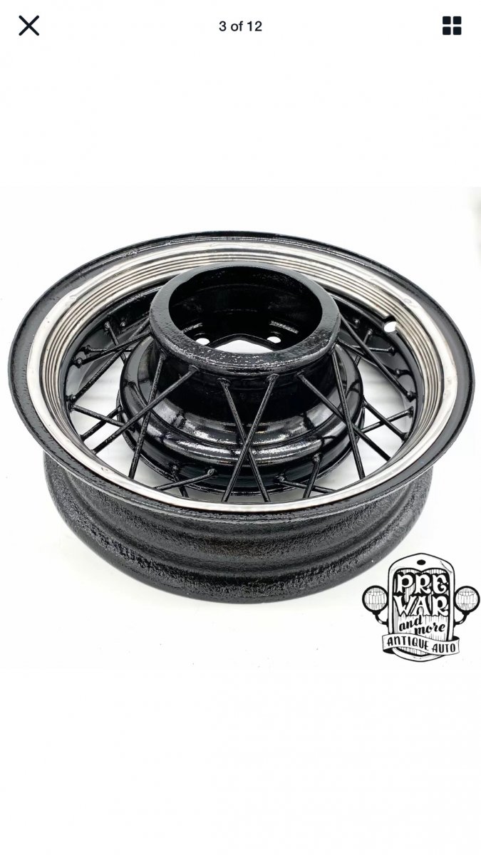

  13. Tribalmonkey
    Joined: Feb 17, 2019
    Posts: 921
    Tribalmonkey
    Hmmmm. Well I’ve all ready pulled the trigger on these. I like the look of the 1935 wire wheels. I like black. They have already been blasted and powder coated. I know they still look a bit rough. So... maybe just tell me it will all be okay. Ha!

  14. Tribalmonkey
    Posts: 921
    Tribalmonkey
    I was on the fence. I like the look of both but now I’ve bought these. Hopefully they are straight without issues. I think they will look good with some center caps.

  18. I mentioned that a while back as well.
    Those wires look pretty damn rough. I would triple check them before sinking any extra coin into them

  22. alchemy
    Joined: Sep 27, 2002
    Posts: 23,465
    alchemy
    The nubs are on the hubs, not the wheels. There are support nubs, or sometimes a ring, inboard of the studs that support the inside of the wheel. This sits about a quarter inch proud of the mounting surface. The stock A wheels and any wires through 35 need this support to bolt up tight. Otherwise they look like they are bolted up, but they will flex and crack.
    If you decide to run later wheels like 40 Ford steelies you will need to remove this support nub from your A hub. Or, conversely, if you decide to use later juice brakes like 40 Ford brakes you will need to add in support to keep your wires in good shape.
    https://www.speedwaymotors.com/Speedway-1928-35-Ford-Wire-Wheel-Center-Support,5846.html
    lothiandon1940 and 31Apickup like this.
