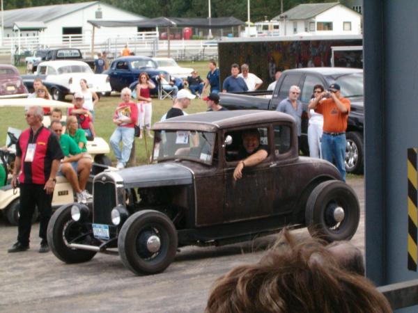

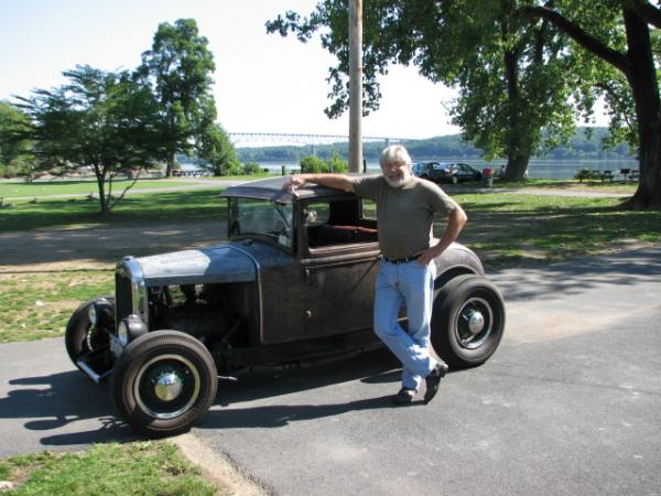

    Hey Tribalmonkey,
    I'm not recommending this for you, but if you are not running fenders,
    I tried to always use 7-50-16 rears and 6-00-16 fronts.
    It provides the rubber rake while you work on a 4 inch drop axle,
    reversed shackles, leaves out of rear spring, etc etc.
    Also, most guys, and Coker for sure, will tell you not to
    run 7-50s on a 4 inch rim. I did it for 12 years and at least 5 sets of wheels on my '31.
    I don't own it any more but I don't think the new owner will mind!
    BTW, this car is on a '32 frame, 4 inch drop front axle, 36 rear, spring behind rear
    axle, cross member moved back 7-1/2 inches (I think)
    Sorry I drive a lot and don't take many pictures!

    Oh man! That’s nice. Tire size looks perfect. I’m in.

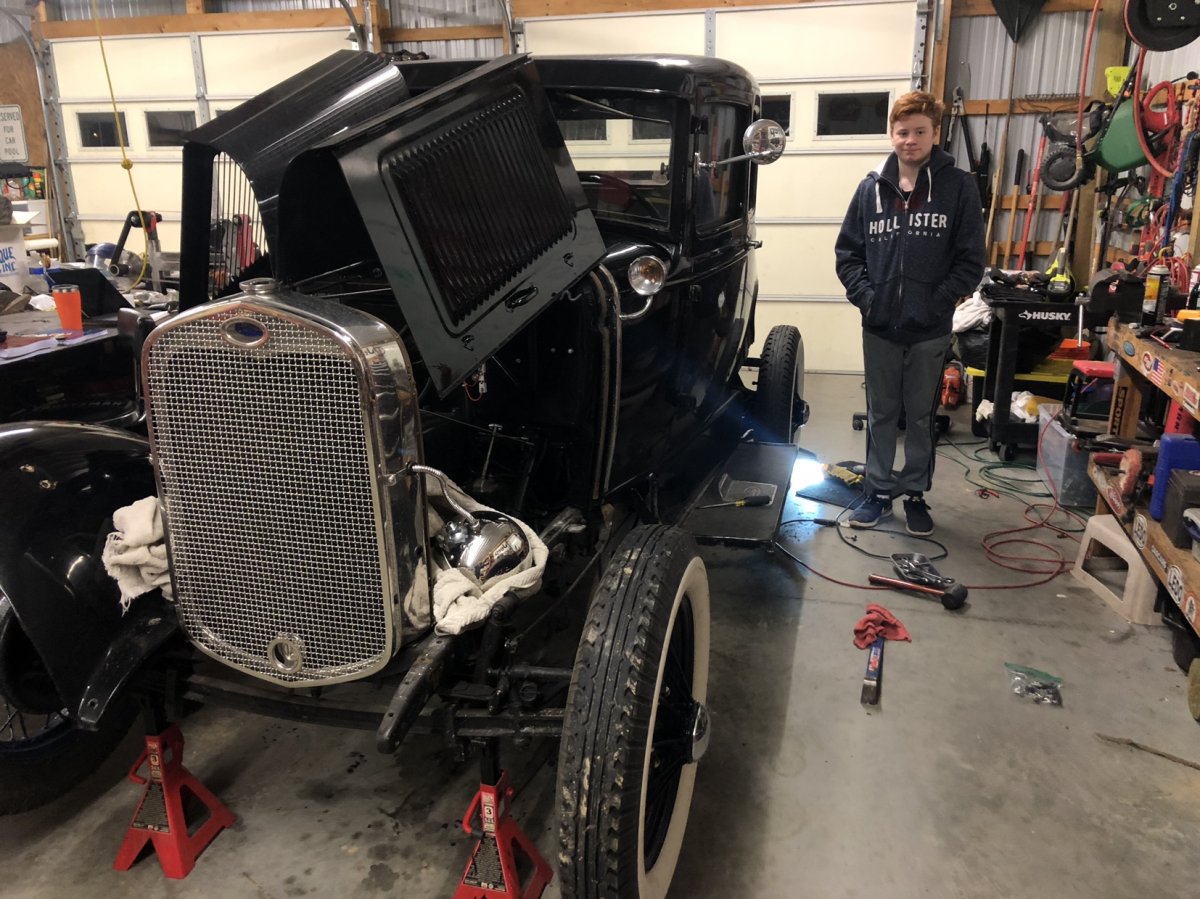

    I know you said you had a 32 frame but what would I have to do to get that stance?

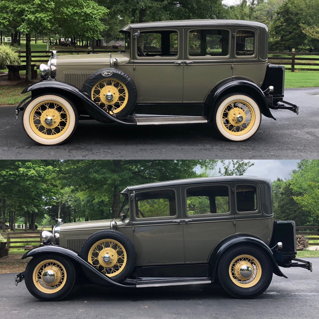

    I just looked at @drdave thread on the size he is running. Coker Firestones 5.50/16 front, 7.00/16 rear.

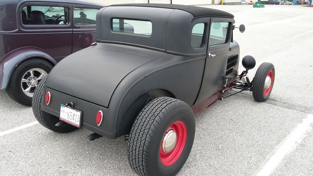

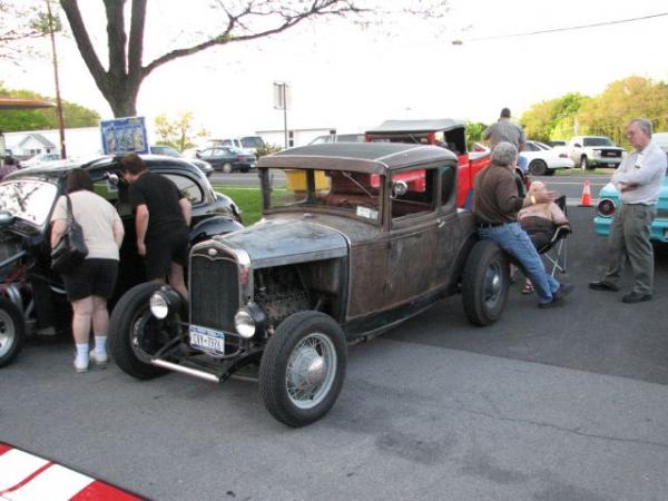

    Take a look at this thread
    Any pics of fenderless, unchopped Model A coupes?
  9. Tony Martino
    Joined: Apr 2, 2010
    Posts: 3,930
    Tony Martino
    A lot of differences in this thread.
    This pic from the thread is about what yours could look
    like without too much work.
    I think it's very cool just as it is.
    It has a late '40s early '50s kid car look which is
    sort of my favorite.

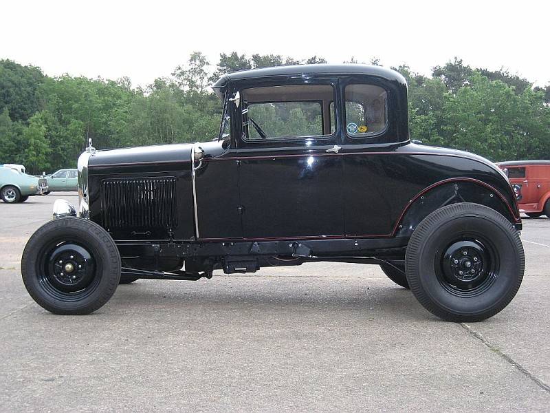

    As @arkiehotrods already said above, I’m running 550’s up front, 700’s in the read on my 4dr sedan. I’m running a 4 inch dropped axle, 32 spindles in the front with reversed eye main spring and several leaves removed. With the tires that got me right at an 8 inch drop. The back is a T spring. The 700’s are a bit taller than the 19 inch stock A wheels and tires, but the T spring is lower than the A spring, so that combo brought the tail down about 4 inches. Oh, and I’m still running the mechanical brakes.

    drdave - Great stance! Thanks for sharing your information. Nice to see what can be done and still retain the mech brakes. Very helpful.

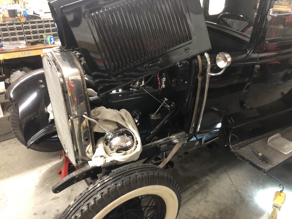

    Ahhh... much better [emoji2]
