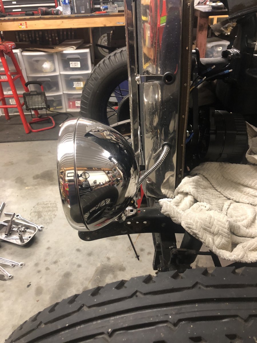

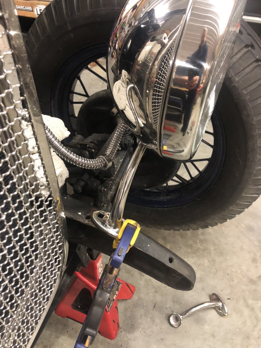

    Any rules, guidelines, or recommendations, for headlight mounting location?
  7. Dick Stevens
    Joined: Aug 7, 2012
    Posts: 4,248
    Dick Stevens
    It will look better if you move them back so the front of the headlight is inline with the front of the grill shell! Also keeping them tucked in close to that sides of the grill shell is good and don't mount them so they get high enough to make them stand out.
  8. alchemy
    Joined: Sep 27, 2002
    Posts: 23,462
    alchemy
    I like headlights a little ahead of the grille shell. If even or behind the grille it looks like they got punched. Give us a head-on view, as that is as important as the sides.

  9. Tribalmonkey
    Joined: Feb 17, 2019
    Posts: 921
    Tribalmonkey
    Yeah. That is what I was thinking too. I’ll send a pic from the front when I get a chance.

  16. loudbang
    Posts: 40,351
    Or you could look up your states MVD regulation on headlight heights and go from there. There is a range between too high and too low :)

  17. Tribalmonkey
    Posts: 921
    Tribalmonkey
    Thanks loudbang! Great pics. As I figured it is just personal preference along with state laws. I think I will place them just a bit head of the radiator. Similar to how they were on the light bar when attached to the finders.

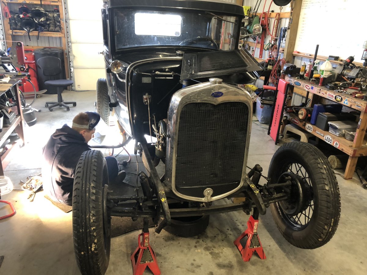

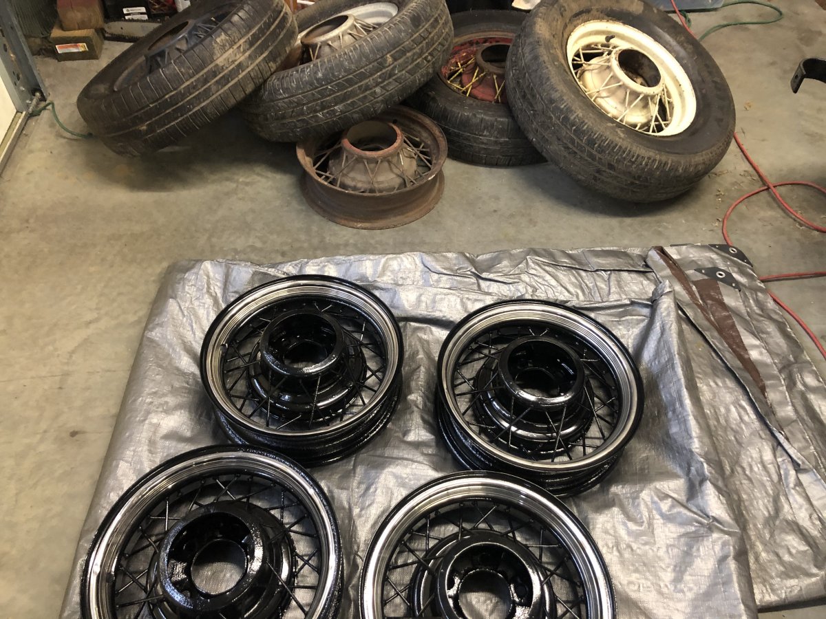

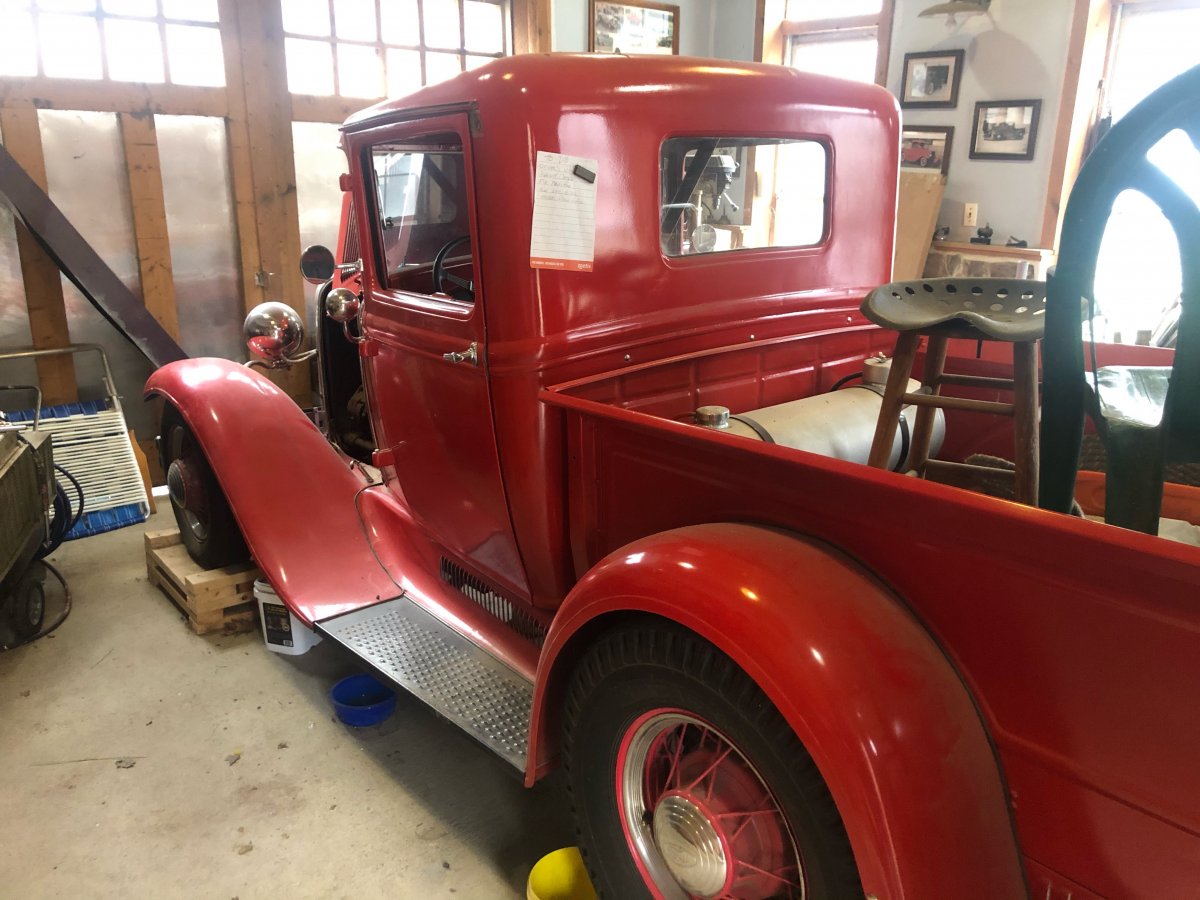

    I spent some time today with dustyp489 who lives about 35 mins away from me here in MD. He is a great guy that has been working on Model A’s for well over 20 years and has a wealth of knowledge. He was very patient with me as I asked a million questions and checked out his sweet 1931 Model A Pickup. He built it to race with a hopped up banger. It even has a roll bar in the cab! At one point he had a 32.
    He sold (tried to give to me but I gave him something for them) me 5 1935 wire wheels he used as rollers. Between the wheels I bought off CL and the ones I got from Skip I am pretty certain I have at least 4 good ones. I’m 1935 wire wheel poor now.

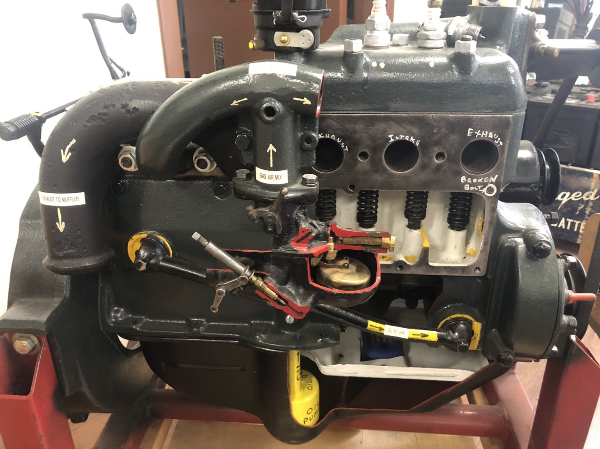

    I also dropped by Bratton’s Antique Auto in Mt Airy, MD. The original owner, Walter, who is now retired and sold the business to his kids, happened to be there. It was pretty awesome. Lothiandon1940 told me about them. They have a whole warehouse full of parts right there. No waiting for shipping!!! I couldn’t help but to buy some more stuff. I got the float motor mounts, valve cover and oil return tube gaskets since I will be digging into the engine tomorrow to try to fix the oil leak. Walter can tell you anything you want to know about Model A’s. He was rattling off bolt sizes and which tool works best to reach certain areas. They also had a ‘cut-away’ banger on a cart right there in the front office. It was pretty cool to see inside a banger. Very happy that there is such a great Model A parts resource so close to me.

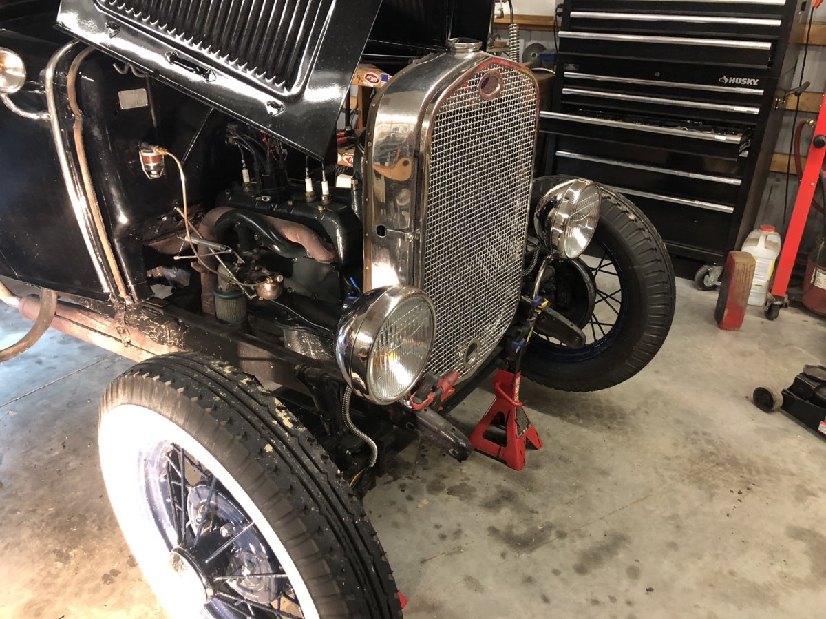

    Headlight placement mock up... again. IMG_5046.JPG IMG_5047.JPG IMG_5049.JPG

  22. Tony Martino
    Joined: Apr 2, 2010
    Posts: 3,930
    Tony Martino
    Hey monkey,
    I think you have to loose the grill guard.
    The headlights are cool, but a '40s teen would never
    keep that grill guard. Another part to fund the build!
    Tman and 31hotrodguy like this.
  23. lothiandon1940
    Joined: May 24, 2007
    Posts: 33,192
    lothiandon1940
    Headlight placement looks perfect to me.:)............Don.

  24. Tribalmonkey
    Posts: 921
    Tribalmonkey
    Yeah. I was thinking about that. Thanks for the input Tony.
    31hotrodguy and lothiandon1940 like this.
  25. Tribalmonkey
    Posts: 921
    Tribalmonkey
    Thanks Don. That is probably where they will go. Job one today is dropping the oil pan, checking the oil return, and maybe getting brave enough to check crankshaft spacing/adjusting the shims.
