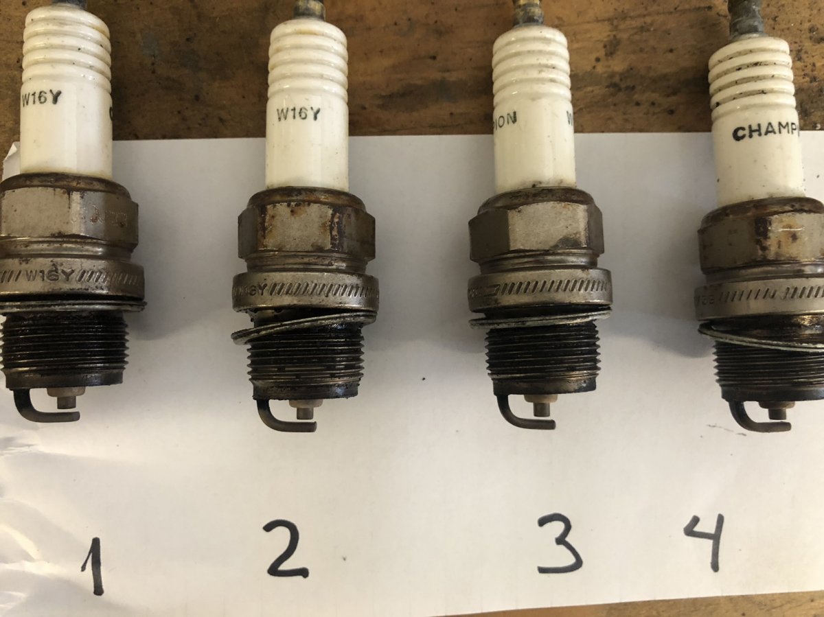

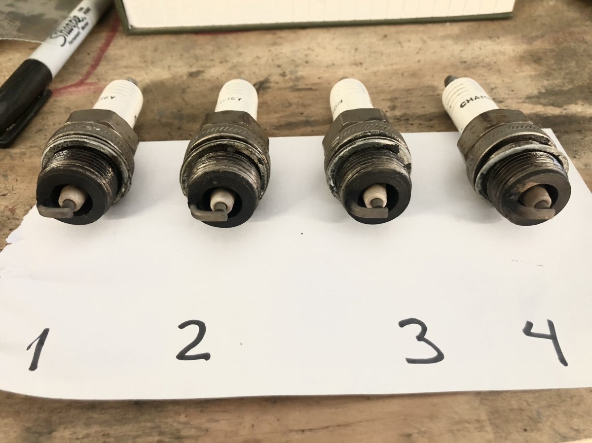

    While working on the engine yesterday I looked closer at the spark plugs. Their gaps were way off (.010 vs .035). I also took note of their condition relative to each cylinder. I think they actually look pretty good and didn’t notice any significant differences between the cylinders. Let me know what you think.

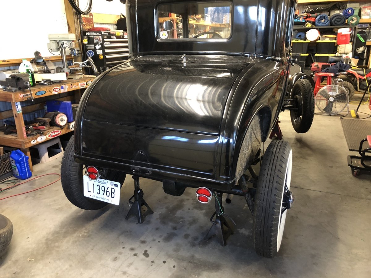

    Tribalmonkey

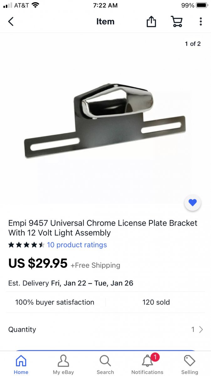

    Working on tail light and license plate placement. I think I’m going to start with placing the original tail lights under the back flush with the rear. I’ll make brackets to utilize the bumper brace holes mounting holes. That will have them a few inches from each outside edge. I think this will look pretty good. I plan to create a bracket centering the license plate on the rear utilizing the spare tire mount holes. Need suggestions on an appropriate license plate light.
    I know this is not right but along the lines of what I’m thinking. Recommendations?

    lothiandon1940
    ^^^Nothing at all wrong with that one^^^:)

    Tribalmonkey
    Built some tail light brackets. IMG_5101.JPG IMG_5102.JPG IMG_5104.JPG IMG_5105.JPG IMG_5107.JPG

    Tribalmonkey
    Gettin there.

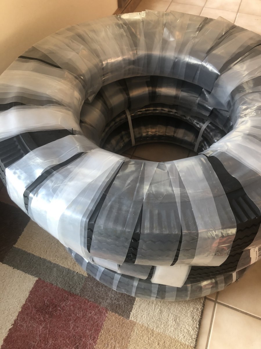

    Tribalmonkey
    IMG_5113.JPG [emoji2]

    tb33anda3rd
    cut the plastic off and stick some chunks of 2x4 to hold the beads apart for at least a day to aid in mounting them.

    Tribalmonkey
    Good advice tb33anda3rd - I have already finished one and it was a real pain because it was squashed from shipping. I’m gonna do the 2x4 thing and bring them in where it is warm for the night.

    Yes, I am impatient. Yes, I am sweating.
  13. My trick on the Tires is to install the New Tubes and just add enough air to spread the beads about 6". After they sit a day or two they pretty much stay apart.

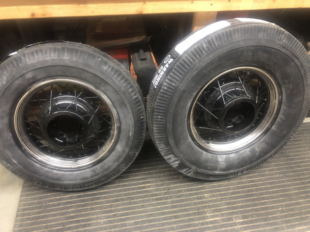

    Tribalmonkey
    Even though I only have two tires on their rims [emoji2]
    Dannerr, Tim, Baumi and 6 others like this.

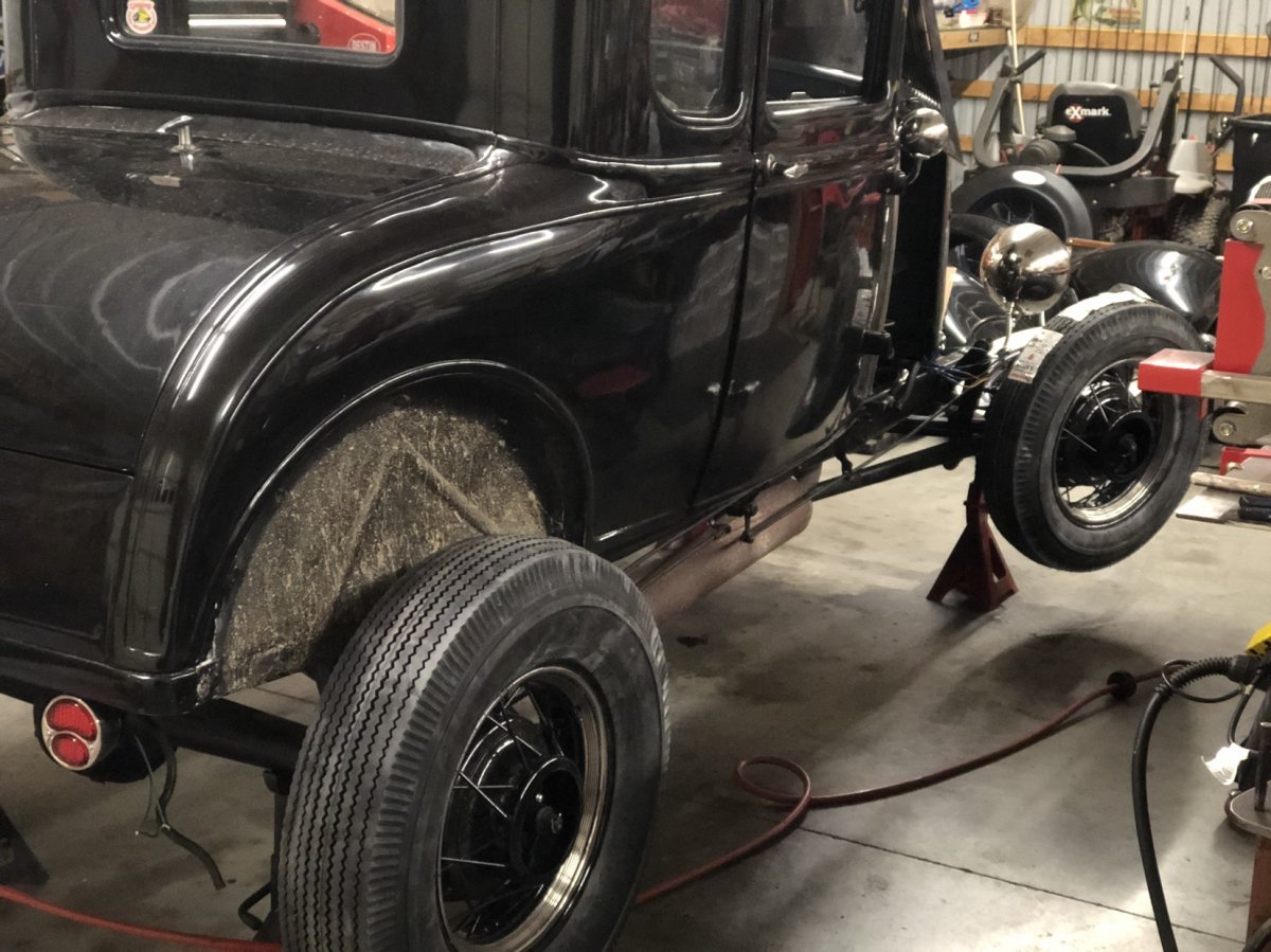

    Tribalmonkey

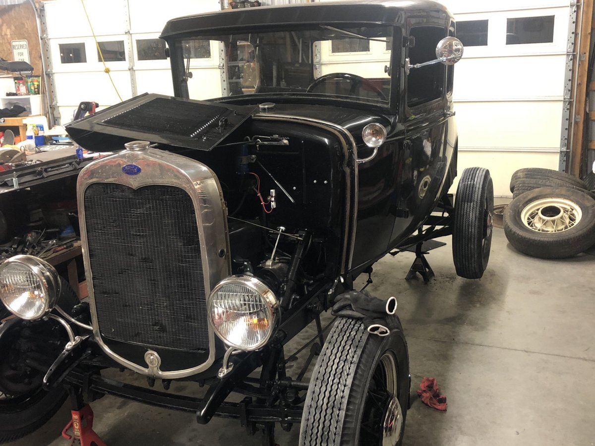

    Tires are all on the new wheels with shiny new center caps. I have a bit more light wiring to tidy up and then I plan to just drive it for a bit. Next will install some seat belts, start lowering it, and maybe some speed parts.... unless driving it more IMG_5120.JPG 63219373815__4DD14475-CFF5-4A29-BE60-B1EC28E5DCB2.JPG reveals some other priorities.
