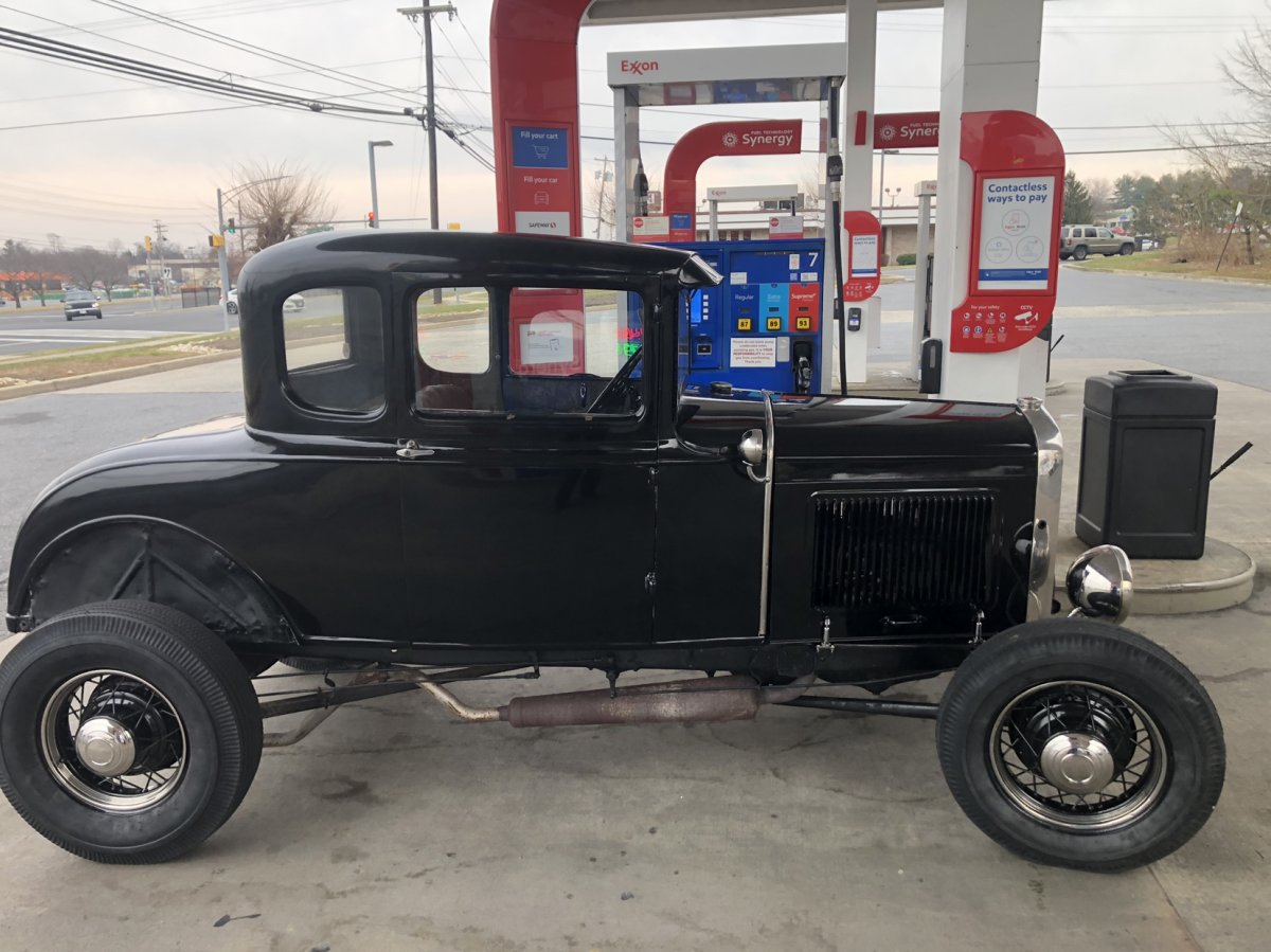

    And no, I didn’t spray the engine. Didn’t even open the hood. It was supposed to be just a quick rinse before I got some gas and I went over to my buddy’s house.

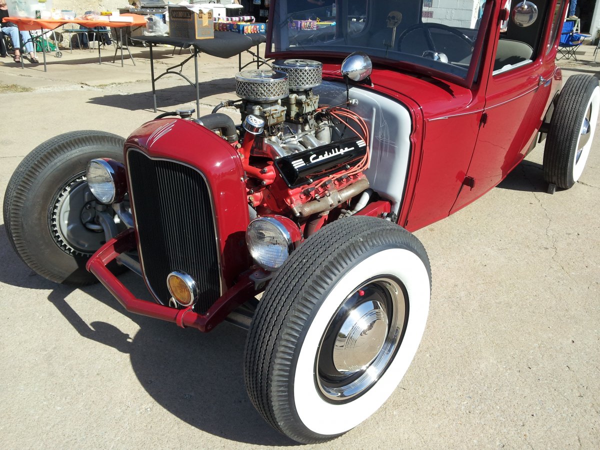

  6. arkiehotrods
    Joined: Mar 9, 2006
    Posts: 6,802
    arkiehotrods
    Yes to the 331. The banger locking up is a sign you should install a Caddy.

    arkiehotrods - Very cool. Someday....

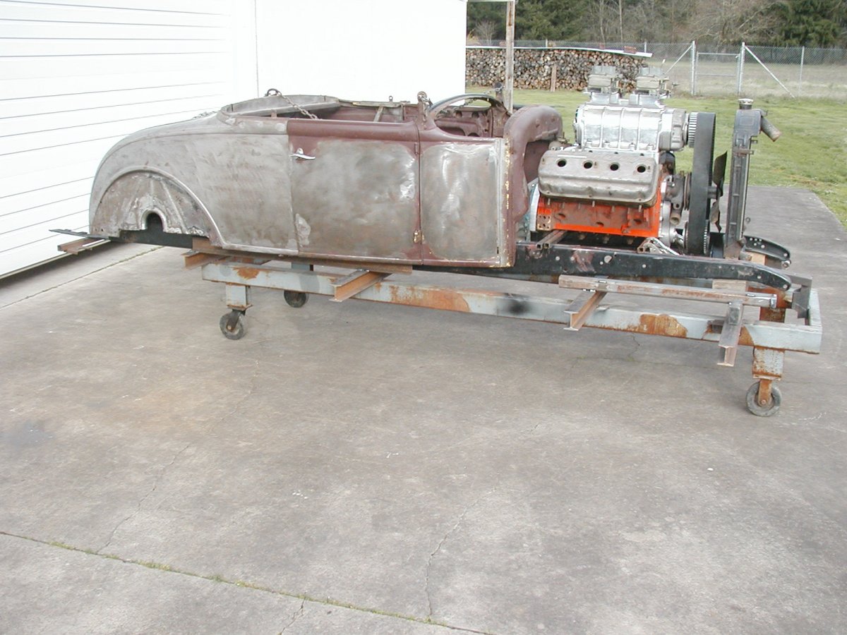

  15. Being you may entertain building a different ch***is in the future here's some food for thought. I totally get the "use a 32 frame" guys. I also get the "use the Caddy" line of thinking. Fenders or no fenders, ya, I can go either way. But here's the deal, these decisions determine where the finished project fits. We've all seen drivers with so much Mix-n-Match stuff done that we just walk on shaking our heads. Kool pieces but not all in one unit. Just think about that before jumping in any direction.
    Using a Model A Frame with the Caddy will mean the Frame needs some help. Going to a 32 ch***is means a big spend up front and some kind of work setting the Body on top of it. For some of us Time and Date stamps mean a lot, not so much for others. One thing we all seem to have in common is, when we see it done Right we all agree on it.
    I like the Red Roadster that arkiehotrods posted. If it does something for you figure out what that is and build according to that.
    Boxing frames seems to be the normal anymore but it wasn't always like that. Building a frame out of square tube also isn't a good look for Old School. A solid ch***is is a must have today. Something over looked is the AA Frames. Not hard to find, Look like a stock Model A set of rails but much heavier wall material (I used to know the numbers). My list of to do's has this unit sitting on it. A Blown 392 and unboxed AA with a 36-40 X member and yes it will be a solid unit. Unless I told ya you would think it's just a Model A frame.
    Again, just food for thought.

    I know there is a fine line between brave and stupid. I just don’t know where it is. IMG_5157.JPG

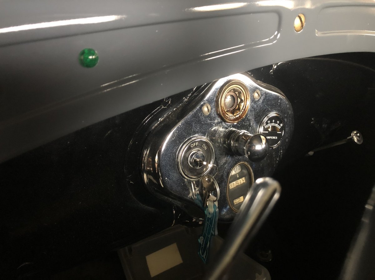

    However, no good deed...

    Yeah. Nothing like hurling yourself through space on curvy/hilly maryland roads, with no seatbelts, in a car that has sketchy brakes, not enough body mount bolts, crazy bad vibrations, and look down and realize that fuel is leaking onto a live light socket. Good stuff.
