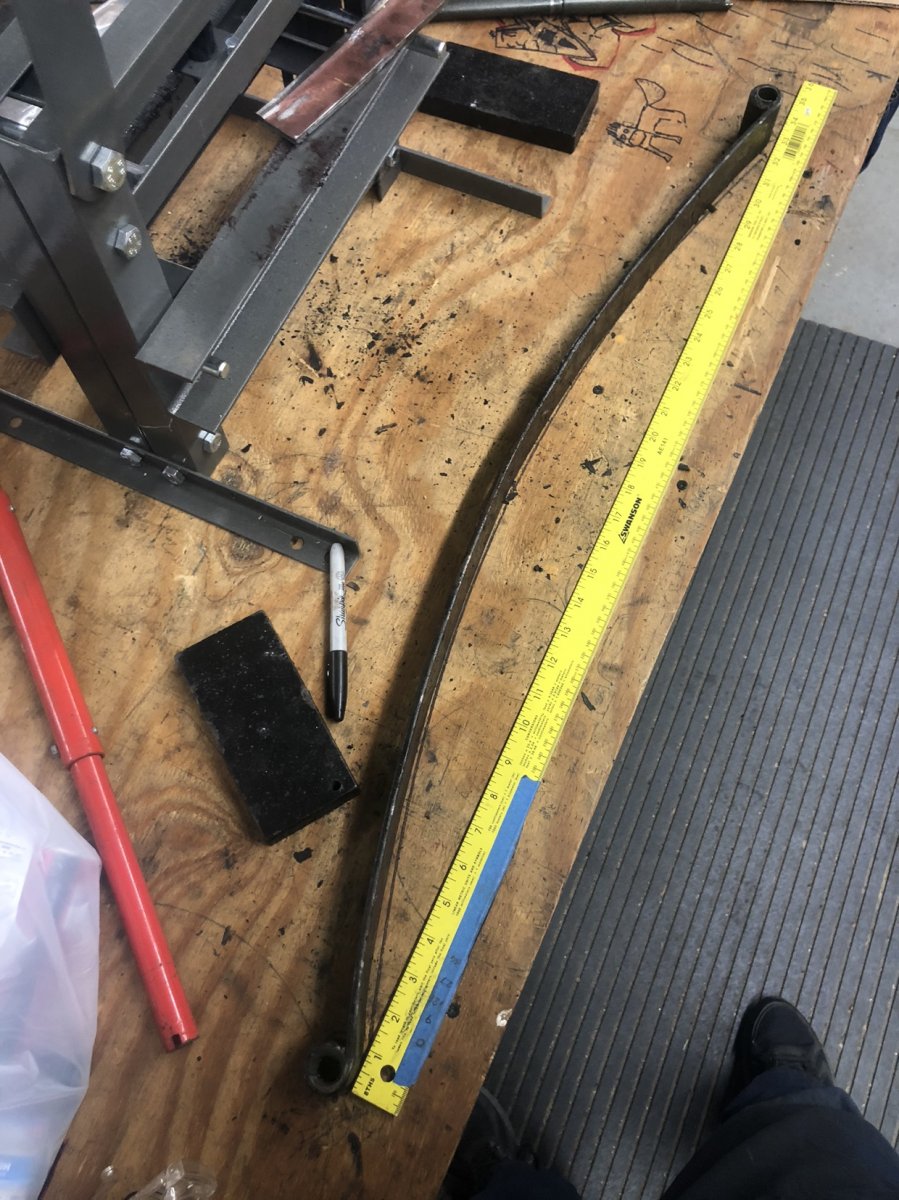

    Here is a measurement pic I took before I started work on the leaf springs. Plan was to post the before and after. Keep in mind this is with my 16” wheels and 550 tires. Is this a normal height? IMG_5175.JPG

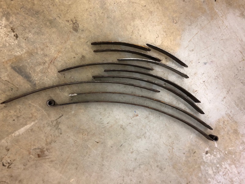

    Here’s the leaves I took out of mine (the ones slid to the left)....almost. I put the second from the bottom (the longest of the 4 I removed) back in, deciding I was a little too low (hard for a Kustom guy to say that, but there you go. Lol). I had 10 leaves to start and I’m to 7 now.

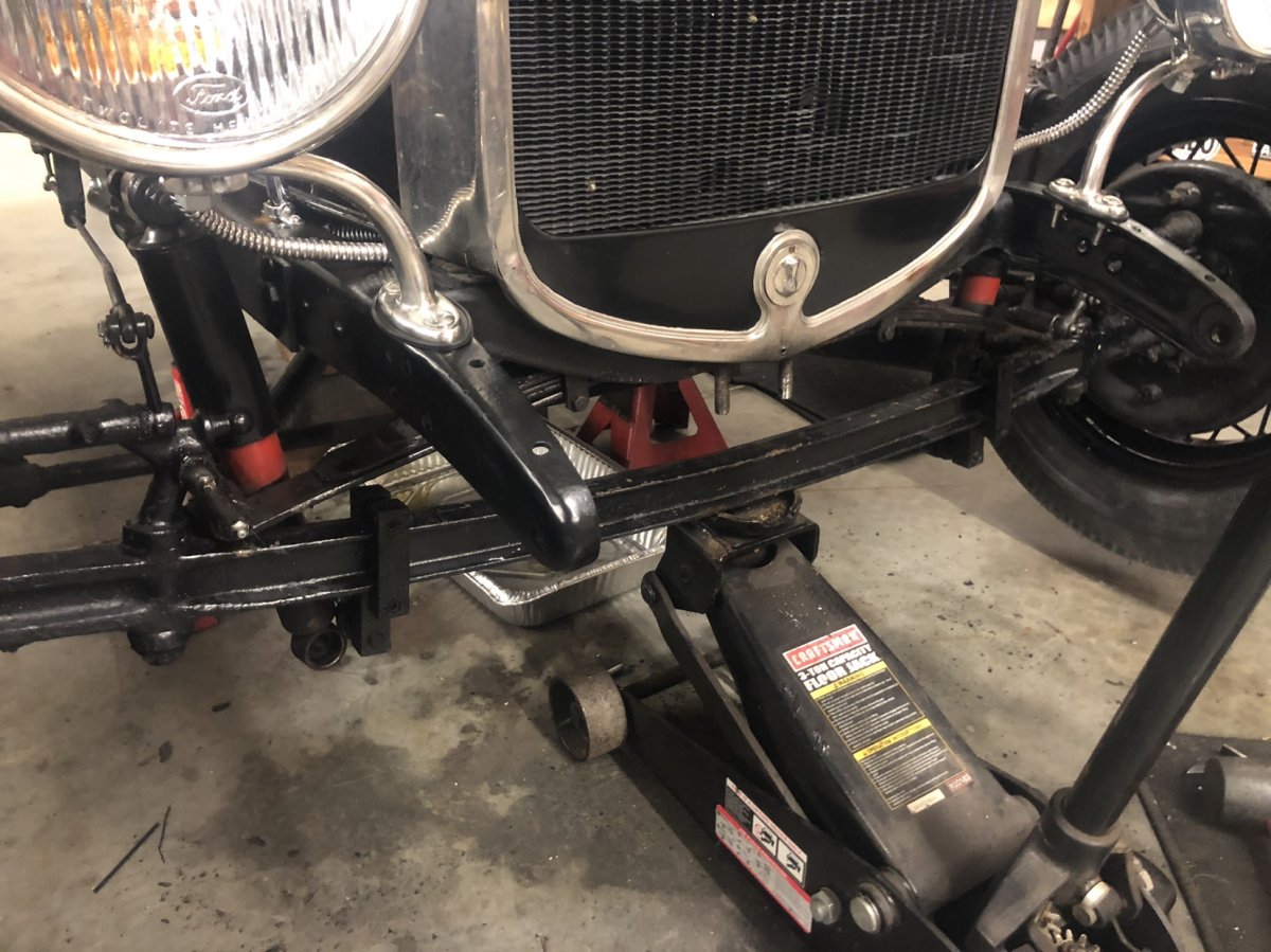

    Thanks drdave - here are the pics I have. I know they are hard to see. The first one is from the first attempt. The second is from last night the frame is on jack stands so it is not compressed. IMG_5189.JPG IMG_5193.JPG

    Yup, that's pretty flat! LOL (sorry, it's not really funny). Yeah, I would agree, that second longest leaf is likely the culprit. When I look at the pic of the spring flat, it looks like that the main leaf is bent/flexed between the eye and the end of the next leaf you have there, so my guess would be that there is too much unsupported length of the main leaf without that long leaf that should have just been clipped on the ends rather than removed.

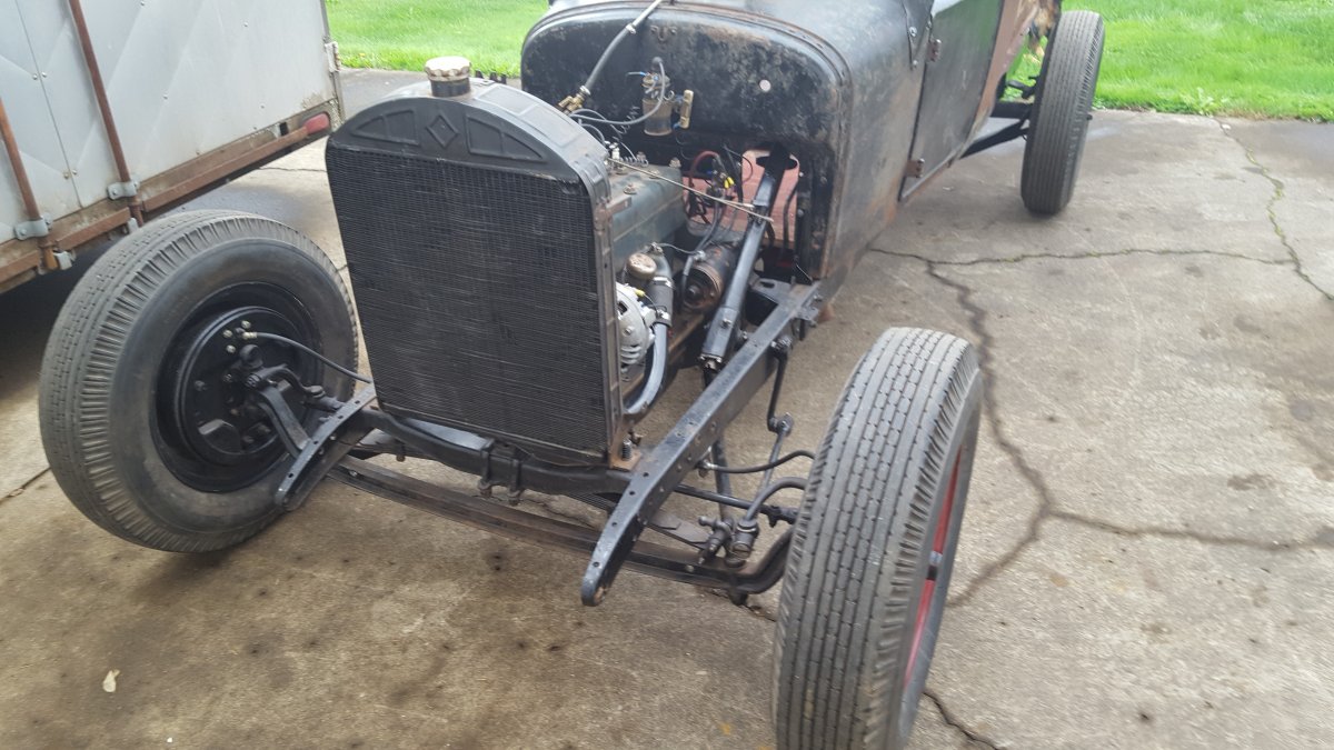

  28. What your looking at here is all stock Model A steering, tierods and spindles with 46-48 Brakes on a 4-1/2" dropped Model A Axle. I did chase threads on the tierod to adjust for the drop getting a little narrower between the King Pins. That's just normal stuff.

  30. If you want to just bolt things back together with what you have stay with all Model A pieces. That said you may want to look very close at that photo and look at all the same things on you Coupe. You may have a few more questions.
