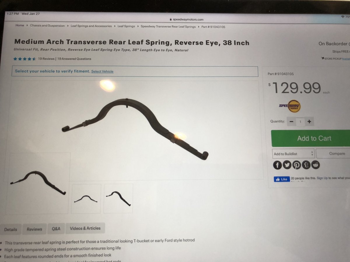

    Joking aside. Will this work to lower Pappy’s rear? Looking to get close to 4”s.
    Has any one tried this? Concerned about the size and the spring eyes.

    I see that it is on back order anyway.... Trying to plan my way forward to lower the rear.
  16. [​IMG] Buy yourself as set of these and mount the Stock A spring V-8 style. Then make a spring perch off the stock crossmember. That will drop the rear 4.5".

    Pist-n-Broke - I think you keep trying to throw me in the deep end of the pool. Ha! That is a cool suggestion. I didn’t know it was even an option.

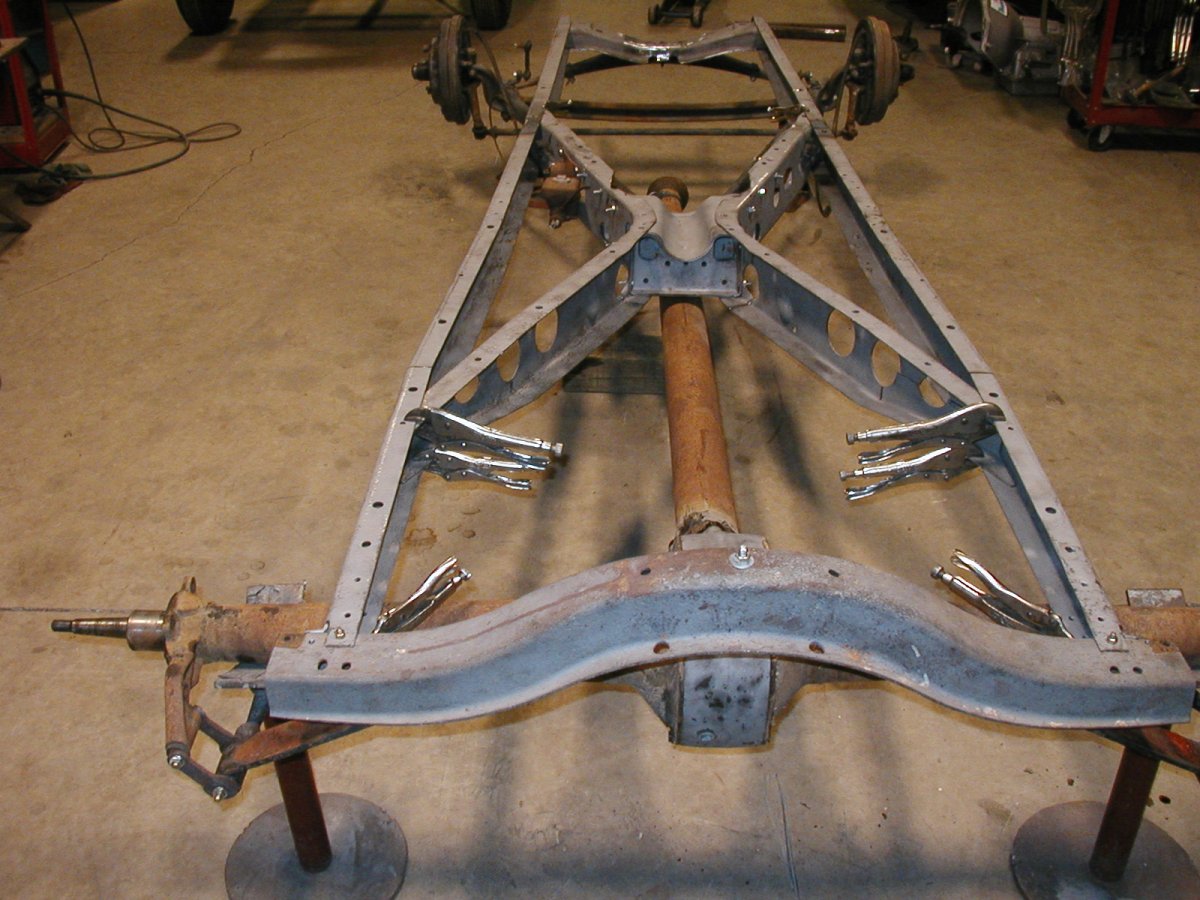

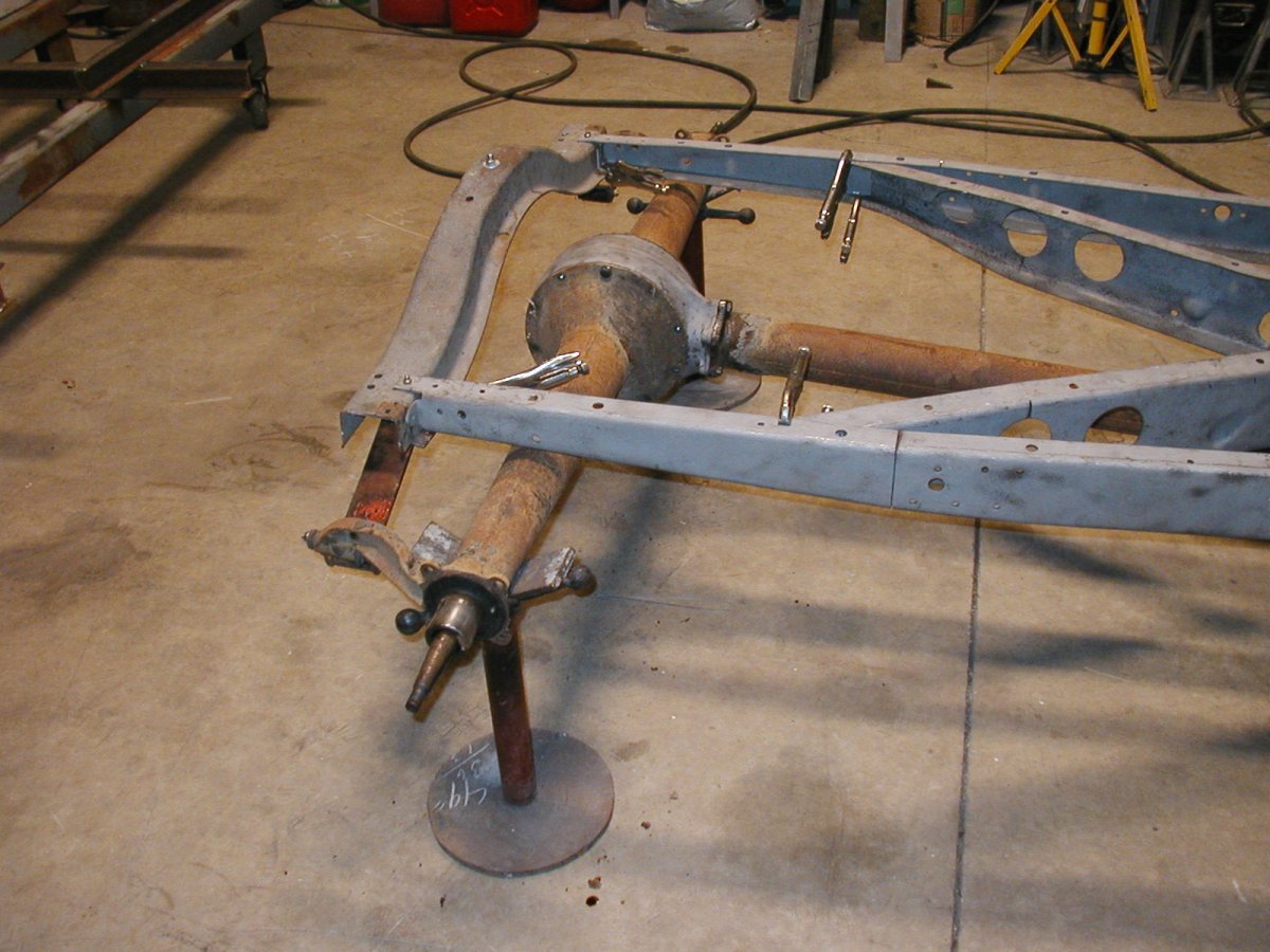

  23. For me being I'm a pretty fair Fabricator/Welder/Builder things like the above idea just seems very simple. I forget how much is behind me compared to many others. I also understand "I don't think like normal people" and accept that I'm a misfit. I don't know how many times at the end of a day I've heard Customers say "I'd have never thought of that". I don't know if it's a Blessing or a Kurse or even where it comes from. It's just what I do. What I do know is that my Candle is getting very short and if I don't throw out some of what I have done it will all go with the Light when it goes out.
    What I was getting at with the weld on bracket comment is sort of what I did on the ch***is below. That is actually a V-8 rear Axle but look at the location of the spring eyes to center of housing. That set of Frame rails are Flat and the drop is outstanding with a Stock Model A spring. For me it just ment not going shopping and just doing what I do.

  25. Do you mean closer to something like this? The ch***is posted above lives under it.
