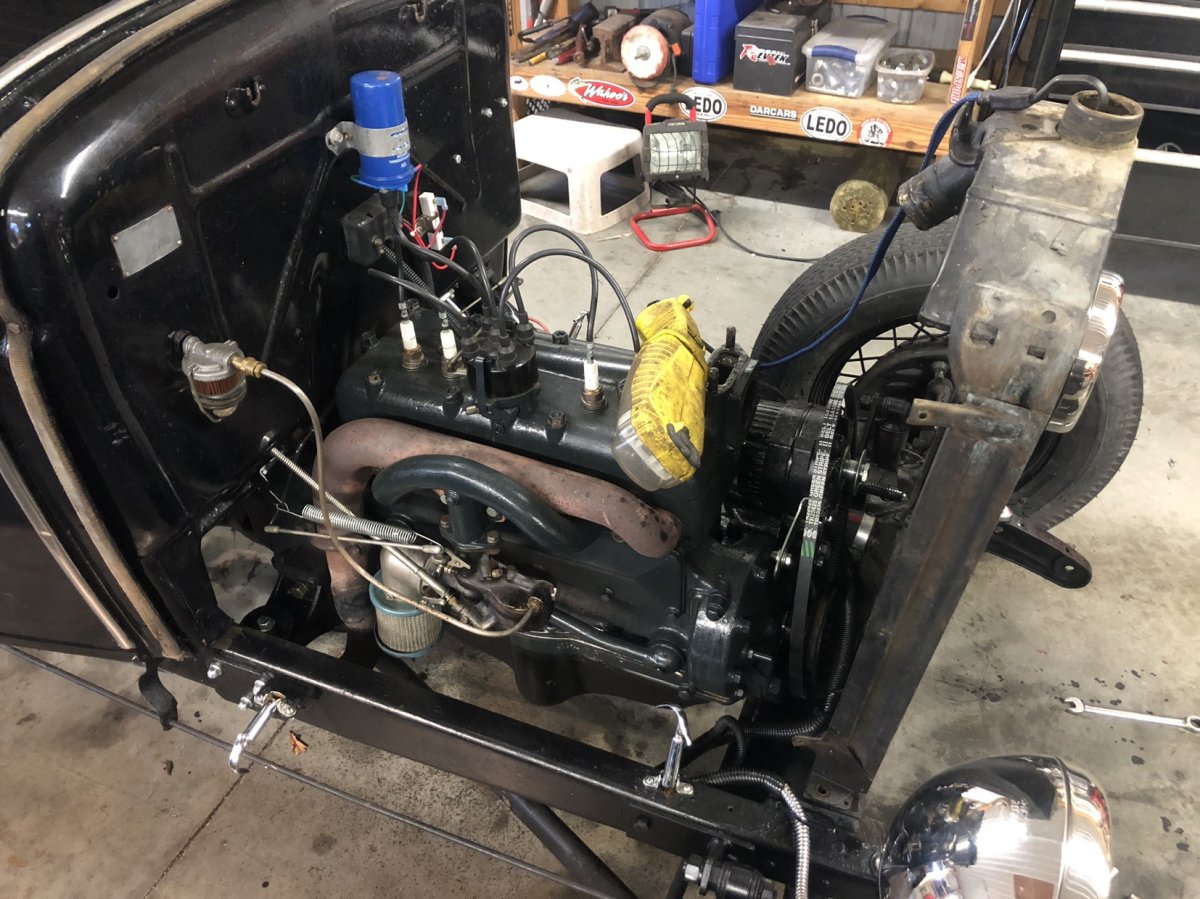

    Installed a new leakless water pump, hoses, and gaskets (including the water outlet). The coolant was pretty dark and all the p***ages seem to be coated with ‘gunk’. I’m wondering if it is grease from someone using the wrong grease/too much grease in the old water pump. IMG_5223.JPG

    TM, the trick back in the day was to install a '66 ?Ford inline 6 water pump. Gets rid of the old and the issues that followed it with a newer style. Some fab work required but pretty simple in the long run. My friend just did this to his banger build. Thought I had a pic but can't find it, yet.
    Those older Rev Pols are hard to find. I searched last night across the net but didn't see one for a banger. Could always use a MSD 6 AL and use the current points as a trigger for it. Just another thought.
