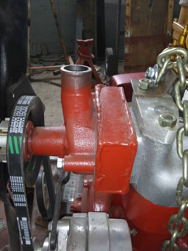

    TM found that pic of the water pump. Looks like a box is tabbed that bolts to the block and the pump bolts to the front. Neat conversion. Thought u might like to see it. 20210203_134615.jpeg

    Thanks! I already installed the ‘Leakless’ I bought at Bratton’s.

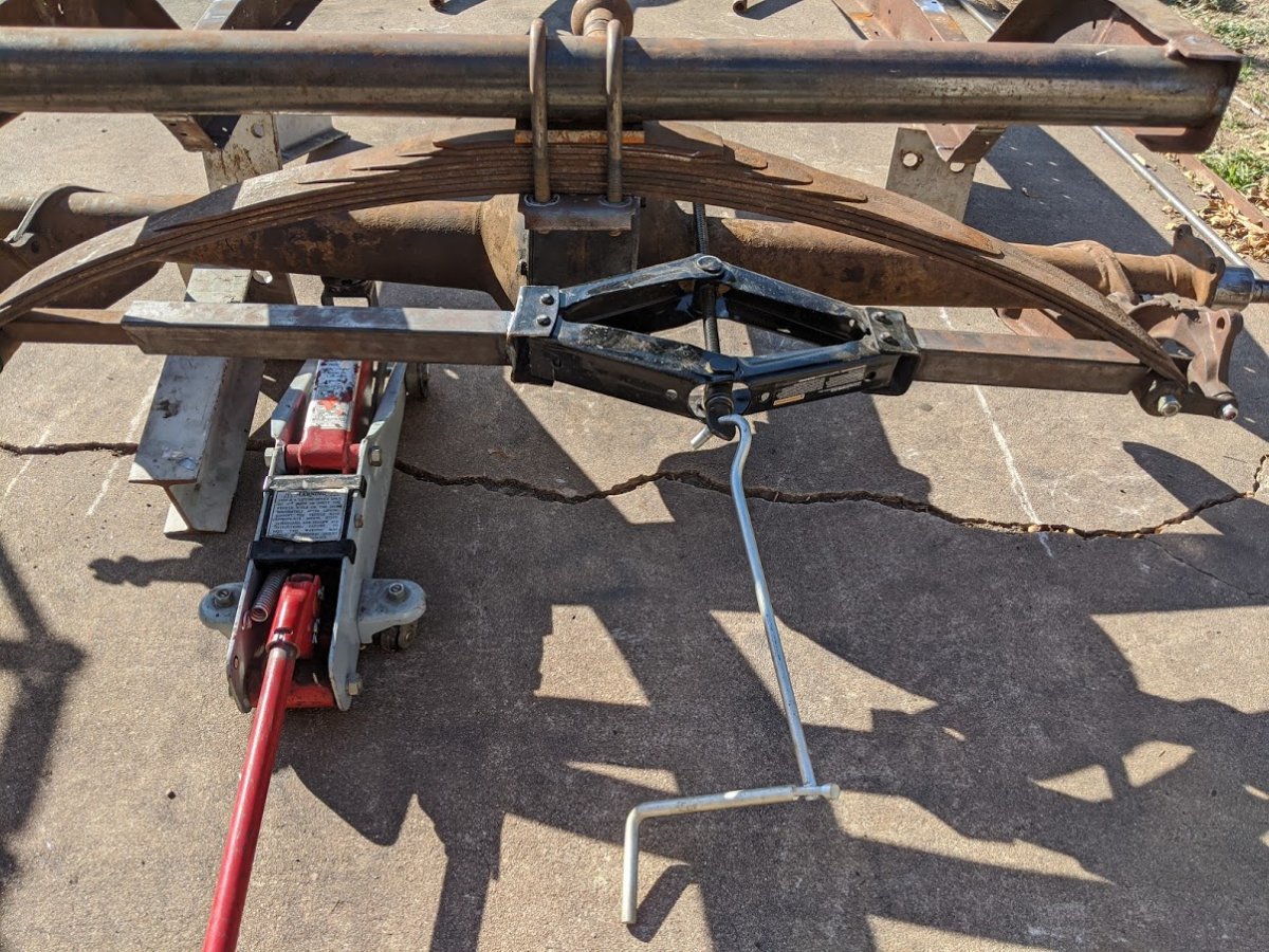

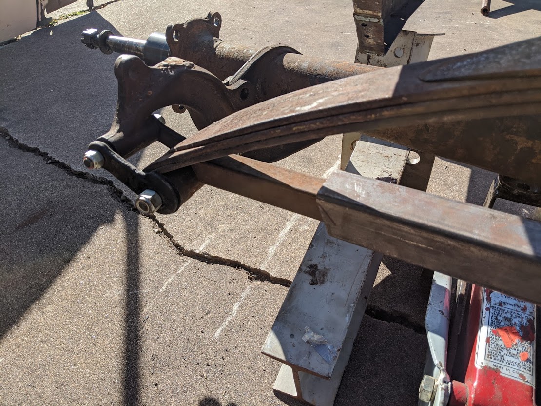

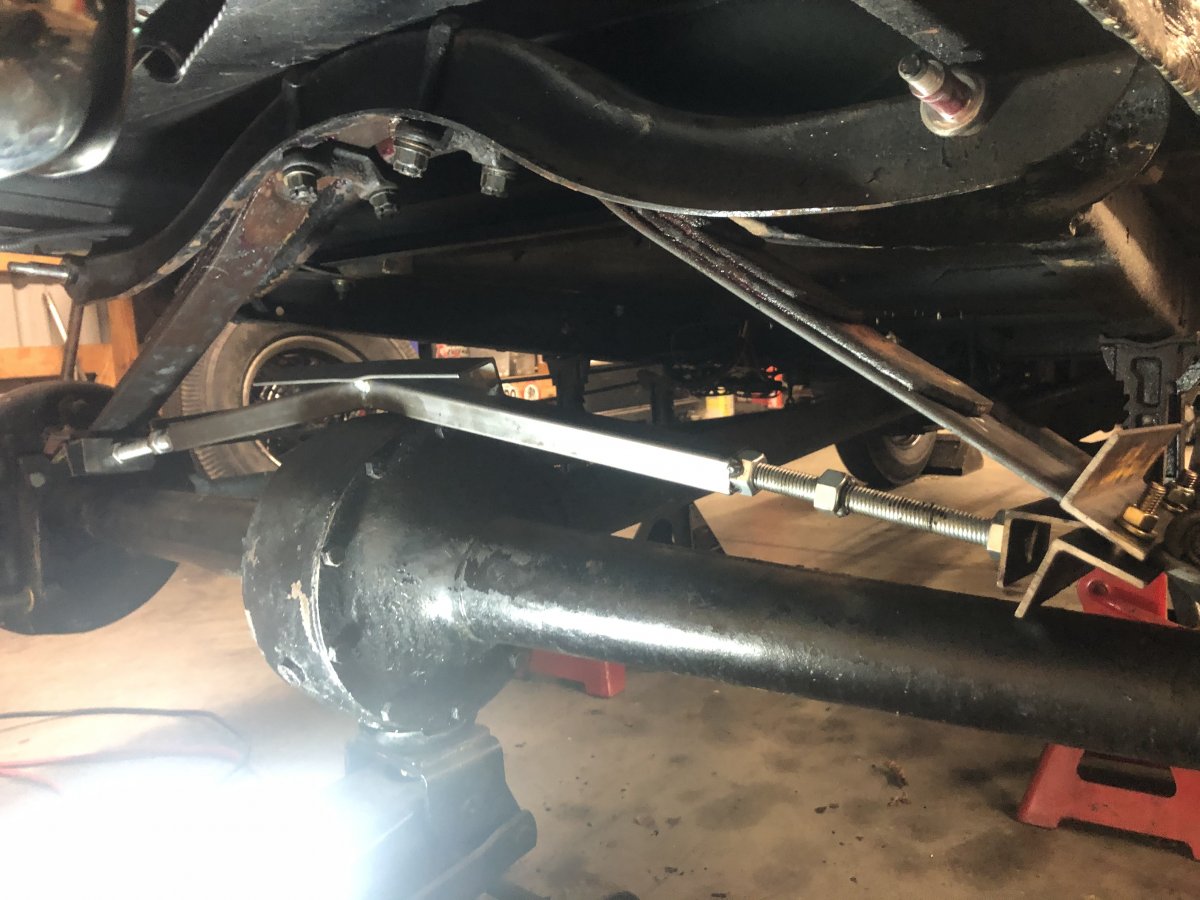

    Here’s a pic of my hack job rear leaf spreader. I haven’t tried it yet. I may have to do some mods as I go. IMG_5248.JPG
    lothiandon1940 likes this.

    Last time I needed mine, I couldn't remember where I put it so I just mounted the main leaf and then added the rest with a C clamp.
    Sent from my SM-T350 using The H.A.M.B. mobile app
    bchctybob and loudbang like this.
  8. grumpy65
    Joined: Dec 19, 2017
    Posts: 920
    grumpy65
    Might need a gusset or brace bar across the middle ???
  9. Tribalmonkey
    Joined: Feb 17, 2019
    Posts: 921
    Tribalmonkey
    Yeah. Thanks. I was thinking the same.
    lothiandon1940 and grumpy65 like this.

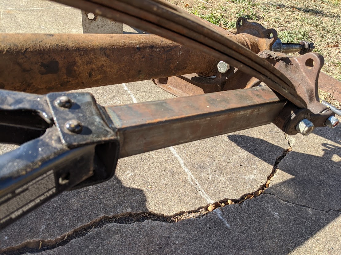

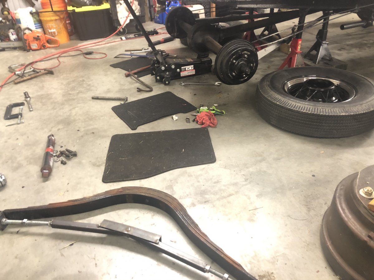

    I did reenforce my hack job spreader. It worked perfectly taking out the old spring pack. I swapped out the main leaf, removed the #2 leaf and the top 3 (no, I didn’t chop any of them up this time). I greased, clamped, and bolted the pack back together and attempted to reinstall it. I tried to cut some corners on the process. I bolted the springs back in the crossmember, placed wooden blocks on the axle, and jacked the axle up. I got one shackle in but the other was far from going in. I wrestled with it for too long and then realized I had to revert back to the spreader process. I should have done that in the first place. I called it quits for tonight. I’ll hit it fresh either tomorrow or this weekend. IMG_5251.JPG IMG_5253.JPG IMG_5255.JPG IMG_5256.JPG

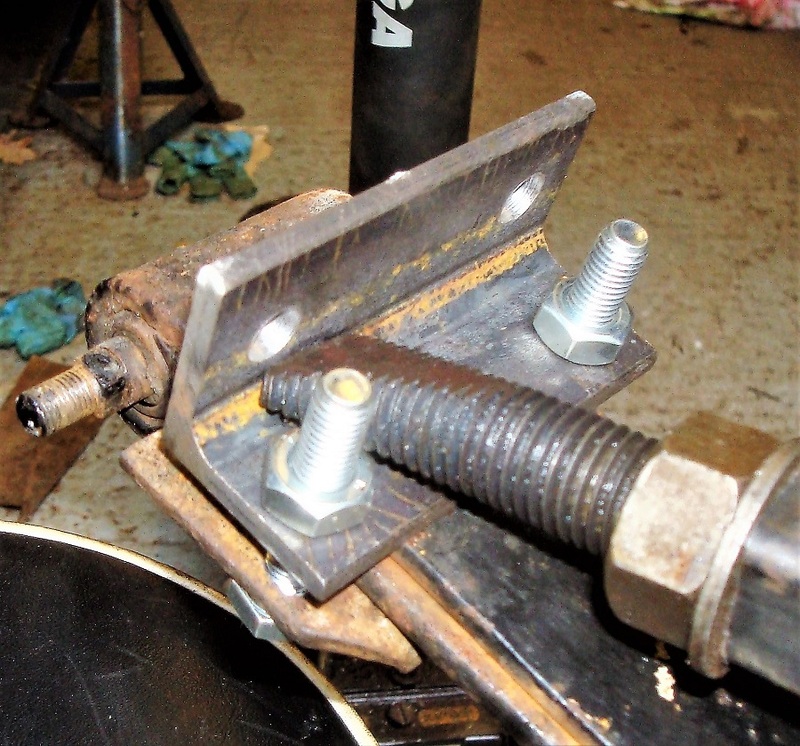

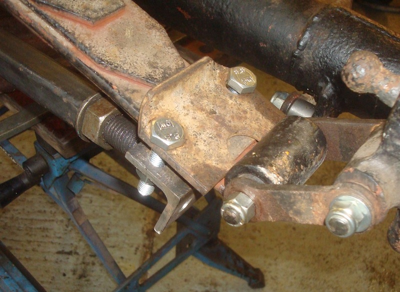

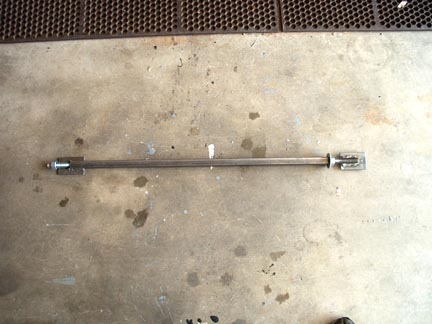

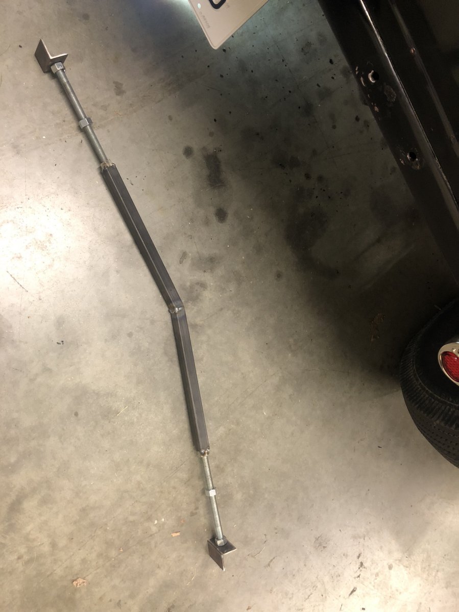

    When I saw that I hadn't read all the way to the end and that you'd already made and used your spring spreader I deleted my post, but you'd already responded. So I'll repost for anyone who didn't see it in the 2-3 minutes it actually existed.
    Here are all the spring spreader pix I've saved over the years; maybe something in here will give you an idea or two:

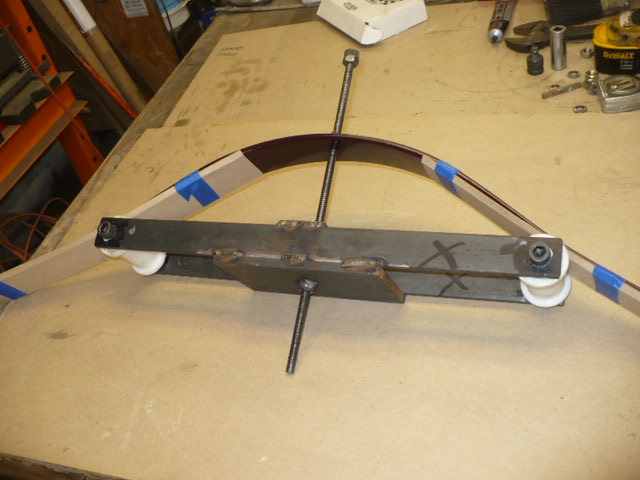

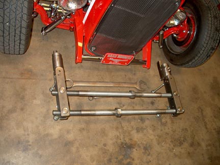

    Spring Spreader - Reverse Eye.jpg spring spreader 1.jpg spring spreader 2.jpg spring spreader 3.jpg Spring Spreader 5.jpg spring spreader reversed eye spring 1.jpg spring spreader reversed eye spring 2.jpg spring spreader.jpg
    Tim, drdave, lothiandon1940 and 3 others like this.

    Atch - No problem. Fun to see the different solutions. Now you can add my hack job spreader to your repository.

  26. atch
    Joined: Sep 3, 2002
    Posts: 6,529
    atch
    Already did.
    b-t-w; most of the ones I posted are for "spring behind axle" setups. You were clever in making yours for the "spring over axle" setup.

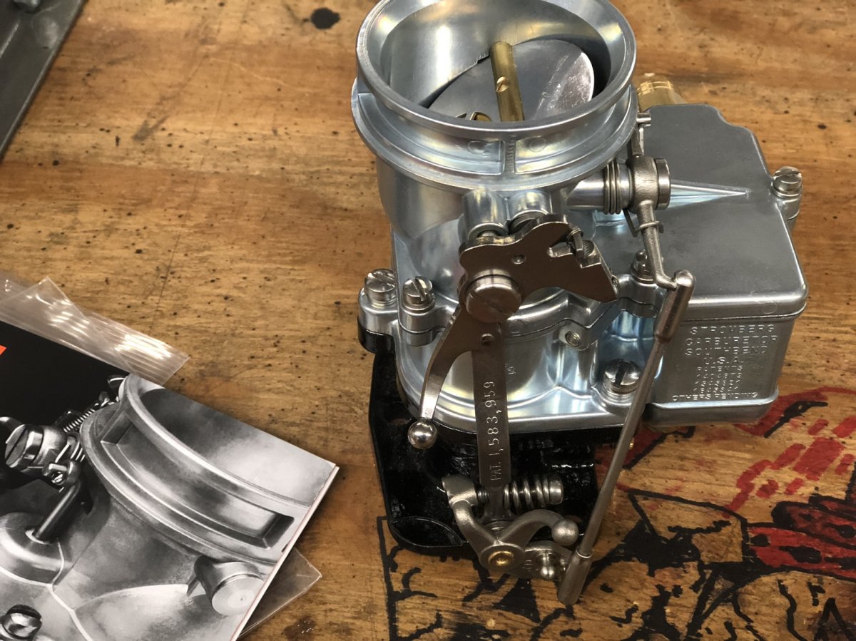

  29. Tribalmonkey
    Posts: 921
    Tribalmonkey
    So far I haven’t run across any choke linkage solutions or examples. The carb has the ball mount for the a choke linkage. I haven’t called Stromberg again but I did talk to Victor at Red’s Headers (where I purchased the carburetor) and he didn’t know but said he would look into it.
    You guys have any ideas or recommendations for Stromberg 81 choke linkage? What do you guys use?
  30. tb33anda3rd
    Joined: Oct 8, 2010
    Posts: 17,592
    tb33anda3rd
    there is a cable end available for the ball. I think Speedway has them.
