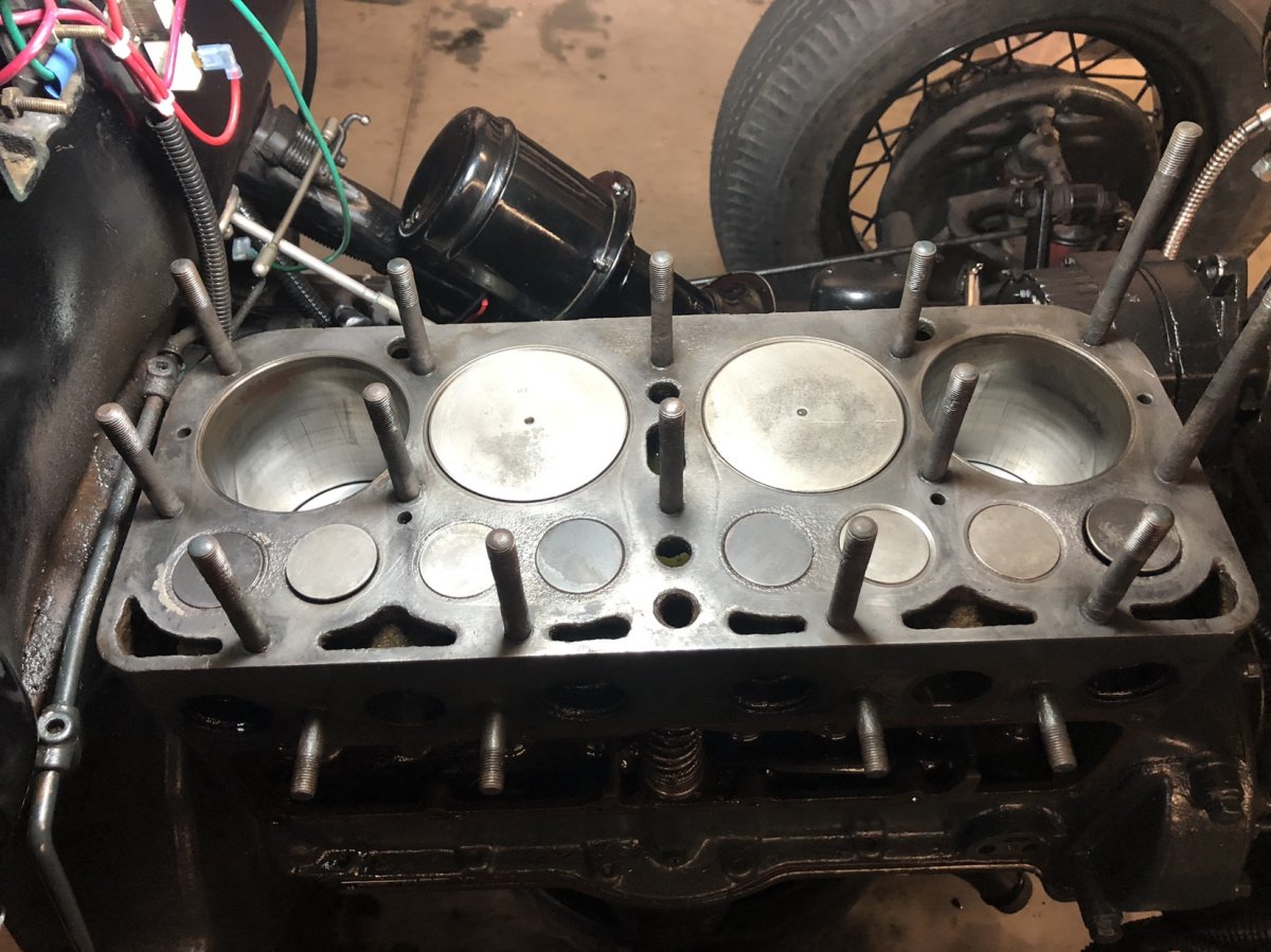

    Should I consider a new cam while I am this far in? What all would be involved? I should be getting my FSI2 distributor and Snyder 5.5 head within the next few days. I discovered don’t have adjustable lifters. Here is a pic of my mock up so far. IMG_5317.JPG

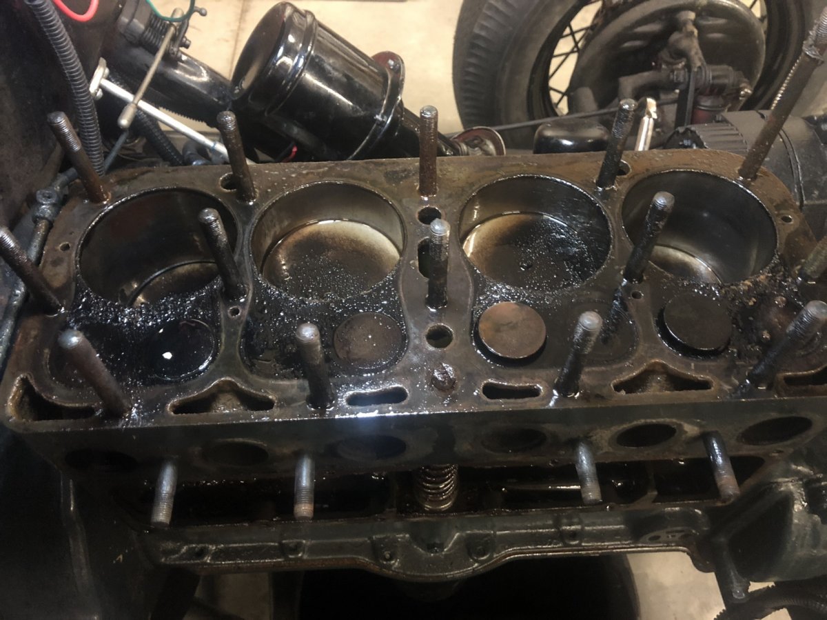

  5. Dick Stevens
    Joined: Aug 7, 2012
    Posts: 4,178
    Dick Stevens
    D
    Drill mounted wire brush
    StraightAxle64Nova likes this.

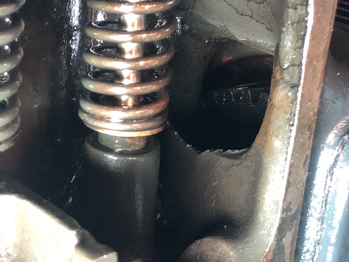

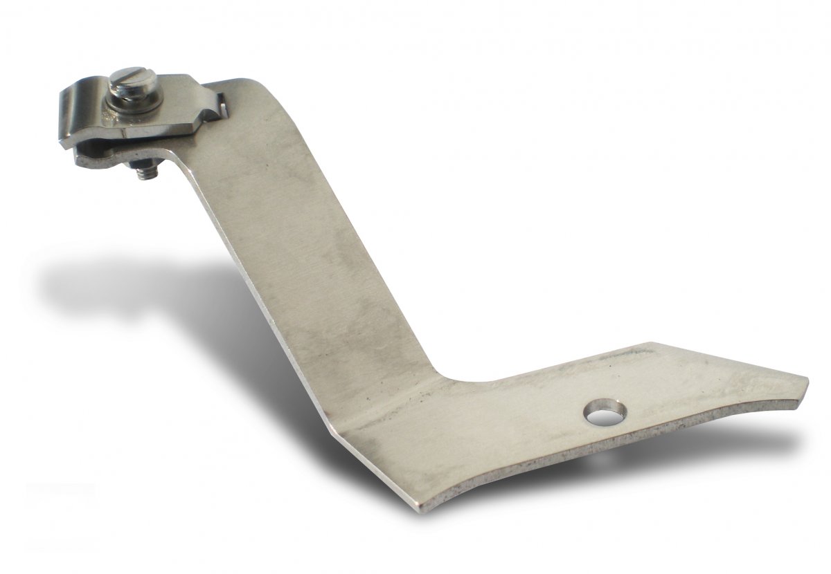

    Your build is really coming together! I'm loving all the speed equipment. As far as the choke cable mount goes, I was thinking maybe this one from Stromberg would work? I was considering running it on mine with a cable. Or I may just fab one up myself instead.
    That being said, it doesn't get very cold in my part of the world and I'm not sure how necessary a choke will be. 9552K-B.jpg
    You can find it in the "Other Parts" category here
    tb33anda3rd and lothiandon1940 like this.

    Thanks Joey. I already ordered this one. I get a four seasons here in MD. IMG_5343.JPG

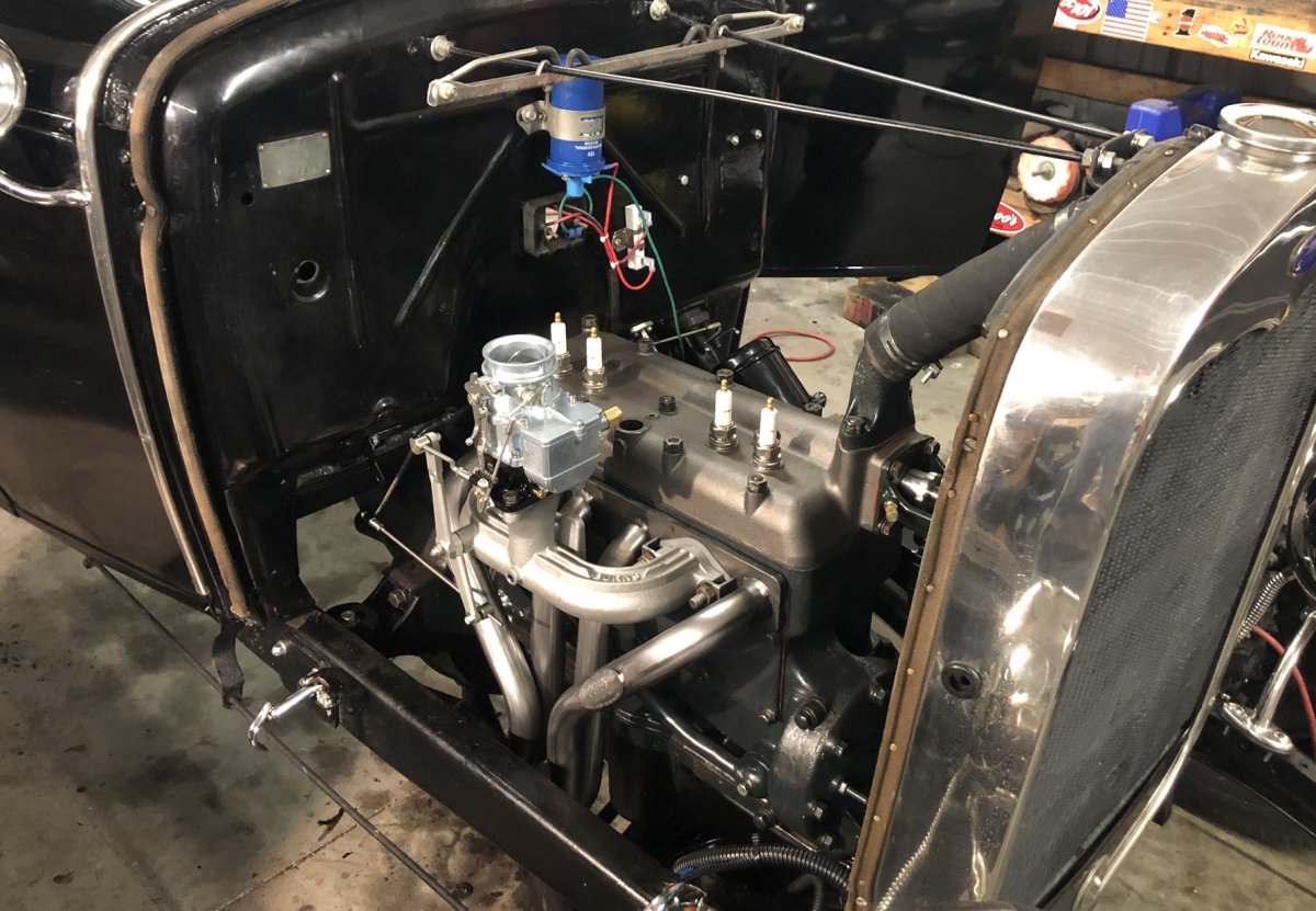

    More progress made this evening. Hard to tell from the pic but I installed the FSI 2 distributor and coil. I also did the first mock up of the fuel line from the firewall to the carb. Began work on the ‘behind the scenes’ fuel line and pump placement. I’m enjoying the fuel line work. It’s a bit of creative fabrication. IMG_5375.JPG

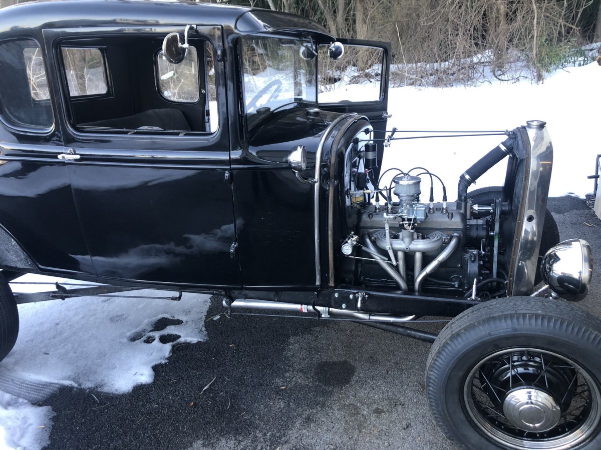

    He said, “Dad now it looks and sounds like a hot rod.” It ran great and stopped great. I could certainly tell a difference in the power. Much more lively. I tack welded my exhaust pipe extension in place. IMG_5429.JPG IMG_5430.JPG IMG_5431.JPG
    Phase III complete.
    (Phase I was getting it running and stopping, Phase II was pulling the fenders and ‘trying’ to lower it, new wheels and tires, Phase III was Hop Up)
    My wife asked how many phases will there be. I said, good question. [emoji2]
