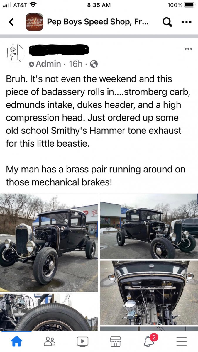

    Just ordered a Smithys muffler.

    I always laugh at the misconception that mechanical brakes can't possible work and it takes balls to use them. cut a couple "lines" on a mechanical brake and you still could stop. try that with hydraulics.:cool:

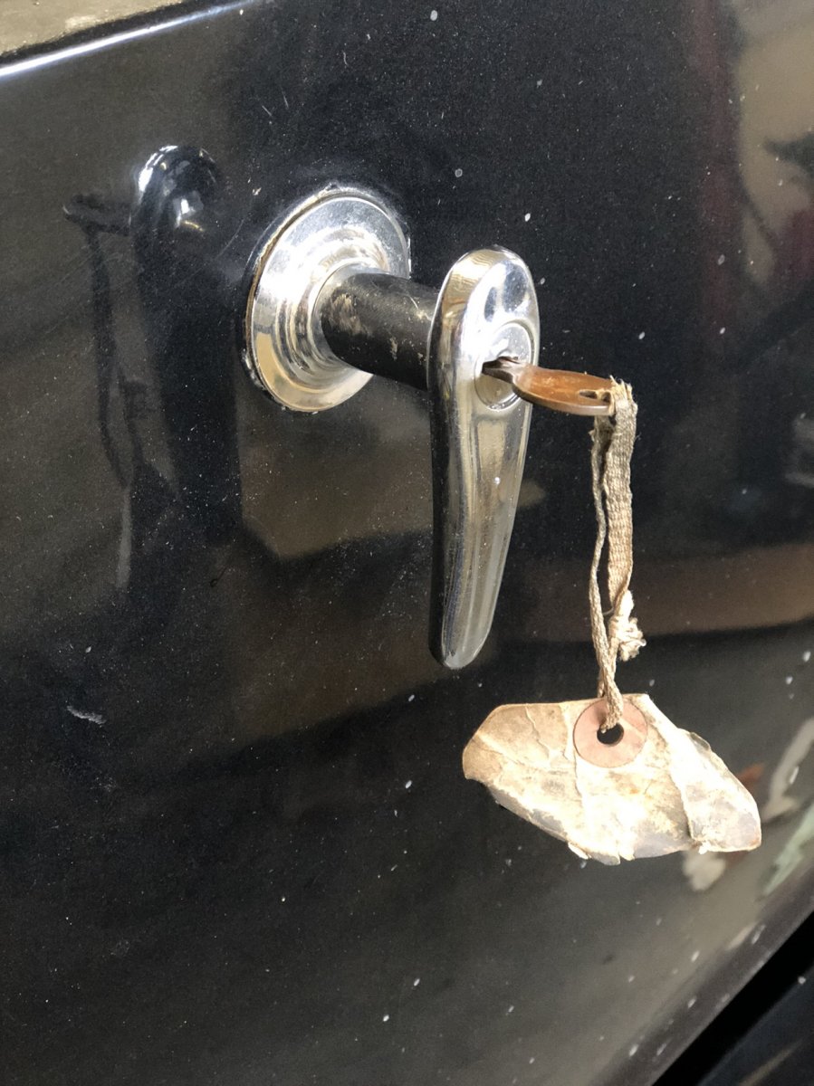

    More likely, the sox etc prevented the top material from flapping in the breeze
    and the key was a spare, try it in the pop out ignition switch!

    Fits in the rumble seat lock but doesn’t turn :-/ IMG_5476.JPG

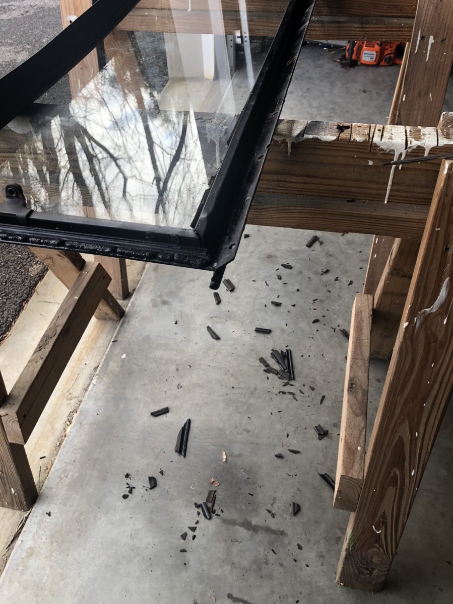

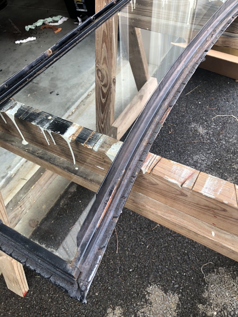

    What is the best way to remove all of this petrified rubber?

    Seems like a torch might do it but I’m afraid it might crack the windshield. IMG_5492.JPG

    I would take a putty knife and gently tap it to try and remove that spent rubber. Like you mentioned, I would be reluctant to use a torch. What would soften that rubber and help it to release? That's another question.

    Thanks Don. Not sure if you can tell but I lack patience sometimes. Gently with a putty knife will take a lot of self control. I’ll try. [emoji2]

    I might try a blow drier or heat gun to try and soften the old rubber, but be careful not to get too close to that gl*** or "another rabbit hole"!:eek:

    We used to make a tire prep when we raced gokarts that was equal parts acetone, mineral spirits and ATF, it will soften up rubber then use either a razor s****er or sharpen a putty knife so that it will cut the rubber, if that doesn't get it soft enough you could try a hair dryer after the fumes from the prep have dissapated!

    Thanks ****. I’m open to all suggestions on this one.
    This seems to be working. Really slow though

    Brake fluid will soften rubber. It also will dissolve paint, so don't get it anywhere you don't want paint ruined.
    I've never heard of or used the concoction that Mr. Stevens mentioned. It sounds like it would be pretty effective, though.
    b-t-w; after you've got all of it off that you can by s****ing I bet a wire wheel on a 4" angle grinder will clean the metal up to bright and shiny. I'm ***uming that after s****ing you'll still have dried glue and rubber particles that haven't yet come off.
