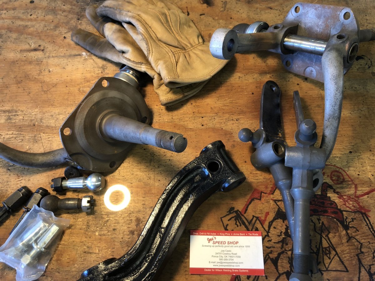

    With the new drop axle I think I am going to have to come up with a different shock mount solution. I’ve read and seen a lot of different configurations. What do you guys think is the best option? IMG_5689.JPG
