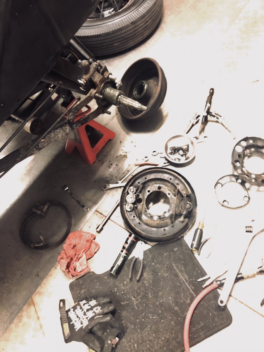

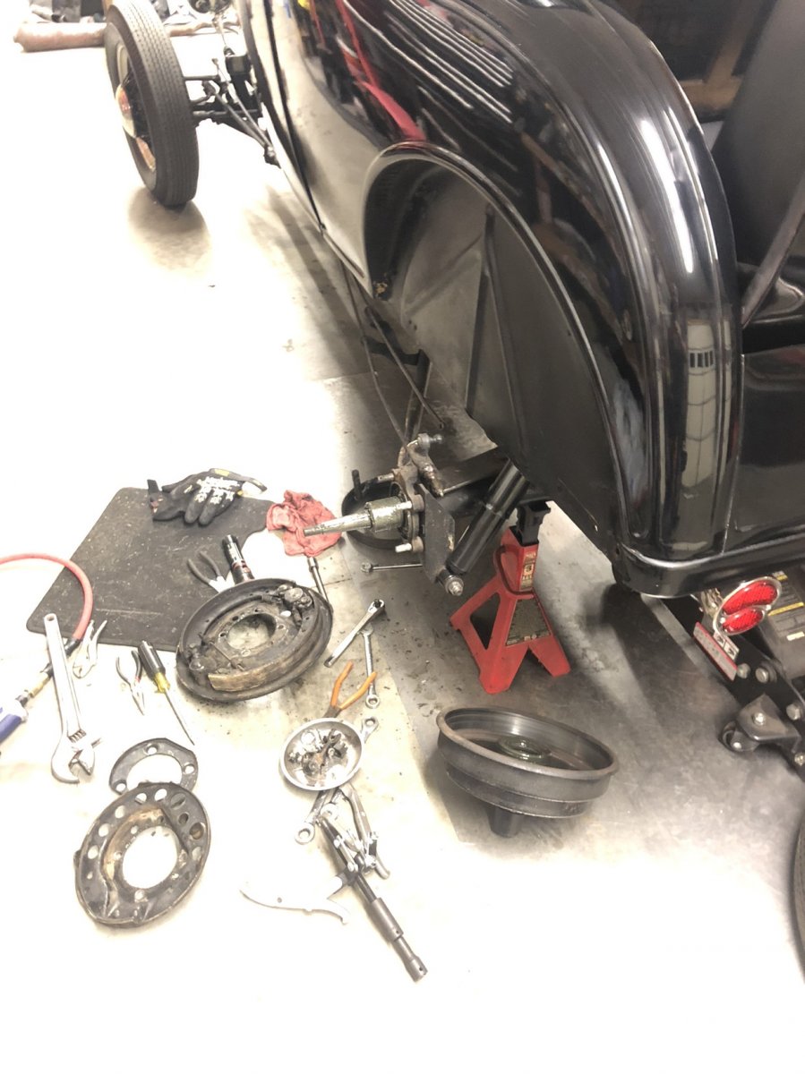

    Bringing this great thread back to the top. I'm about to (finally) address the rear brakes on my car. Would you recommend removing the backing plates before working on them? When I did the fronts, I kept them on the car. It would be nice to put the brakes together on the bench and then just bolt them back in place!
    P.S. How's the roadster search coming along?
  4. Tribalmonkey
    Joined: Feb 17, 2019
    Posts: 921
    Tribalmonkey
    Hey Joey!
    I also did my front brake work on the car. (I still haven’t swapped in my drop axle yet.) I rebuilt my rear brakes with new camshafts, cams, track ***emblies... It is an off-the-car, down to the backing plate type of job. To replace the track ***embly I had to grind off the old rivets and heat the new rivets red hot and swack em with a hammer. I had one rear brake that was in pretty bad shape. The rebuild made a huge difference. My brake shoes were in pretty good shape so I haven’t replaced them yet. Be sure to replace the rollers and toggle pins. I swapped out to cast iron drums all around and new wheel bearings while I was at it. I also swapped out all of my brake rod pins with new ones.

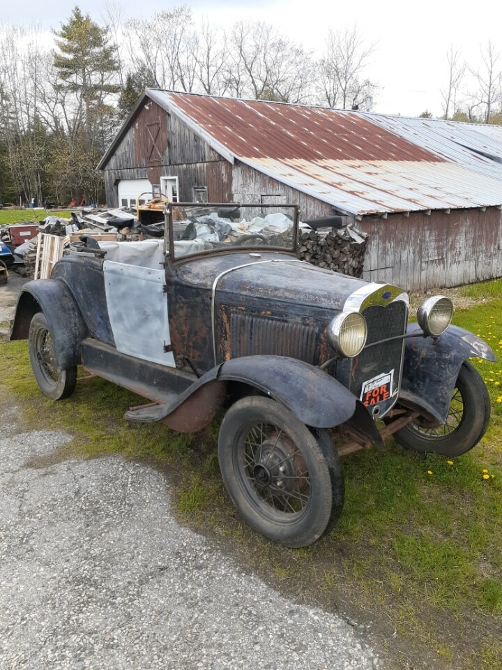

    Tribalmonkey
    Picked up the roadster from my new buddy Paul in VT today. He trailered it a couple of hours down from Maine to help shorten my trip. I ended up making it a two day trip and stayed the night at my friends house in West Hartford. My wife talked some sense into me. “Why are you trying to drive a thousand miles in one day? You should stay over somewhere.”
    I’m glad I listened to her. It made the day more enjoyable and I got to catch up with a good friend. Now That a have a bit more time I have plans to drop by a fellow H.A.M.B.er’s shop tomorrow morning on my way back south. These cars are awesome but the people you meet and friendships you build are the best part.
