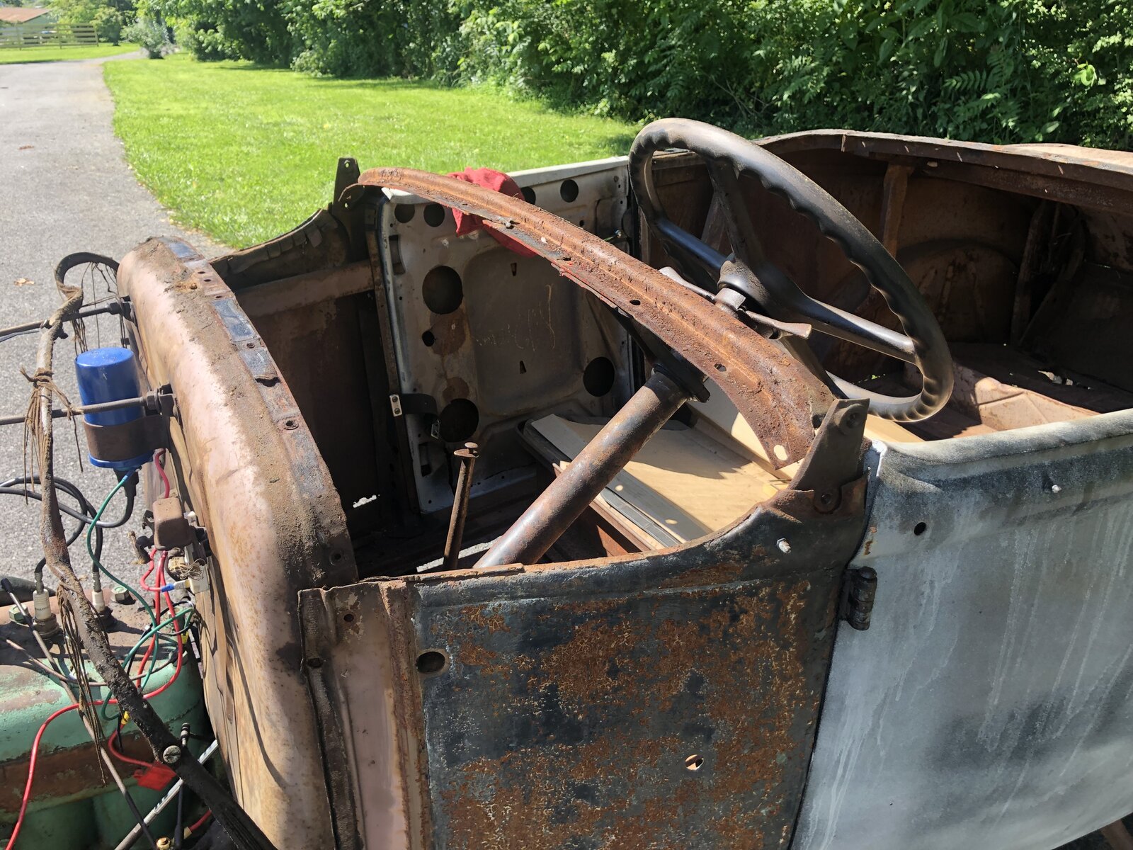

    I realize yours is metal, but most gl*** roadsters have a metal bar behind the dash, running from one side to the other. It helps stiffen up the entire cowl section for sure and helps to minimize "cowl shake". A bulkhead behind the ****pit between the interior and the trunk will go a long way in adding some structural stability to the whole car.

    once all the repairs are made to the body, and the body is properly mounted to the ch***is they are "fine". boxing the ch***is will improve it.

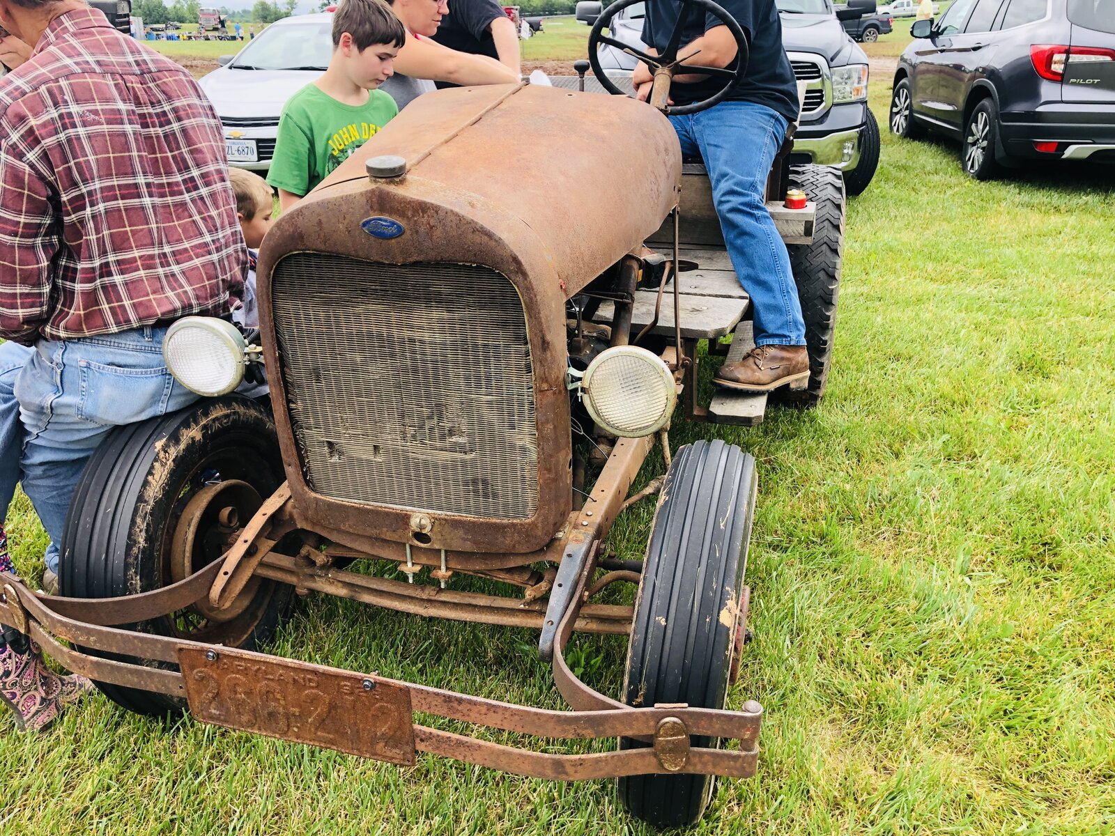

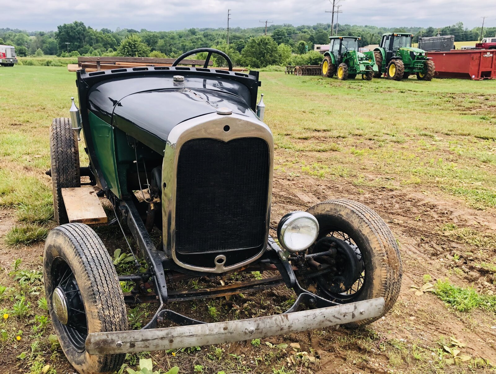

    Cool Doodle Bugs at the Flee Market/Tractor Pull.

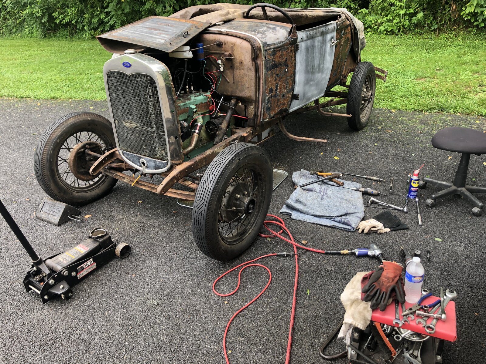

    I worked this evening on the Roadster. I’d say the motor runs great; however, the steering and front end are shot. Steering box would need a complete rebuild and I’m not sure that would do it. The king pins have excessive play. I also see movement in the spring perch radius rod areas.
    I think my priorities right now are to:
    1. Fix the steering by either finding a better condition model a box or swap over to F1 steering if I can find something.
    2. Replace much of the front end with the Okie Joe drop axle I have for my coupe. I have new 32 spindles, spring perches, and king pins all set up with the axle.
    3. Get a seat.
    4. Clean and seal the fuel tank.
    5. Fix the brakes.
    6. Fix the windshield. I should be getting my Ukrop replacement frame sometime this week :)
    I still need to make some decisions.
    -Do I work on the mech brakes or start the move now to juice? I don’t have any of the juice parts.
    -F1 steering now or just get a model a box? Same. I dont have the F1 parts.
    -Take my fuel tank somewhere to clean and seal or try to do it myself?
    I still would like to get the roadster on the road soon with the banger and do the A-V8 build over the winter.
    Open to your recommendations. TM

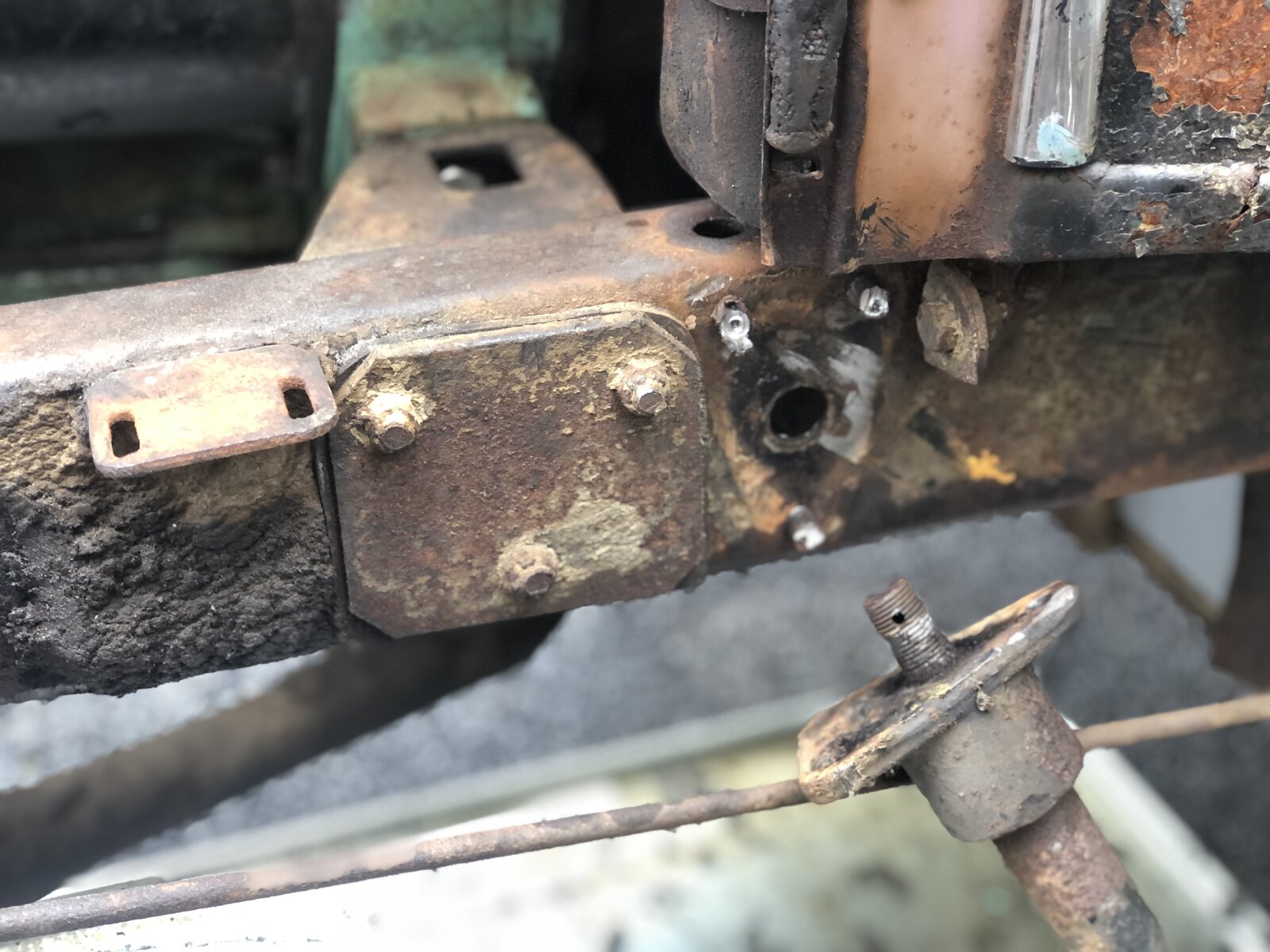

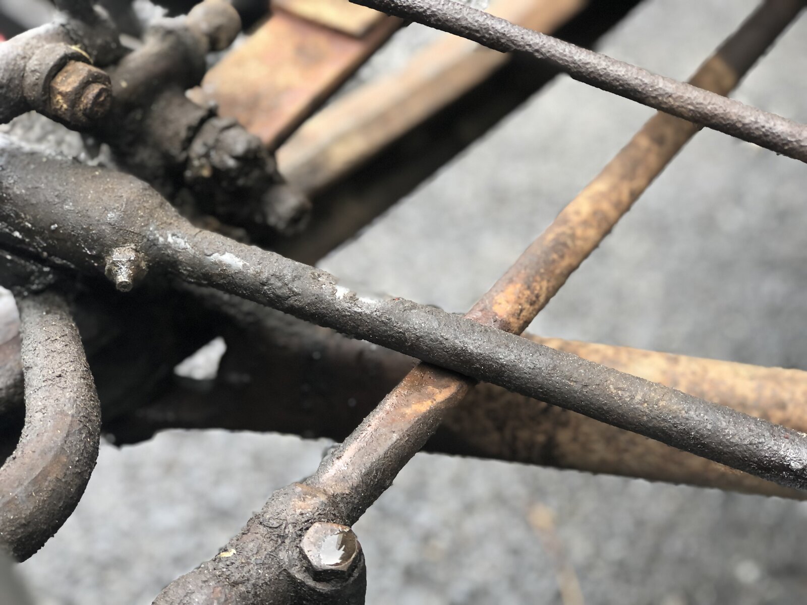

    A few things. First, I went through all the adjustments on my two tooth steering box and then added oil. The oil pretty much ran right through. 8D7EC21D-4721-478B-B95C-24BCC231826D.jpeg
    Then I realized that the drag link and tie rod have been wearing against other for some time now. Maybe a shorter pitman arm would solve this. 6FC989D1-127C-4267-8A5E-4788F0386D49.jpeg
