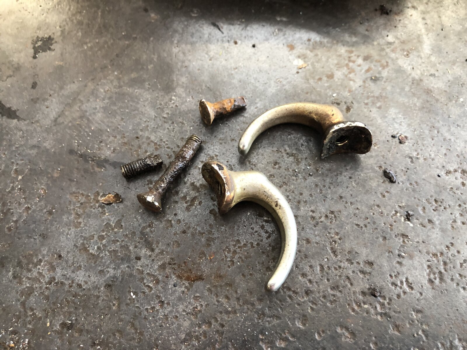

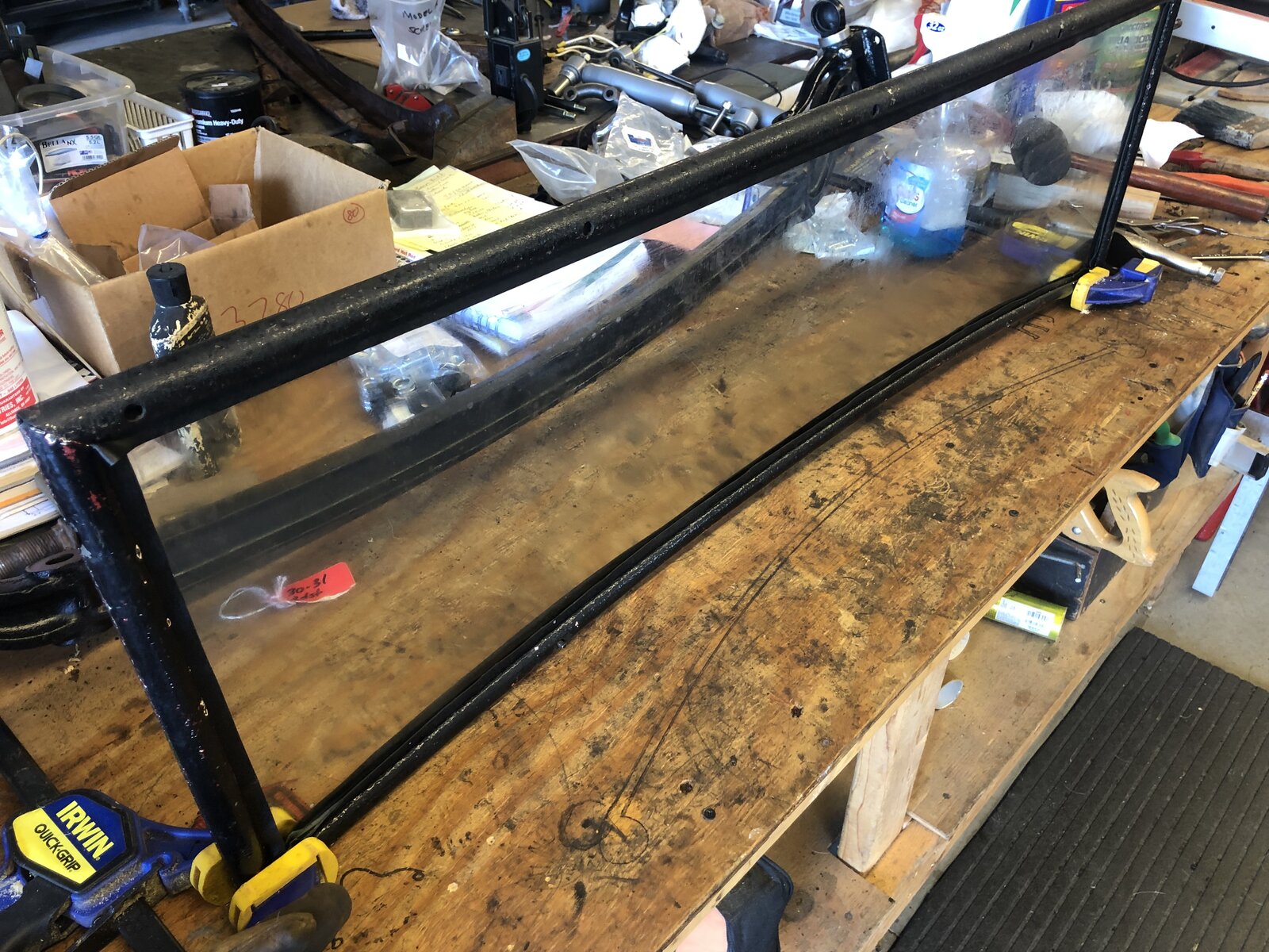

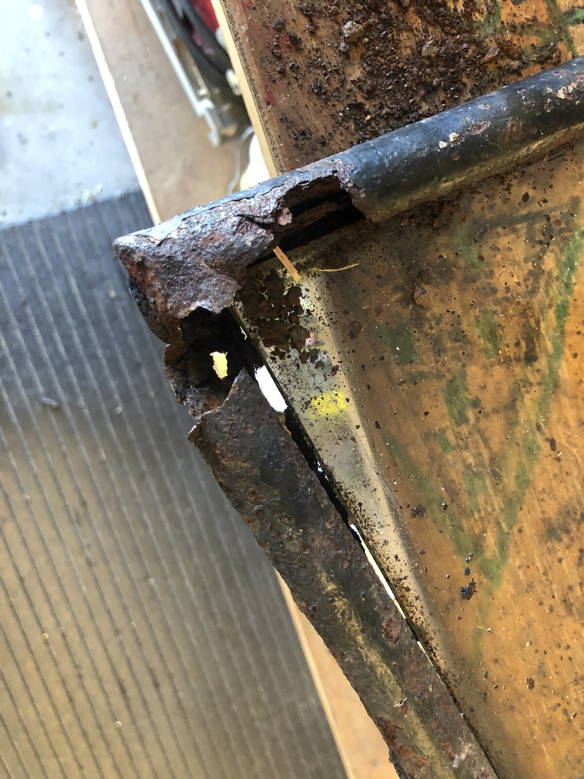

    I’m excited to get my windshield ***embled.
    I have been soaking my old frame with Kroil in anticipation of taking it apart to swap the gl*** into my new/old frame. Turns out I really didn’t need to since it was so rusted it basically fell apart.

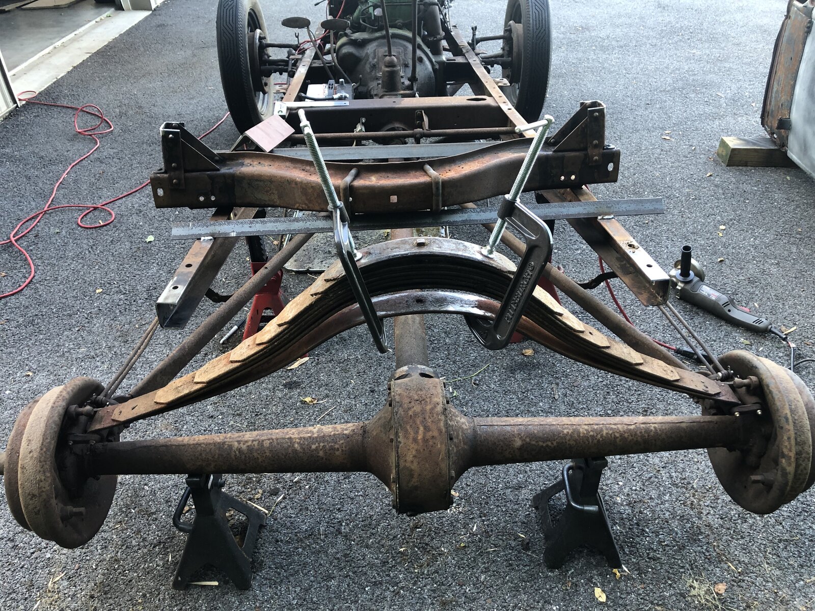

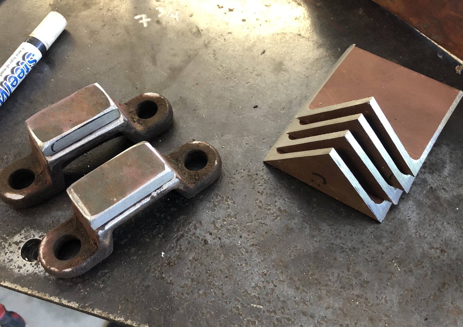

    Working on stepping the frame and taking out a few leaves from the rear spring pack. Interestingly, there are 9 leaves in the pack. I know roadsters should have only 7. Makes me doubt this was actually a roadster frame. Regardless, it will have only 4 when I ****on it back up. I know the leaves are probably different tension rates than roadster leaves… but I am gonna try 4 and see what that does. Not cutting any of them up this time :) F9C98384-BD21-4B81-9C79-7AC7F0A825AD.jpeg 8B5F01D9-C7A9-4550-94D8-8FA99488512D.jpeg

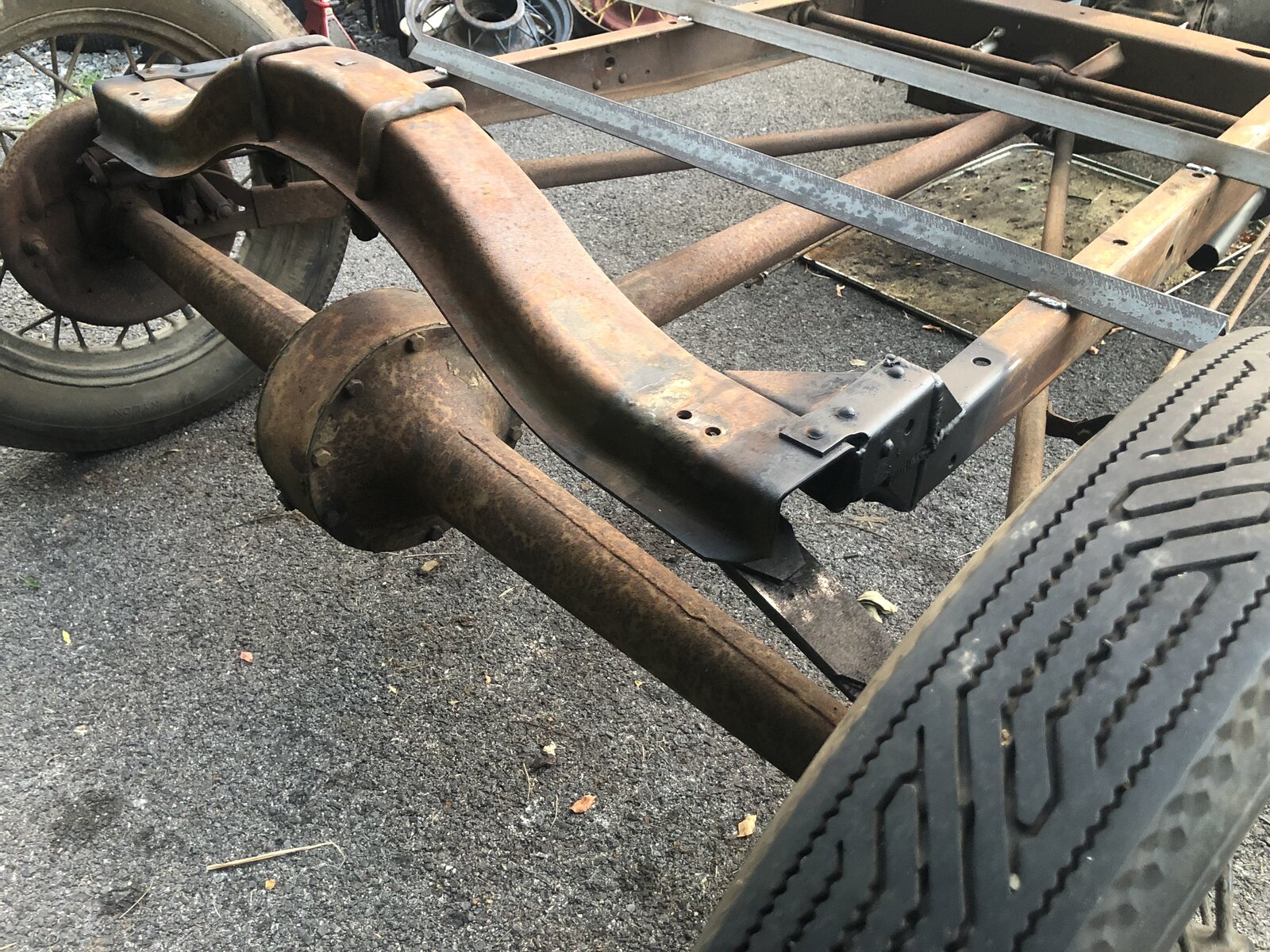

    Made a little progress tonight with the rear spring and the step. Decided to use a couple of the short springs as spacers and then also weld spacers on the u-bolt ‘brackets’. I tacked the rear crossmember in place and did a bit of a mock up. I’ll do some more measurements and finish it up sometime this weekend and then switch to the front end. I’m still sloshing evaporust and bolts around in the tank. It’s a pretty good workout. Doesn’t look clean in there yet. 845B4F11-629A-4560-AB3C-F72A0790D50C.jpeg 14952355-85A3-415E-90DE-F4165E52C019.jpeg

    Lots of small victories with the roadster this weekend.
    Finished stepping the rear and completed the install of the spring with 4 leaves.

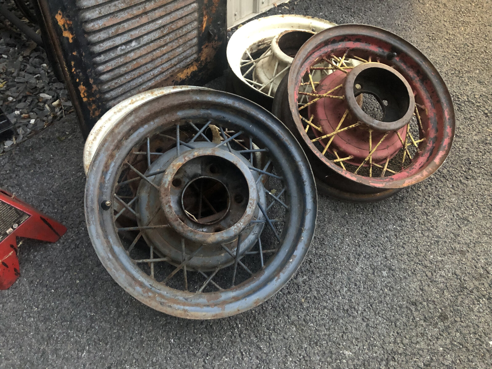

    I also got the old tires pulled off my 35 rims in anticipation of my new skins. E8DB4237-5D5B-47CD-A115-1722557B31A0.jpeg

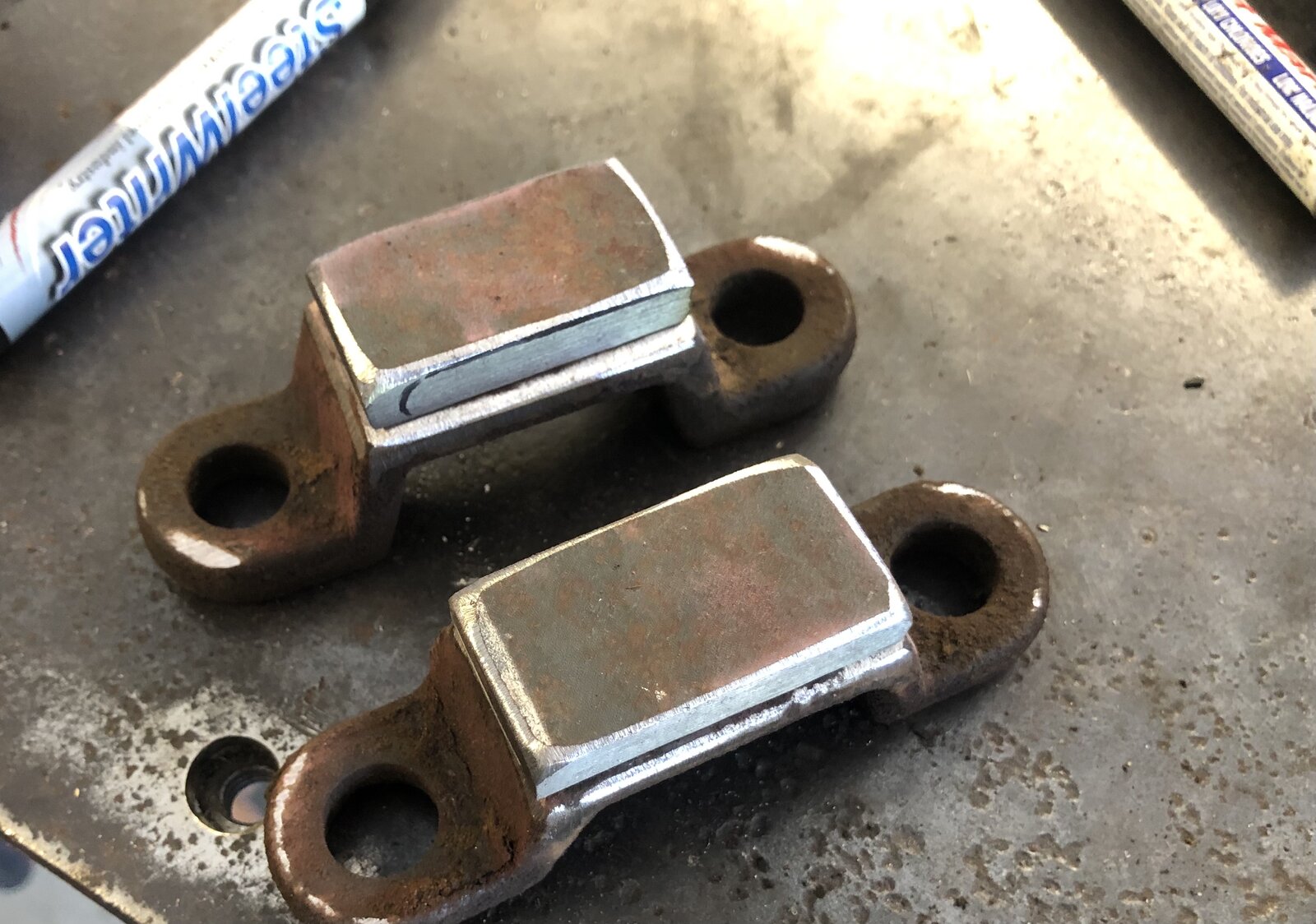

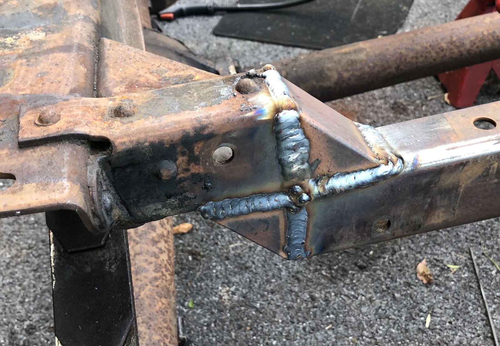

    Here is a better pic of my step welds for your critiquing pleasure. Ha! A3DB7128-21EC-4960-9C81-45B629065FED.jpeg I know they are not pretty. I’m not a trained welder but I penetrated the $hit out of them inside and out.
    Dannerr, Joe Blow, Aaron D. and 6 others like this.
