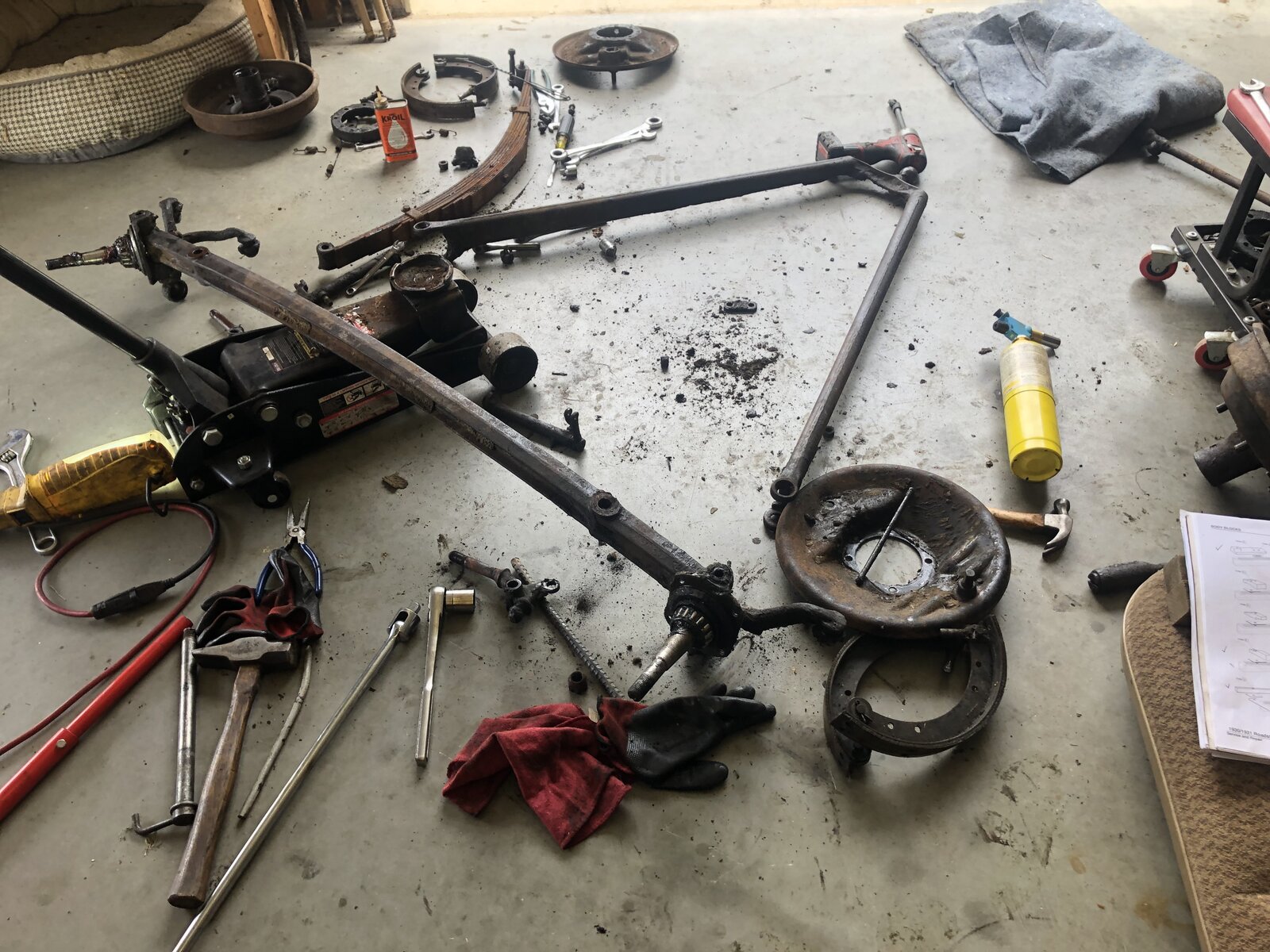

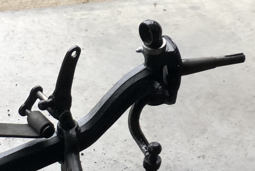

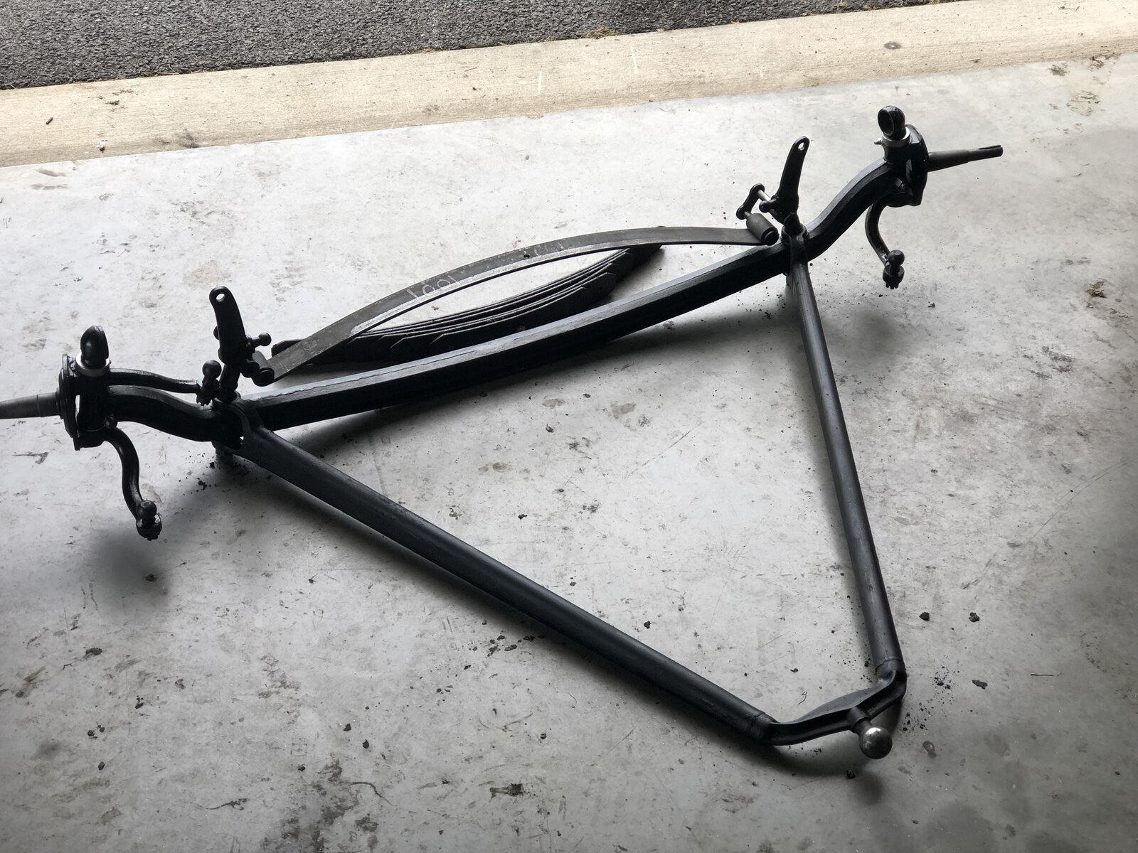

    Started working on the front end today. 4ADFF7E7-4DCF-45EE-BD38-7A5A1F0B04D9.jpeg B0BD68BC-A4DE-432B-9960-584F3A484DC8.jpeg 7423EF6E-525F-4F16-B831-AED49DEA2EE8.jpeg E463D590-34A2-40A8-B4E2-67E05613CA11.jpeg

    I know it’s hard to make out what I am doing in this pic. I had to heat and ‘re-bend’ my 32 spindles on my drop axle to get them to line up for my tie rod and drag link. D85E26B1-C0C4-4AEF-9DF0-375AB9DABF80.jpeg

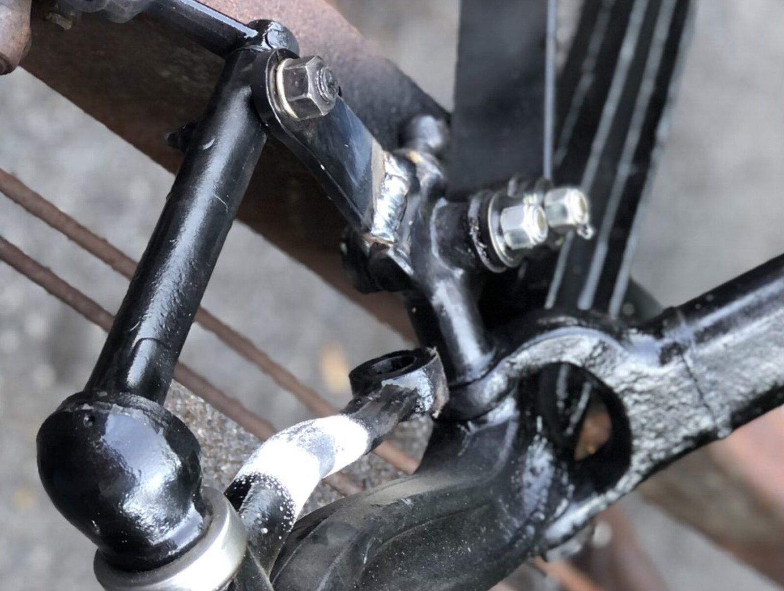

    During drop axle ***embly/mock up I discovered that my brake actuator arms wouldn’t line up with the cup on my king pins and the spring perch tabs I had. I ended up cutting the tabs off, grinding them a little shorter and tacking them in place once I bolted the arm in place and aligned it with the cup. Then I did my normal weld the $hit out of them technique. I think they are good now. BD7FBD41-818A-47FF-9053-6D608BBD71CD.jpeg

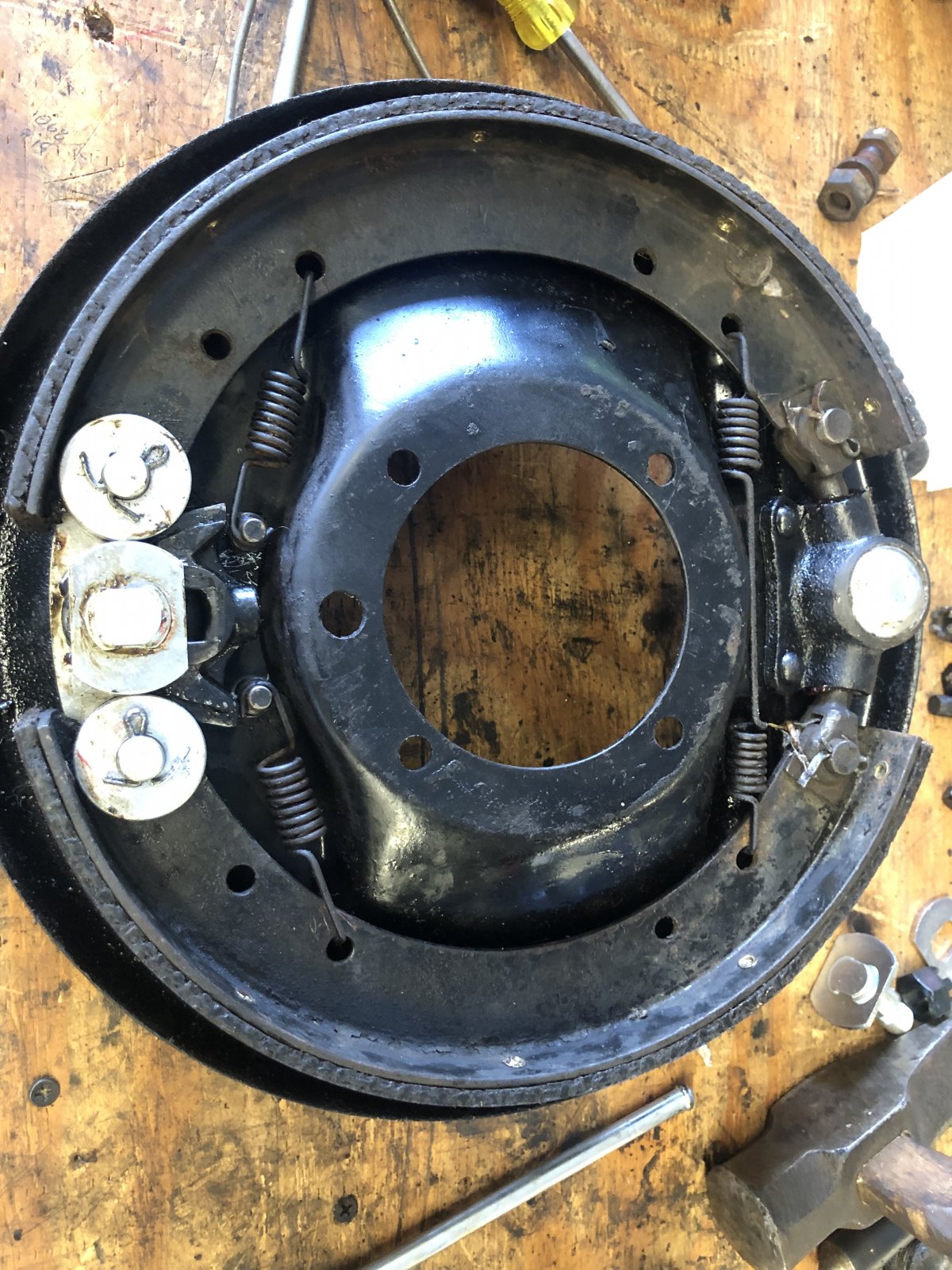

    I’m getting better at rebuilding backing plates for model a mechanical brakes.
    1E9D2E25-4C4C-4633-84D4-98CB314FAE6B.jpeg 1340B708-D953-4D0C-8BF4-7C22FA5456BF.jpeg

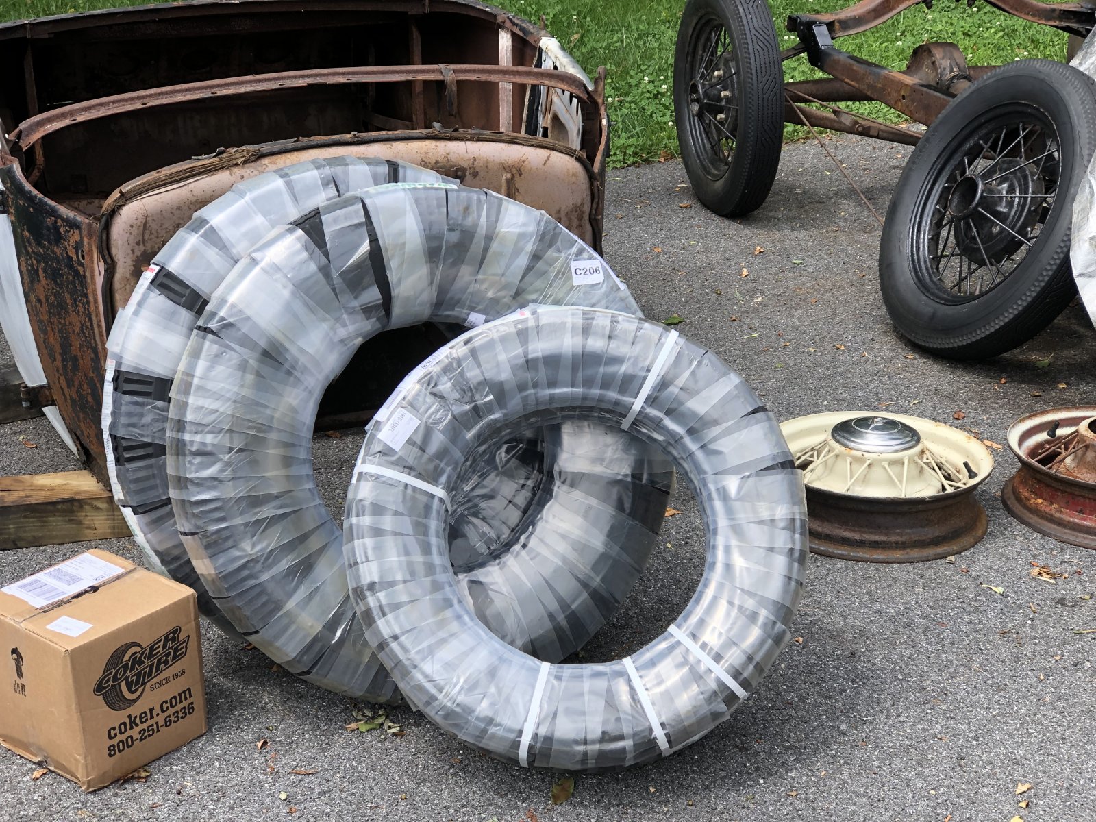

    Excited to get my new tires on the 16” rims. B9E2104B-B521-4A27-A5F6-4088B1AFE969.jpeg

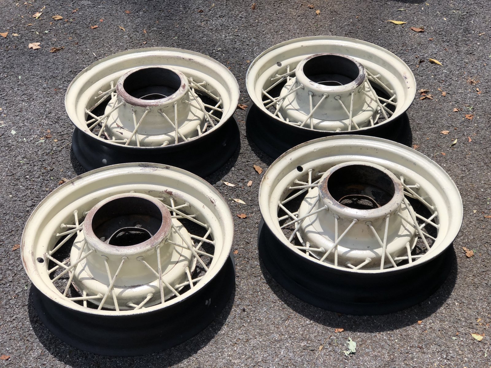

    Each of my 16” rims were different colors. Or were… they are very rusty.
    I talked my artist wife into making them all one color but not perfect. They need to look the part. I chose to go with the one that was almond color.

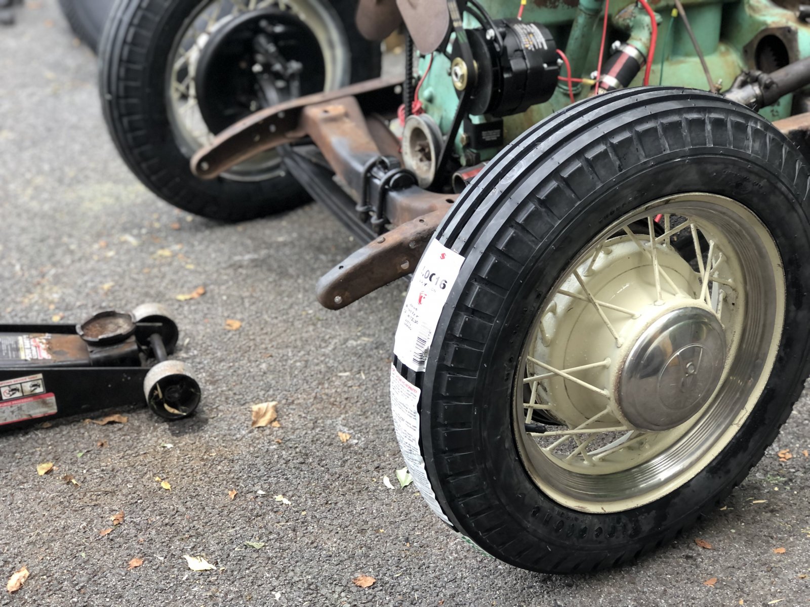

    You guys know how impatient I am. I finished the backing plates while the wheels were drying in the sun. As soon as they were dry enough I stuck the front ‘dirt track’ tires on my ‘new’ rims. I couldn’t wait to see the stance with the drop axle. I’m very happy with how it turned out. 71BC6677-9BBB-4767-8A40-5FA824617D95.jpeg DE493E8D-76E5-4E57-B2F8-BD8F05A5184E.jpeg

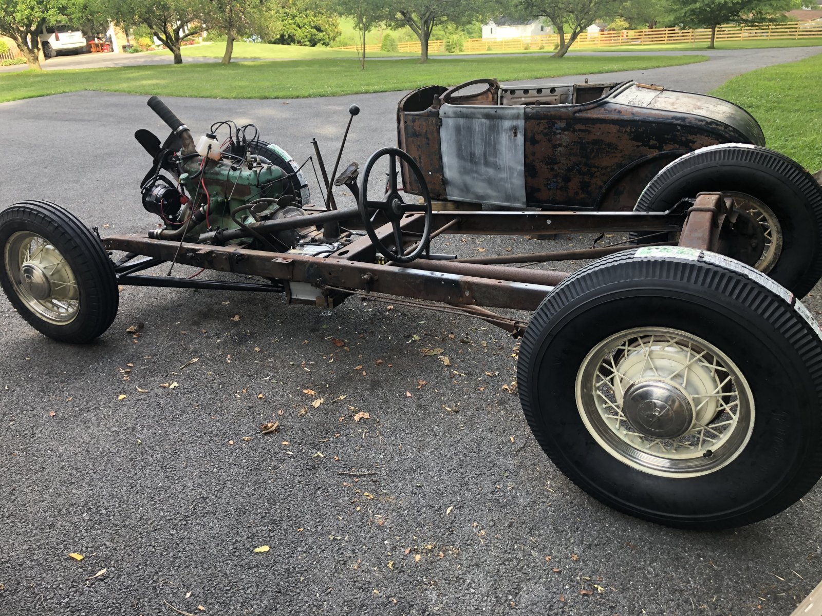

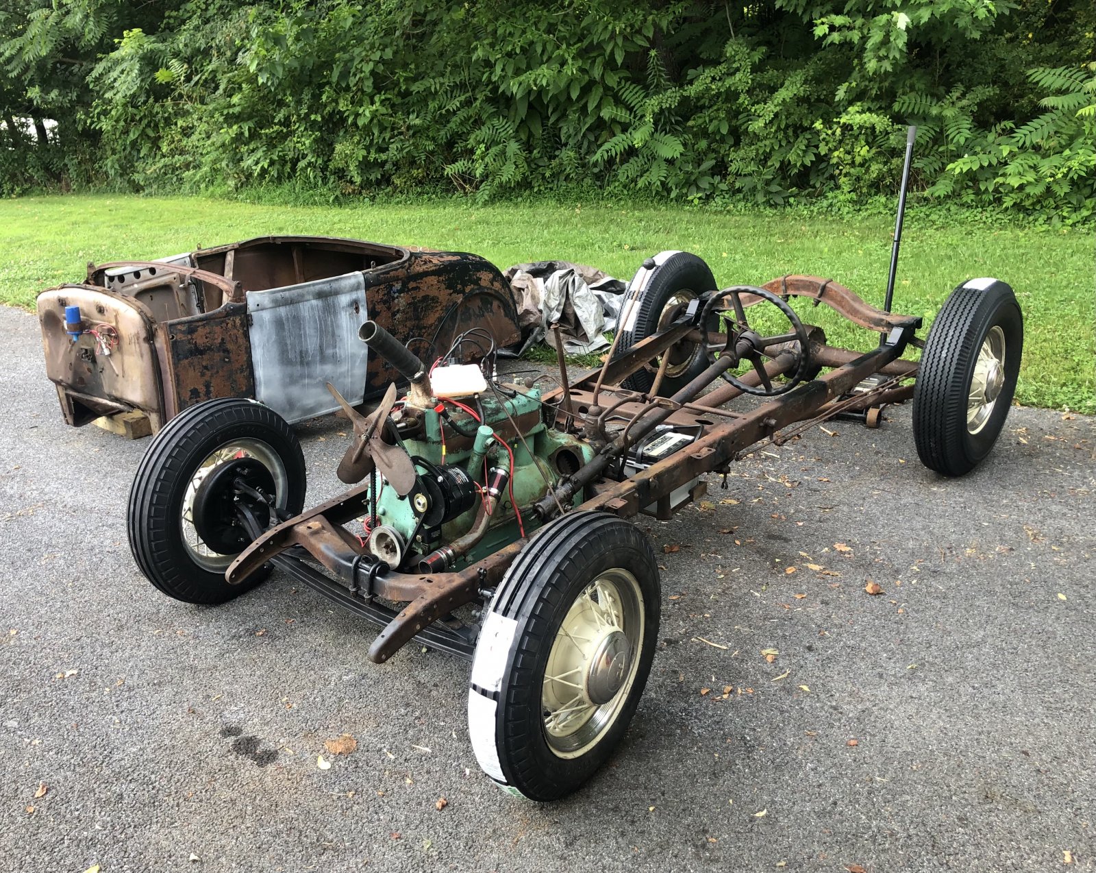

    Got all four wheels and tires on the car.
    4D96362F-017A-4167-B9CB-B2829F9C3B02.jpeg A14D88AF-5B6E-4CAD-A6F3-48BF312D0C96.jpeg

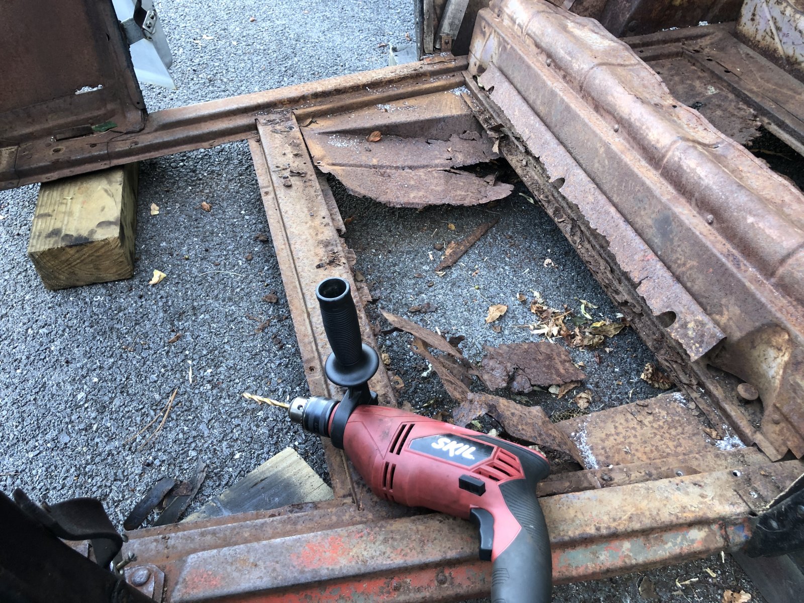

    Finally started working on the body. Began removing the rusted out floor pans. Found the sub rails are in worse shape than I expected.
    353FE5C5-95BA-4631-B4F9-372049AA8887.jpeg 0368499F-DB55-443B-9BBC-B6C48072F944.jpeg
