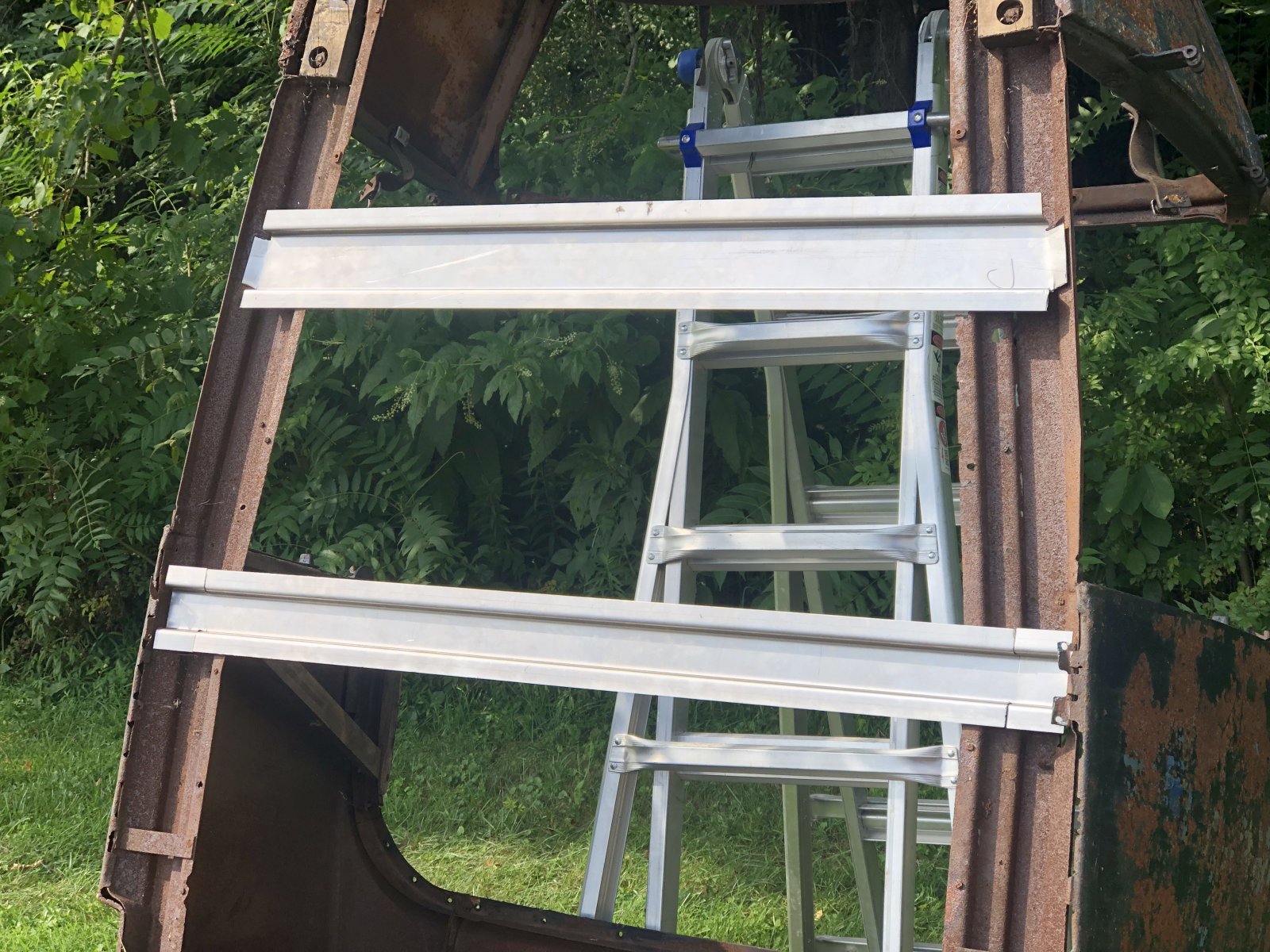

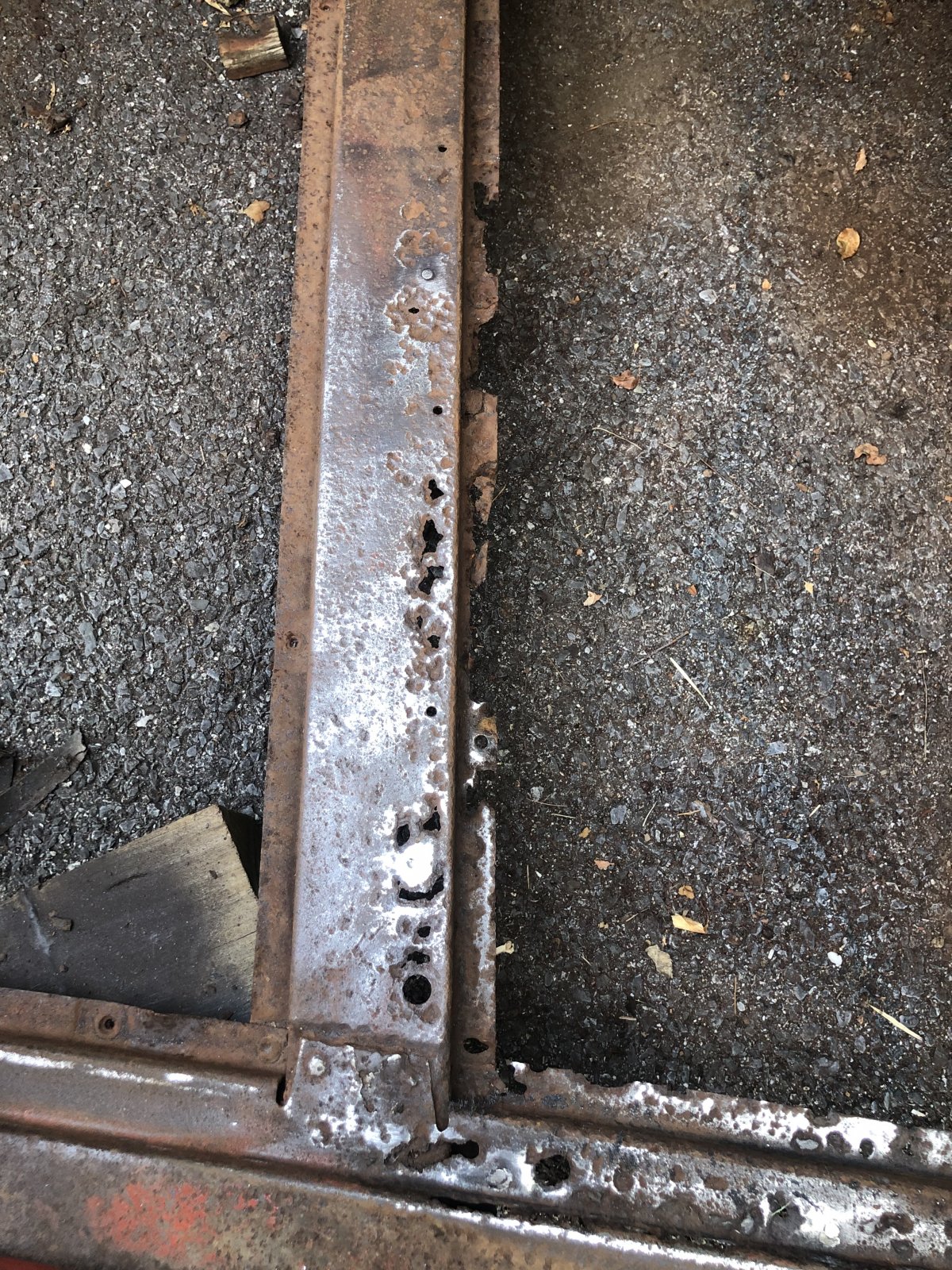

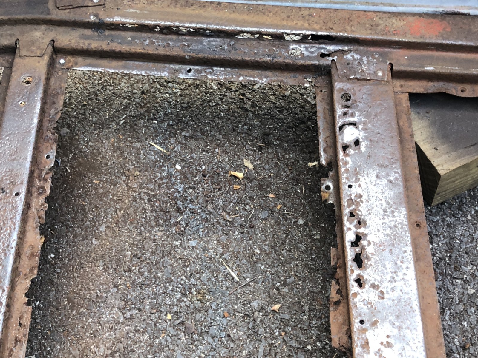

    Slow progress on the floor pans. I have sub rail repairs to make. My plan is to patch and strengthen and then apply rust encapsulater. EC574340-A4BD-4868-A696-408CC49288A6.jpeg AB672B81-ED93-4999-A319-4808F2AEB36C.jpeg B2D54D01-9201-4C4B-B295-CD2AE9A0E691.jpeg 8B3ADFC0-1E9C-433B-BF7F-920AA71599B9.jpeg

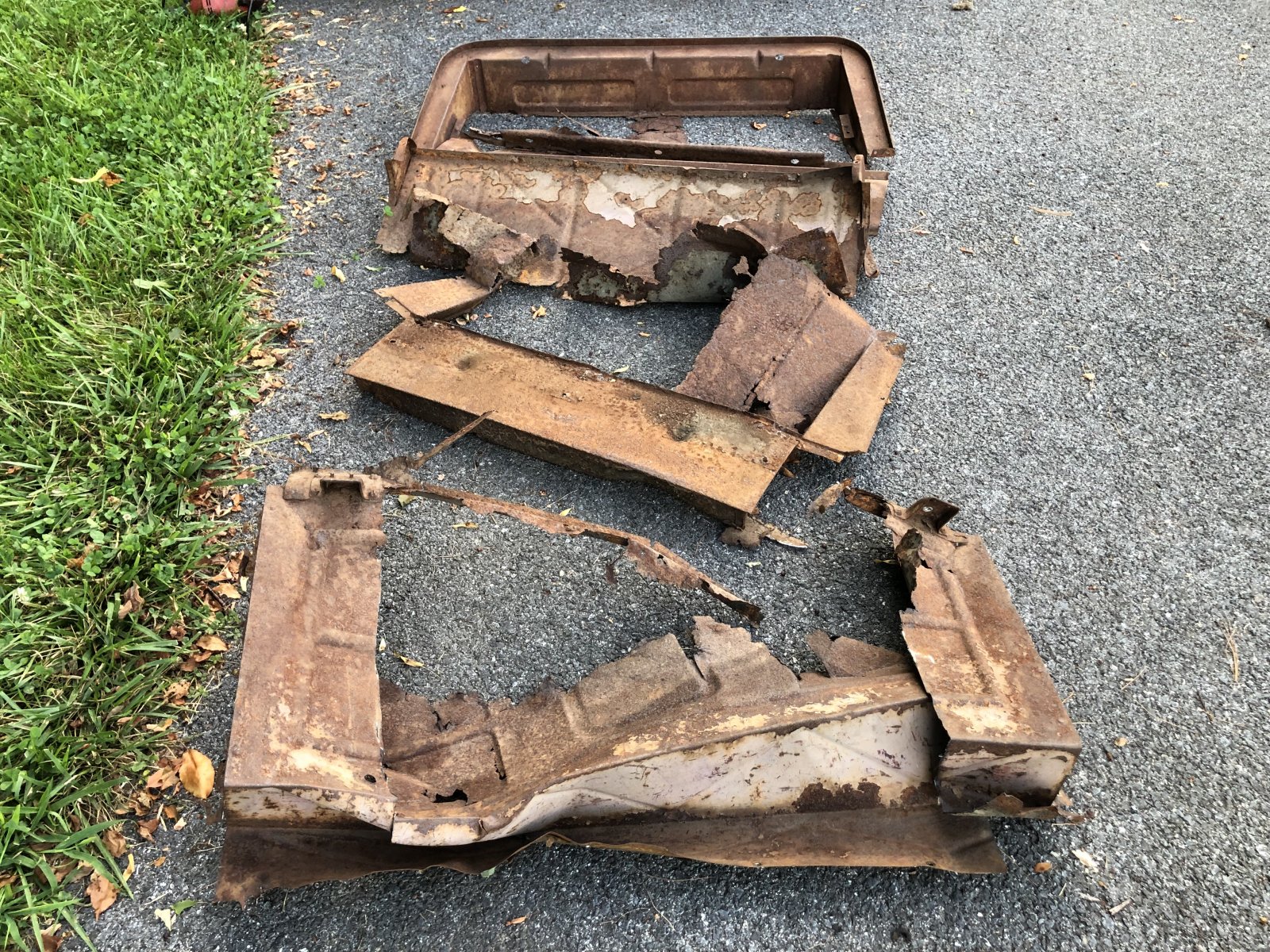

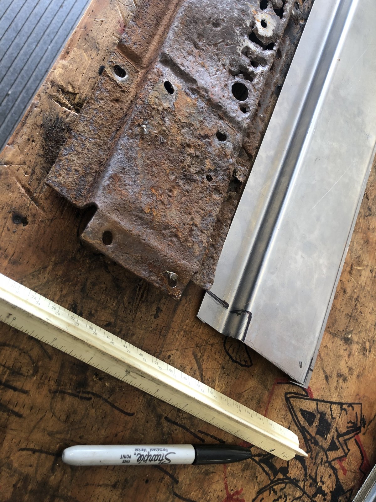

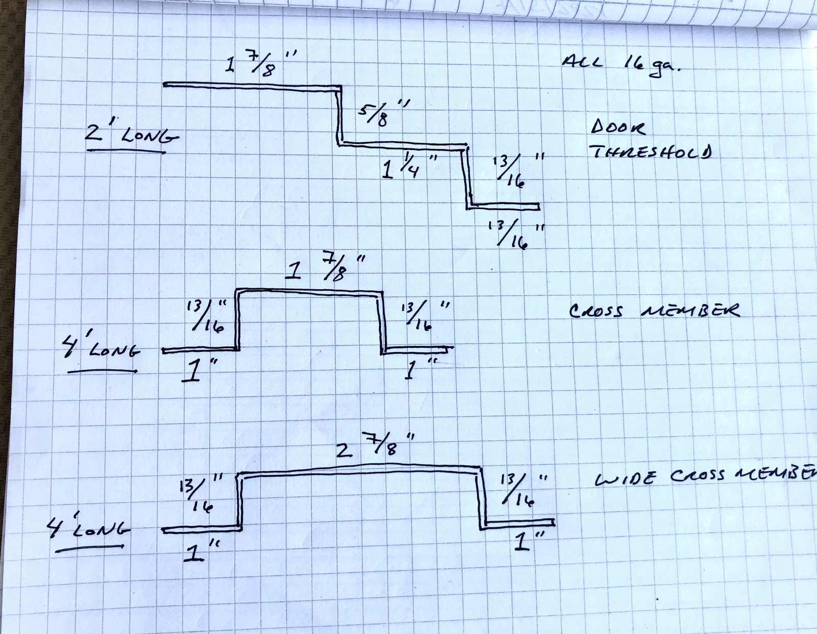

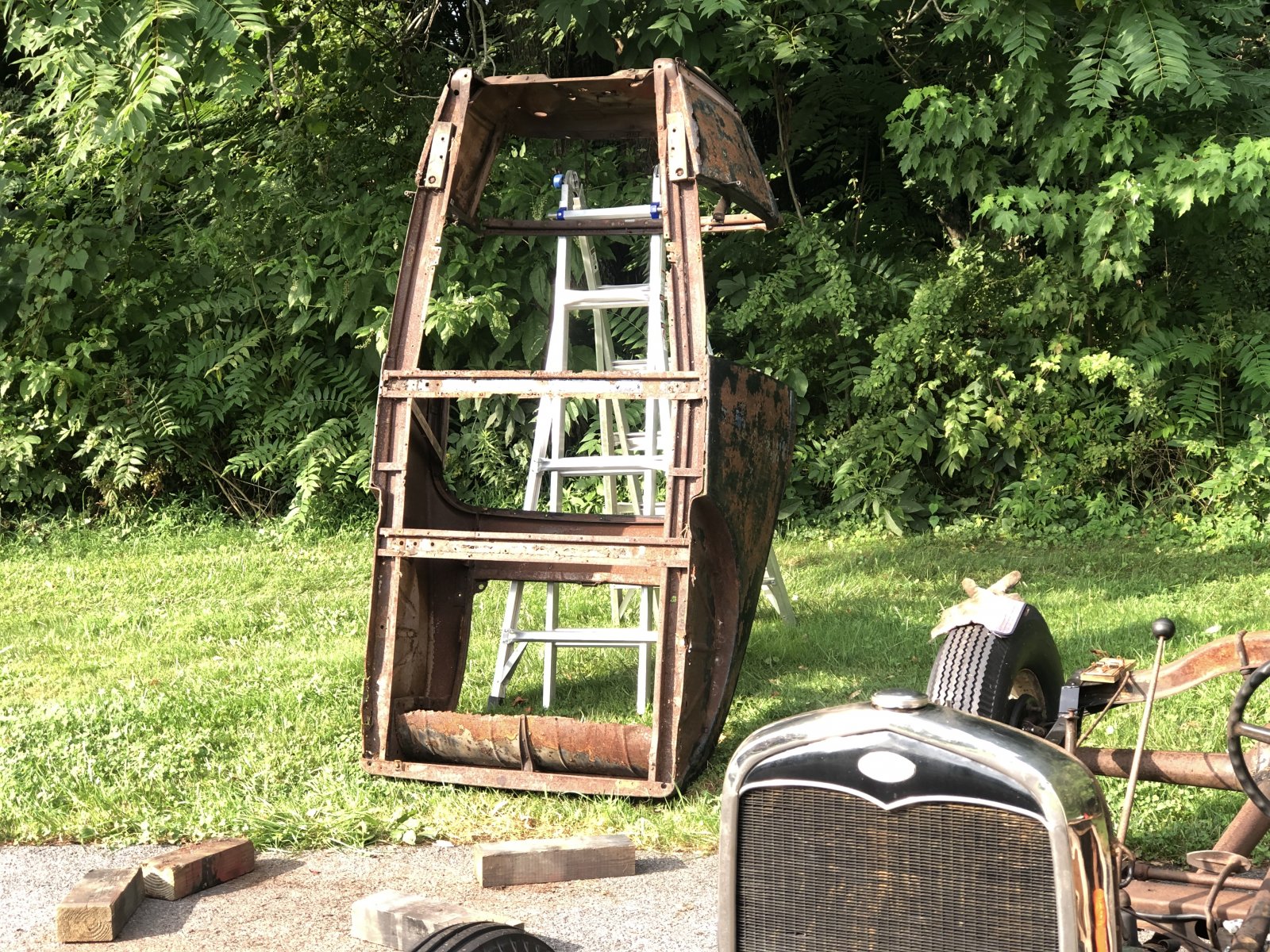

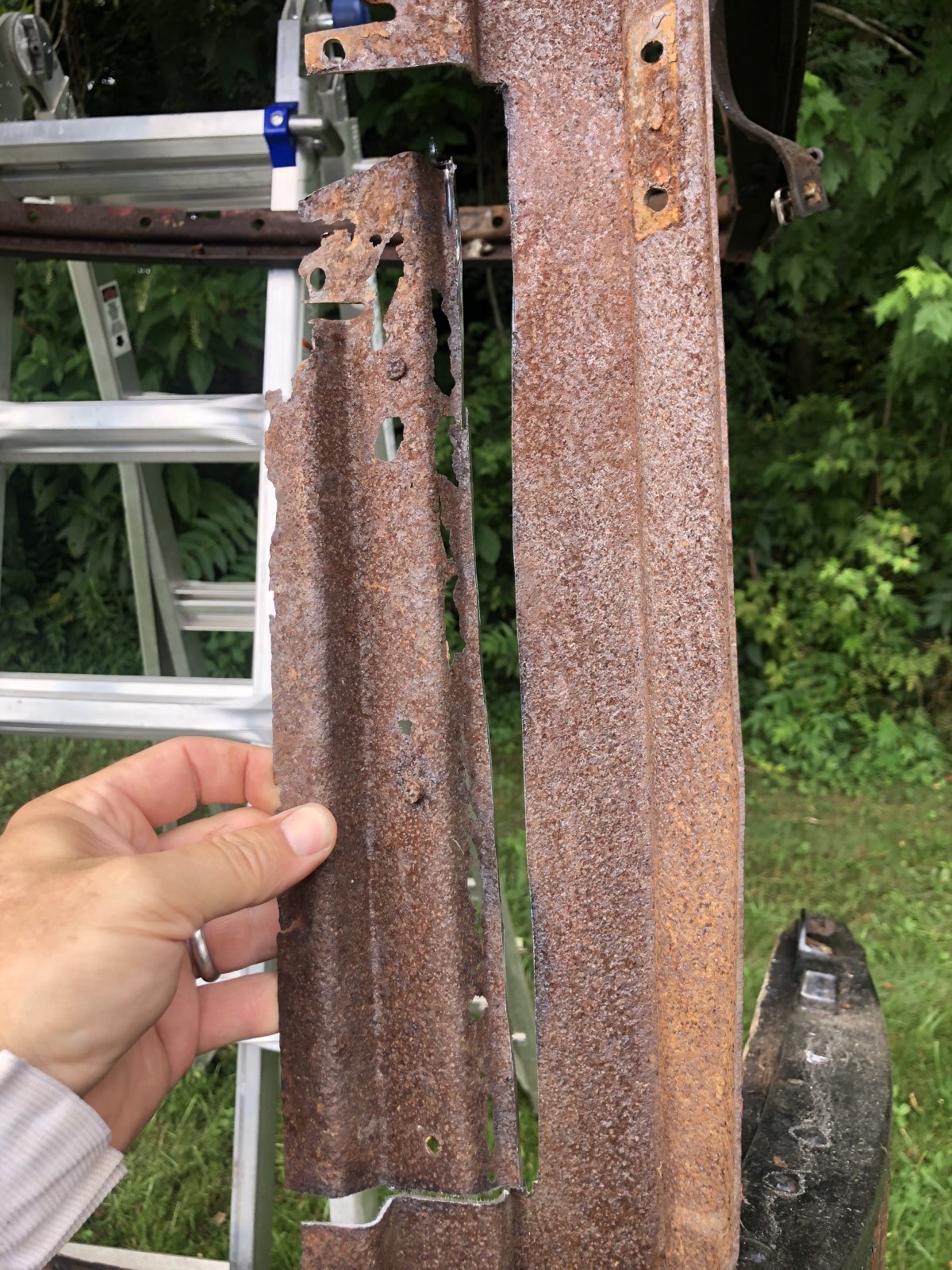

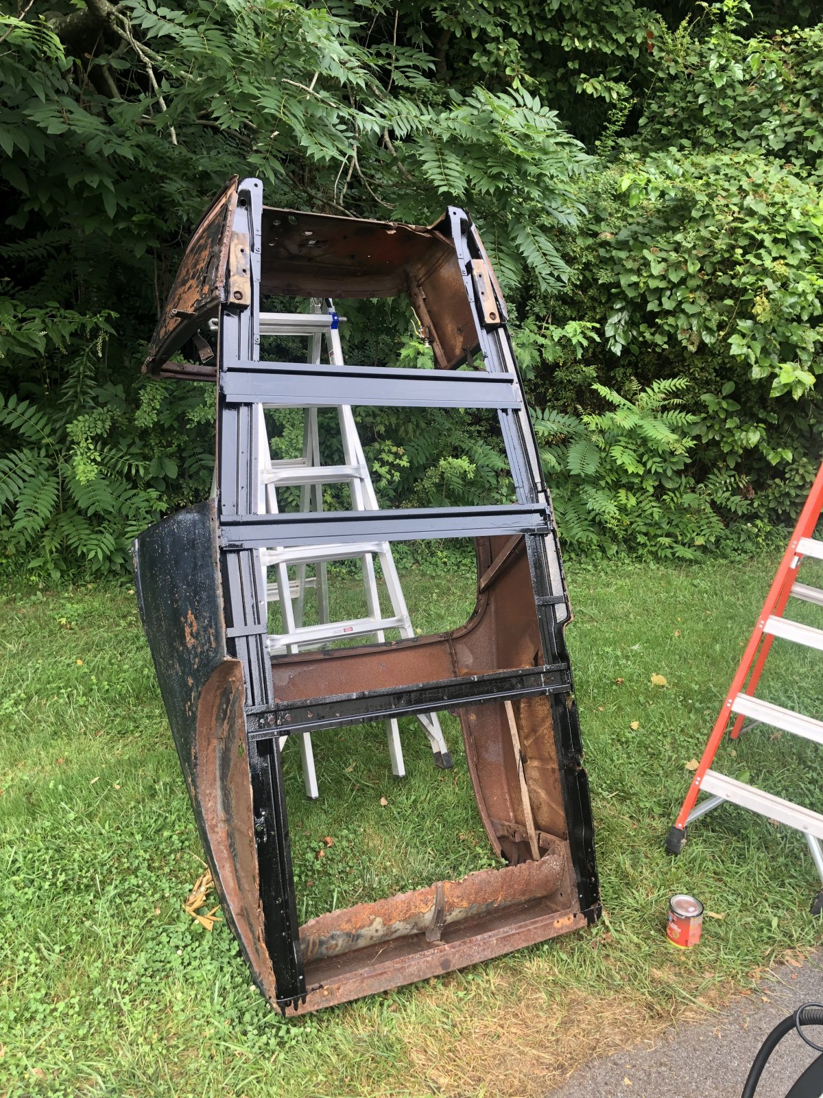

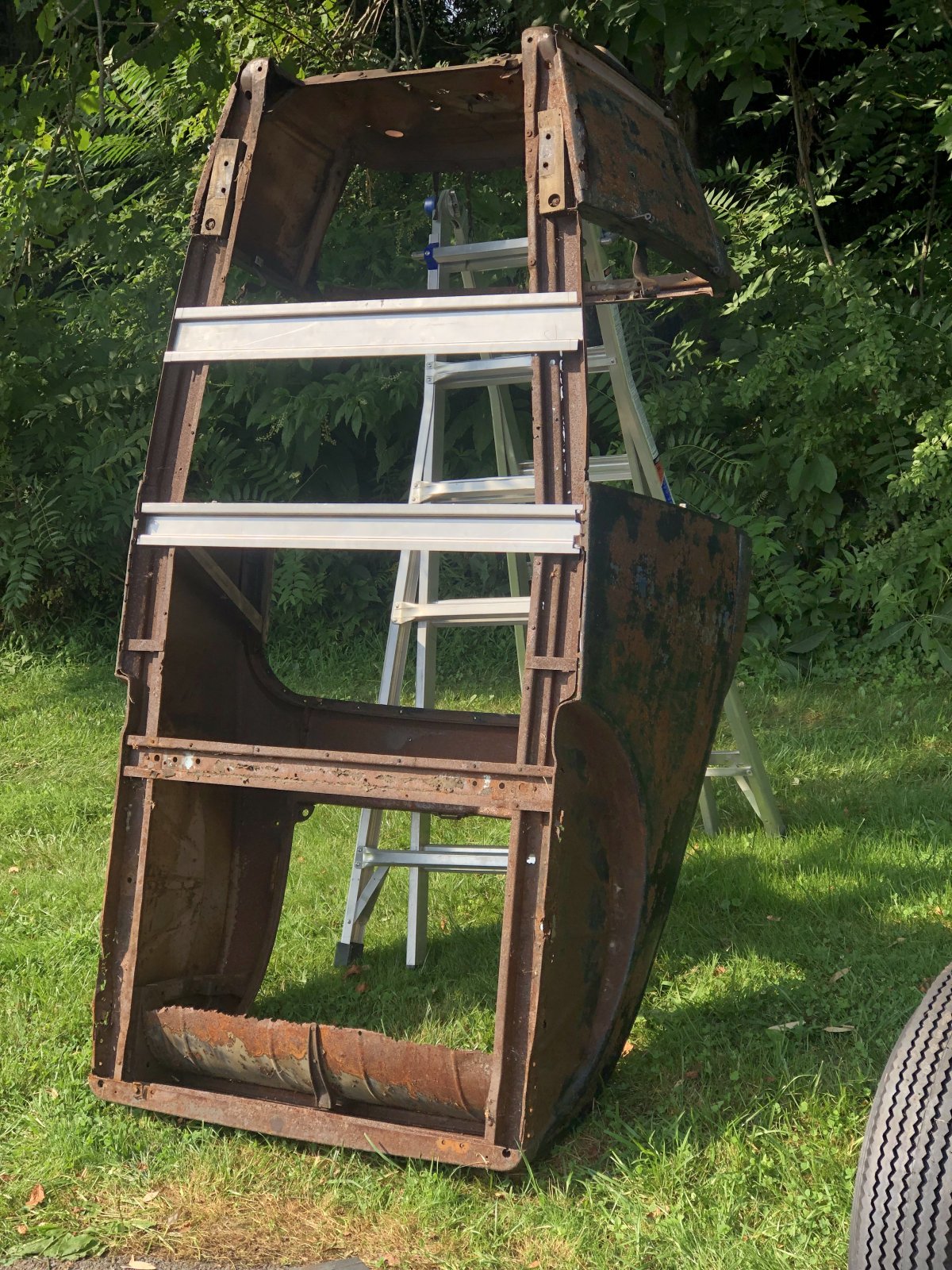

    Removed some of the worst pieces of sub rails/cross members. Having some new ones made locally to replace/patch.

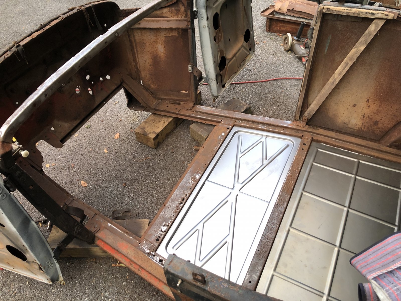

    Seems I have a couple extra air holes in my firewall. Any recommendations/opinions on which ones to keep and which ones to patch?

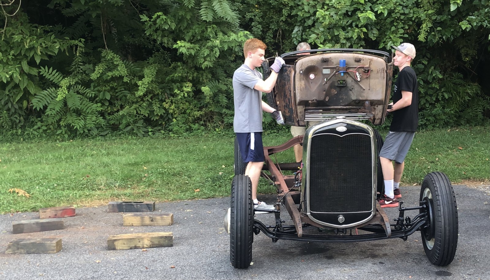

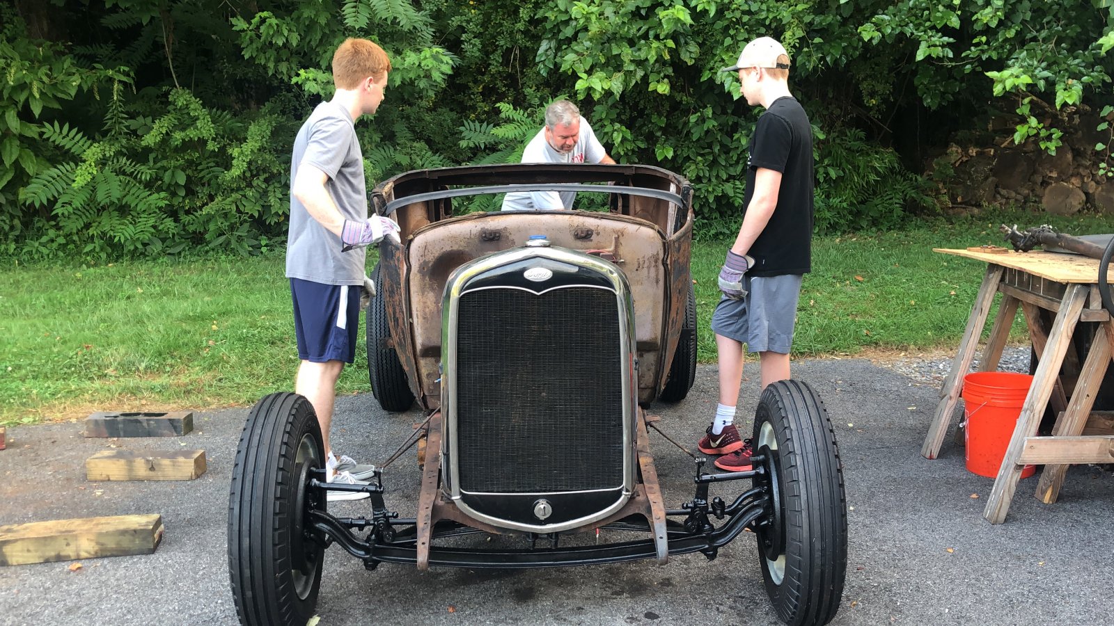

    All backing plates, brakes, hubs, bearings, brake rods, wheels… complete.
    Kaden helped install the new/old radiator, hoses, and new/old 31 shell.

    Kaden, the future of Hot-Rodding!:D

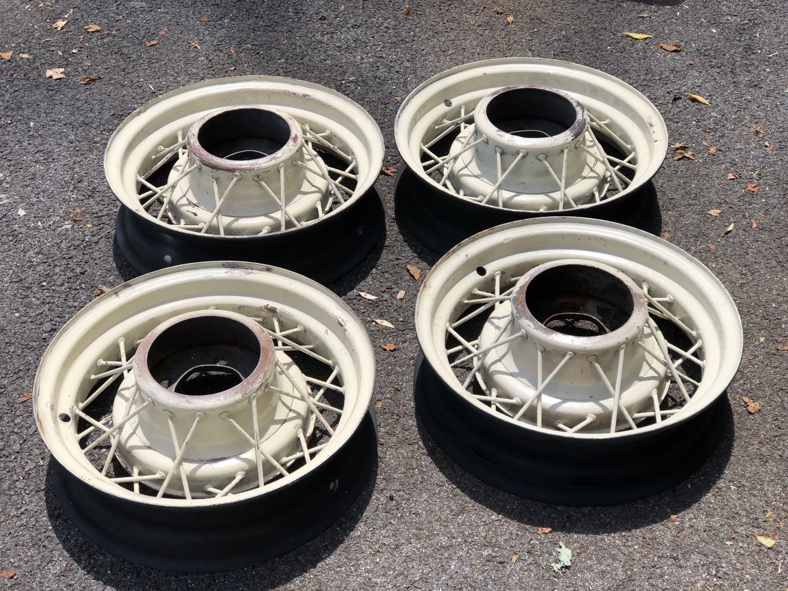

    @Dustyp489 - you recognize these wheels? TM

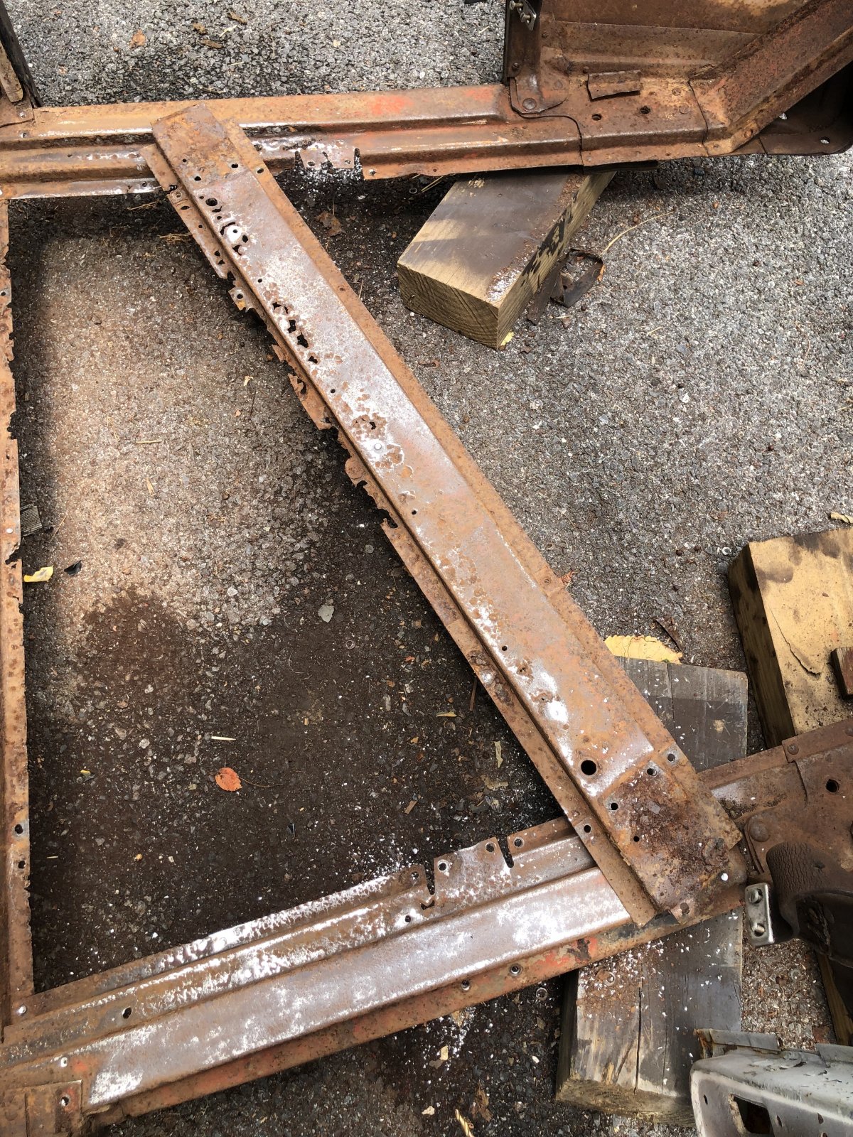

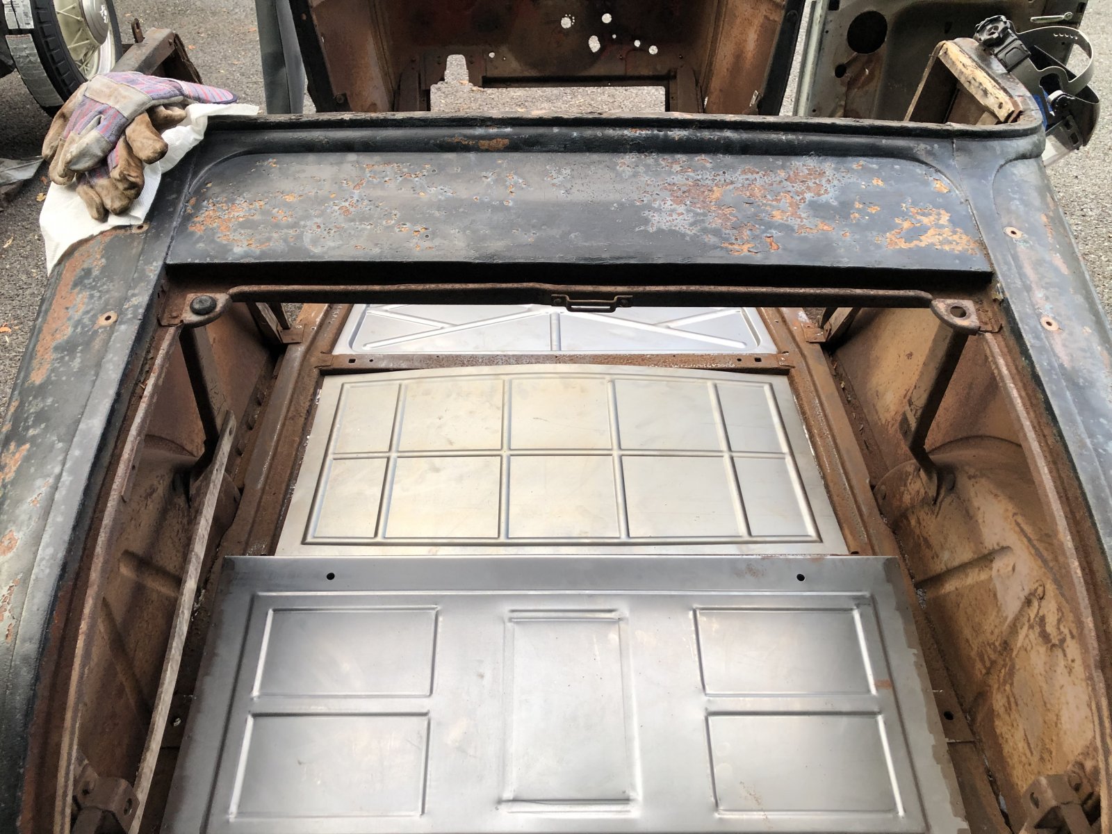

    218DD79C-35EF-40D8-8290-28F99161A038.jpeg EB279612-29F8-49BB-8CF9-19A64DF9D08B.jpeg Slowly doing work on the body. Trying to get the cross members and floor pans patched and ready to install. I really feel like a monkey trying to F a football. No experience with this at all. I spend a lot of time moving parts around and looking at them. Ha!
