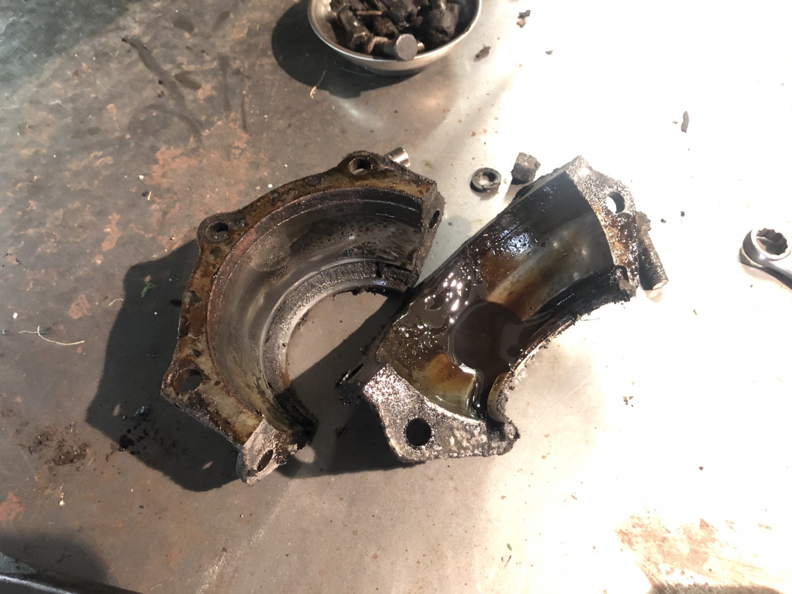

    This evening I pulled the clamshell apart (Some of the worst nuts and bolts placement on a Model A in my opinion. No socket or wrench can really get a good turn on those! Ugh!). I found that there was no felt/rope gasket on the rear bottom half. That was actually good news. I cleaned everything up and installed new gaskets. I’ll test it out tomorrow. I’m pretty confident it will be at least less leaky. F34A7361-E59E-4DDF-8811-426D7FDC4F01.jpeg

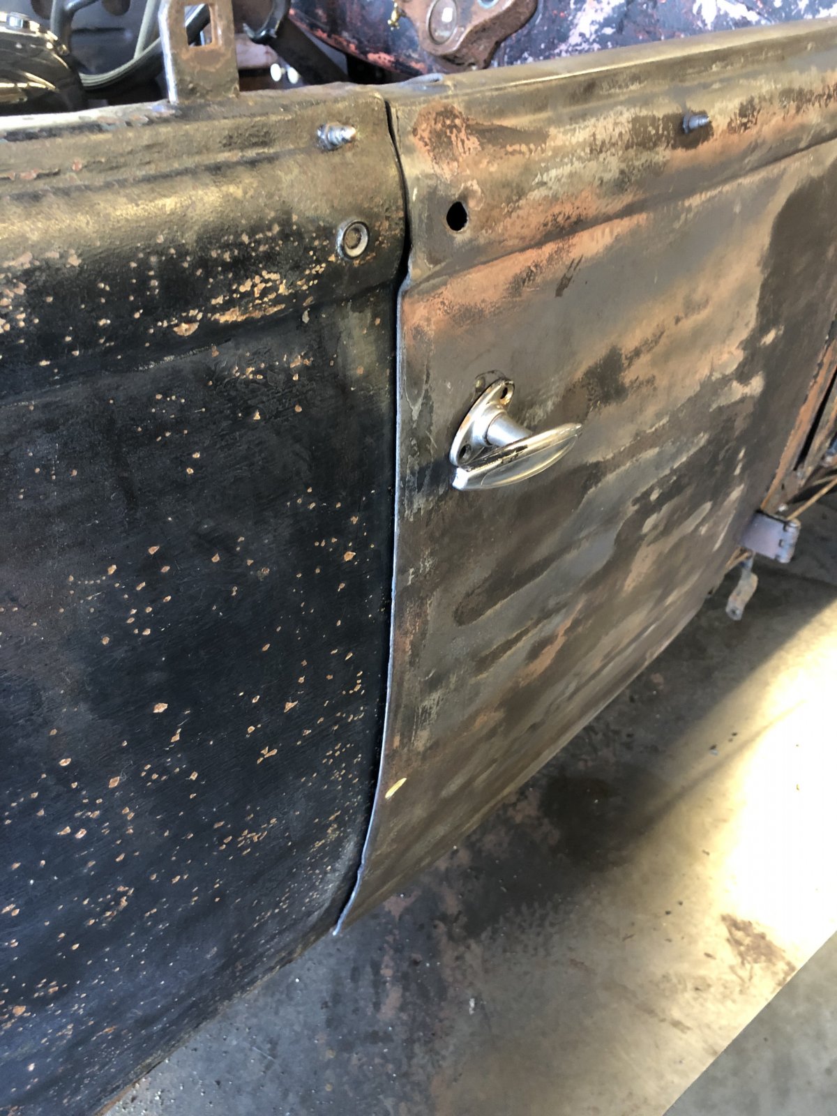

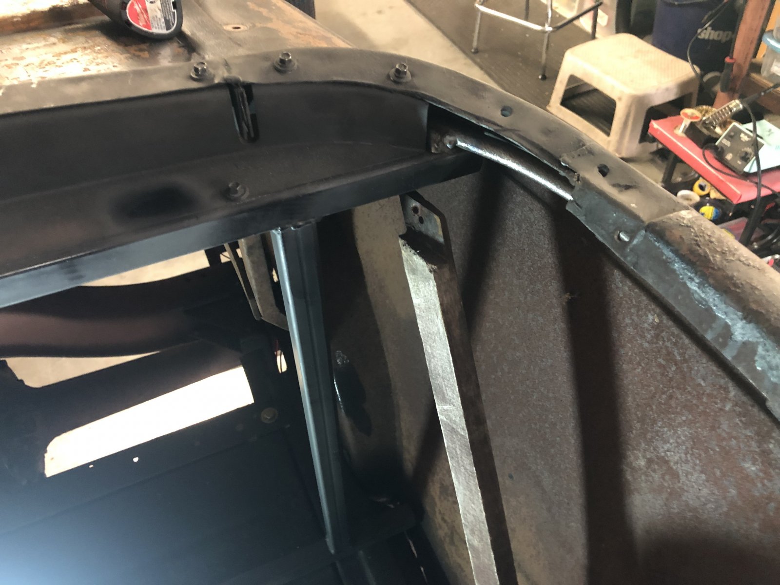

    I started working on the quarter panels and door alignment. I have zero experience as a body man other than YouTube. I’ll post some before and after pics when I get to ‘after’. TM

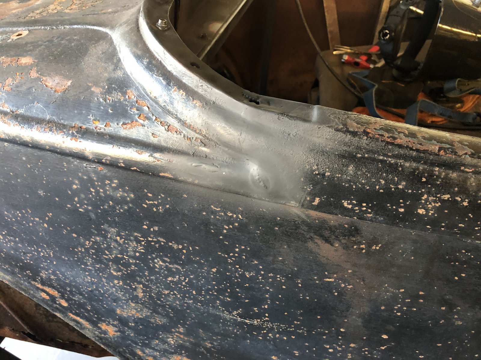

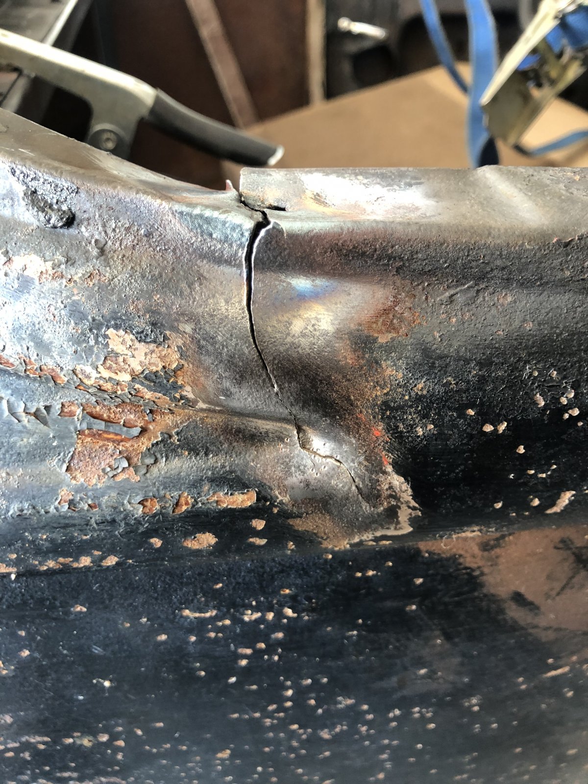

    Tribalmonkey

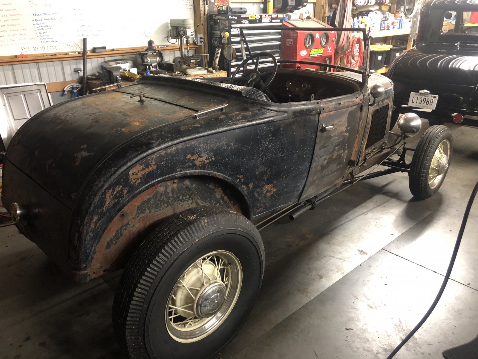

    Before and after pics of the quarter panels.
    D5F7E2DD-86DE-4337-ABE9-B3424BF01EDD.jpeg 666DC63E-8F5D-4720-B3C3-18742AC46D48.jpeg 18C4C6AE-DEF3-4D8A-8174-48E30122BF82.jpeg 59AFA5A1-E23D-4E5B-BD36-66510FC9421F.jpeg BE7F647F-7C1A-474C-BA57-58DF6ADD9601.jpeg
  9. Tribalmonkey
    Joined: Feb 17, 2019
    Posts: 921

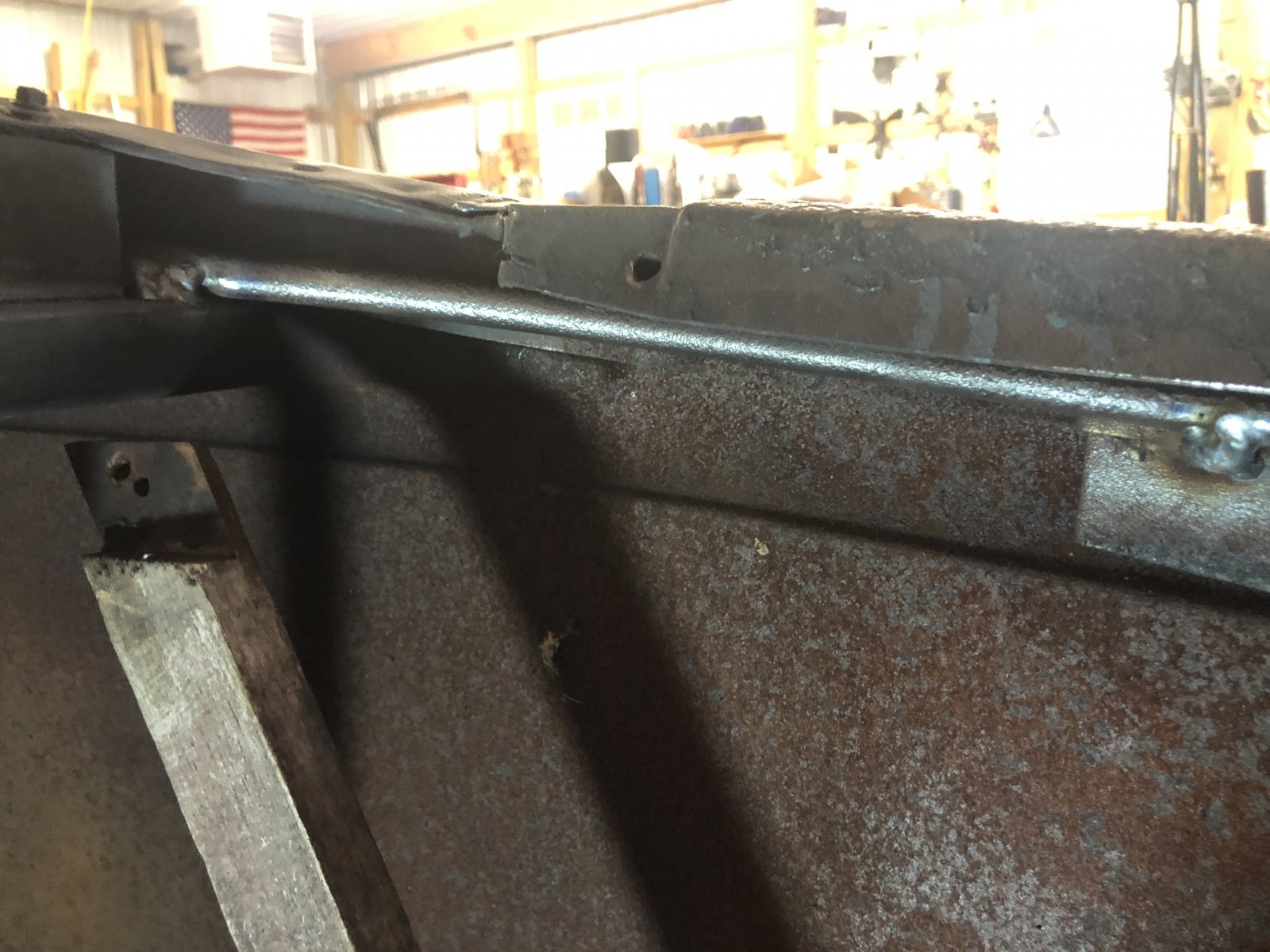

    Tribalmonkey

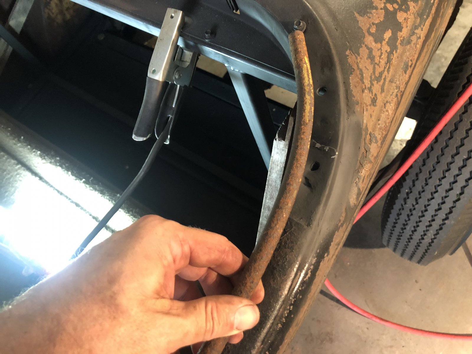

    I bent and welded in a steel rod on each side. That along with welding up the cracks made a huge difference. Very solid now.

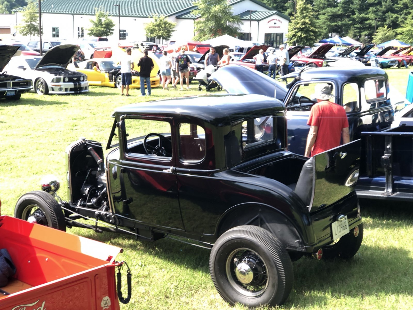

    Tribalmonkey
    We took ‘Pappy’ (the coupe) to the Middletown, MD car show sponsored by the Middletown Fire Department last Saturday. Really fun to hangout with friends and answer questions about the car. B8124FFB-76AA-4C5B-9109-8FBB61D24958.jpeg 938D49BE-6EEF-44FD-BA3D-C1BC6FC3678E.jpeg

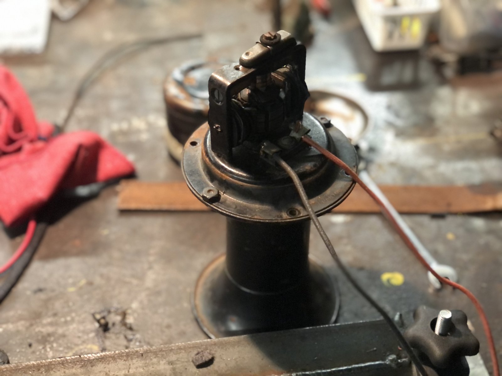

    Tribalmonkey
    Tried to get my original Spartan ahooga horn to work last night. Horn spins too fast at 12v and doesn’t work at all with the horn resistor. Any ideas? DE402297-EFB9-4DFF-B706-BC7E2D0E3EC7.jpeg

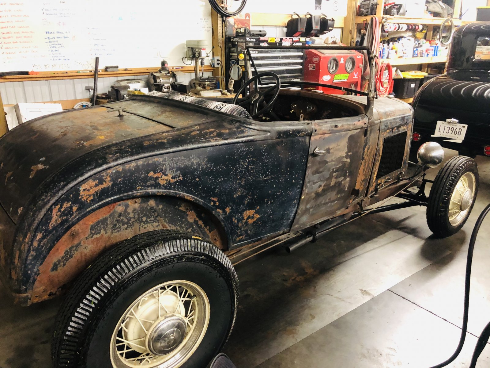

  19. Tribalmonkey
    Posts: 921
    Tribalmonkey
    Couple more minor changes. One you might notice. One is too subtle.

  20. Joe Blow
    Joined: Oct 29, 2016
    Posts: 1,904
    Joe Blow
    Looks like you have the center section of your tack rail in.
  21. Tribalmonkey
    Posts: 921
    Tribalmonkey
    Yes! You guys are good. I also added the stainless cowl trim piece. I was not going to install the cowl lights and trim until I patched the rusty bottoms of the cowl sides but I don’t plan to do that patching for a while.

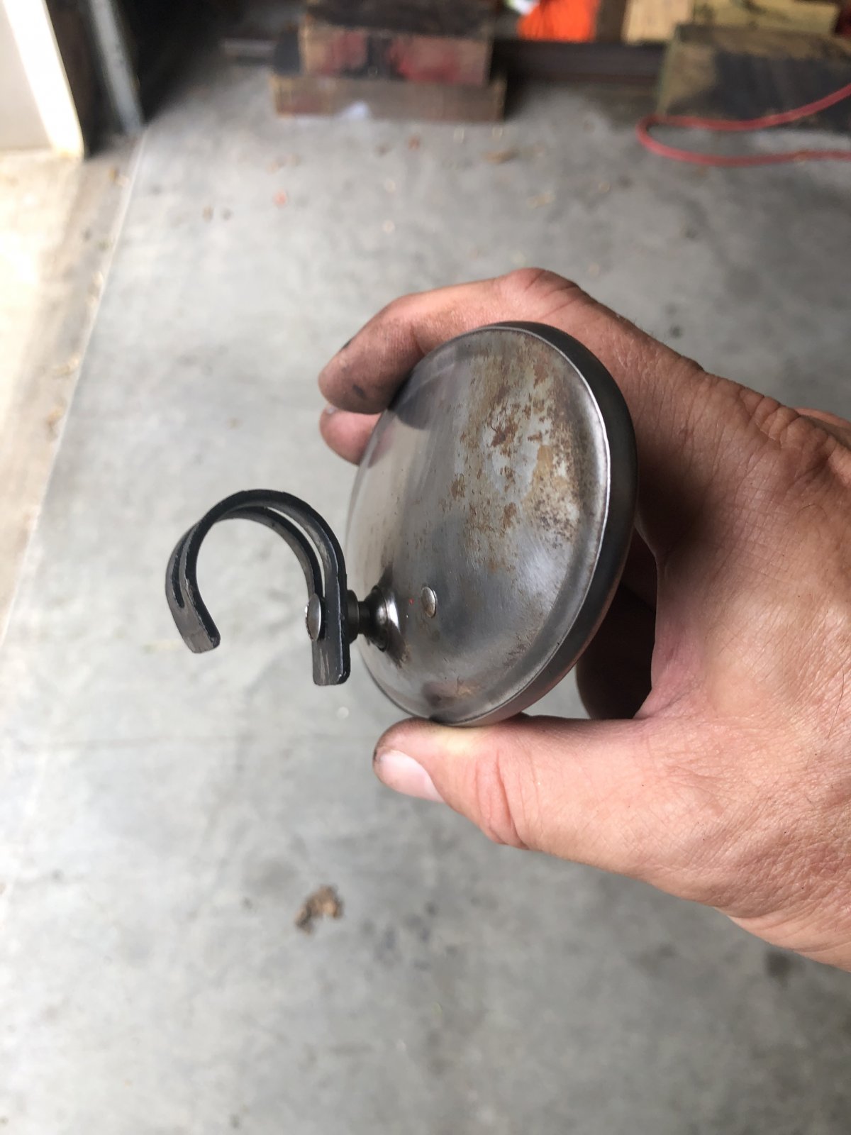

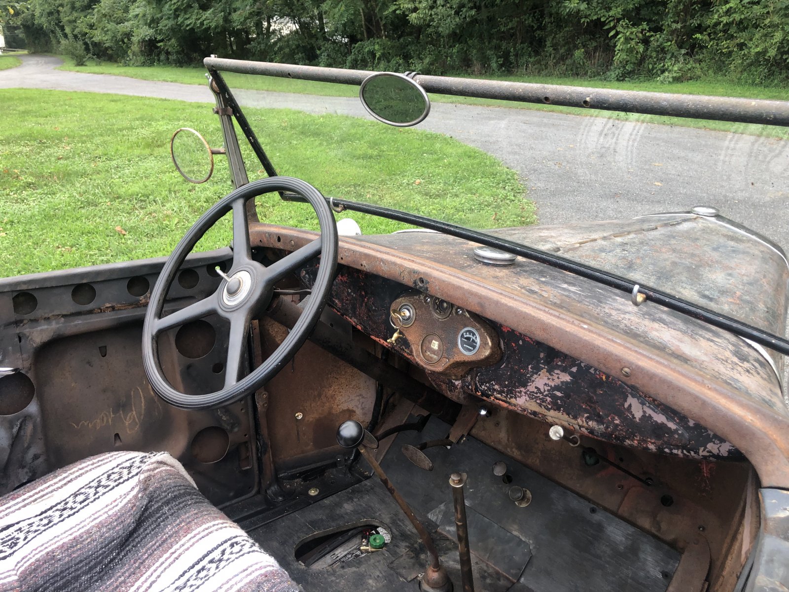

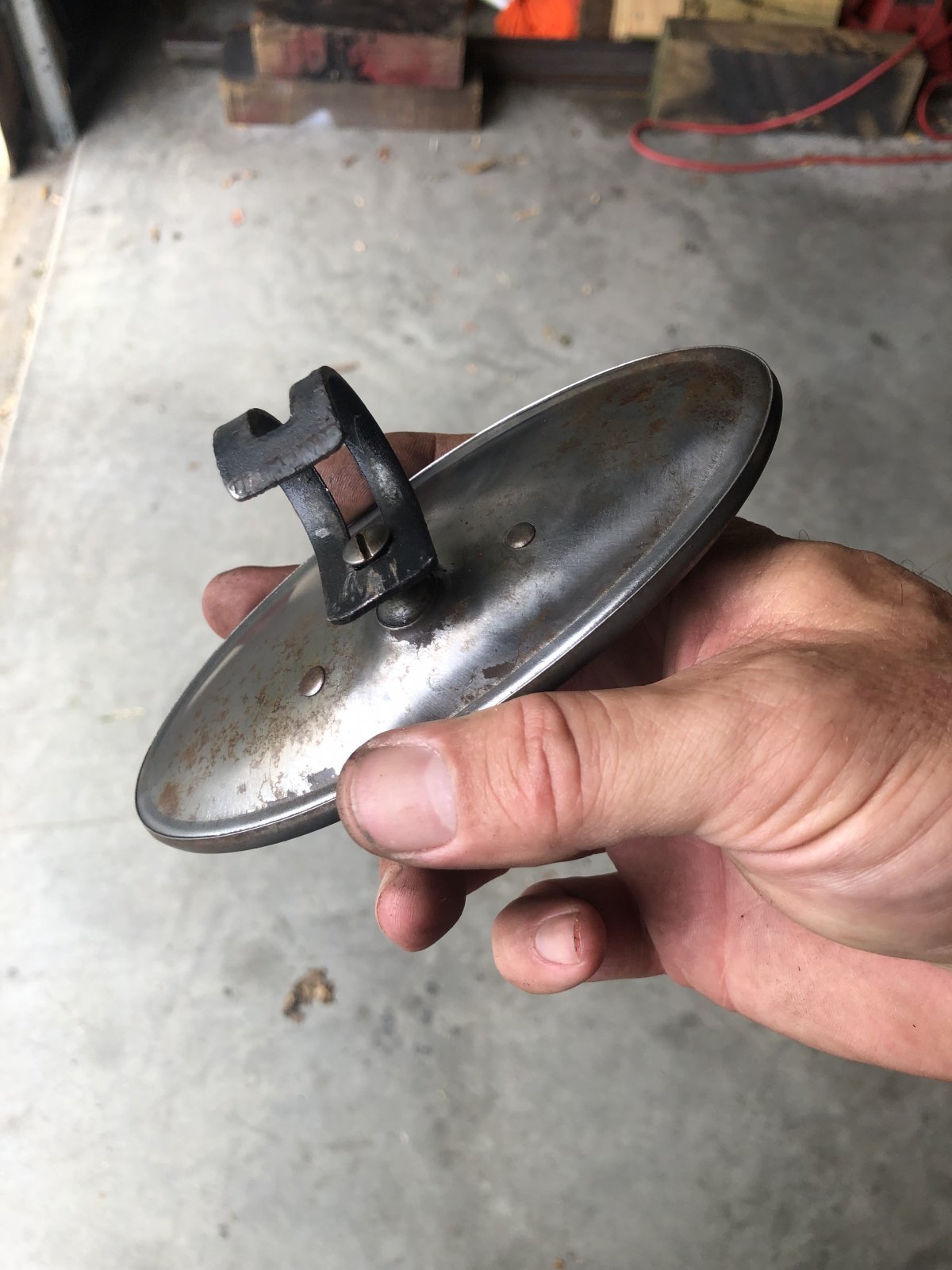

    Created a spring type clamp for an early Ford mirror to mount on the center of the roadster windshield. 6FA1FD37-3296-4F30-BF9E-2A0813B868C5.jpeg 13167006-5107-4FF0-8483-067F73496DAD.jpeg E6FE99E4-FC8B-4076-B0C1-E907EDB584A6.jpeg
  27. lothiandon1940
    Joined: May 24, 2007
    Posts: 33,197
    lothiandon1940
    ^^^^^^^^^Innovative^^^^

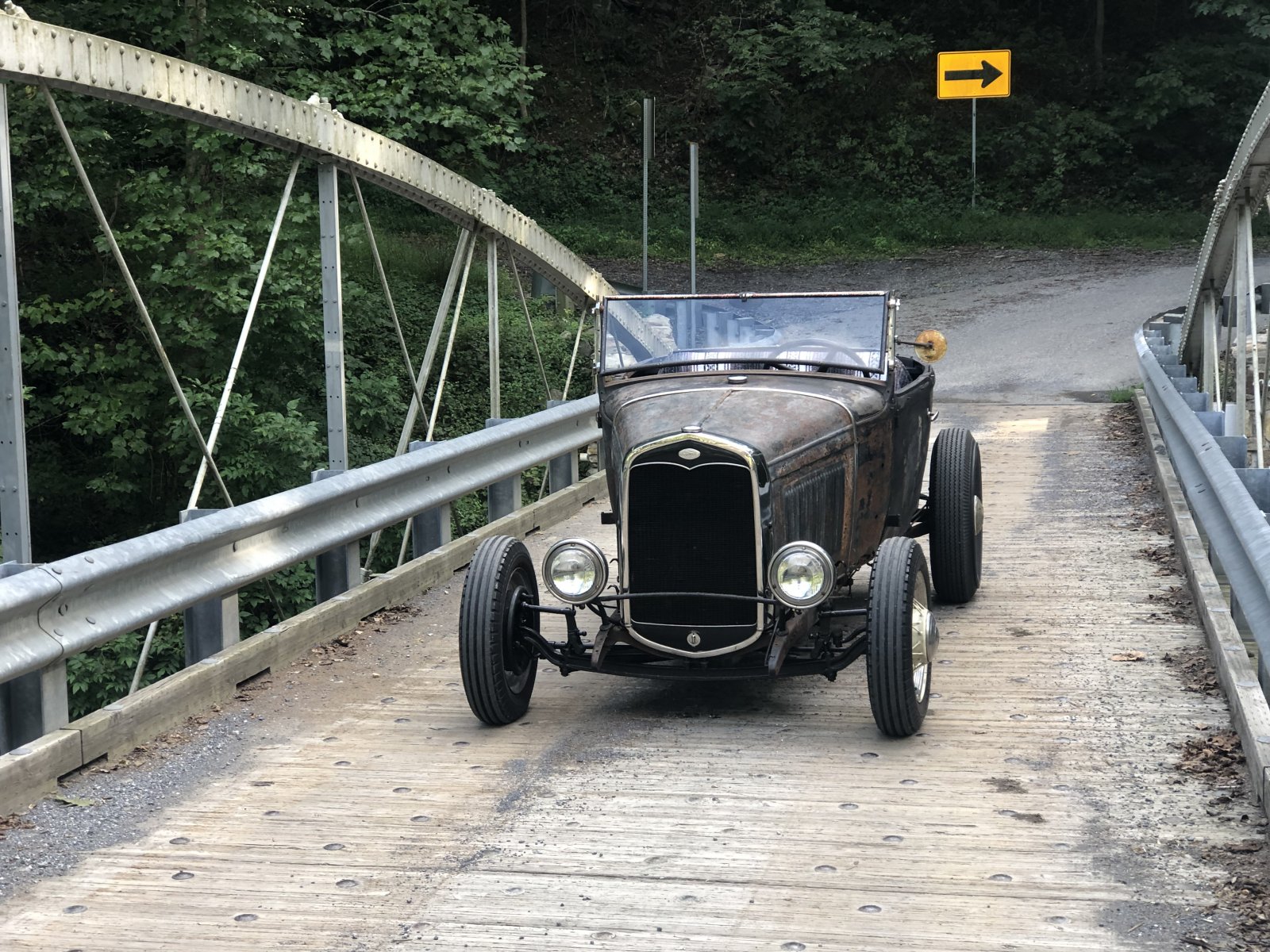

    Tribalmonkey

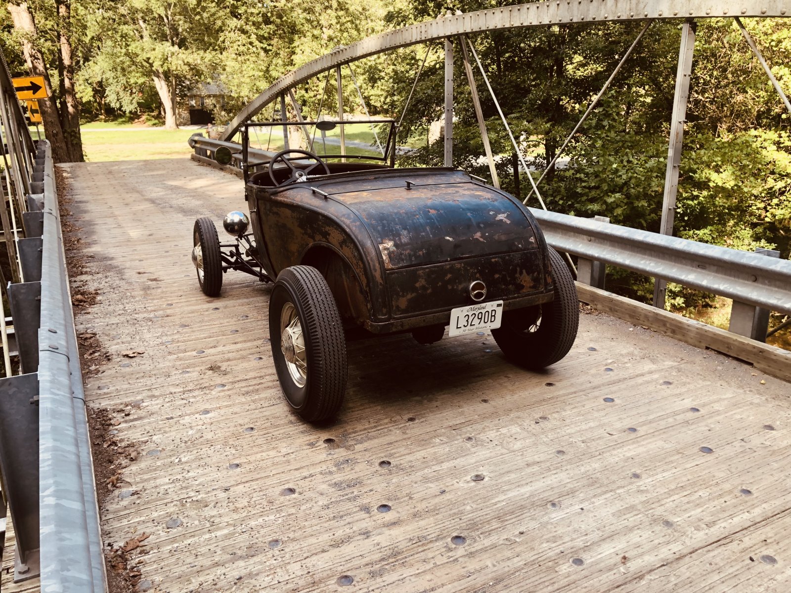

    29772022-6764-40FF-A019-52048BDF3E34.jpeg 5E5C3853-173A-4600-B9AD-0F88DEF4ABCB.jpeg Out enjoying the great weather after Ida p***ed through.
