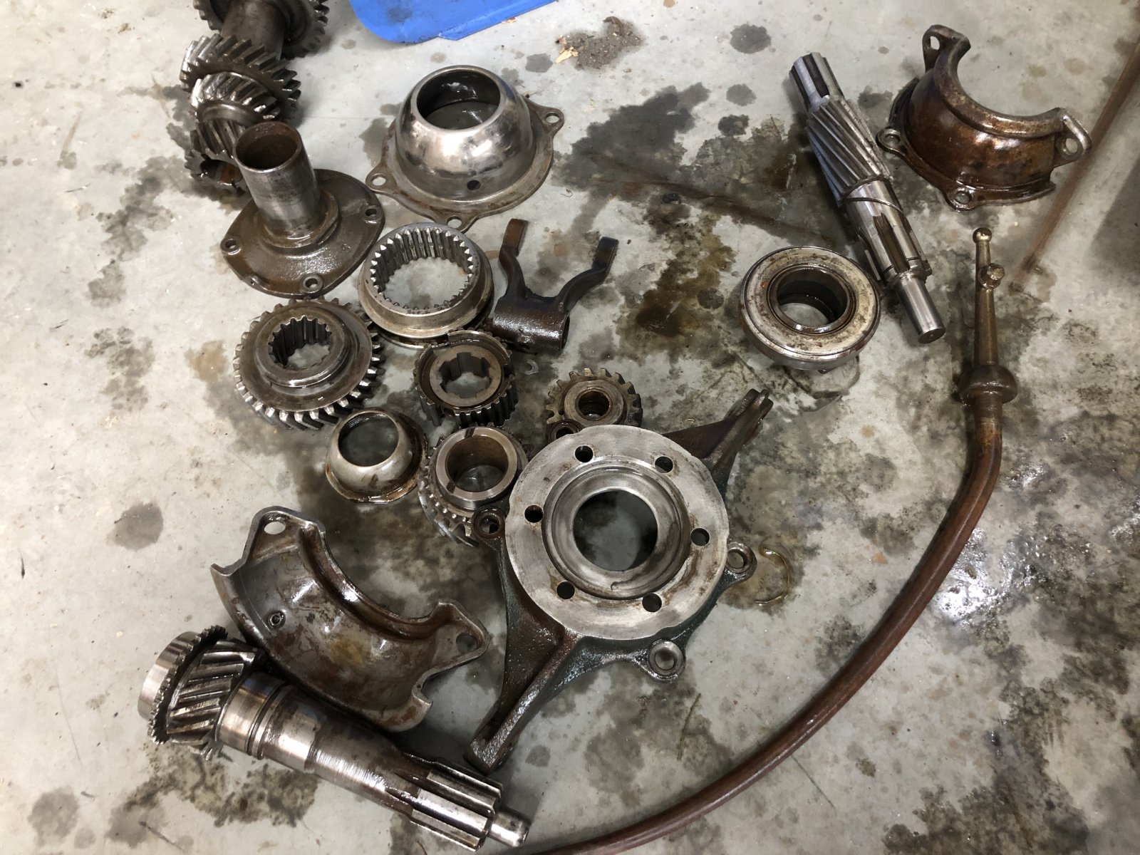

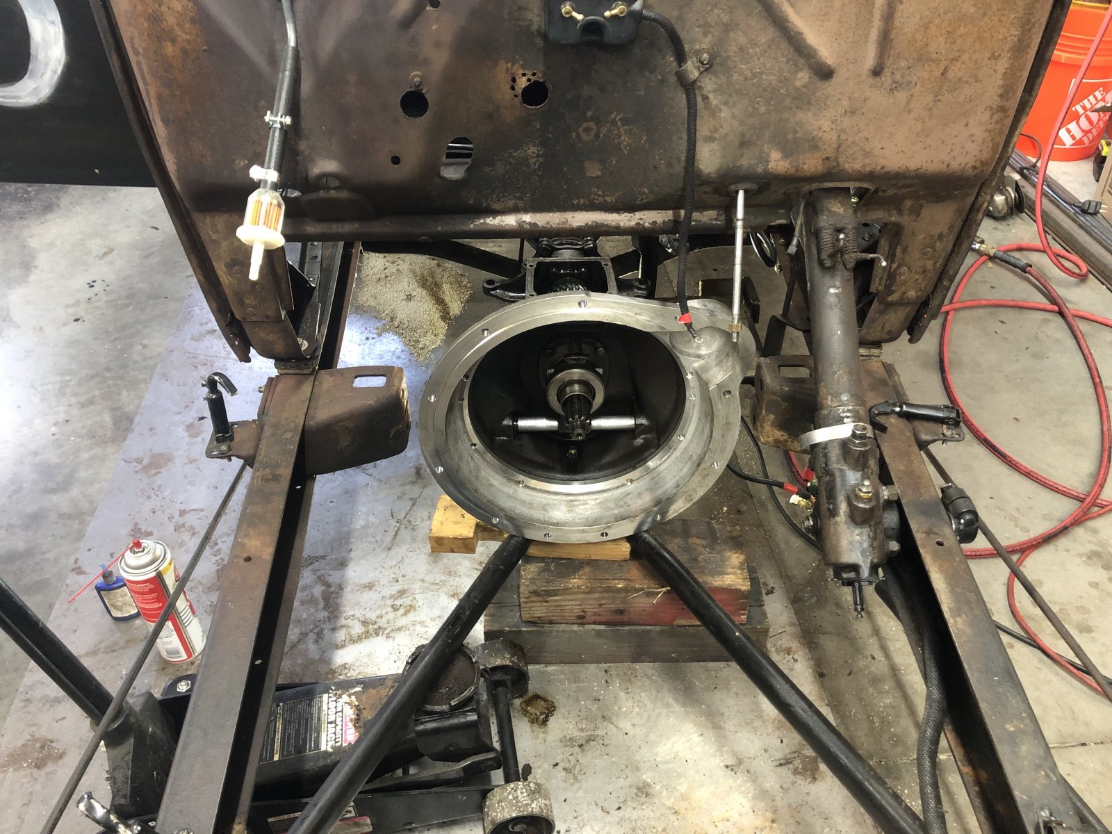

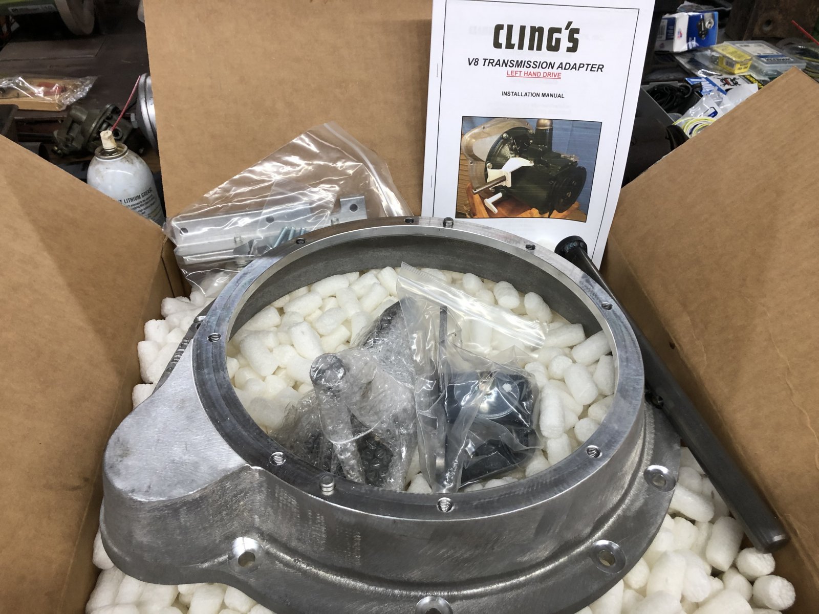

    This came in the mail today. Gave me a bump of motivation. 79935B83-5587-4179-AFF4-D8089BFCFE46.jpeg

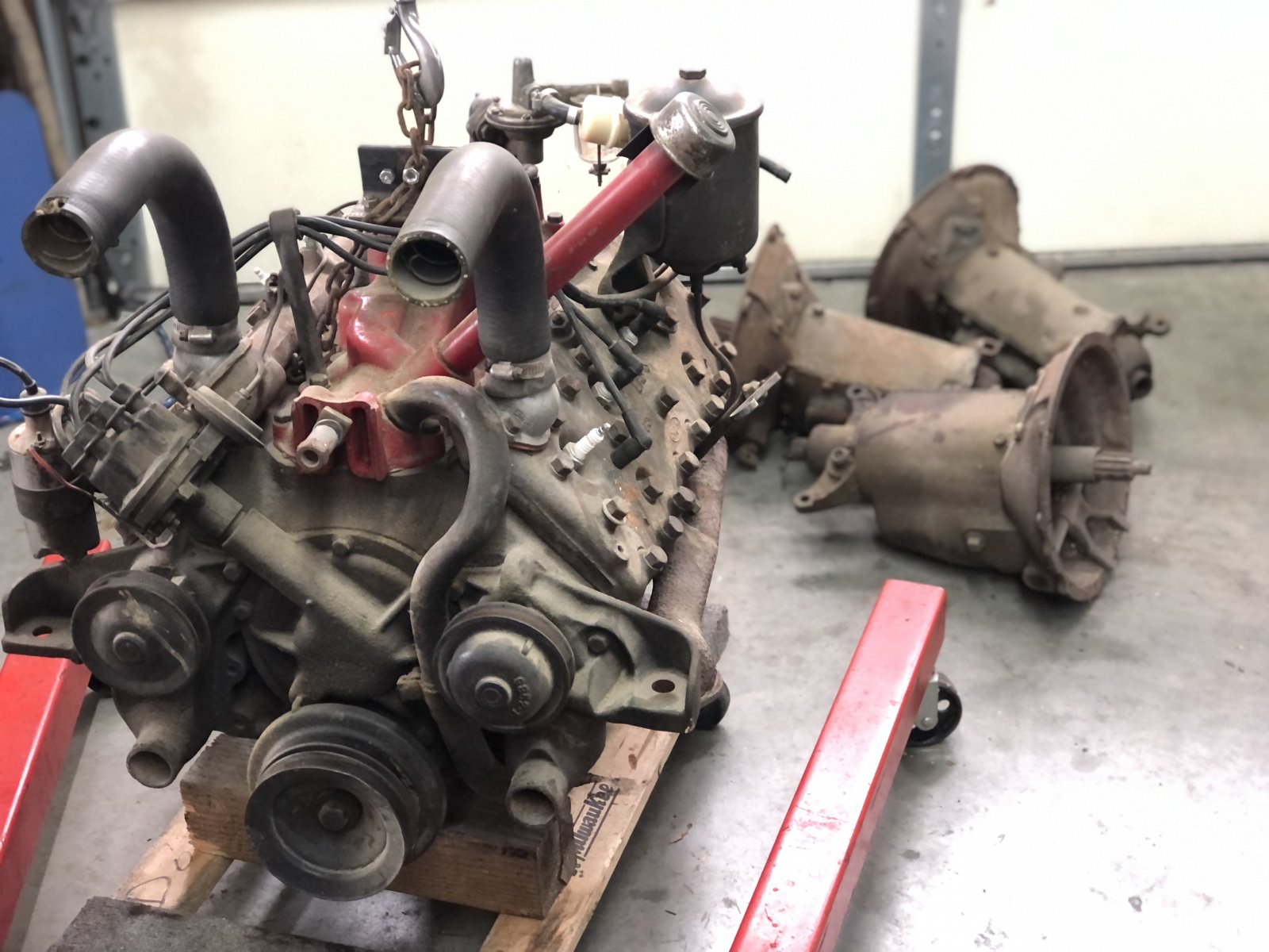

    Still cleaning trans parts. Trying see what I have and what I need to order. 70801639-634D-4664-BB0F-7C28F9F70C1B.jpeg

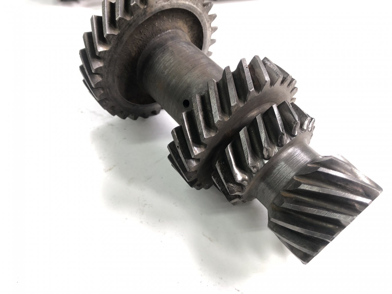

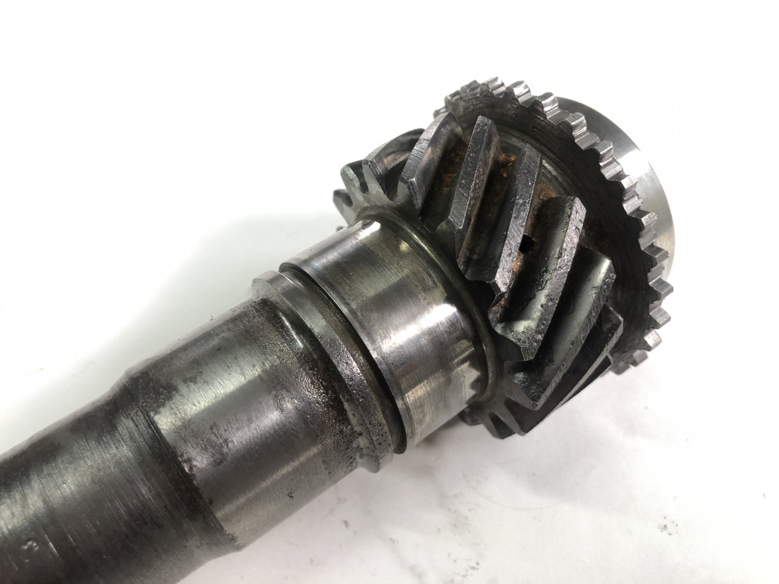

    I also sent Mac Vanpelt pics of my ****** gears today. He said he would take a look and give me a recommendation of what I should keep and what I should replace. These pics are the ones I consider the most concerning. I’m bracing for impact on this one. $$$
    DE60558E-65DF-49BE-BCA2-2A65267B74AA.jpeg BF97F47D-9AC2-4469-97C1-EB470209B318.jpeg 7E8668B2-65C3-42CA-942D-2073D05B3E99.jpeg
    Joe Blow and lothiandon1940 like this.

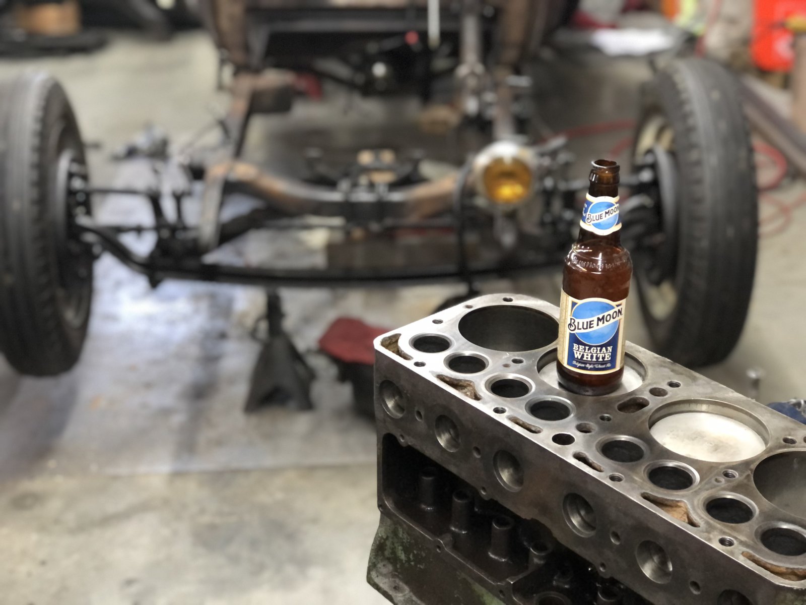

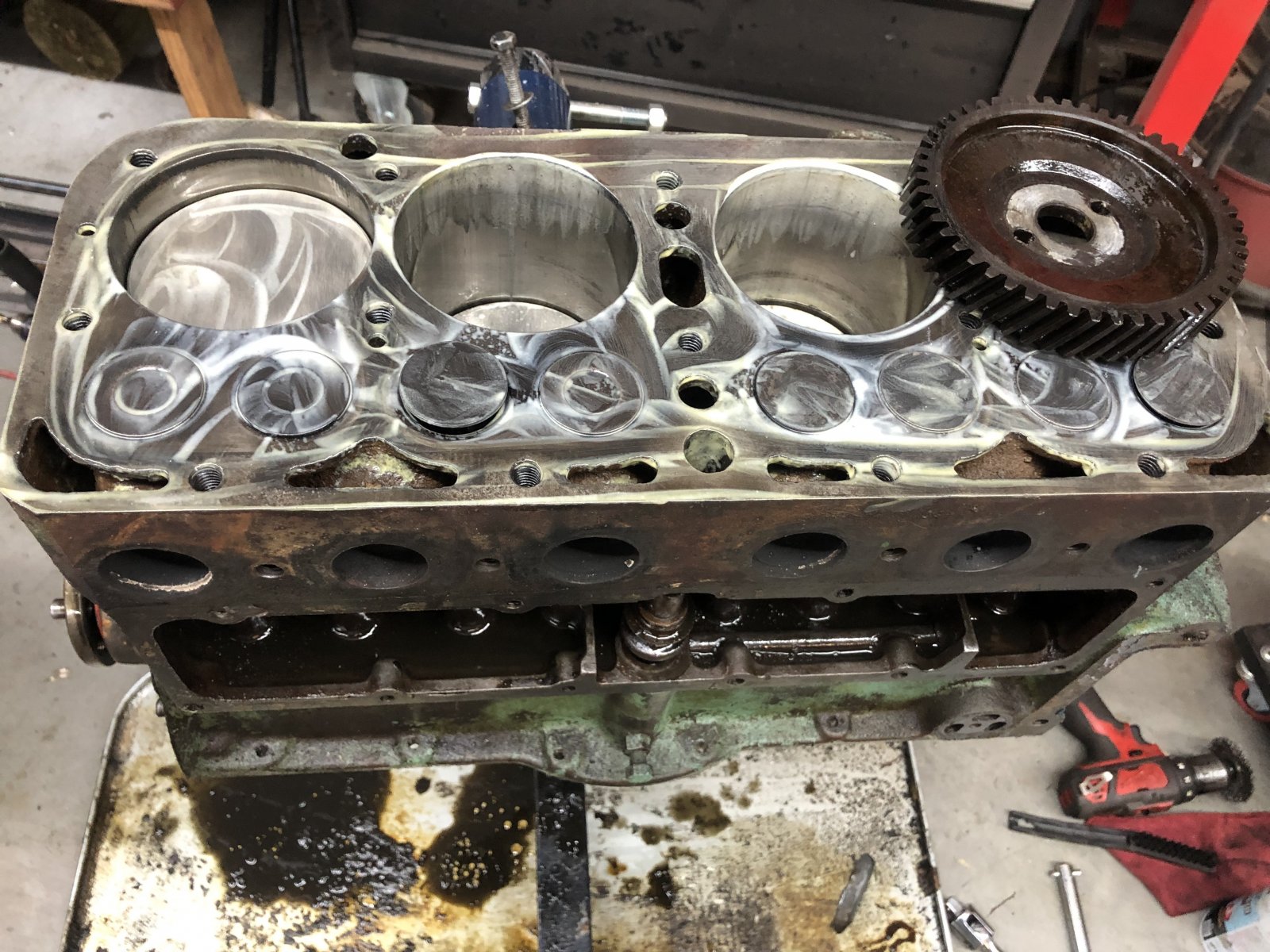

    The engine looks better than I expected. The pistons, rods, and caps look pretty new to me. I can see hone cross hatch on the cylinder walls. No lip at the top of the cylinders either. Also the pistons are marked with 80. Does that mean 80 over? Is that good? TM
    623D26F6-4AE7-48E2-A347-1779564904DB.jpeg 1E0CFA85-1AFE-4D16-AAE5-B984FD64F6AA.jpeg
  12. lothiandon1940
    Joined: May 24, 2007
    Posts: 33,192
    lothiandon1940
    I believe that is what the 80 means. That's quite a bit, could possibly affect cooling. I think 10 would be a typical "clean up bore". If I were to guess, that little engine may have been rebuilt more than once in its' life. It may be fine. It couldn't hurt to inquire with some of the A experts to get their thoughts.

    Ask over on the banger monthly meeting forum. My engine is 60 over with balance crank runs very smooth.
    lothiandon1940 and Tribalmonkey like this.
  15. I'm no expert, never played one on TV, and didn't stay at a Holiday Inn last night, but...
    I had a Model A that was bored .125 over, and had no problems with it. That was a pretty common overbore, but might also have been the maximum, but no one in the Model A community thought anything of it. Ninety years ago they weren't worried about 3.1 pounds of cast iron to meet fuel economy standards, so castings were thicker walled than what you find even in the '50s. I would be tickled pink (how the hell did THAT become a 'saying'?) to have a good one at .080 over.

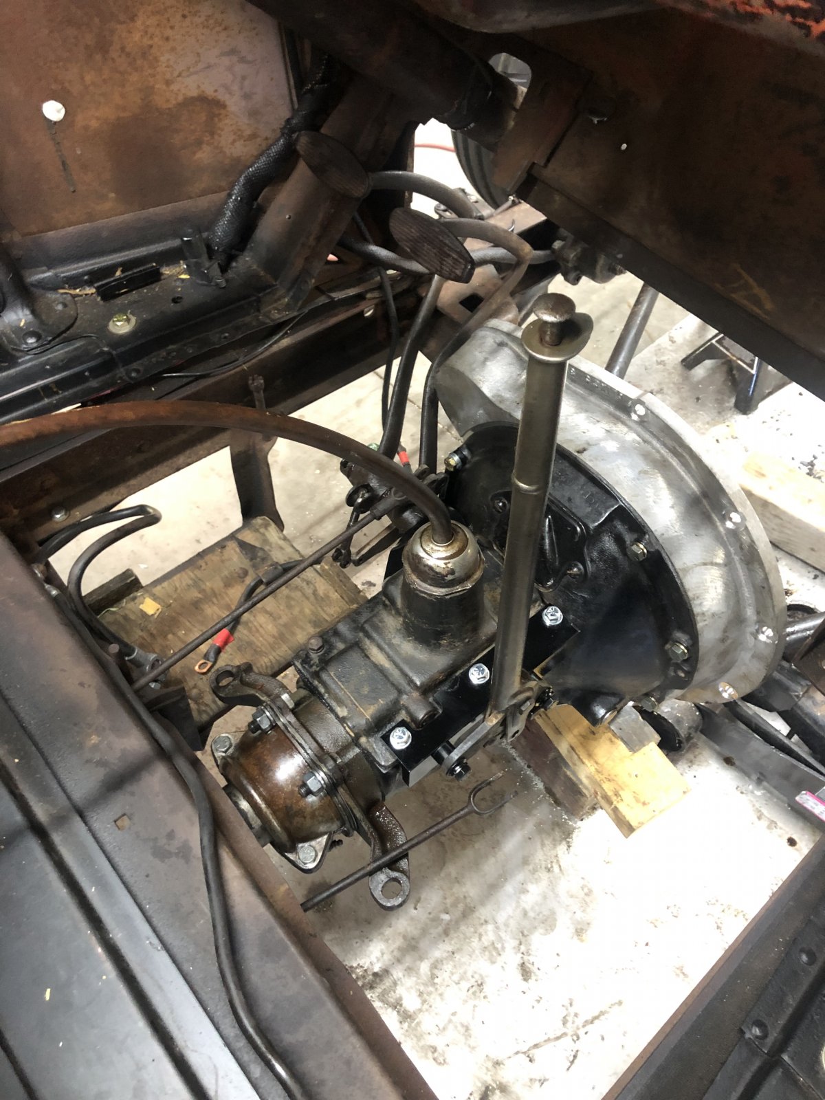

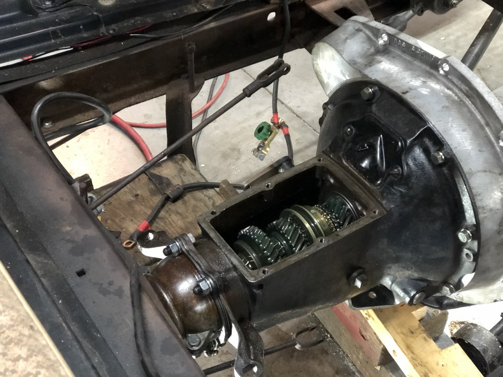

    ****** bolted in and filled with gear oil. 796617DC-DD74-46C3-9BC6-B1E595F2ED02.jpeg 2EA5BFFB-BC2C-44CD-99DE-260B1281ABA6.jpeg 0BEF43AD-5833-4371-8F49-86DA2A37AFA1.jpeg
