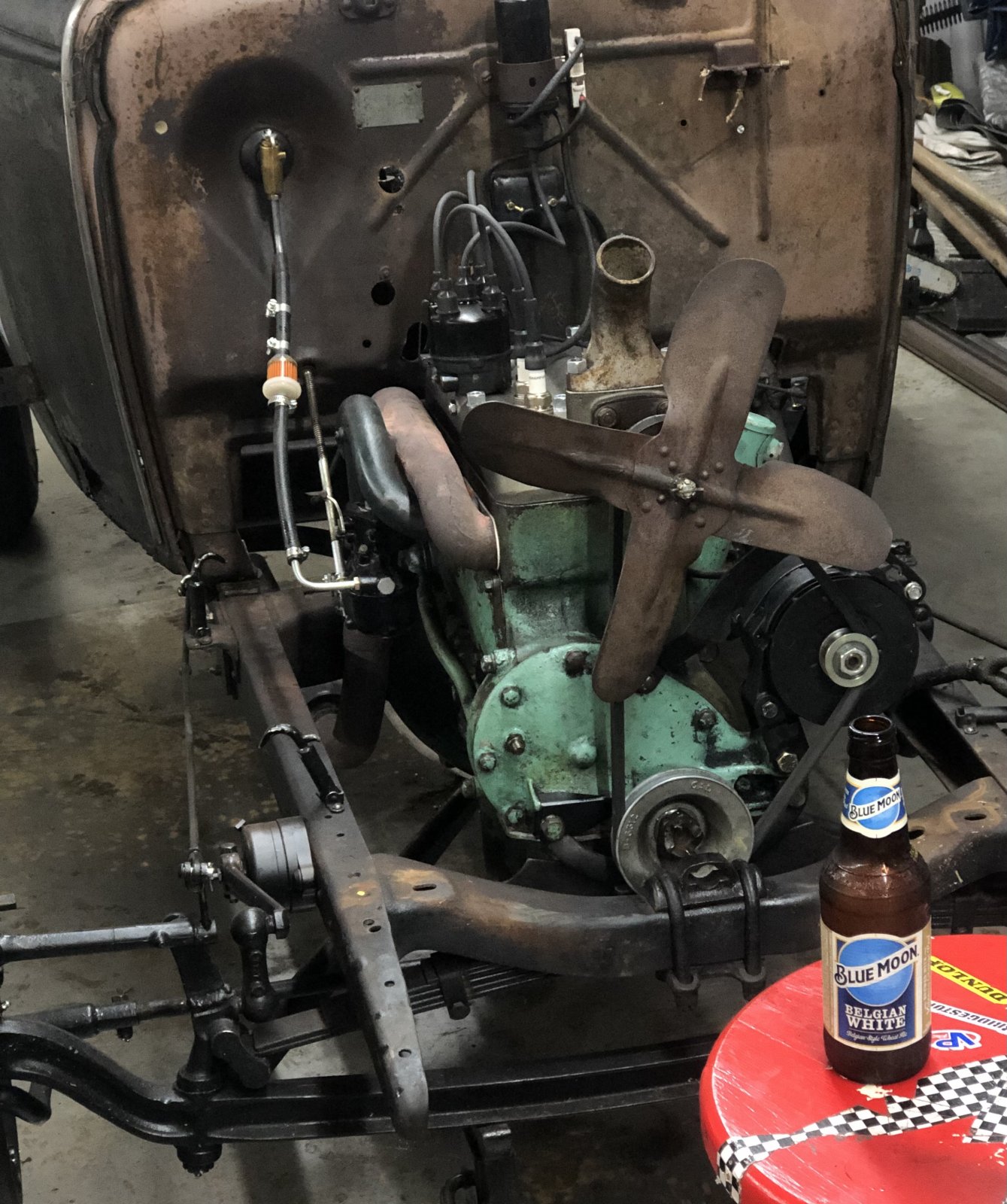

    Couldn’t wait. I used my Lucas ***embly lube. Slicked it up and stuck it in :) New aluminum cam gear. New adjustable lifters. Installed and adjusted the original valves and guides with new springs in their original locations.

    Making some progress on the banger. Valves adjusted, oil pump installed, oil pan installed. Working on getting flywheel housing true and then will mount the flywheel, clutch, and pressure plate. BA38B099-6CE3-424B-8144-C8DF03843436.jpeg 6537222F-F014-49E3-8CA6-6A45055A6EE2.jpeg

    I finally got sync’d up on a roadster weather day and a running/driving roadster. Ratty has significantly more power now. Had a great 10 mile initial shake-down run. All good! 7BFB8180-8ABD-4DF9-AA3C-8536A7E2E54B.jpeg 6E469277-D2CF-46FF-B3B2-3F081AF48E73.jpeg

    Got the generator working pretty good after my 12v field upgrade. I have to admit it was a bit of a pain. Getting the new fields in tight enough for the armature to fit was a challenge. Not understanding that I had to polarize the fields to make them work was a hurdle. I learned a lot by reading the Ford Barn posts from the guys that rebuild these things.

    Let’s talk voltage regulators. Should I use one with the 12v generator? Here is why I am asking. If I adjust the middle brush to give me 12v at idle then I get upwards of 17v at high RPMs. Seems like that is not good and could do some damage. If I adjust the middle brush lower then I only get 3-6v at my retarded timing cool model a loping idle. That means I am running off of battery power to keep the engine running. Any thoughts or recommendations?

    Voltage regulator use................YES!
