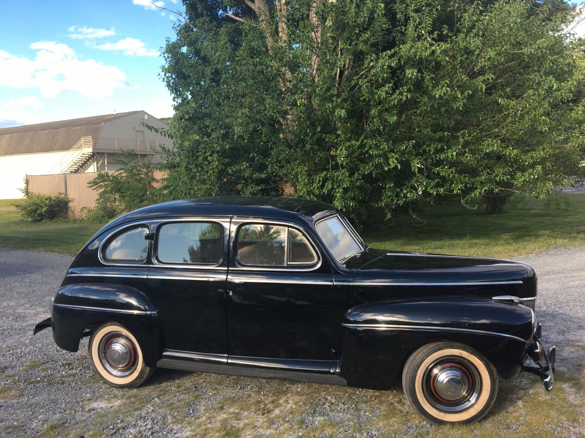

    ......He has been posting in the cl***ifieds, looking to sell this sweet '41. 9F639C77-1076-4933-AB18-F7EC08F090DE.jpeg
