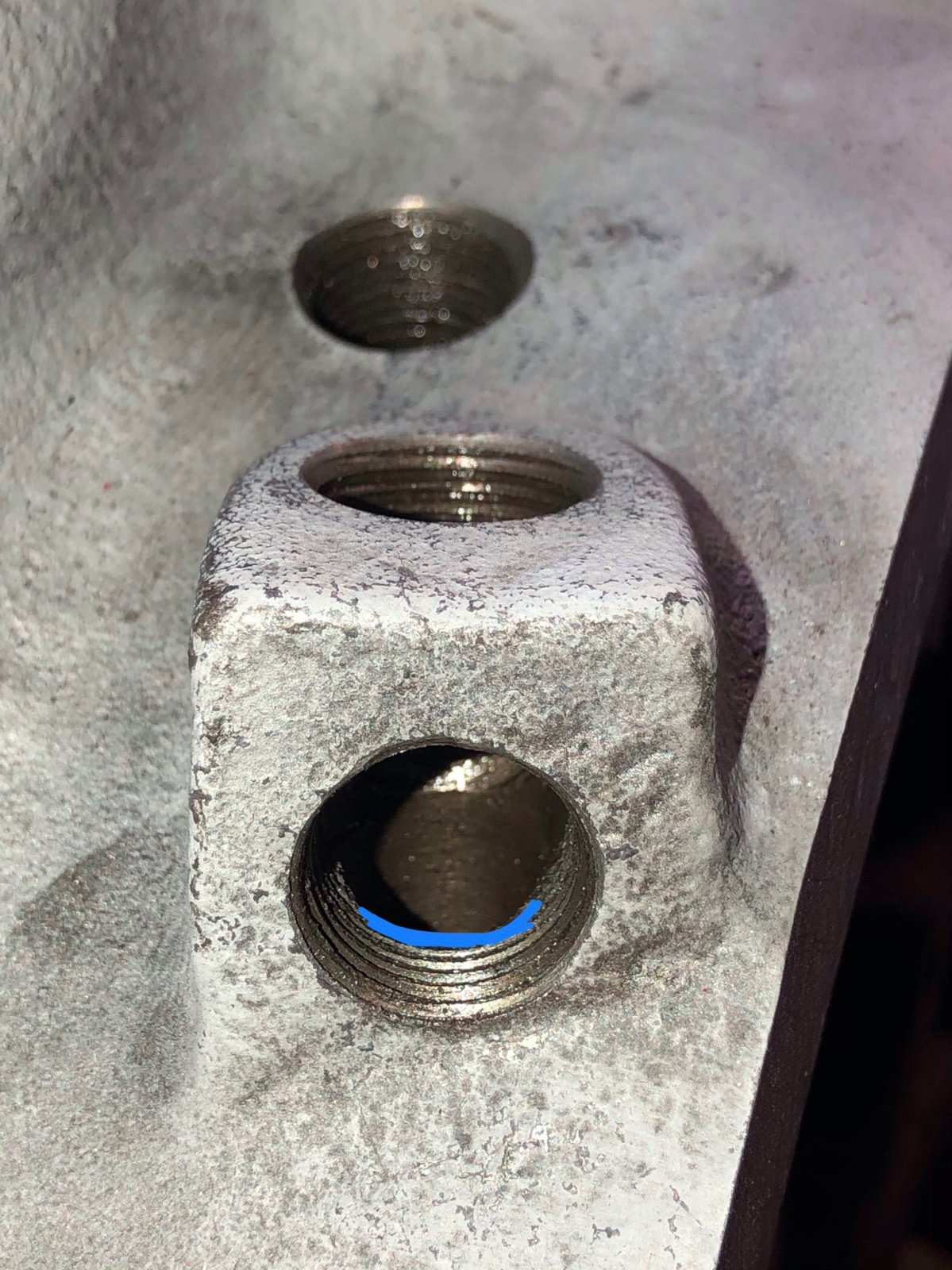

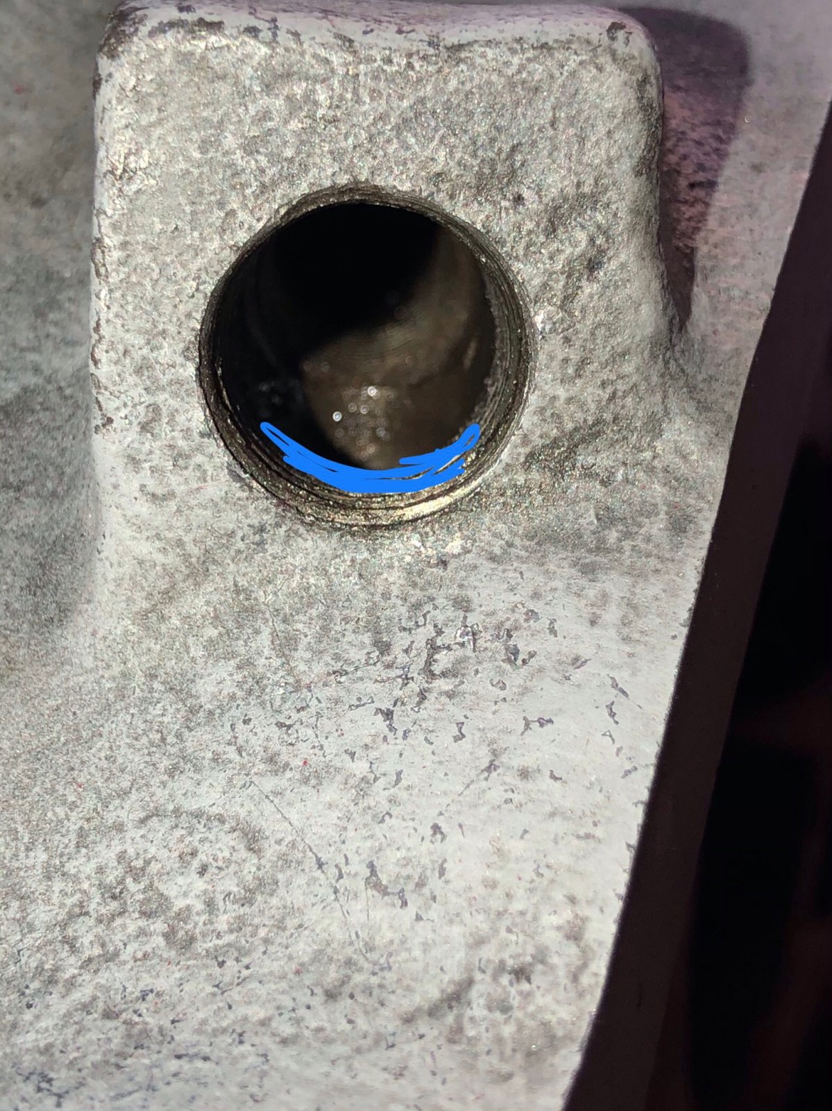

    I took some pictures and there appears to be no plug. The small bung is for an oil pressure gauge and the other runs to the filter base.

  8. Looks good,,,,,you should be good to go !
    Tommy
