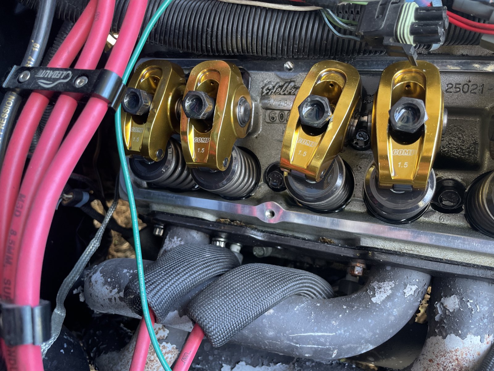

    image.jpg Just installed this 327 bored 40 over. Edelbrock aluminum heads. Local race shop built this engine for me. Since I installed the engine it has a miss to it. Pulled valve cover on right side and number 6 roller rocker is really loose compared to the others. I cranked the engine over and that roller rocker barely moves. What would cause this on a new engine.

    Bent push rod? It looks like the heads of the rocker studs are hitting the slot in the rocker. Very small area of contact, doesn't look right to me.

    The exhaust rocker to the right looks like it is riding offcenter to the valve stem, as if the rocker stud isn't in the right place. I'd be looking at all the rockers, a roller rocker will not live if it isn't in the middle of the valve.
    'Speedmaster' & other chyna heads had/have that problem and a roller rocker won't stay tight, I know these are Edelbrock and it may well be that it is just a photographic angle suggesting it is offcenter, but this is something I have seen before and worth mentioning.

    This head should be using a guide plate to center the rocker arms. Something must be really amiss
    for that intake rocker to be so ****eyed. Maybe the push rod is broken from binding or a guide
    plate issue. If you remove the rocker arm I am sure there are several of us wanting to see what lies
    underneath ! Thanks CP

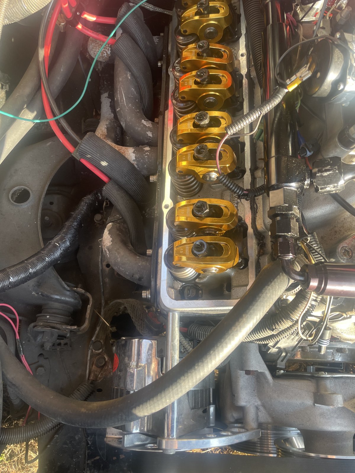

    Looks like a guide plate under the next cylinder but not the one in question. I would also check under each adjuster nut to see it the rocker arm shaft is upside down.

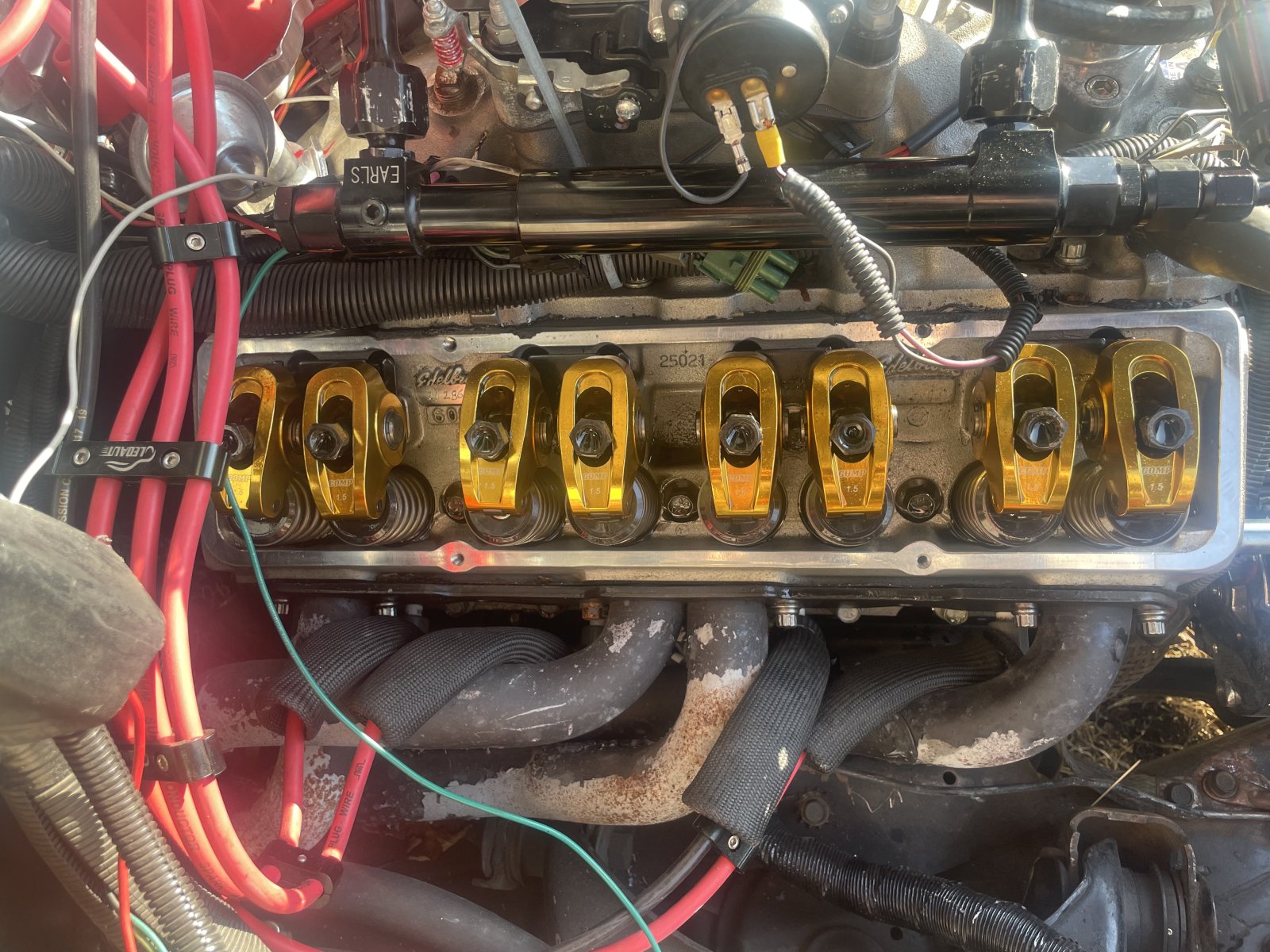

    from Kentucky
    I posted some better pictures, I tried to upload a video of me cranking the engine while my son recorded. It wouldn’t go through
