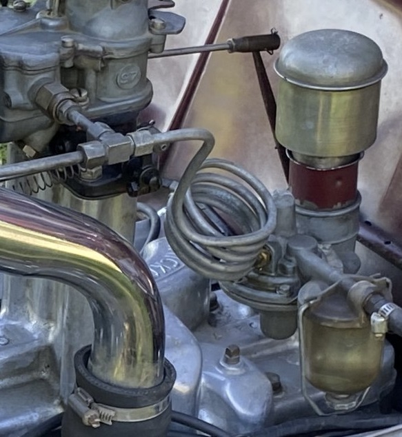

    Need some trouble shooting input on my roadster, the one in my avatar. Awhile back, last year, I was trying to figure out why there was such a sticky spot when letting the clutch out. Took it into a shop and after pulling the transmission twice it was determined that the clutch fork was tweaked. Well that was repaired and it works just fine. While it was in the shop I was told it would be a good idea to install a fuse block because everything was straight wired with no fuses. So that was done. Was told the roadster was ready to be picked up. Picked it up drove it and got on the freeway and it just dies. Started it up and got it going but everytime I left off the throttle it would die. Limped back to the shop. Got a call a couple days later and they determined it was a bad coil. The coil was replaced and the shop was nice enough to deliver it to me, about a 15 minute trip.
    Took it out for a drive and after about 10 minutes of driving come up to a stop light let off the throttle and it dies. Again limped home. Called the shop and told them the same thing was happening again.
    I checked the coil and the new one has the same symptoms as the one that was replaced. I just don't think it was the coil in the first place.
    Now the thing about the whole situation is the car ran just fine when I took it into the shop for the clutch repair.
    When I bought it I drove it home, about 20 miles, with no problems. Drove it to Midnight M*** and back, no problems. Picked it up from the shop, problems started.
    I was also able to replicate the problem while the car was sitting in the garage. I started it up and let it run for about 10-15 minutes then it starts ****ping out. Was able to replicate the symptoms with the car just sitting in the garage running.
    In the garage when it started dying I checked the gl*** fuel bowl, full.
    It has an electric fuel pump.
    I'm thinking it has something to do with the fuse block that was installed. Been trying to get the shop to take the car back but I'm being told that there is no room for it and they only have one mechanic working.

    Wire the coil straight to the battery and byp*** the fuses. Then do the same with the fuel pump.

    Change the fuel filter ( on the fuel hose to the carb ?) as even though the fuel bowl was full, if there is a booger in the line it moves and blocks fuel flow.
    What Carburetor is on it ?
    Here's one fellas miss.
    Old style with the internal Carb carbon thimble type ?
    If so - change it.
    Depending on how long it has been sitting prior to you owning it, if it's been a long time not running- just sitting , how old the Carb is - and what fuel they ran ( ethanol type) could have corroded the inside of the carb / floats. I've seen it.
    Let me know if I was right and win the prize.

    You have an obstruction in your fuel system. Doesn't take much, especially if it's in the carburetor(s). I've seen the teeniest tiniest things clog the jets. Dirt, a bug, bug wing, his left ball...
    Not sure what your friend did to check the carbs, but you said he adjusted the float level on one carb which makes me ***ume that he had the bowl off and cleaned it out. That's usually enough. But what about the other carb? I am a little curious about how it could be happening to both carburetors, and yet when you think about it, dirt coming in with the fuel would go to both carbs I guess. Am I right in thinking that if only one carb had ****ed up some dirt, the engine would keep on running and not stall, running only on one carburetor, but running? Just thinking out loud.
    It's just that every time this has happened to me and I start thinking that the coils getting too warm or something like that, it ends up to be the same old basic **** in the gas.

    He had the tops off both carbs. One needed the float adjustment the other carb had the worn accelerator pump. Both carbs were clean inside.
