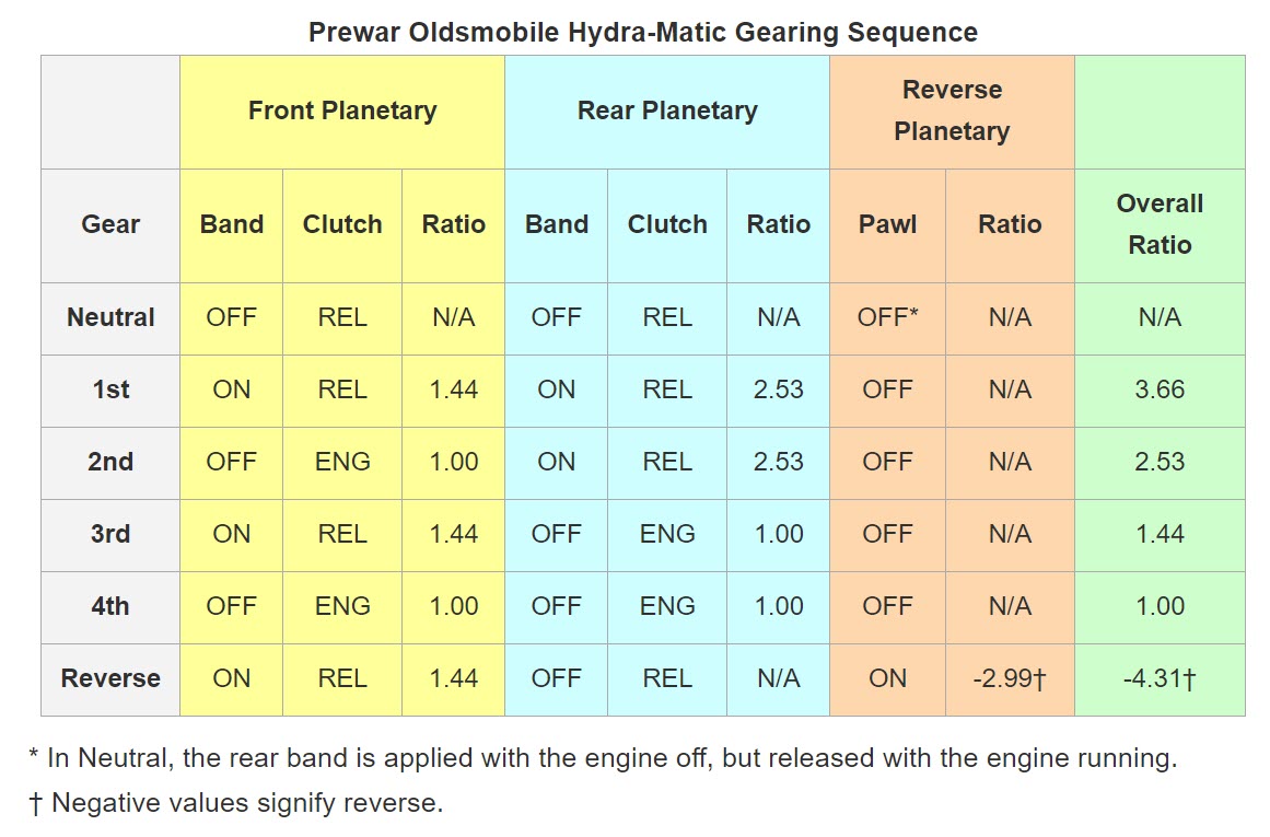

    As you know Hydramatics prior to 1954 were not Dual Range and had the mechanical reverse engagement using the co**** 'parking' paul. Dual Range units had clutch applied reverse which of course is infinitely smoother. Low gear has both front and rear bands applied, no clutches applied. Shifting to reverse releases the rear band, keeps the front band applied and engages the parking/reverse paul with the shift lever. The rear band is involved in neutral also. It is applied with the engine off but released with the engine running. Sounds like your rear band is not adjusted properly?

    Another thing is that Lo range can be set up for 1st or 2nd gear start. In the case of the 2nd gear start the front band is released, only the rear band is applied. As mentioned, you need to check the rear band adjustment.
