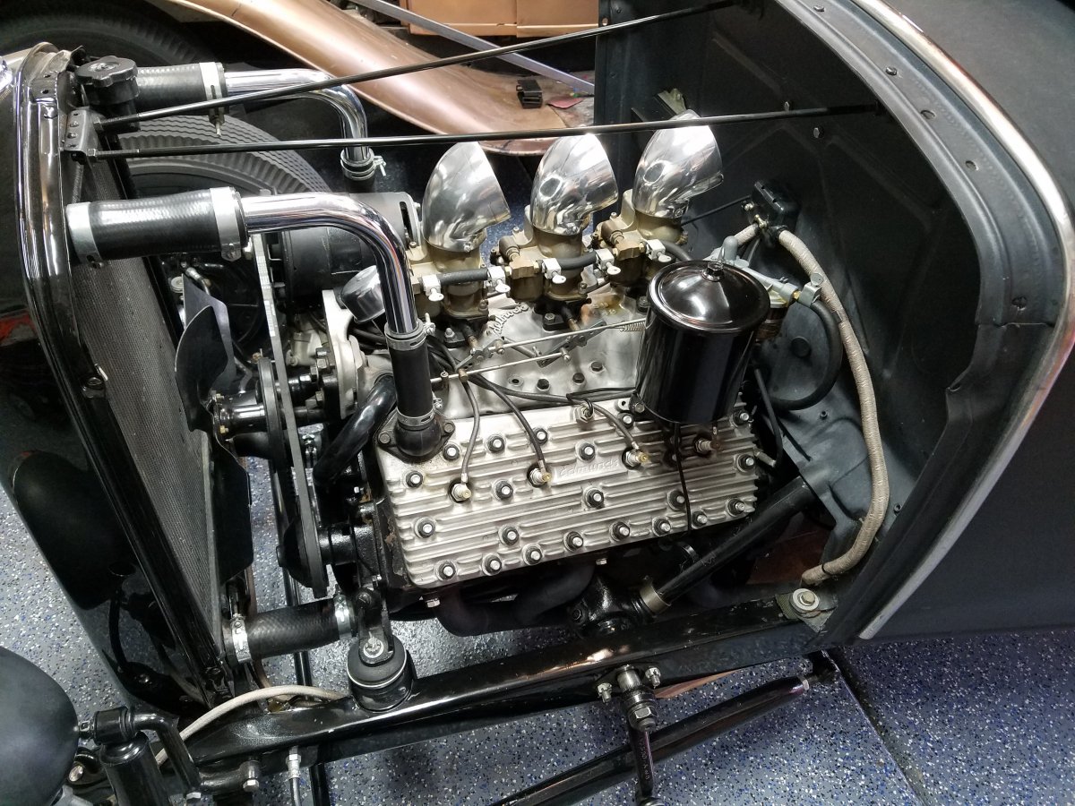

    So I've had my flathead running in my model A pickup for about 4 years now. No issues whatsoever. Its a 286ci with 3 Holley 94's, Edmunds heads on an Edelbrock intake. The distributor is a Mallory YC dual point with the flat cap. The motor has maybe 15k miles on it.
    A little back story:
    Last time I drove it we went on a trip about 200 miles in total. Towards the end of the trip we stopped and ate lunch for a little and I fired up the truck and took off. I noticed it was backfiring out the exhaust mostly under load. I couldn't keep it in 5th so I stayed in 4th and it would do ok, but still kind of running rough. I stopped and checked the points but I was close to home and kept going.
    What I've done:
    I've been trying to diagnose this issue since February and can't figure it out. I took the distributor apart. Cleaned the points really well. I set the point gap and dwell. I put in a brand new condenser. I've tried 3 different coils. I put in a Pertronix ignitor II and flame thrower coil (brand new). I took the cap apart and made sure all plug wires were in the cap correctly. I cleaned off the contacts in the cap. Cleaned off the rotor. I byp***ed the ignition switch with a jumper wire. I tried a known good battery. I tested resistance on the plug wires (1.4 ohms). I did a compression test and they all came back at 100lbs. I can get it to static time with no issues.
    With all this done it will not even start at this point. It will pop like it wants to start and then nothing. It coughs through the carb which to me is too advanced so I set the timing again and nothing. Just sounds like it wants to start and then dies right away.
    I need some help before I swap in a small block Chevy! :rolleyes:
