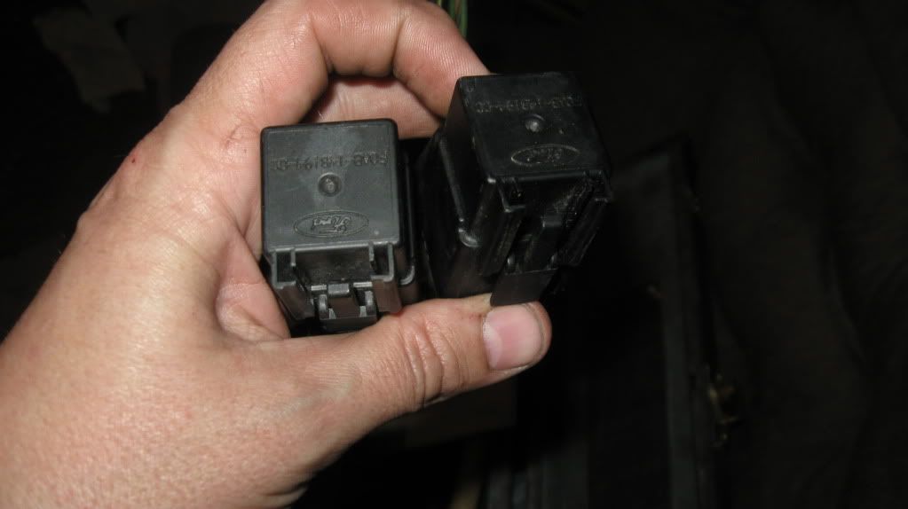

    you can find high current relays with sockets in a lot of full size ford products, do the two fuse deal, one relay and fuse for the low beams, one relay and fuse for the high beams, the switch simply controls the relays, if one fuse blows you still have either the high or low beams,
  16. lostforawhile
    Joined: Mar 23, 2008
    Posts: 4,159
    lostforawhile
    these are a Ford part number Foab14b194dc I found them in a 94 Continental paid 2 bucks for both the relays and sockets, you can find these in a lot of Fords, these are the heavy duty ones [​IMG]

    I didnt think about using two fuse's one for each relay so you always have high or low beams if the other fuse blows ill update my truck now.... thanks something i overlooked i plan to run sealed relays also....
    I pulled a set of sealed relays for my 54 ford i need to pull a set and update the trucks relays, they came out of a ford probe car at the junkyard, they are located right by the drivers side hood hinge,undo one bolt and cut the wires and your done and you get a relay bracket holder also. if you get these kind of relays the numbers for each wire are marked on the bottom inside of the relay when you pull it off the wire connector cost a couple bucks. Part# kc28 d5222
