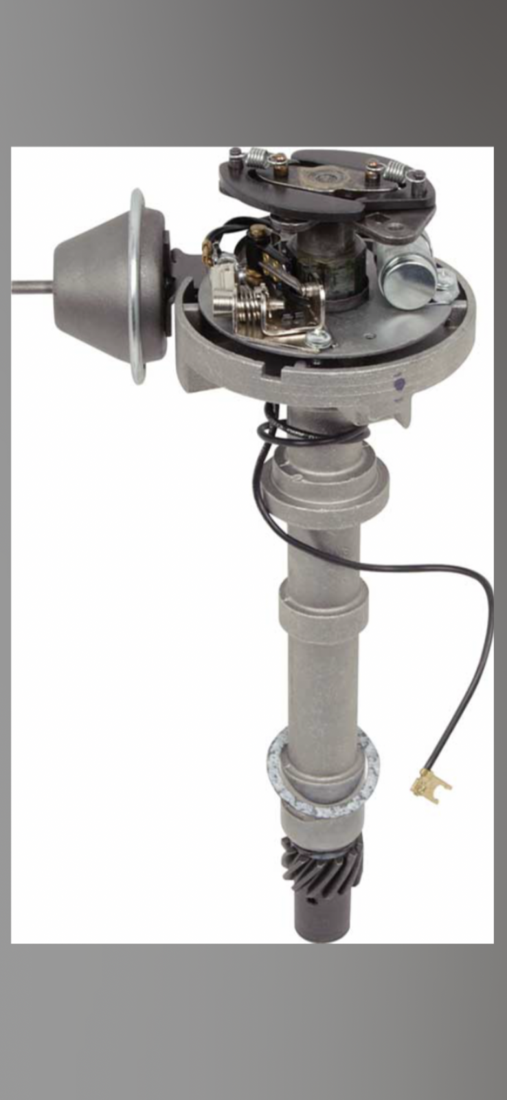

  1. I tried to start my 51 Dodge truck today and in going down the line of what's wrong I found that I lost my spark. I am not familiar with a distributor where there is no oil. I ***ume I can pop a cover off the top and there will be some sort of coil pack but I would like some advice first. Help! distributor.jpeg

    That is an HEI electronic ignition distributor. first you need to verify that there is 12 volts to the power wire going to it. after that there are several things that may be wrong, the ignition module, the pickup coil and the ignition coil could all be culprits

    And make sure that the plug that goes up and into the module is good and tight. Could be that simple.

    Check to see if you're getting 12v to the distributor. These photos may help:

    I've had numerous graphite ****ons that go from the coil to the rotor break on HEI on thr last couple years. Could be something simple. Really they are pretty simple to begin with...

    My Son recently repaired his barbers 56 Chevy that has the same HEI. Turns out who ever wired it used one of the extra acc fused terminal :confused: from the fuse panel. It blew the fuse. :rolleyes:

    There are many distributor rotors that burn through under the center coil contact blade causing a short to ground through the distributor shaft. Check this after you verify power to distributor as Moriarity suggests.

    I'd start with the rotor. They work fine one moment and literally the next don't.

    I had this happen to an OT car with electronic ignition. It turned out to be the wires inside of the distributor and under the coil pac were old and brittle and had broken and not making contact. Easy fix if this is the case for you.
    My car would suddenly lose power while driving or start up. You can tell an electrical issue from a fuel issue while driving.

    Chevy HEI is pretty reliable till it’s not .
    module is the usual culprit
    after cap and rotor .
    the coils are pretty resilient and reliable
    could be the little wires that connect inside the cap or body of the distributor .

    It was also common for the wires to break at the pickup coil. Those wires have to bend every time the vacuum advance moves. Give those two wires a gentle tug and see if they break off.

    yup, good old points ignition. the most reliable system ever. When I was a mechanic back in the late 70's and 80's these Hei's were almost new and were terribly problematic. Typically when the rotor burns thru and shorts to ground the reason is that a plug wire has gone bad and the voltage is forced to find a new path. Also as someone else stated the wires to the pickup coils are prone to break because it moves every time the vac advance moves the plate. They look like they are connected but the copper is broke inside, a gentle tug on them will tell. the distributor needs to come out to change the pickup. as stated earlier too the modules are subject to having problems too and a lot of people carry a spare because of it. All of this combined with the fact that these are the ugliest distributors ever made make me wonder why anyone who cares anything about a traditional looking engine compartment would ever want to run one

    If 12v present , more likely
    Module or burnt rotor .
    Module will go bad with out any warning.

    As fare as HEI systems go the GM unit is pretty good.... The only thing that people forget to do is when they replace the control unit they forget to coat the base of it with dielectric silcone grease... It keeps it cool...
