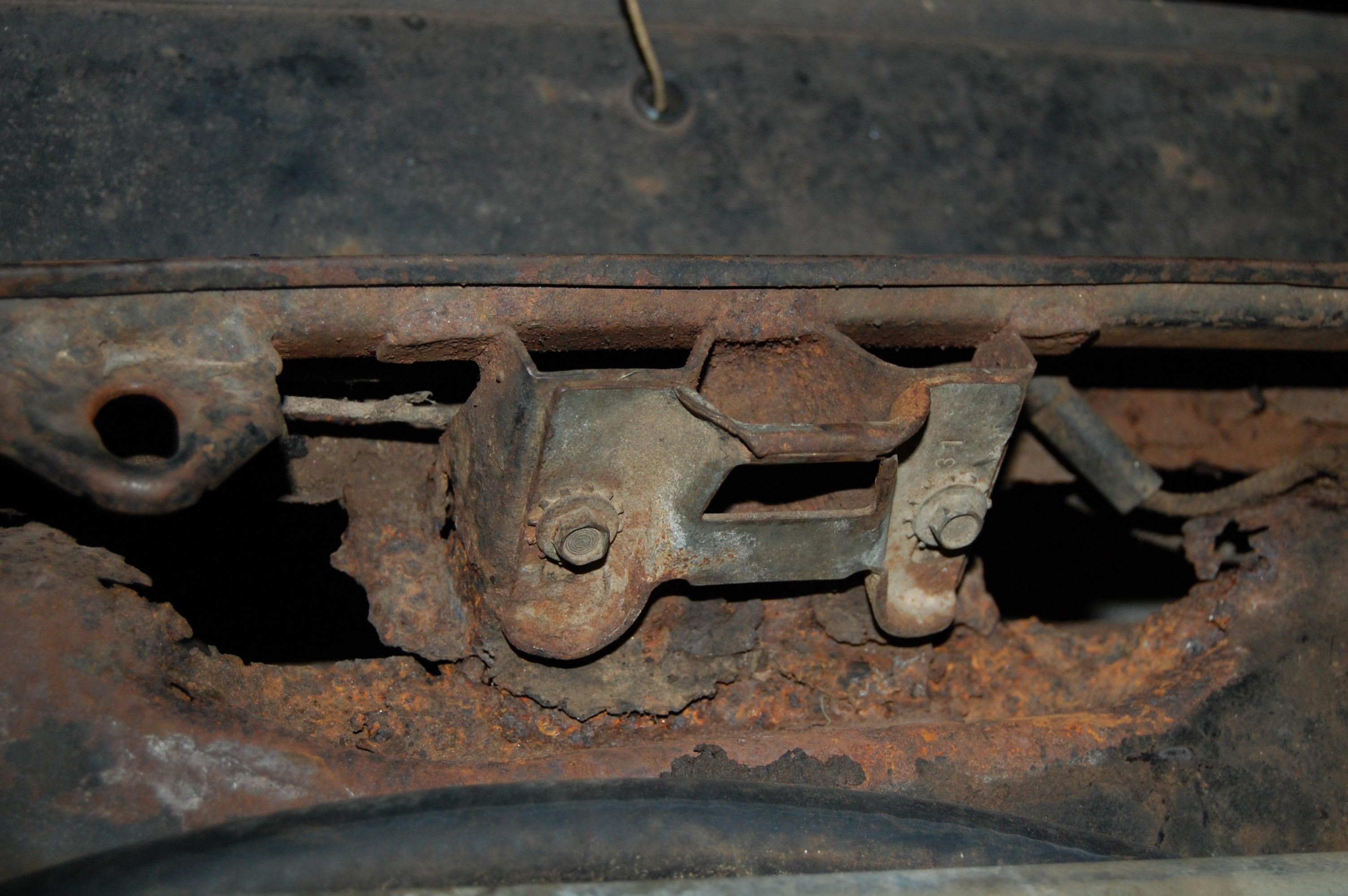

    And maybe someone else with a Chevy the same year and model as yours will be kind enough to post a photo or two of the lock from the inside of the lid and maybe the inside back wall of the trunk to show what you have to work with.

    Dumb question... Have you tried your ignition key in the trunk? I ask because my 53 uses the same key for the ignition and the trunk, and they're both the original keys/tumblers. I just took a bunch of pics, just give me a minute to upload them...

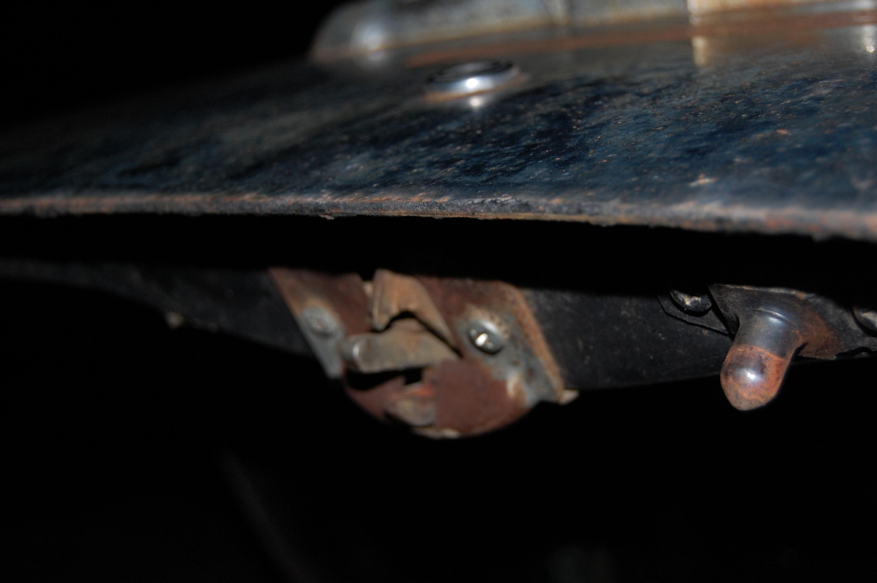

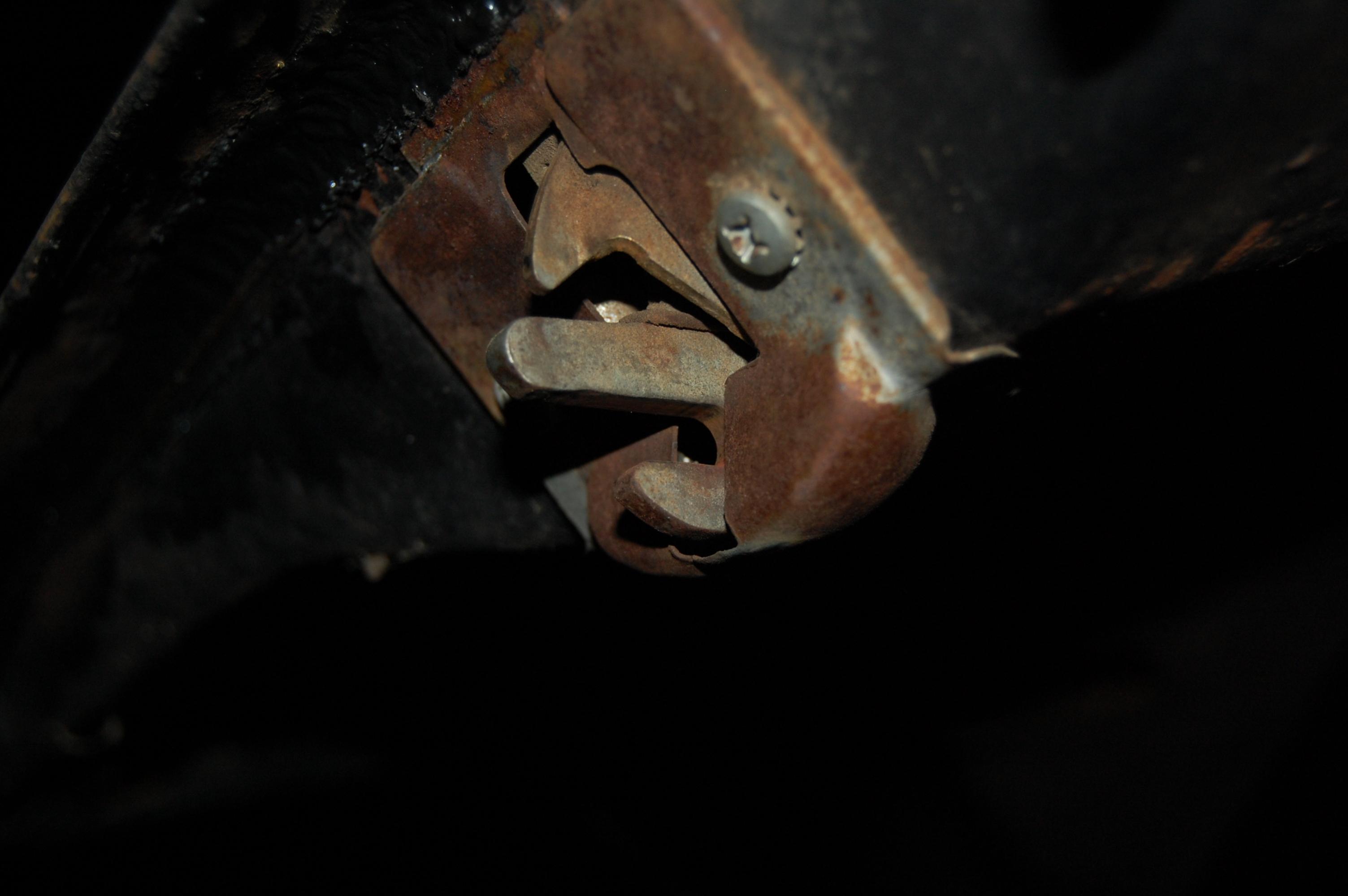

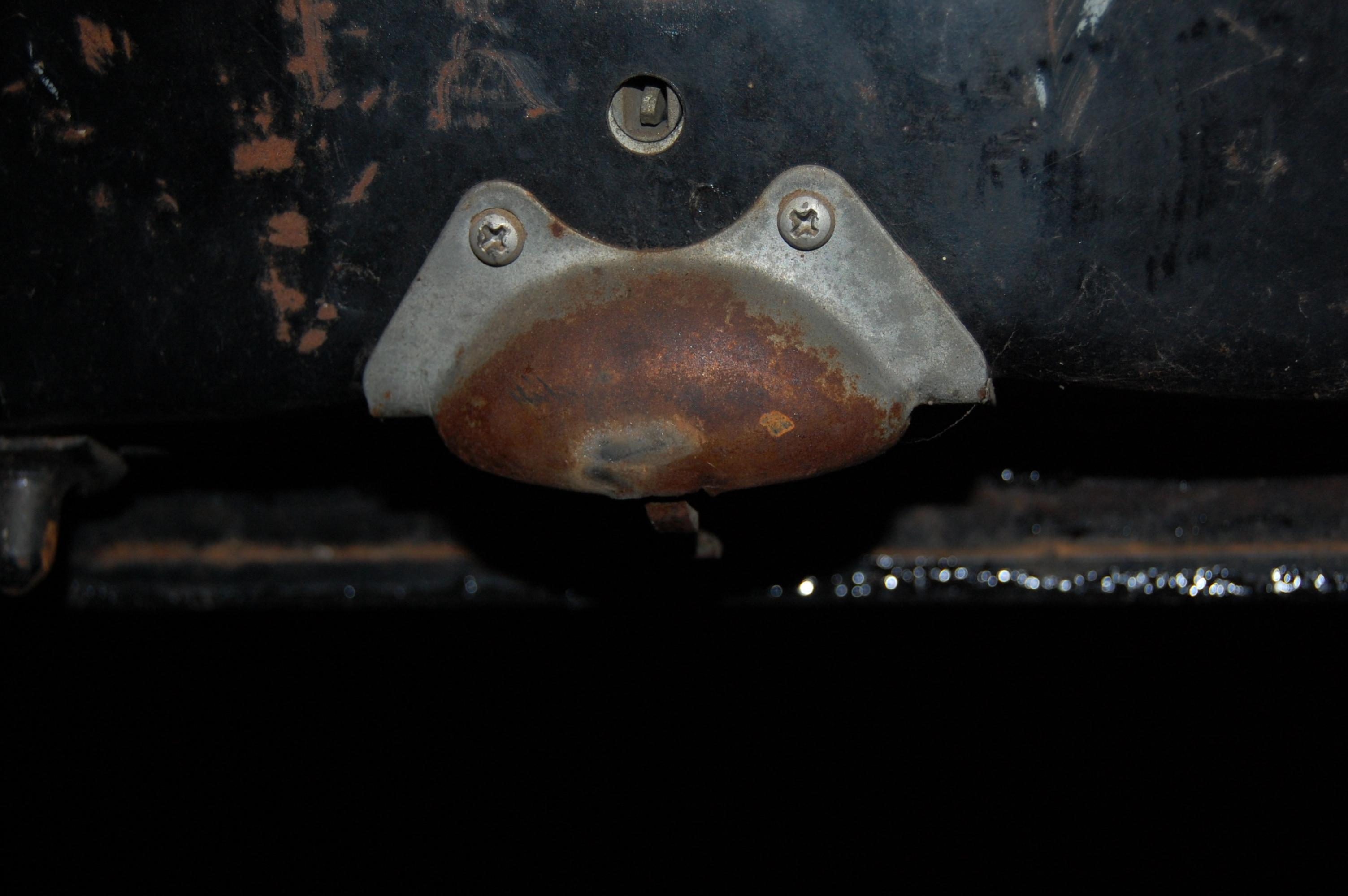

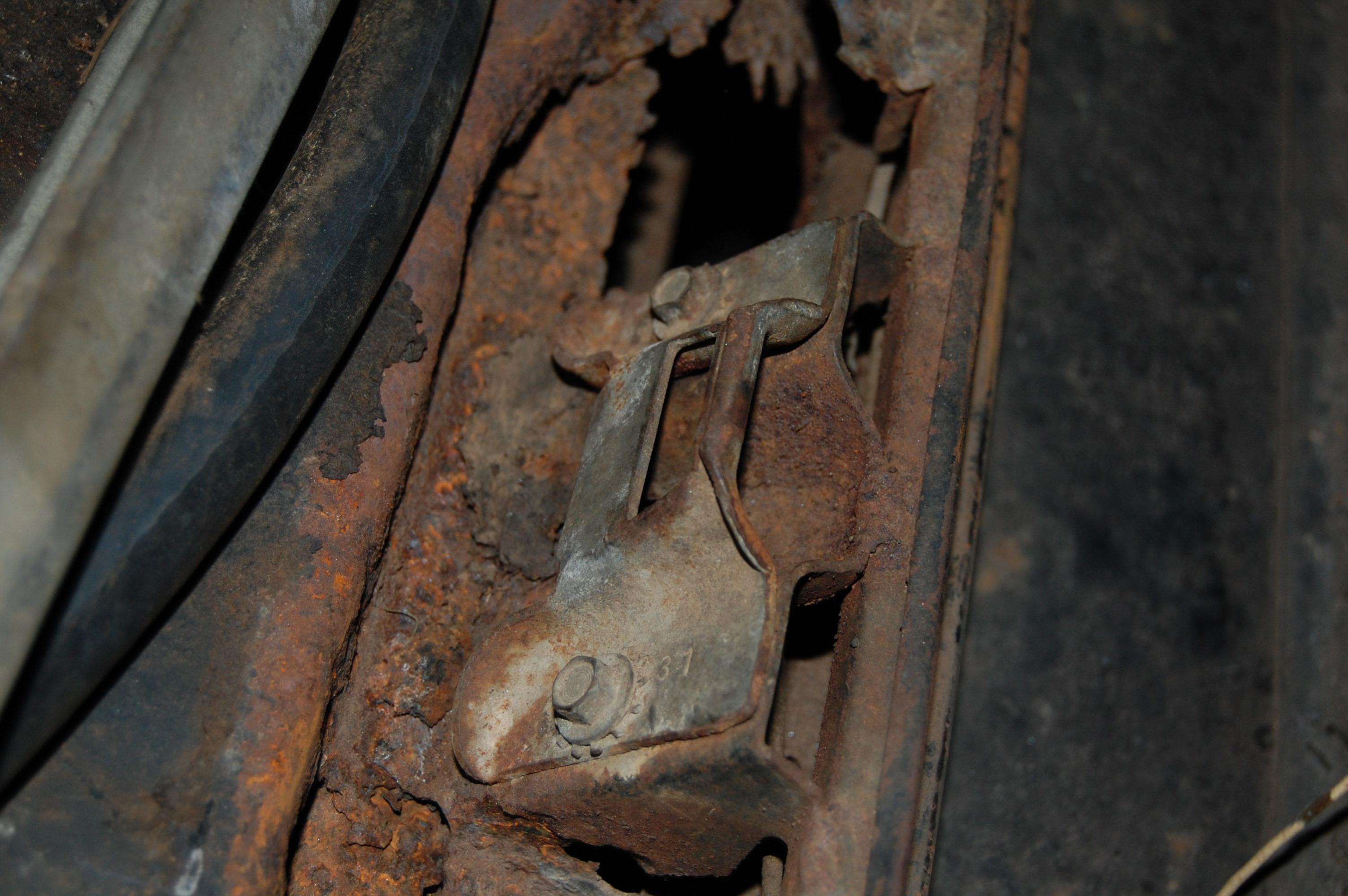

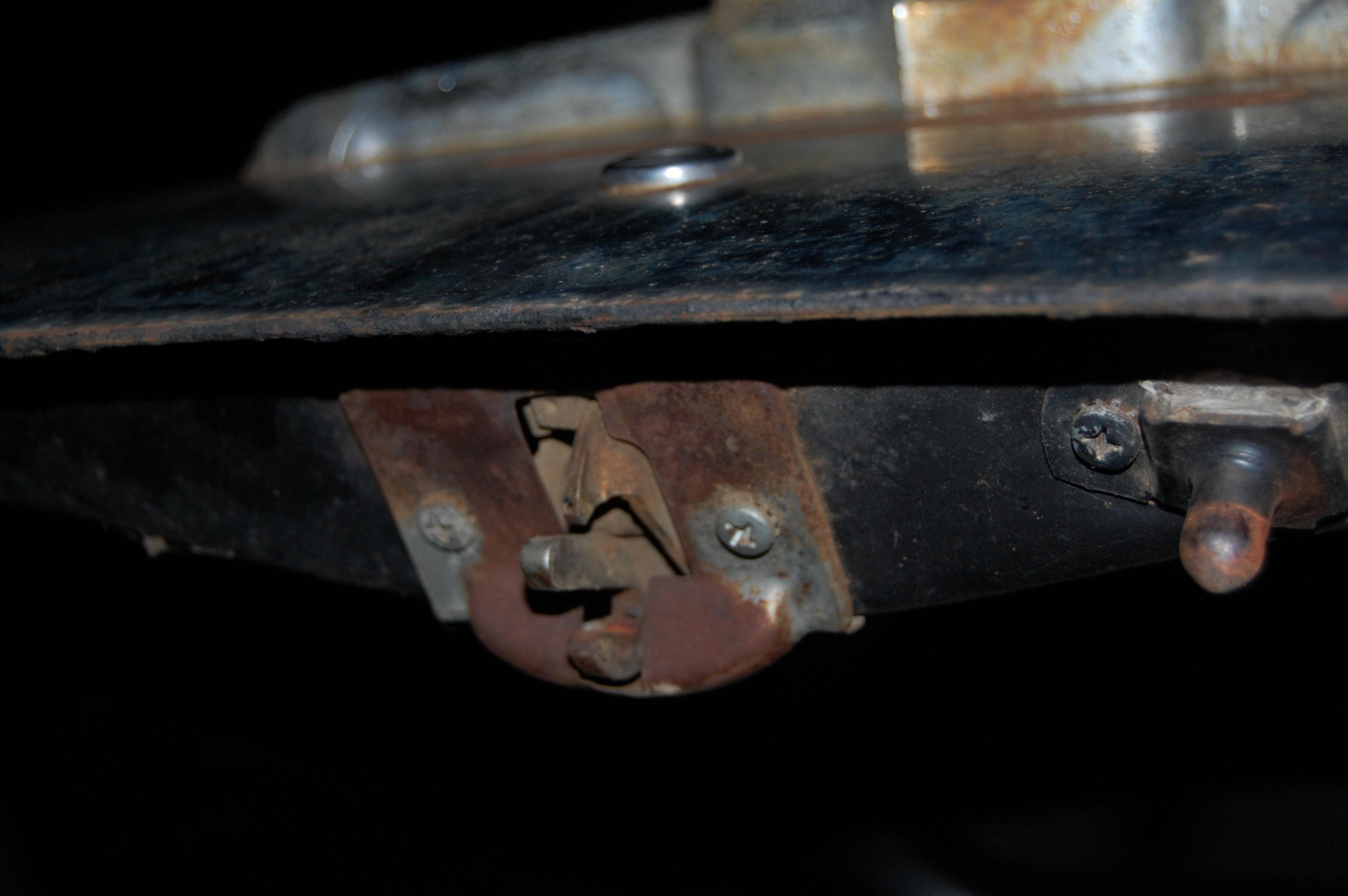

    Some pics...
    Tried to get as many angles of the actual latch mechanism as I could. I don't think you'll be able to do anything with it from inside. That last pic shows the wide-open crawlspace you would have if you did decide to pull out the back seat. At least, on a '53. Can't imagine a '52 would be that much different.
    Just think..! If you had the rot issues around the catch like I do, all you would have to do is lift up on the lid a little and it would come apart in your hands! (Be glad you don't... lol)

    I haven't tried to turn, twist, pull on, wiggle, or anything else this little "nub" above the latch on the inside of the lid, but this might be your ticket to getting it open from the inside. Maybe some needle-nose and twist?

    Rag top you're a G! That's a ton I pics! If I remember correctly turning that will open the trunk
