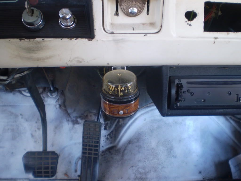

    Not much of a update just some stuff i picked up and put on....First off i wanted a tach but i forgot the other aftermarket gauges were black and bought a white one and destroyed the packaging before i realized it was wrong ,so I maybe swapping it out later for a black faced gauge, and then i picked up a Re-pop cl***ic accessory flashlight and holder that goes on the column, the column was to big to clamp it around so i modified the flashlight bracket to use the tach to hold it to column, it wasnt a vintage one so i didnt fell bad...
    Tach:
    Accessory flashlight:
    1Nimrod likes this.

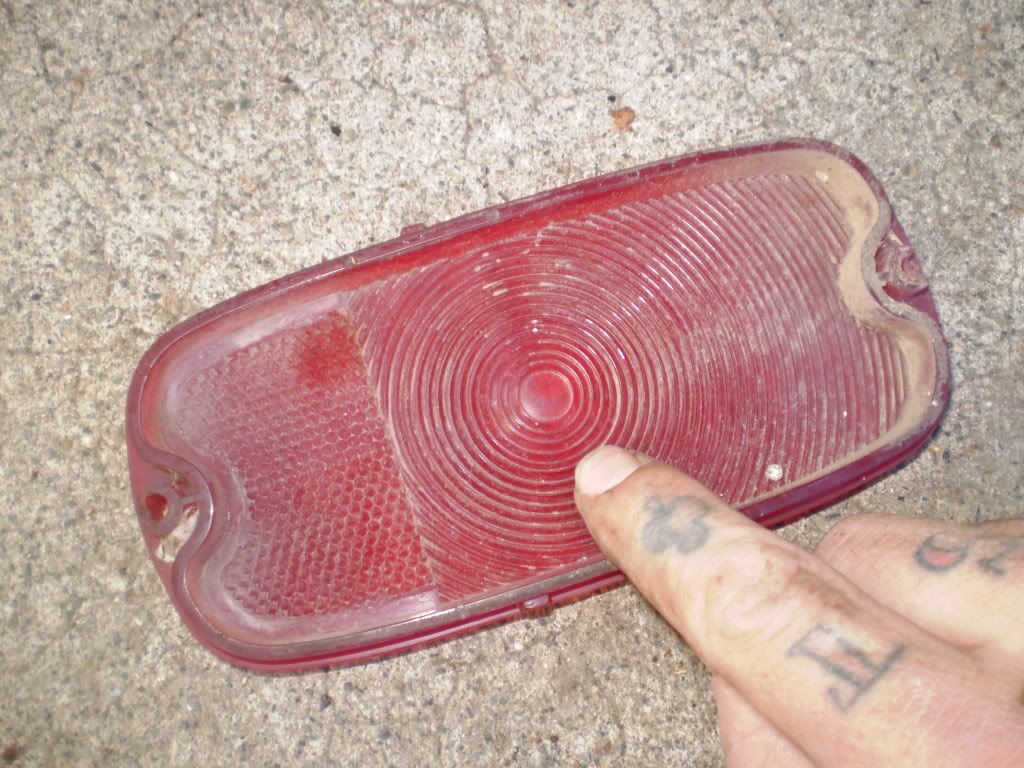

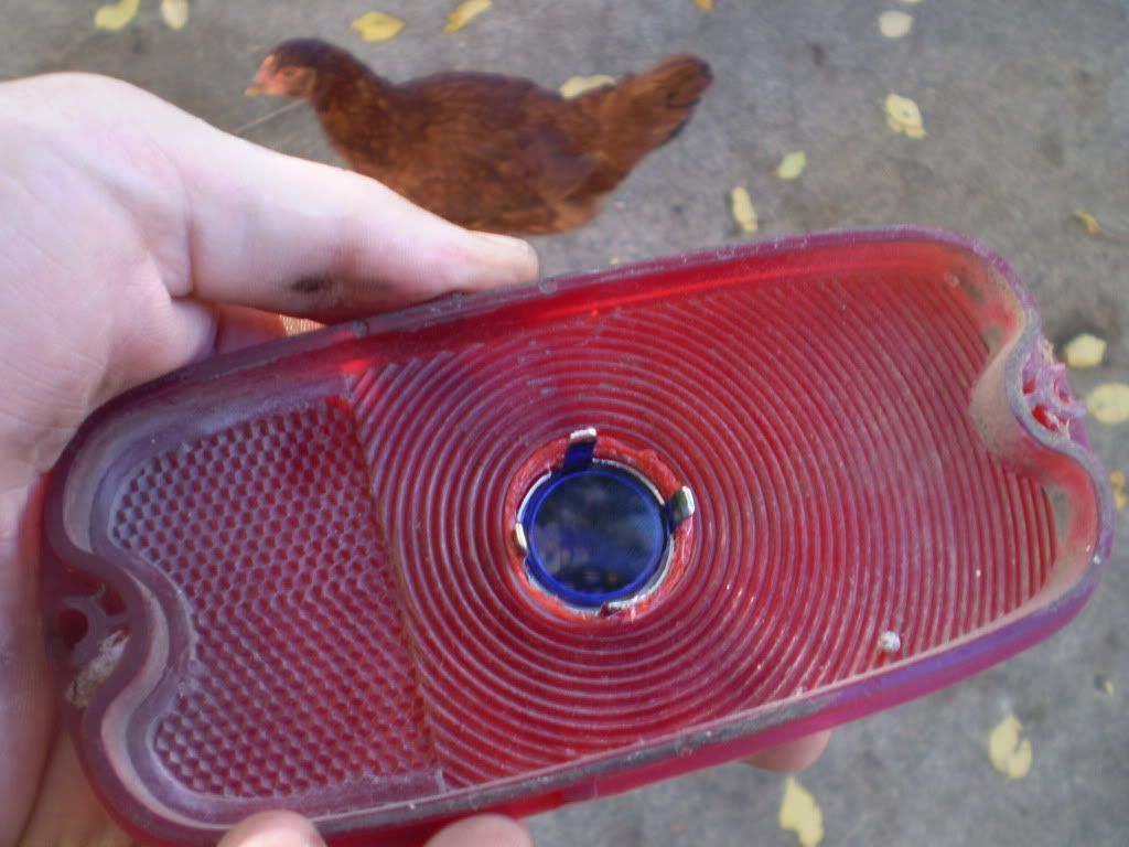

    Well i picked put some blue dots and decided to try and install them on my old lens, ive drilled lens before but it is always risky chipping or cracking them,i know from experience! So i tried a new technique which worked well for me that you guys might like it....
    Stock lens:

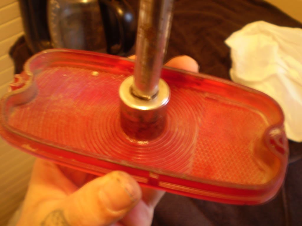

    On these lens there is round ridges on the back side the bloue dots need a 15/16 inch hole and the(hard to see) the deepest ridges in the center are 1 inch so lining up the center was easy:
    I tool i will be using is socket on a extension that measures 15/16":
    Over at the stove i heated it up:
    And then line it up right in the center and let it melt into the lens..This part stinks a little!......i had to reheat and melt a couple times to get all the way thur:
    next was install the blue dot's:
    Twist the prongs with pliers to hold the gl*** in and everything to the lens:
    Presto!!:
    Installed:
    Apply power:
    I couldnt get a good angle with the camera with out it blinding the picture showing the blue dot part but they are quite blue! ill have to get a night time shot!
    Hoped you guys liked it!!!

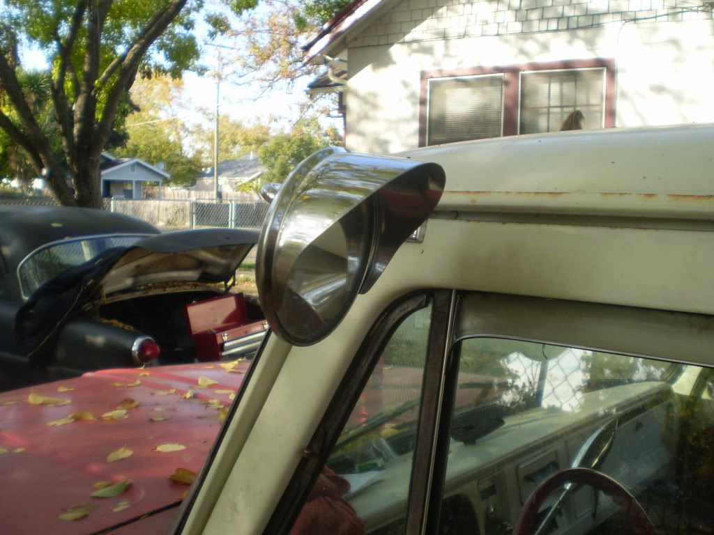

    first i added a peep mirror shade:

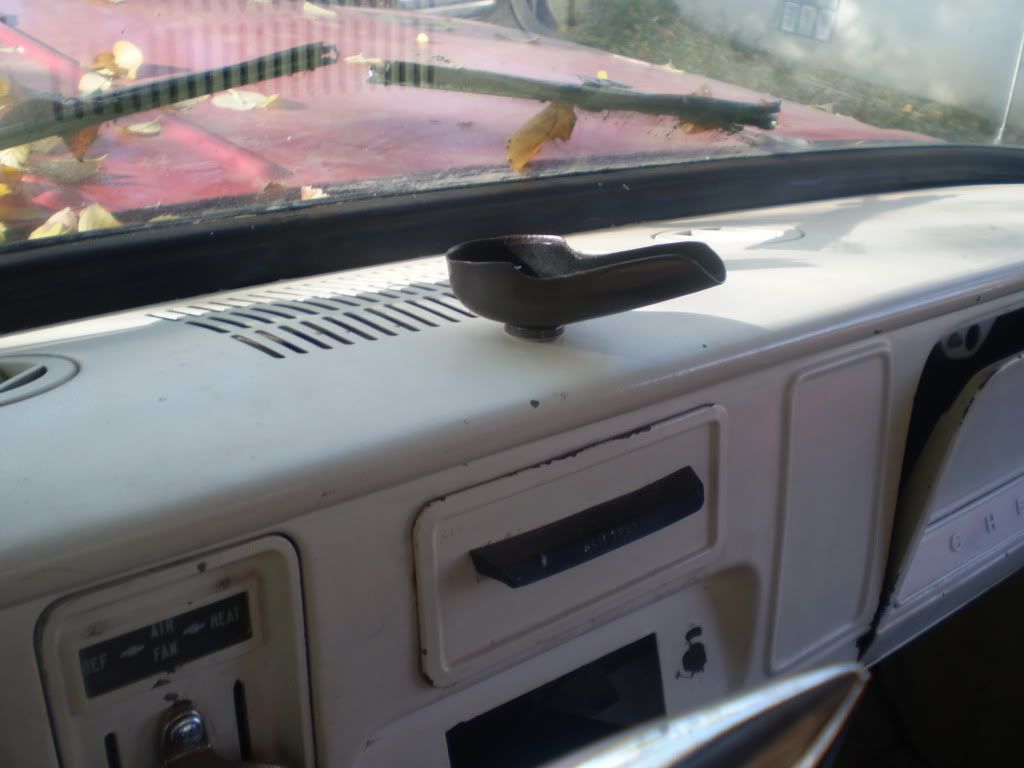

    Steering wheel spinner knob:
    Pipe holder ,i actually do own a pipe that I puff on at my pops house i just got to remember to bring it back next time im there.

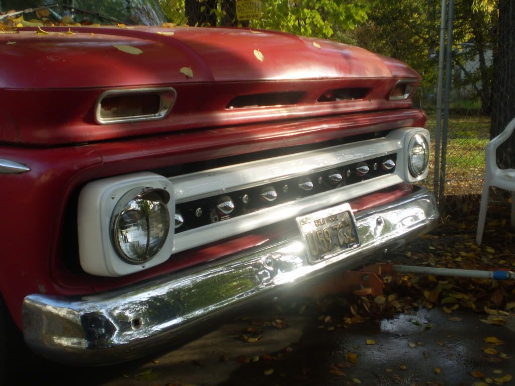

    I wanted to buy "cat eye" headlight covers ,but didnt know if i wanted to run the "jeweled headlight visors also so i bought one too see what it looked like im kinda digging it...thgats why only one headlight has a visor in these pictures:

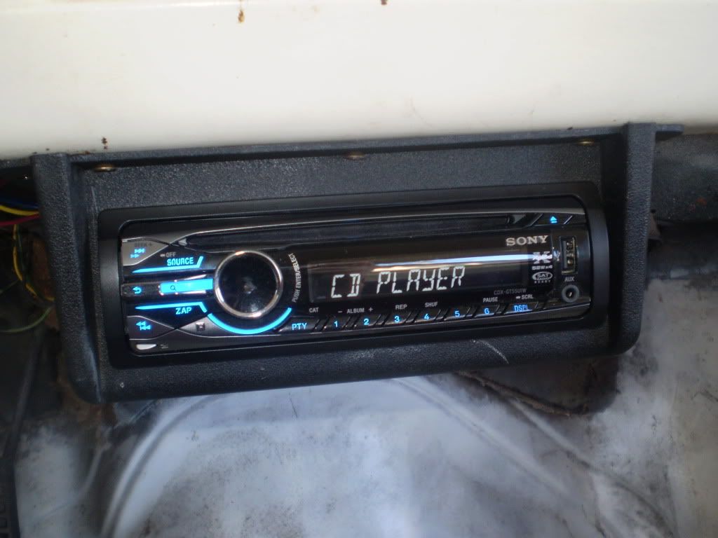

    I had robbed the cd player out of the 66' to put in the 73 bug i picked up for the ol' lady ,so then i was given a brand new cd player that was missing the face plate,I also needed a cd player for my 54 ford so i looked up the model number and went out and bought the same exact one, now i just swap the face plate between my two cars,so i pretty much got two brand new cd players for the price of one pretty smart i think :metal:

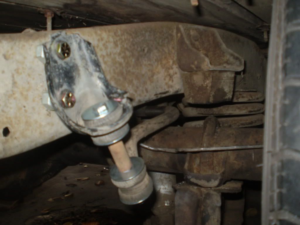

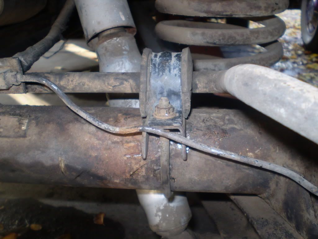

    Went to pick-n-pull on thanksgiving weekend when everything was 1/2 off,and got some front bumper brace's, a 1 1/4 sway bar off a 80's c20 and then pulled a rear sway bar off a camero it all came to $35:

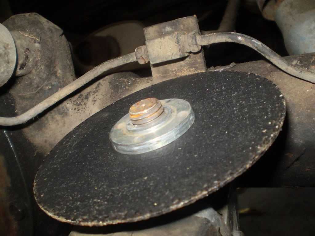

    First thing i wanted to tackle was the rear sway bar, after taking the links of the ends of the bars(because they will be installed opposite of the way the came off camero) I mocked the bar up:

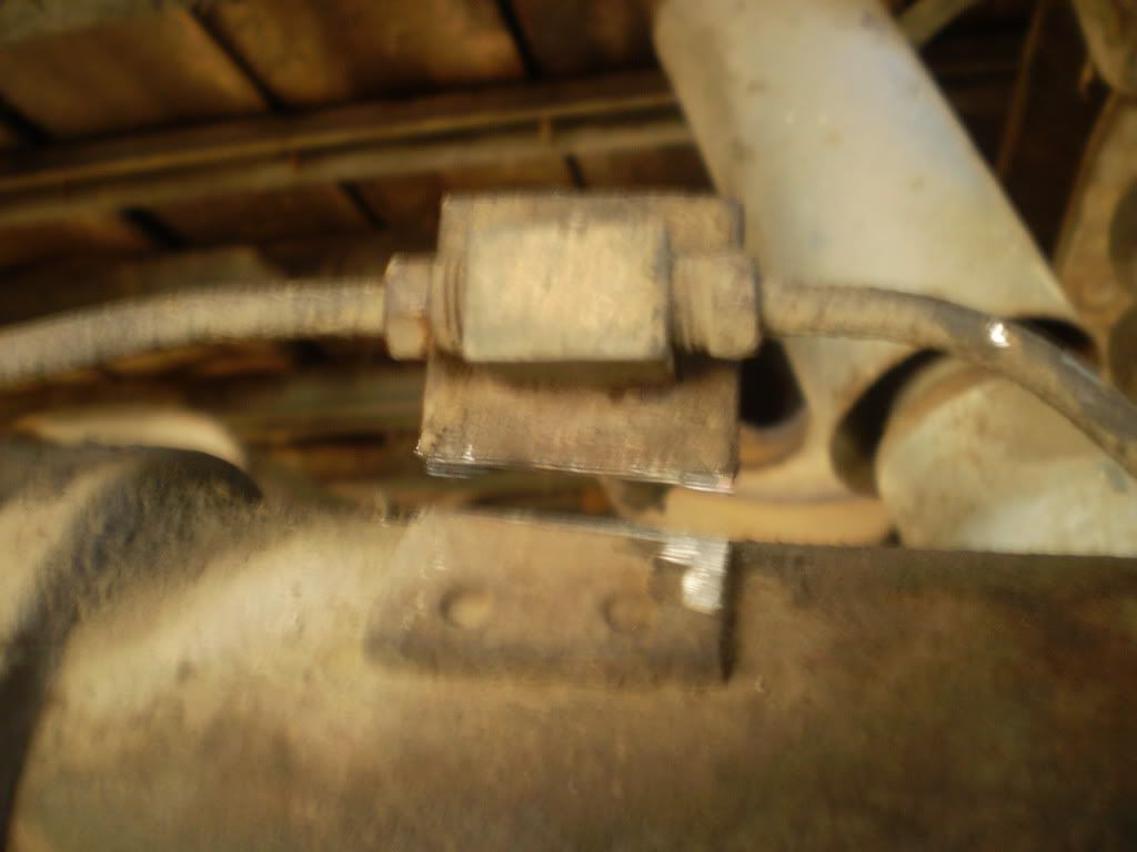

    the brake bracket on the axle has to move and since i didnt want to undo the brake lines i just carefully cut it off:

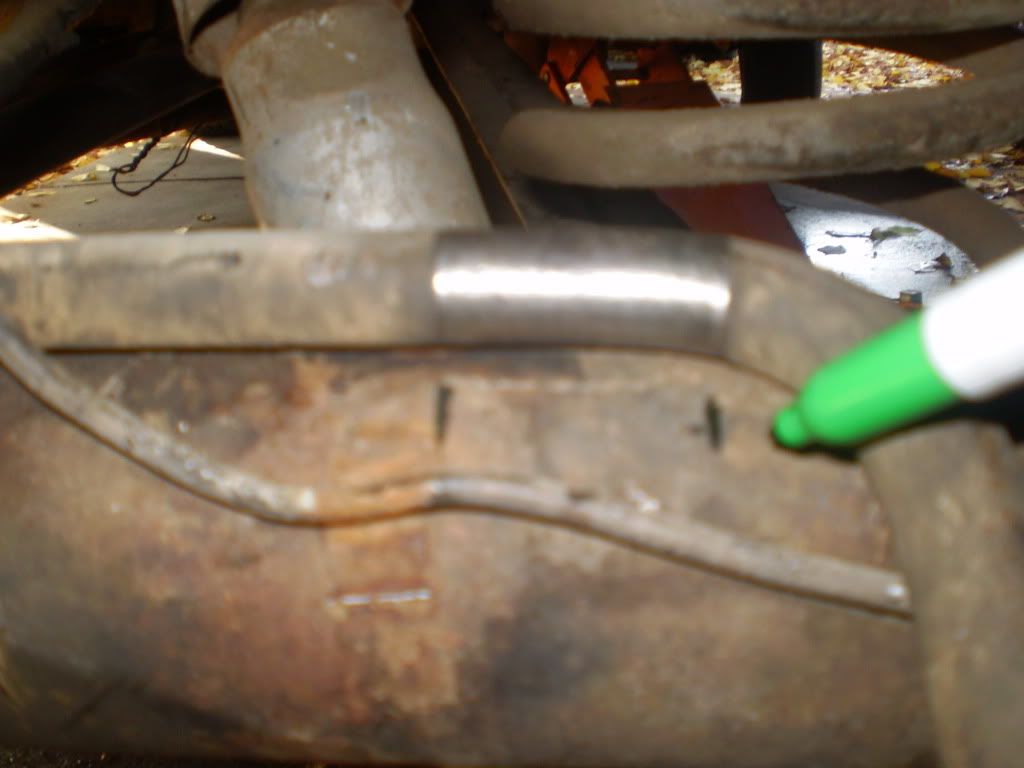

    then i centered the bar on the axle:
    used the old wear marks to mark the axle:

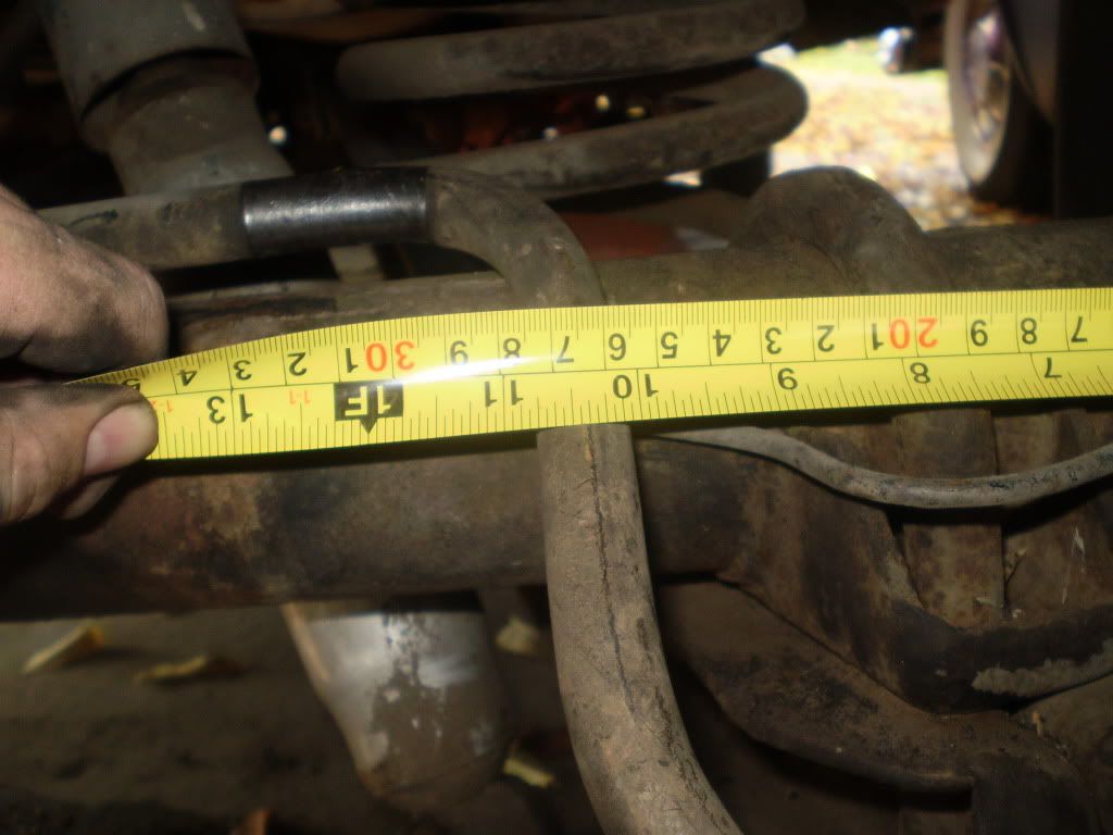

    then since the camero axle is 2 3/4 the saddles have to be ground out to fit 3" axle:
    Then bolted it all together had to bend the tips of the ubolt back to 2 3/4 to go thur the saddle using some big pairs of channel lock pliers saw somewhere else someone welded the saddles on but i wanted mine to be bolt on:

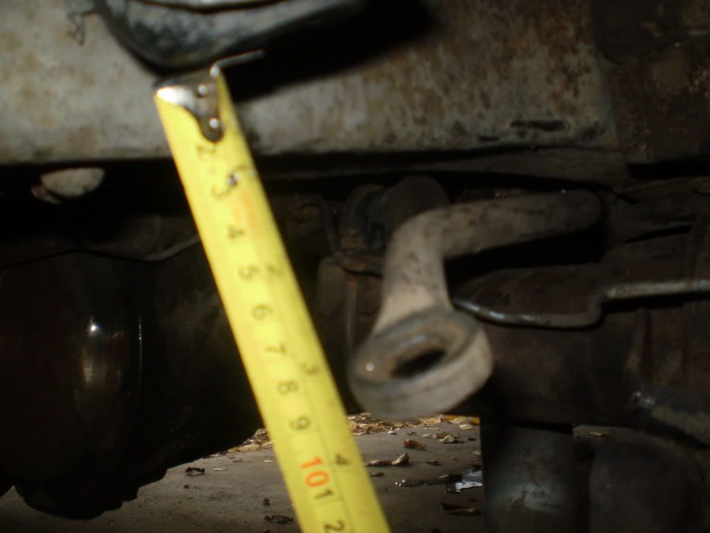

    i the let the truck down and the frame was resting on the bushing hold downs so i had to move mine over since my truck is so low with out a c-notch, once i get my c-notch ill see about moving them back over to the very end:
    next i mocked up the link bracket and drilled holes and as you can see their is about a one inch gap where the bracket will be bolted on the link on the bar:
    All they had at home depot was some thin walled square stock so i just bought some big nuts and used them as spacers and bolted it together and it is strong as hell if i find some solid stock of aluminum or thick walled square tubing ill redo it;
    Then i measured for my link,you want the bar to be parallel with the ground for the bar to work right:
    Measured where to cut the link spacer and i am using a new bolt thats threaded the camero had a bolt with a shoulder that the threads only went so far:

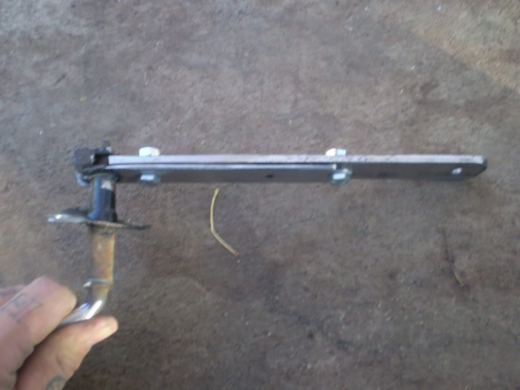

    bolted it all in and cut the excess of the link bolt and its installed:
    everything was repeated in steps on the other side the only thing left to do is make a new bracket holder for the brake lines. I plan on doing bed wood, rear tank and c-notch so i didnt worry about painting it untill i take the bed or the bed wood out plus it match's the rest of the under carriage . next up front sway bar!

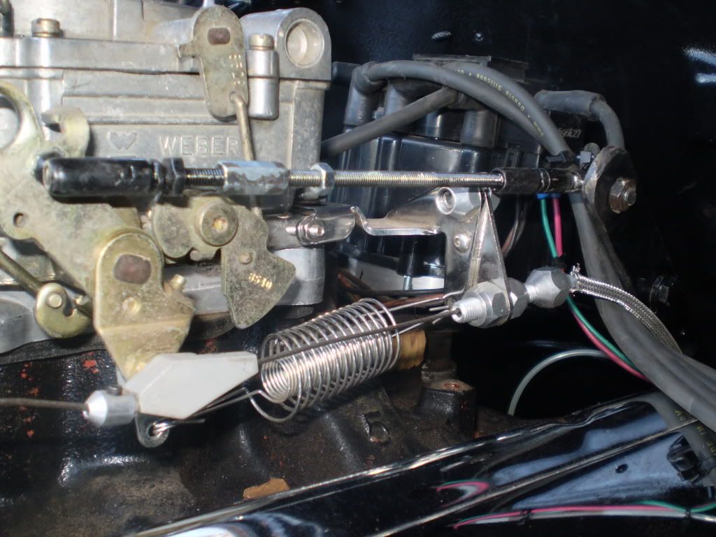

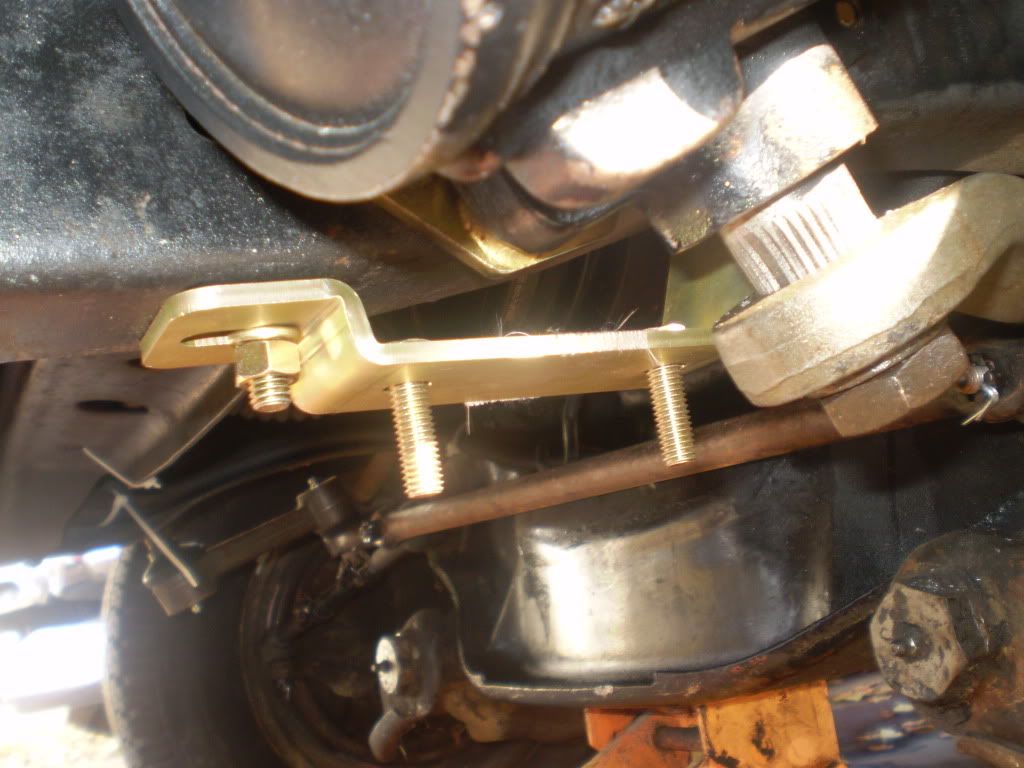

    Since Im waiting on my front swaybar frame brackets to be made and shipped to me i decided to tackle some small stuff I've been putting off,first i wired in some headlight relays which made a huge difference,sending the power straight thur the relays to the headlights byp***ing the headlight switch,much brighter:
    then i extended the stock throttle linkage arm so the rod is level when it pulls:

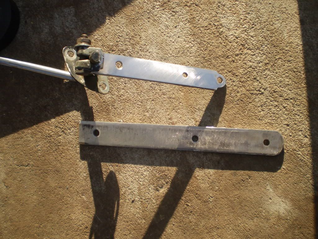

    lowered swaybar brackets:
    ground off the rivets and drilled some holes and mounted them:
    Used some dollar store oven cleaner to clean up the sway bar and bushing brackets i got at pick-n-pull:
    painted the brackets and swaybar:
    Then after fighting getting everything lined up i bolted it on, as you can see i needed the the swaybar mounting brackets(lowered type) because the power steering box hangs lower then the stock steering box:
    Heres a picture of the swaybar next to the idler arm fits tight on this side also:

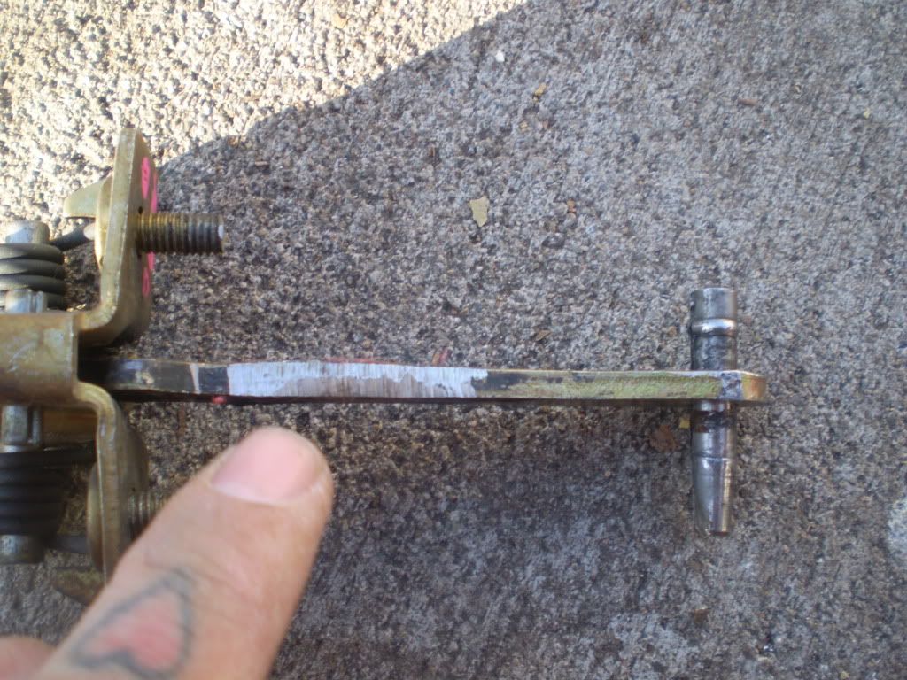

    while the washer bottle bracket and gun rack paint was drying i installed the Jeep Cherokee door checks, i used the front door checks because they have a shorter throw then the rear ones, or the stock ones so they help from getting the door dents(smiley face's) and will hold the truck door open on a hill but the front jeep checks have the double postion bumps and i didnt want the first position at all so i ground the first bump off:
    Here you can see how the front jeep checks hold the door back from getting a dent you can see the difference with the existing dent from when the stock ones were in:
