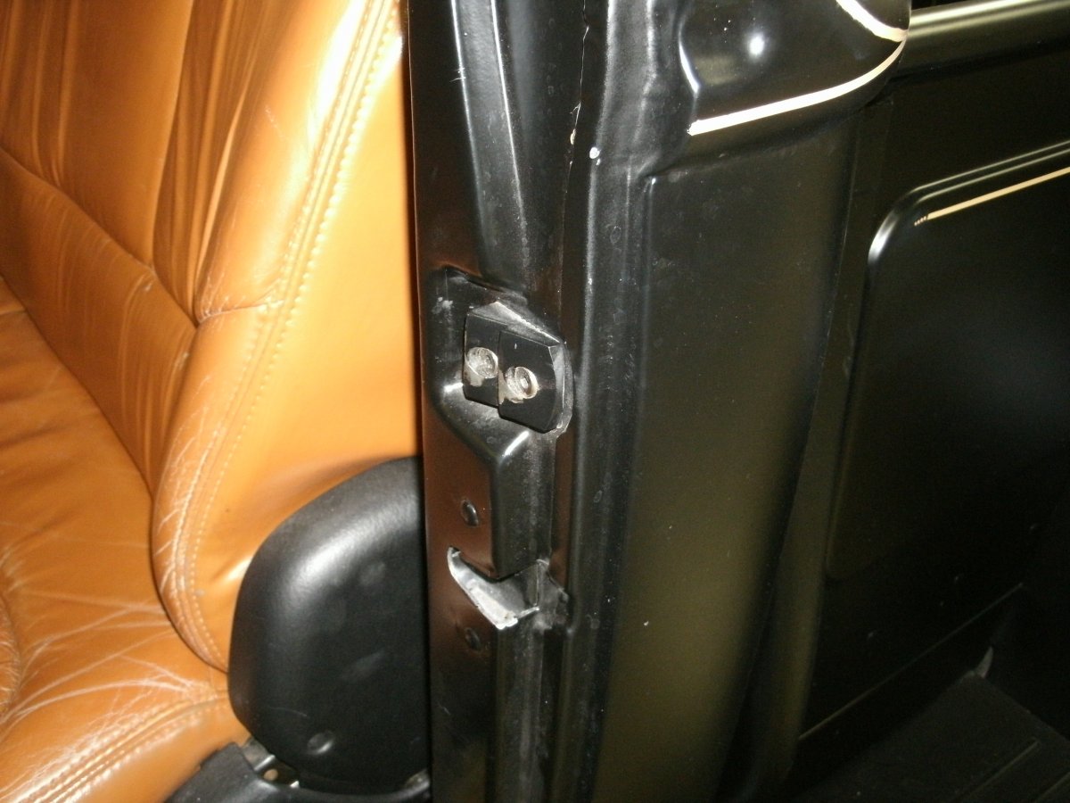

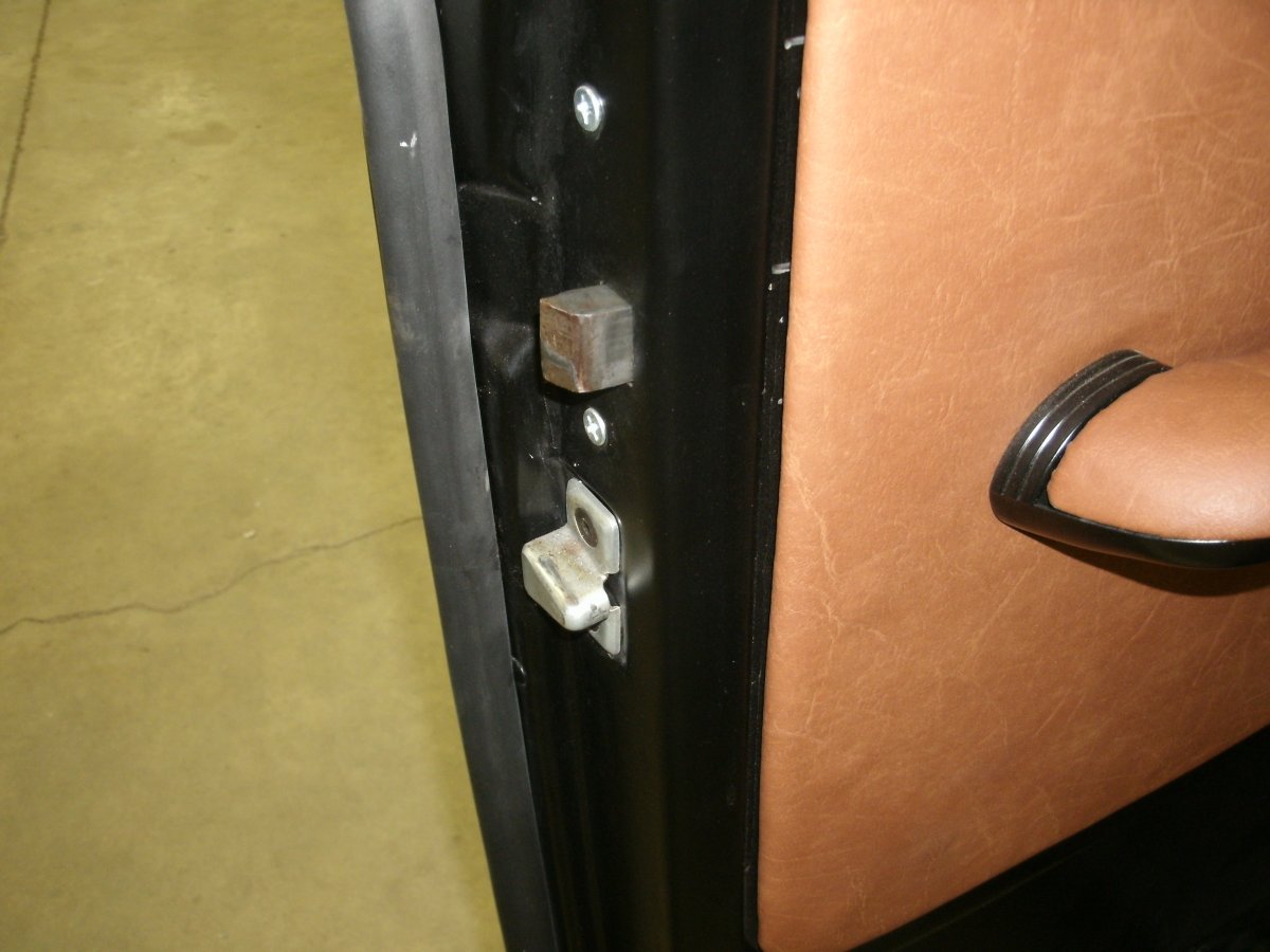

    Does anybody have suggestions for making these latches a little quieter? They sound like a gun going off when I close the door. I have sound deadening on the cab walls and in the doors, but they really "pop" when closing the door.

    I feel your pain. Mine are noisy as well. Looks like you have weatherstripping to dampen the "door slam" noise but like mine, it's the actual snapping of the striker and the latch. Wish I could help, maybe they were engineered that way to give you re***urance that the door was actually shut completely. Don't know. Good luck with a solution..............Don.

    I think you will find oil to be your friend here. I oil the latches and strikers on my 40 once a year and my doors shut so easily and quietly you would think it is a new cadillac... no kidding just use motor oil and you will see what I mean

    I put some 10W30 on it. Definitely smoother, and about 10% quieter on mine.

    did you lube the dovetail and all sides of the latch? mine you can literally close with 1 finger
