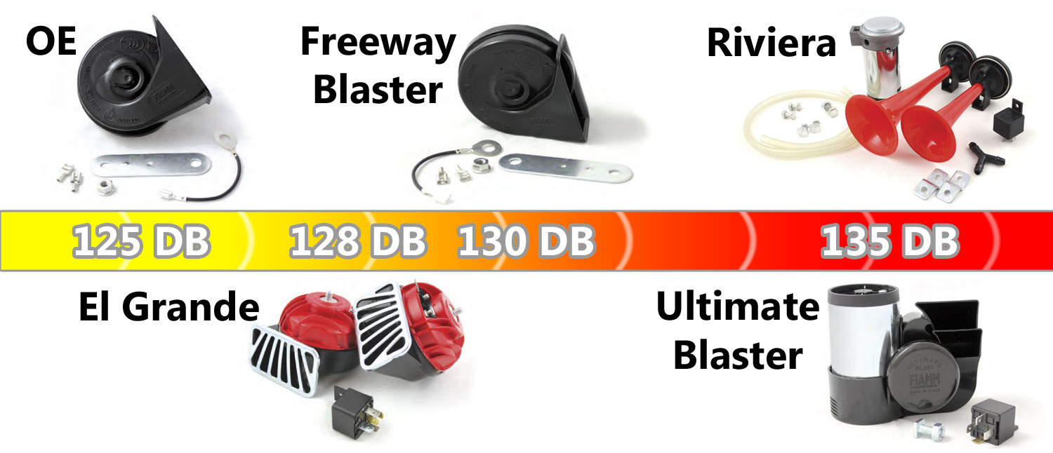

    Found this cool graphic showing FIAM horn db levels: Rock has the 125db new for about $15 + shipping. Need to see what the dealeo is on the FB, R and UB models. But I'm really looking for something that would mount where the OE horns were. NOTE: I'm going to look for those Studebaker horns - I think I have at least a set and would be a cool nostalgia sound I would enjoy.

    The Riviera air horn you show above are loud. Harbor Freight sells a look alike that are loud as well. 6 volt on 12 volt is a good bet for loud. No matter what brand

    Yeah, some of the Italian horns are loud enough to bend sheet metal. Fiamm brand? You can buy them new for reasonable money...
