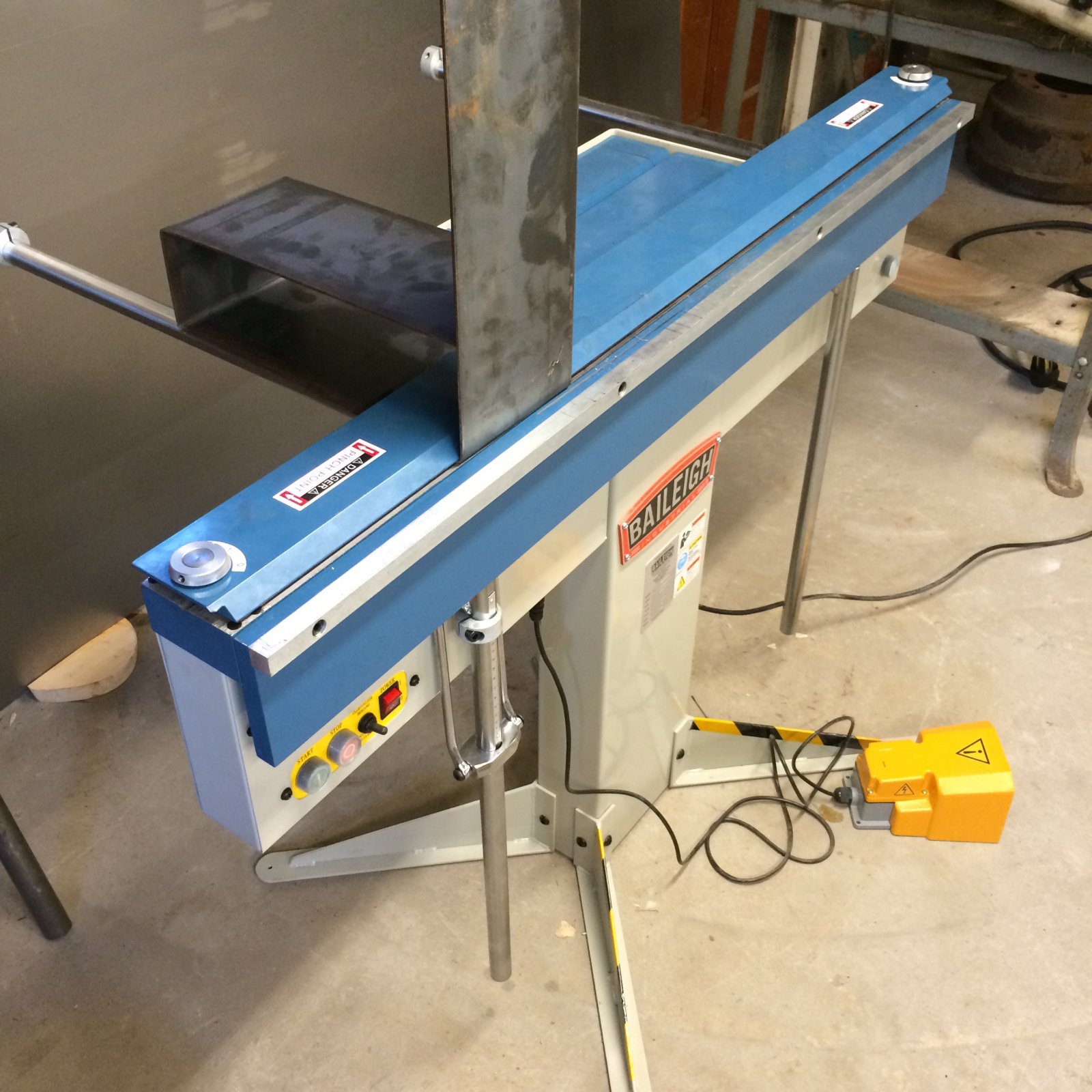

    Starting to fab up a tank. Used my buddy Steves new electromagnetic brake to bend up some 1/8" image.jpg

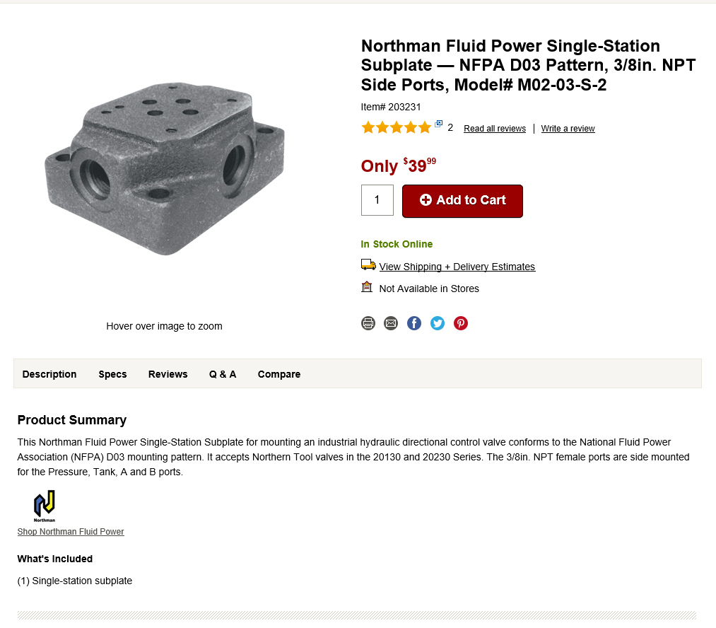

    Alright I think I have this figured out. What do you guys think?
    This is what the plumbing should look like, correct?
    This is the new valve Im looking at...
    http://www.northerntool.com/shop/tools/product_200329581_200329581?isSearch=201305
    This is the sub plate...
    http://www.northerntool.com/shop/tools/product_200326790_200326790?isSearch=203231
    This is the flow control...
    http://www.northerntool.com/shop/tools/product_200339399_200339399?isSearch=202512
    And finally a relief valve...
    http://www.northerntool.com/shop/tools/product_200605546_200605546?isSearch=33308
    What do you guys think? I think these are what I need, I just don't want to order the wrong parts again

    Looks like you got the right components now. Use the relief valve to set your system working pressure and the flow control to set the ram speed.

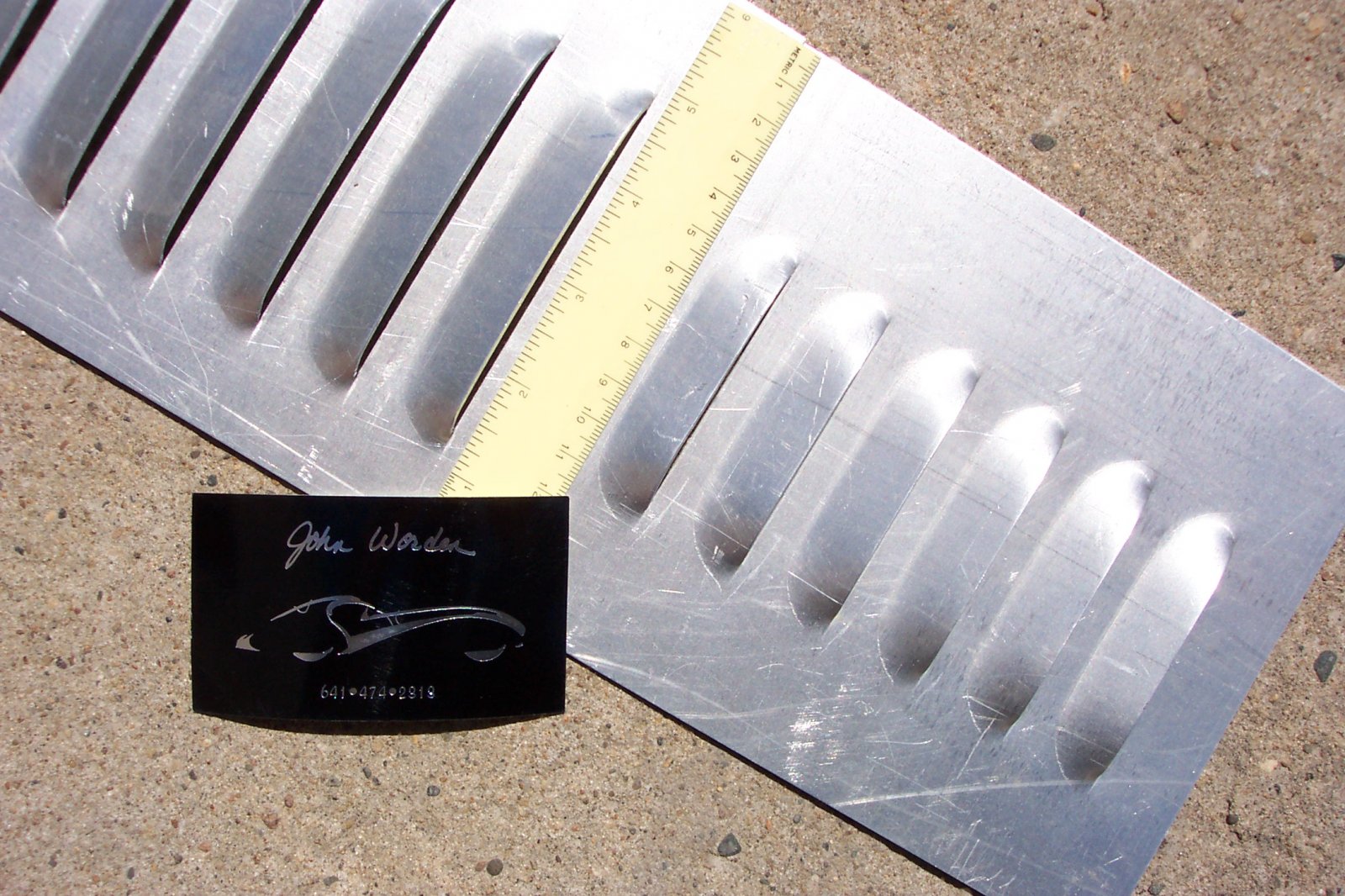

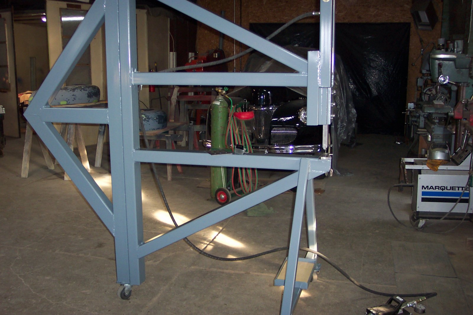

    Your "C" frame throat at 36 inches will not allow the large car hoods unless you rotate the dies and run the panel sideways through the frame. My shop built press is less ***y than your "C" frame but the throat depth was designed at 48" I opted to use shop air connected to an SPX pump with built in foot pedal that operates an 11 ton SPX single action cylinder. A simple setup that uses little air and allows precise die lineup. I also made my 3" and 4" dies by shaping precision ground and hardened steel. I have a set 3" and 4"dies with matching contours and a 3" set of old school or lakes style dies. You may not have to box your frame. I would test it by punching some louvers first. 100_0730.JPG 102_2140.JPG 102_2139.JPG 100_0615.JPG

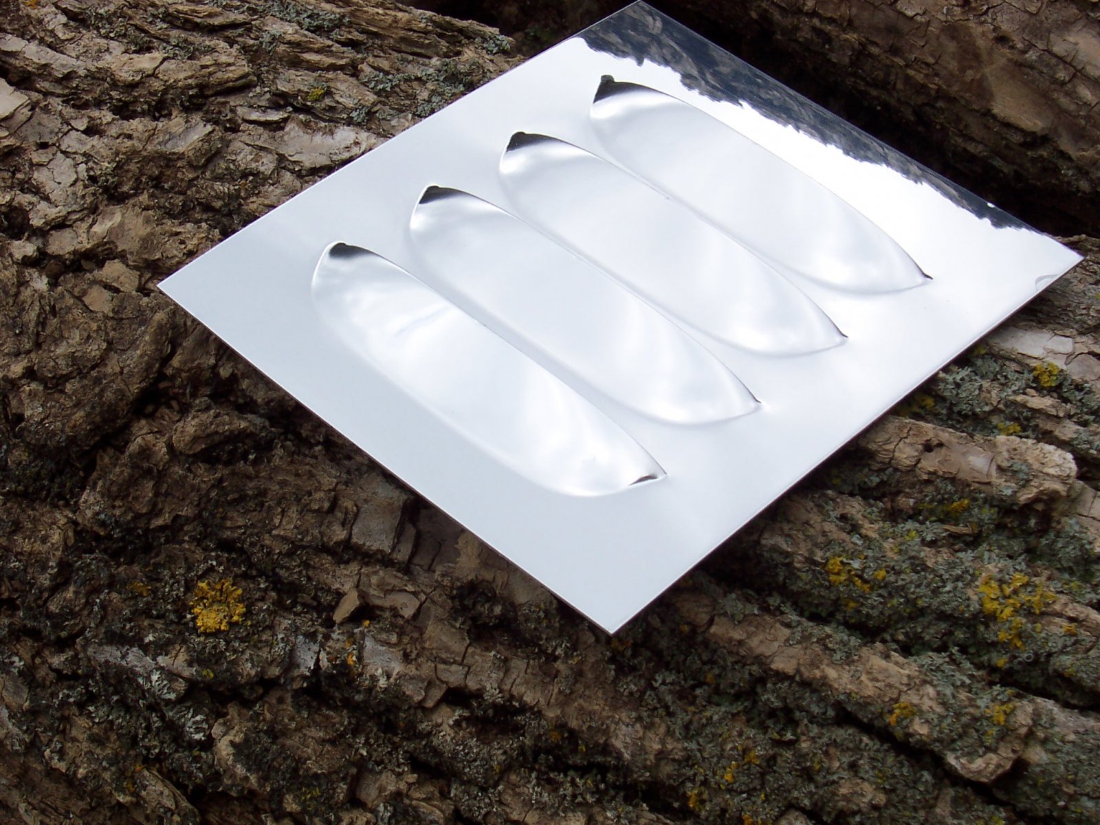

    Very nice! I am planning to set the dies up so they can be turned 90 degrees. Your louvers look awesome! I also plan to carve some dies out of A-2 tool steel then send them out to be hardened.
